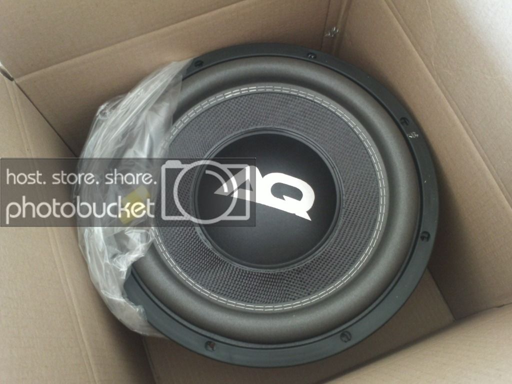

2 12" AQ sdc2.5 d4 subs

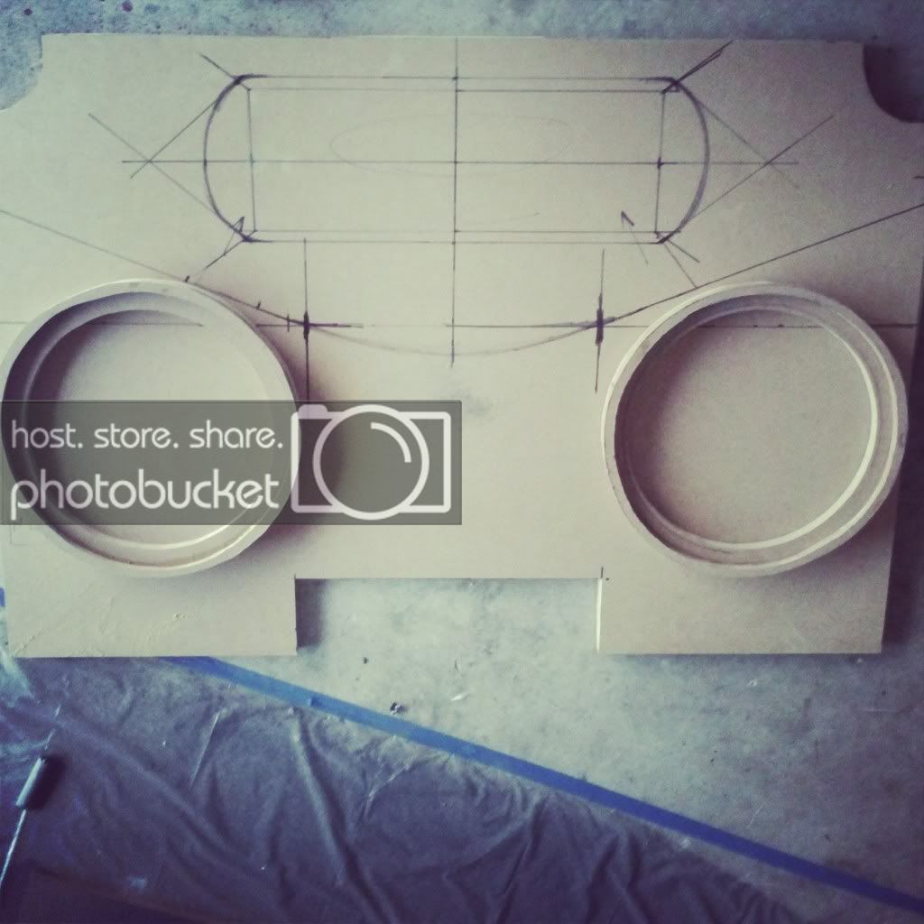

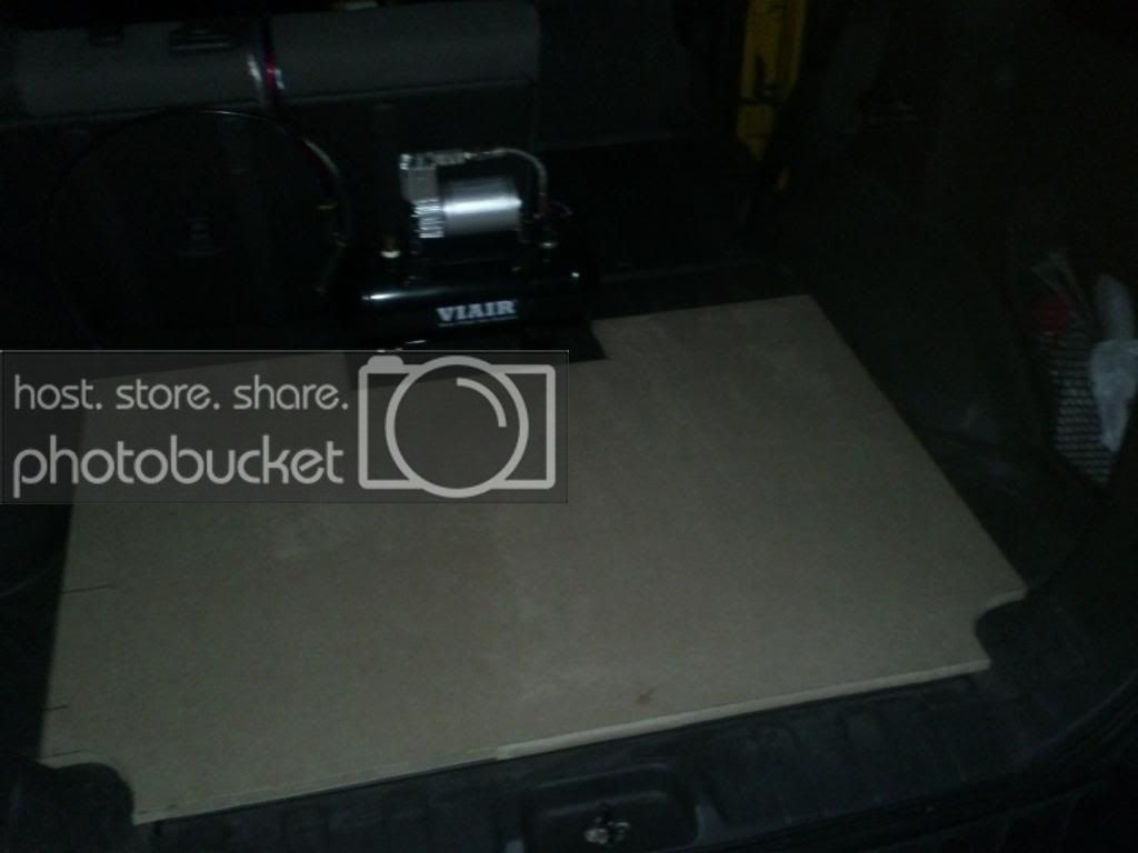

Box will hopefully be around 4 cubes tuned at 36hz with a 6" round port(still trying to figure out the details....basically trying to squeeze out the 4 cubes)
pics
that's where I am at right now.... like I said before wont see progress until after the floors get done so this week I will be working on the numbers to try and get the 4 cubes or close to it......

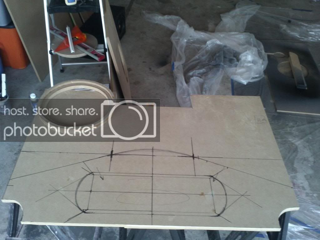

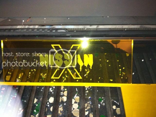

the plexi i will be using for the lit up piece in all of this build. going to try and get the walls and amp shelfs cut this week(inbetween working on my floors) since i have a chop saw....will take advantage of it //content.invisioncic.com/y282845/emoticons/smile.gif.1ebc41e1811405b213edfc4622c41e27.gif
@pro-rabbit
what do you suggest the best way would be to make the plexi to appear an oval shape? i was thinking of doing a oval cutout and flush mounting the plexi into the base and then use the cutout to hold the plexi down and then fiberglassing it to the base.....
There are a few ways.
1. Just use a trim plate to get the oval look
2. Cut the plexi yourself then install in which ever method works best
3. Combination of both 1 and 2.
When doing custom installs there is not always a right/wrong way of doing things. More of a what works best for your skills, tools, and what look you are going for.
well since im still learning etc i guess it will be based off my skills lol
The easiest way would be to...
screw the plexi down to it's location.... then do a trim panel over it with the cutout in the size and shape you want... be sure to rabbit the edge though to hide the material you wrap it with.
He is a very basic retangle plexi but mounted behind a trim panel... (it is screwed to the the trim itself) using the rabbit edge we hid the seem of the carpet..
