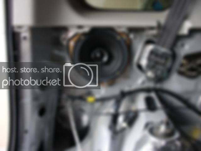

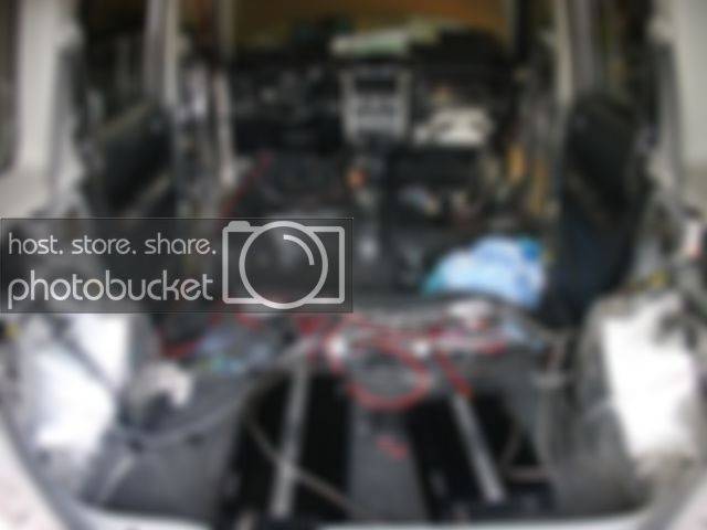

Total mess, the beginning of a nightmare //content.invisioncic.com/y282845/emoticons/smile.gif.1ebc41e1811405b213edfc4622c41e27.gif
Back speakers, the biggest they could be, had to tap on speaker a little bit cuz the bolt was in the way

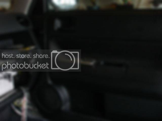

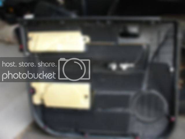

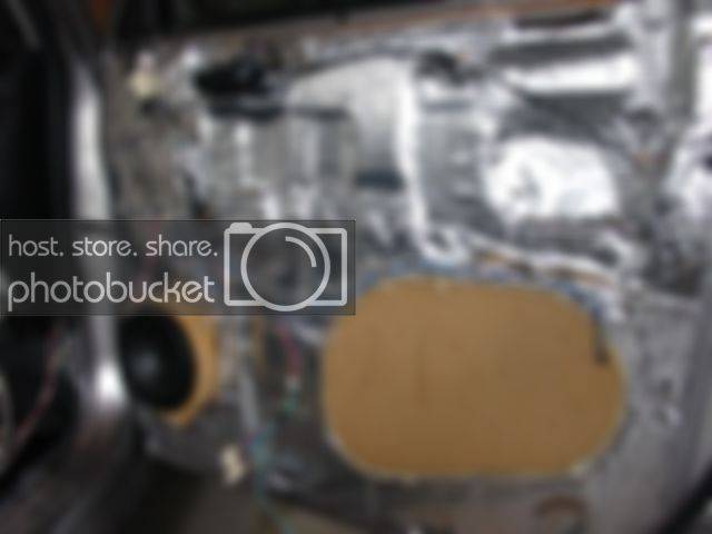

Front doors, damplier, speaker tweaker inside, closed the big hole with watersealed wood, baffles that I did myself(friggin mdf dusts like crazy)
Overkill on the door panel, pretty easy

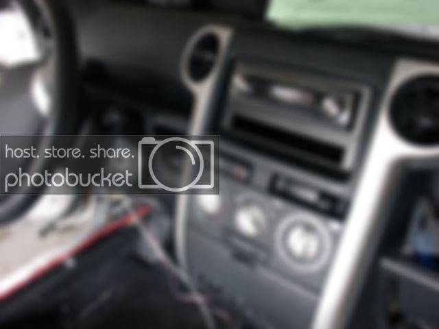

Nice and clean lookin hu
Drilled a hole in doors for tweater, scary as hell...

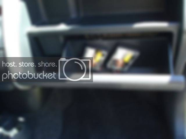

Looked for some good place to hide crossovers to make them accesible

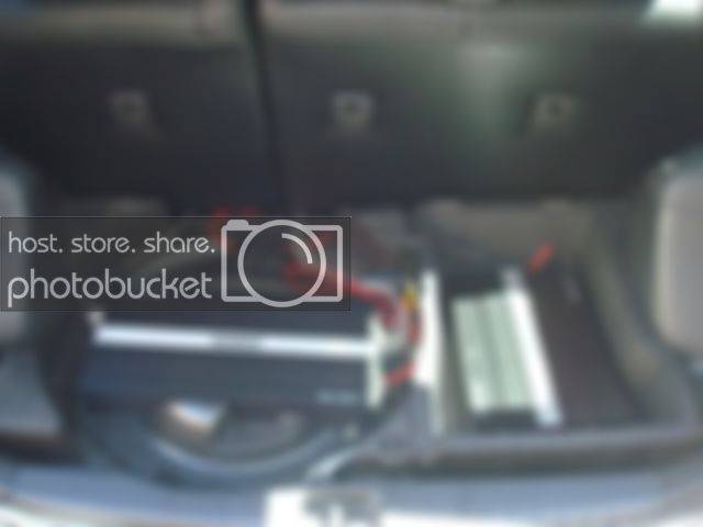

And last the amps, threw out a spare, put them nicely so everything looks oem when covers go back on
Waiting for custom box to go in the back, can't wait //content.invisioncic.com/y282845/emoticons/smile.gif.1ebc41e1811405b213edfc4622c41e27.gif
Are you keeping speakers in the dash? If not, you could always replace them with a plate and mount your crossovers to them... just an idea //content.invisioncic.com/y282845/emoticons/smile.gif.1ebc41e1811405b213edfc4622c41e27.gif I plan on doing just that
Bob from Scion Apocalypse can make tweeter plates, too. //content.invisioncic.com/y282845/emoticons/biggrin.gif.d71a5d36fcbab170f2364c9f2e3946cb.gif
