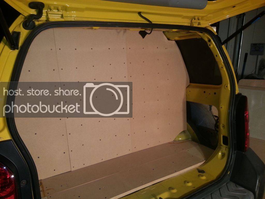

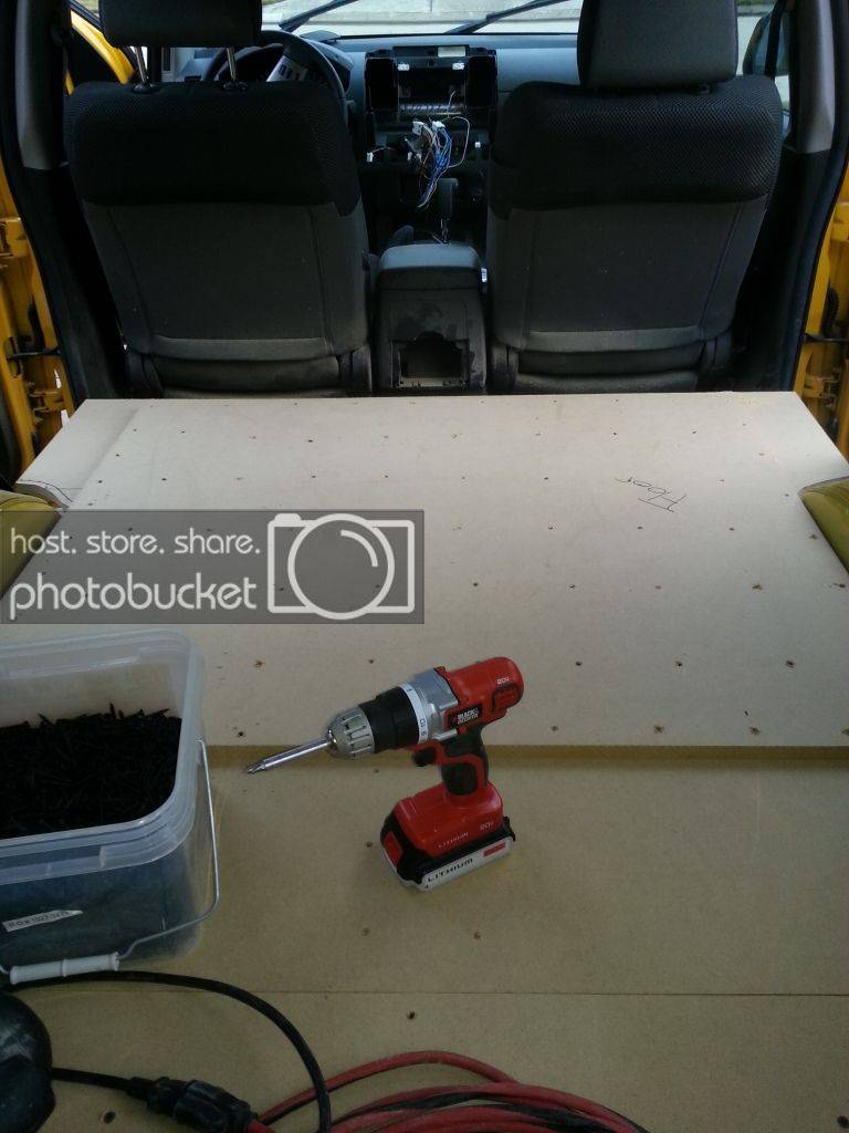

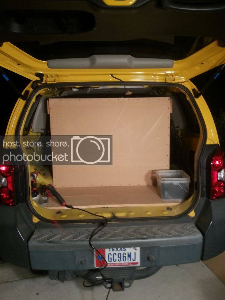

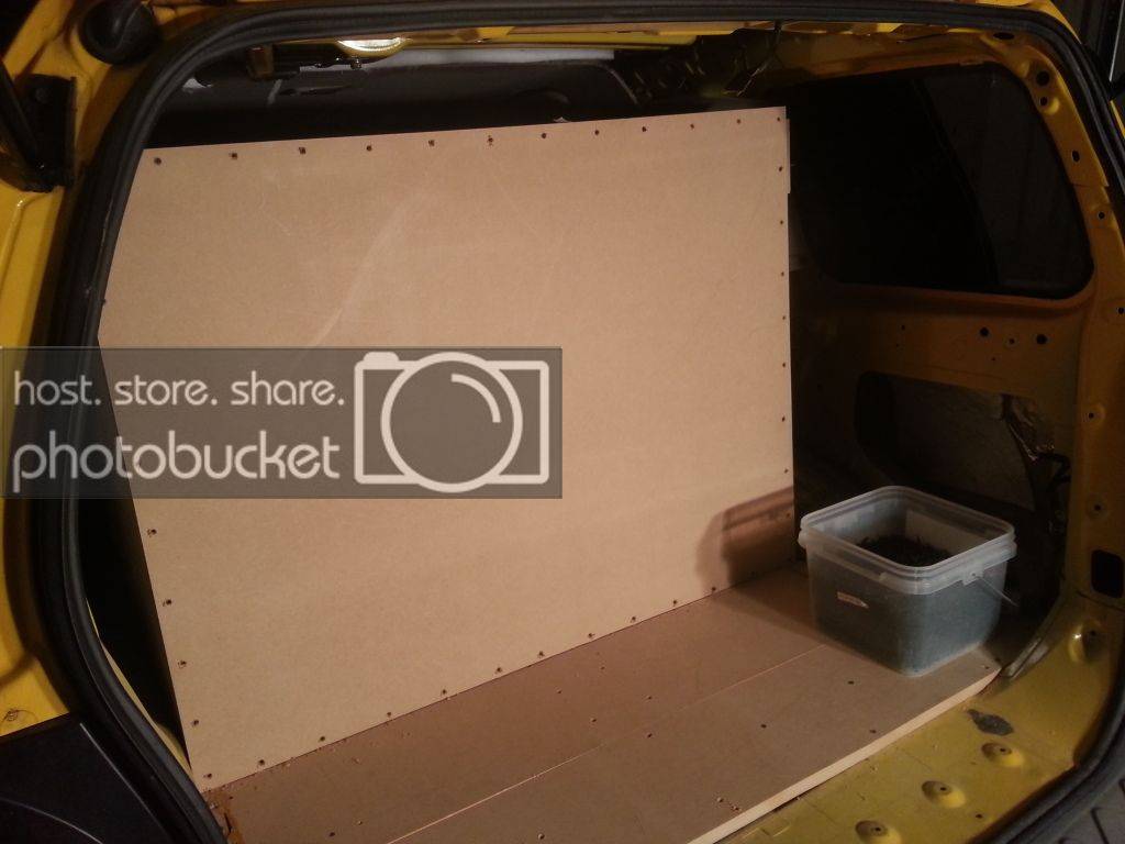

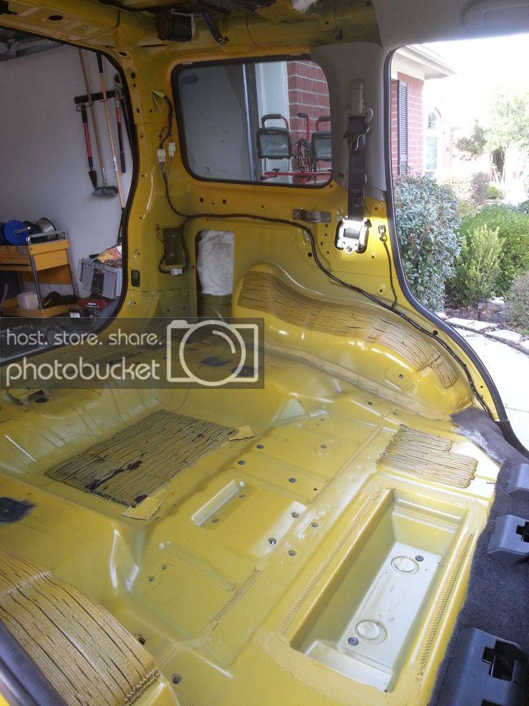

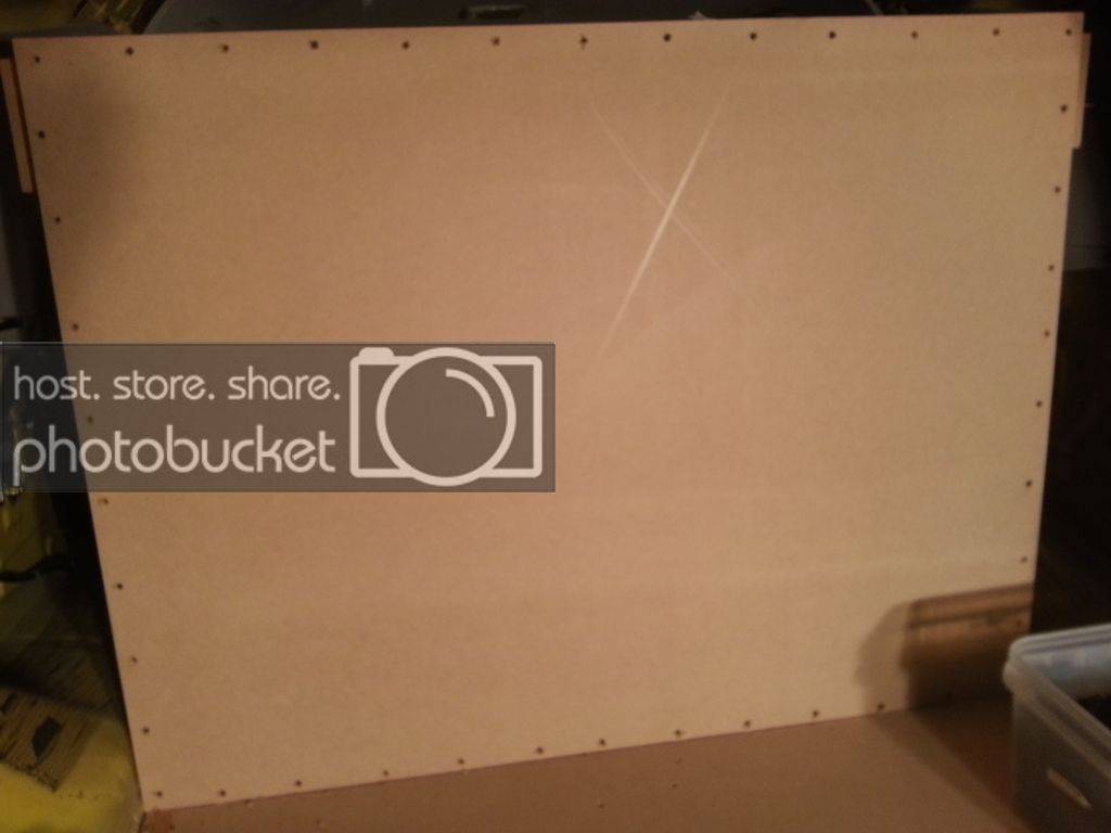

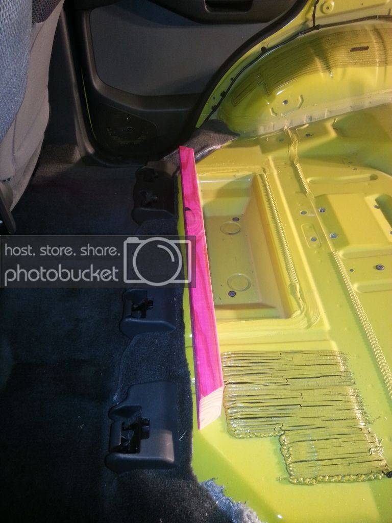

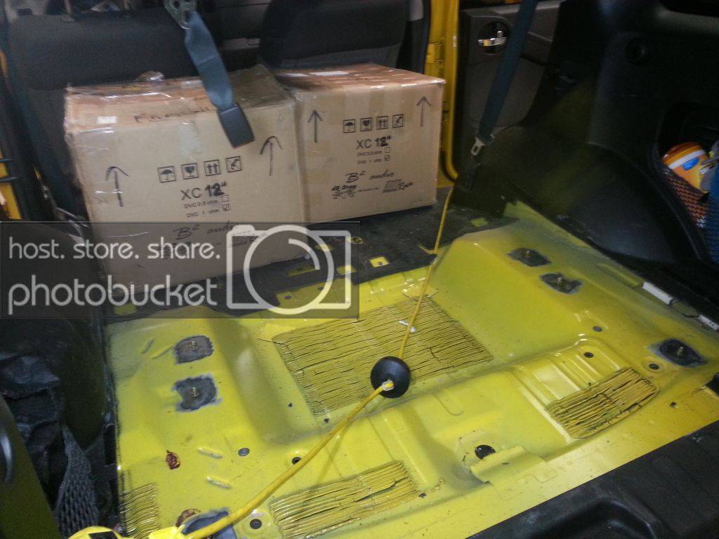

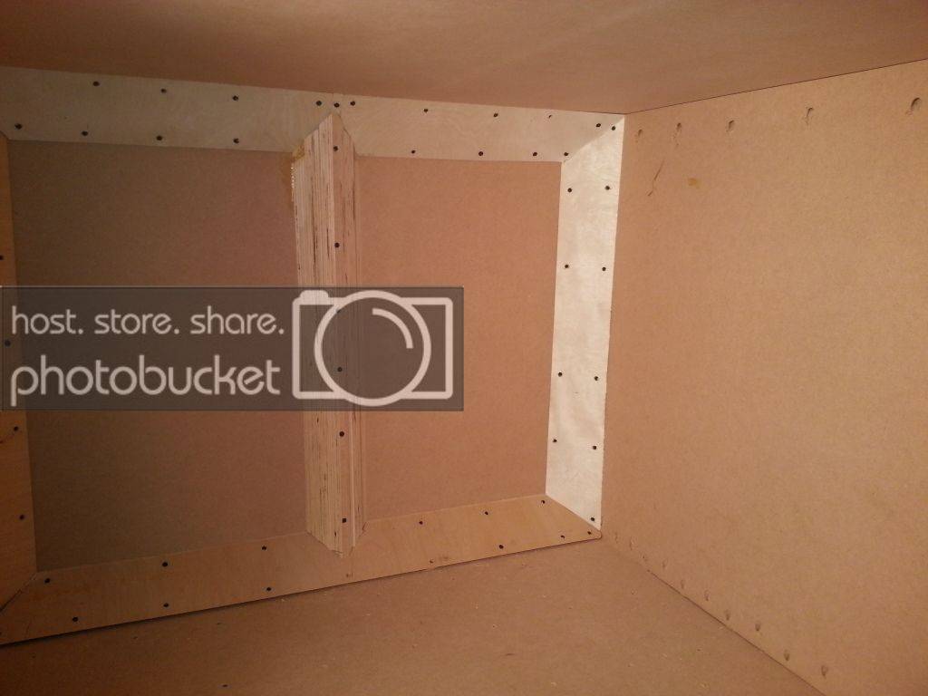

So i decided to do a dedicated Street Beat 4 usaci vehicle, my wife wanted a new car so i got her a new car and decided instead of trading her suv in i am using it for this, lol.

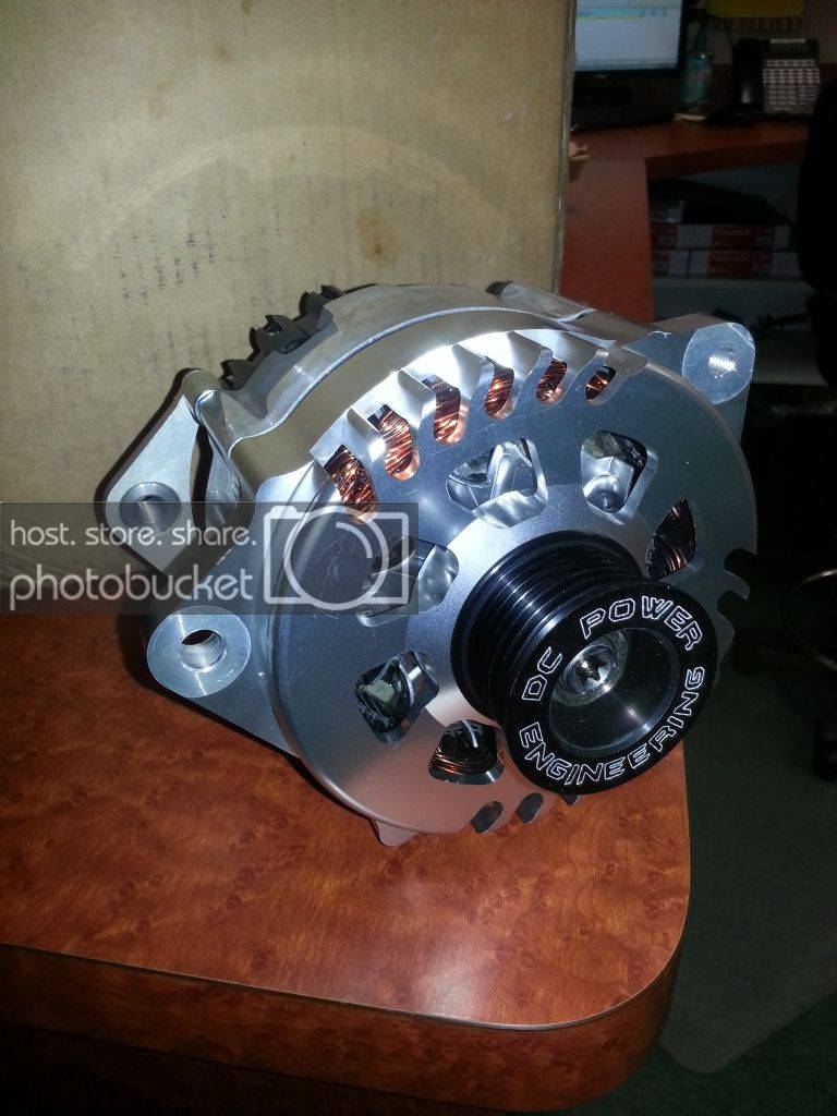

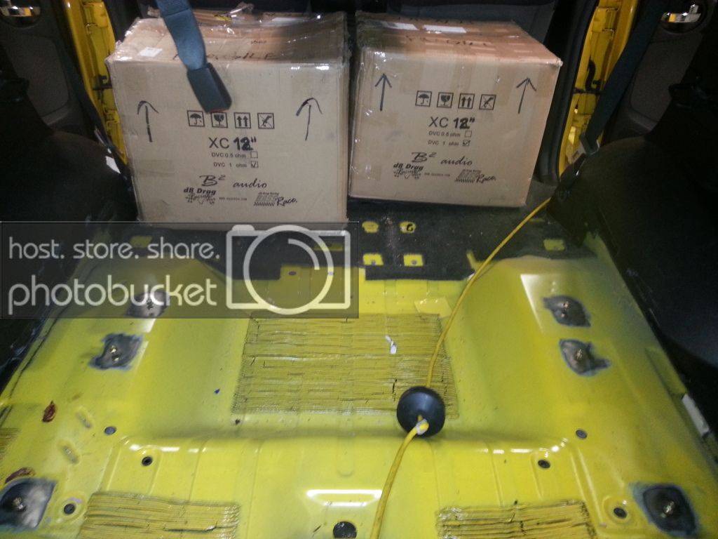

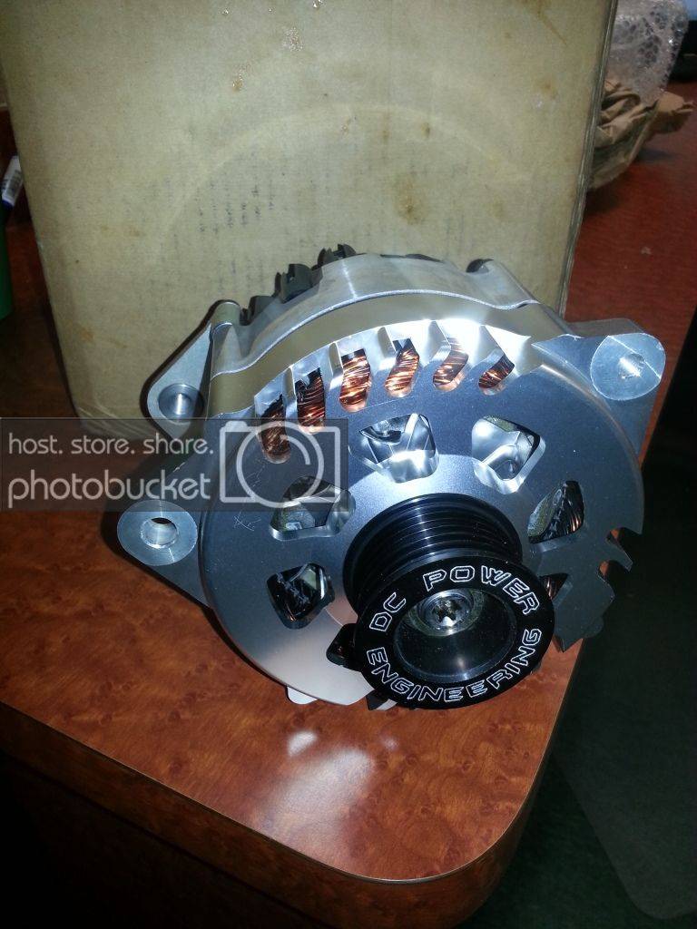

So far the plan is wall it off with 4-15" Tantric SHD's tuned to peak at 47hz (my street beat frequency) powered by 2-B2 M12's, custom built DC Alt, a million feet of 0ga and 13 Deka 8A's.

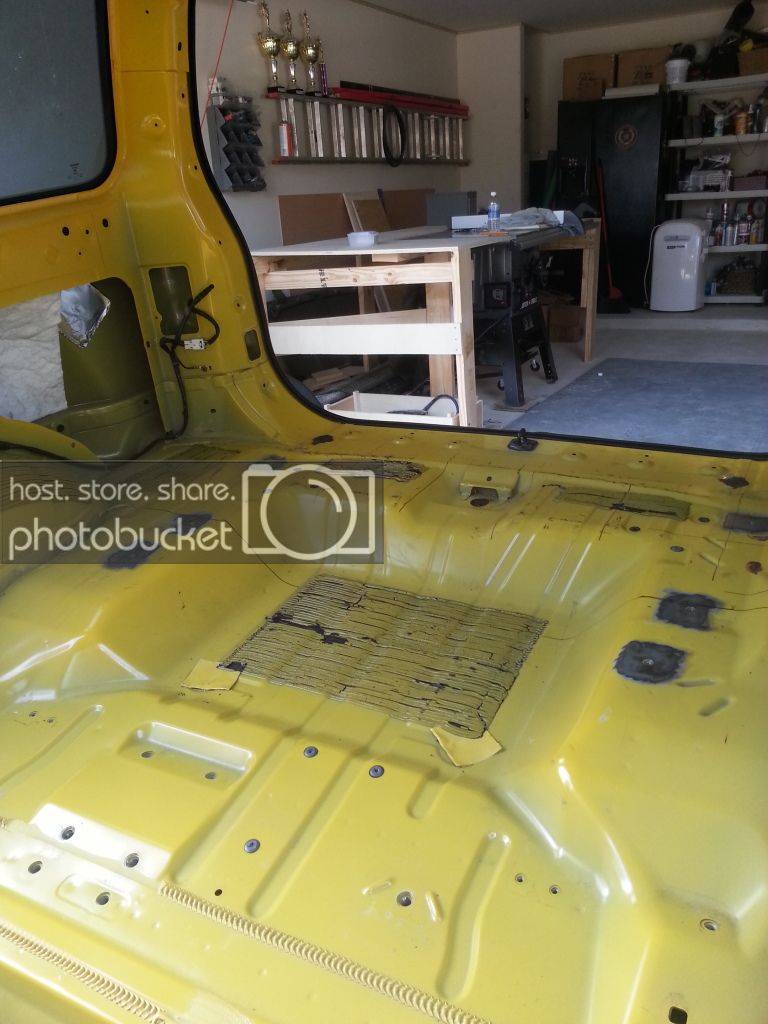

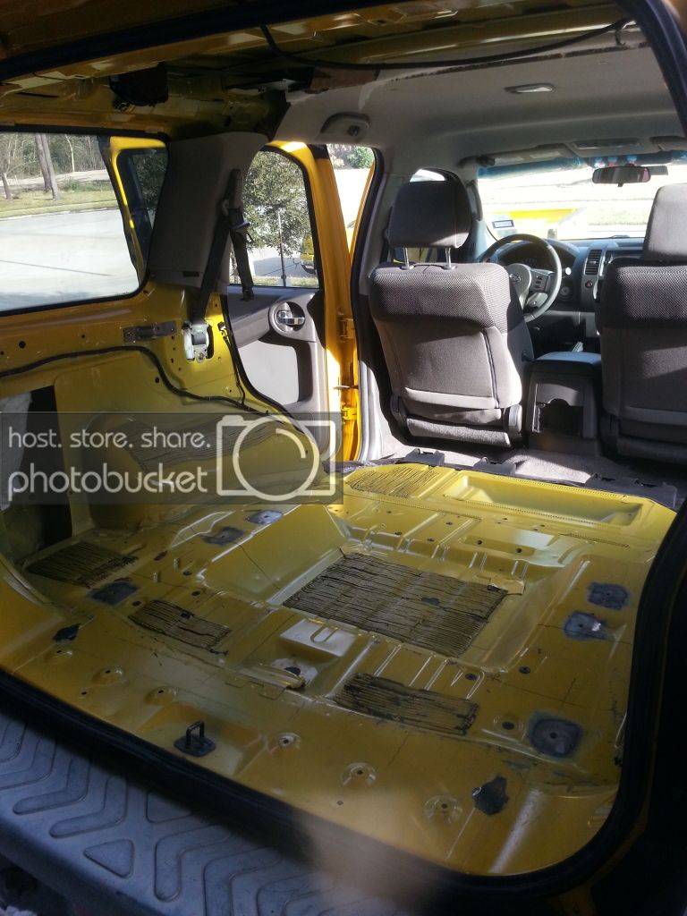

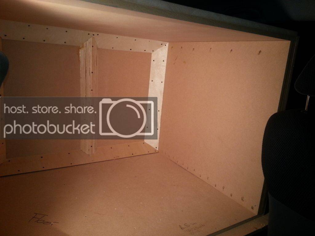

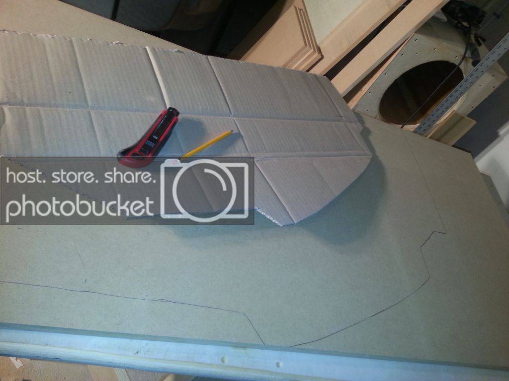

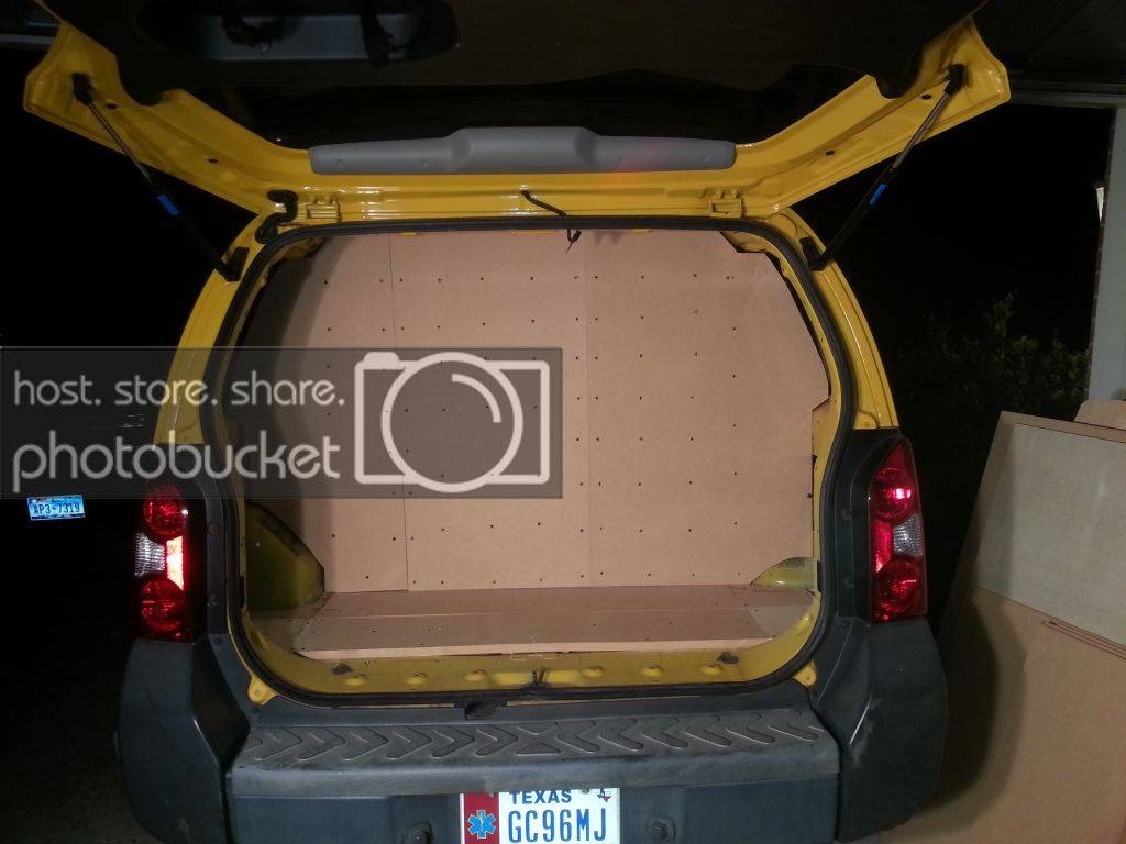

so on to the pics....Teardown

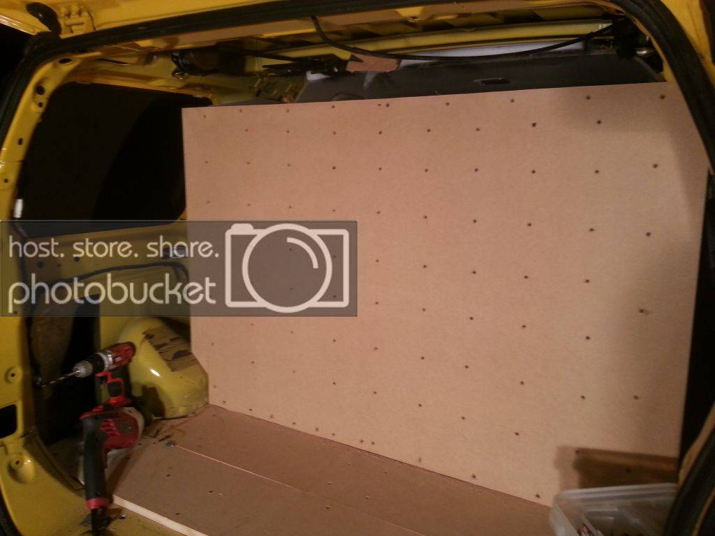

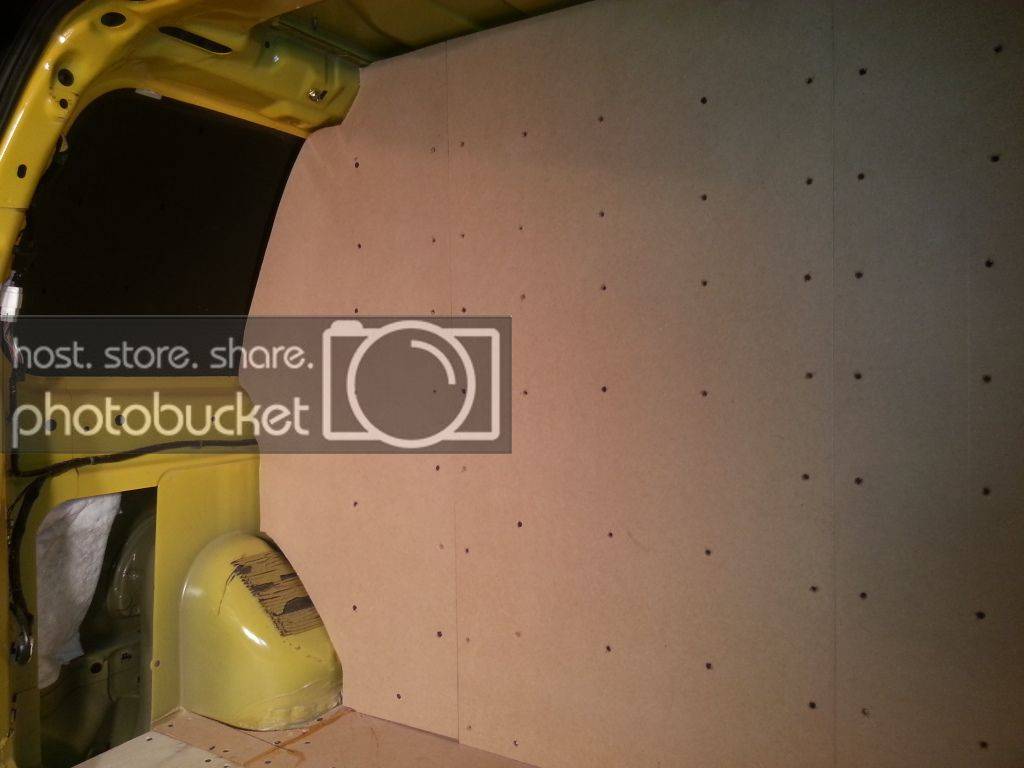

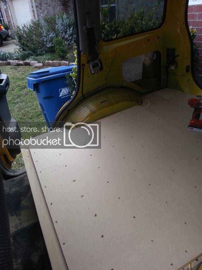

Frame work and floor....

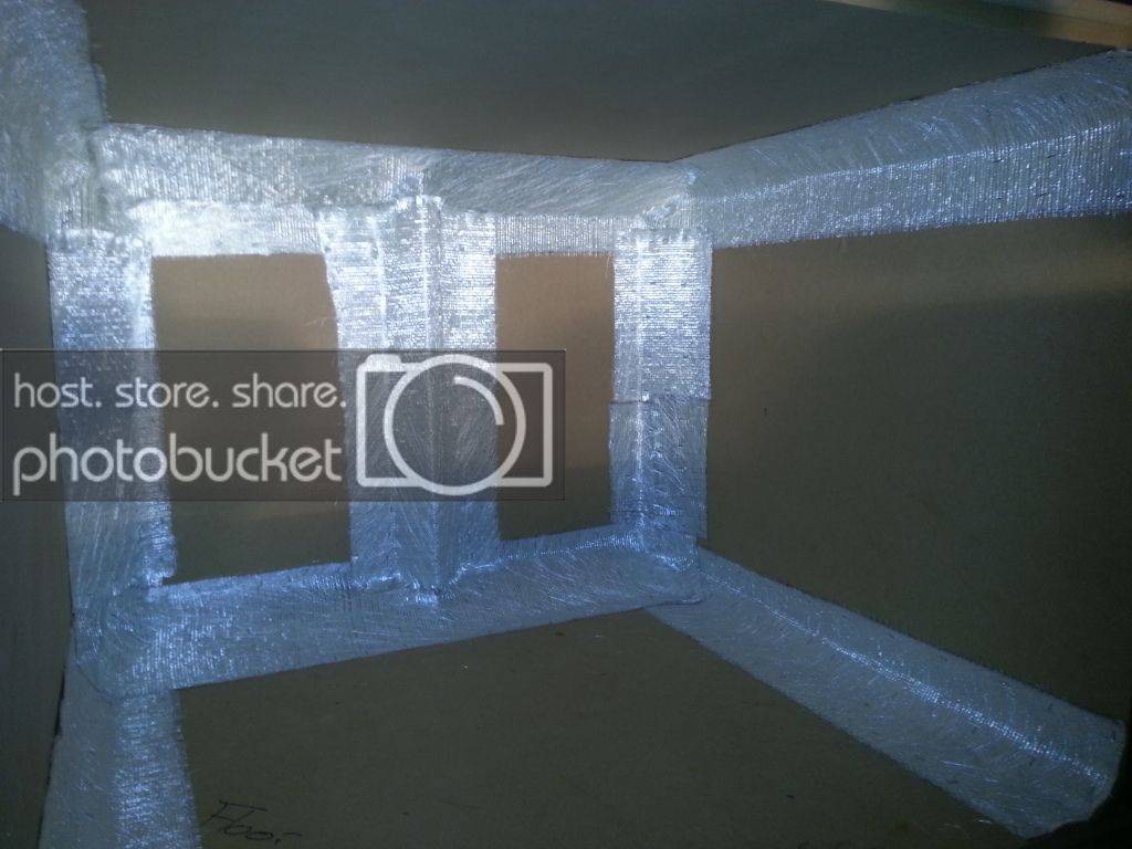

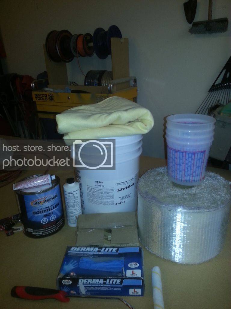

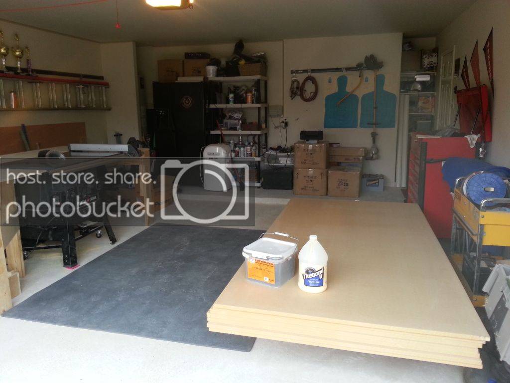

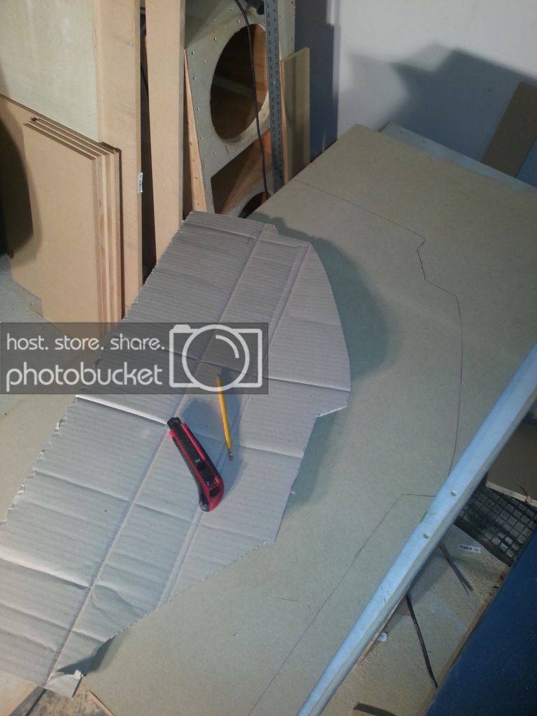

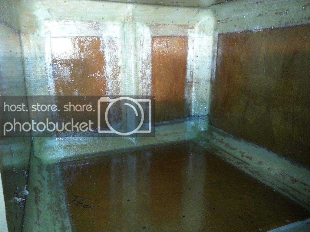

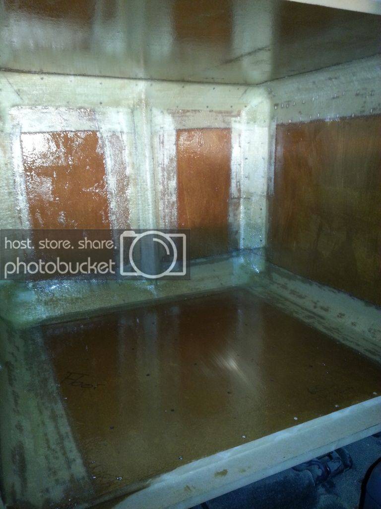

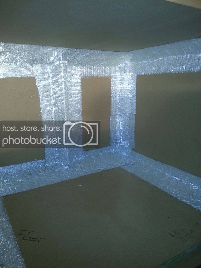

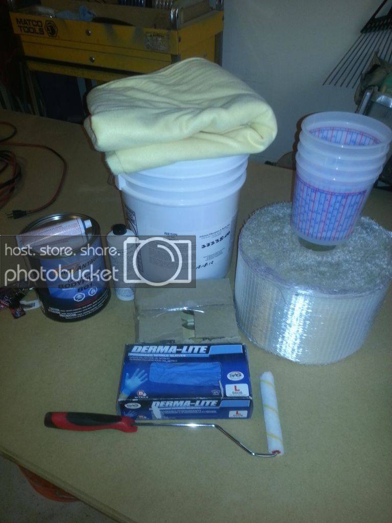

thats where im at as of now, tonight will be 2 more layersof glass and resin then comes the body filler...then sanding....then body filler....then....well you get the idea. lol aiming to be done by january 25th for a big show down here in houston.
yes sir but the peak in the truck with the wall is 45hz, my frequency for street beat is 47hz so i tuned the box @ 43hz so i should be pretty darn good.
Makes sense now. Tuned in for results, thinking about trying my first wall this spring/summer.
almost 16 cubes after displacement, thanks for all the comments guys. I won't bore you with more pics off the second and third layer of glass that went on tonight, tomorrow night is body filler followed by lots of sanding! pics of that tomorrow. thanks for tuning in!
