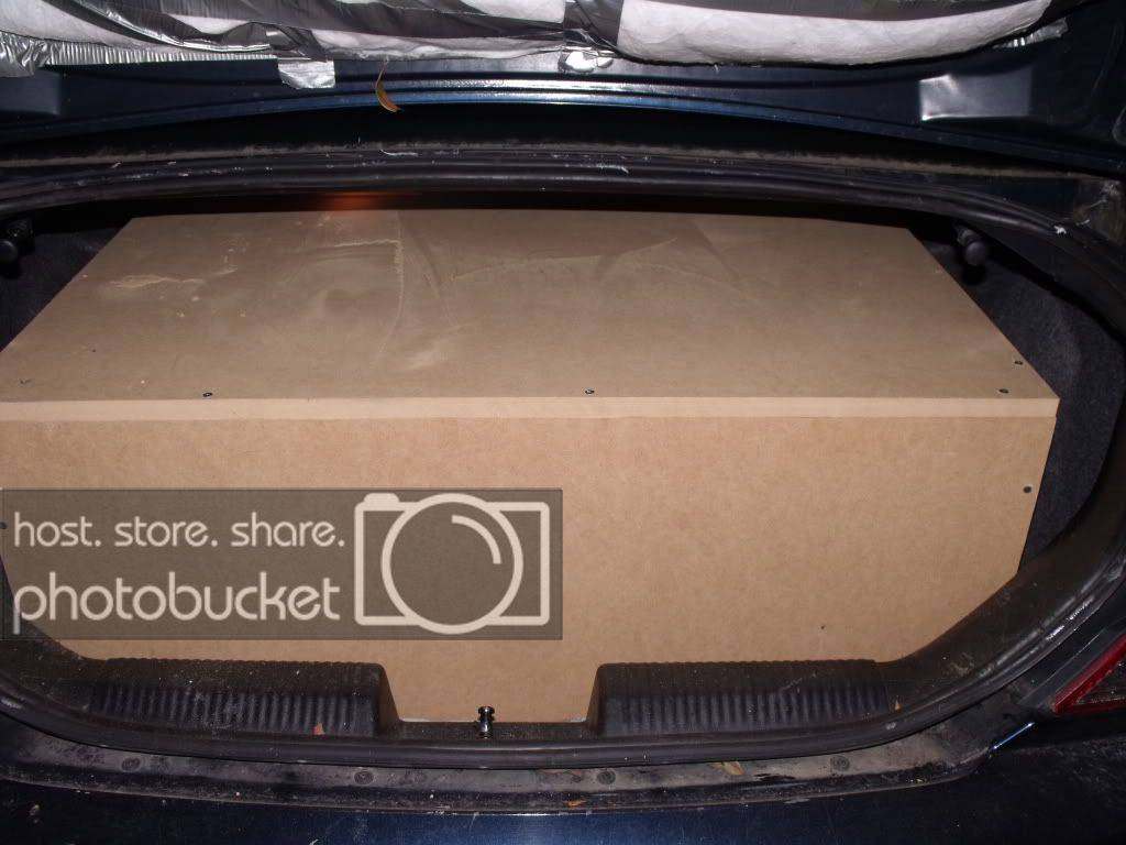

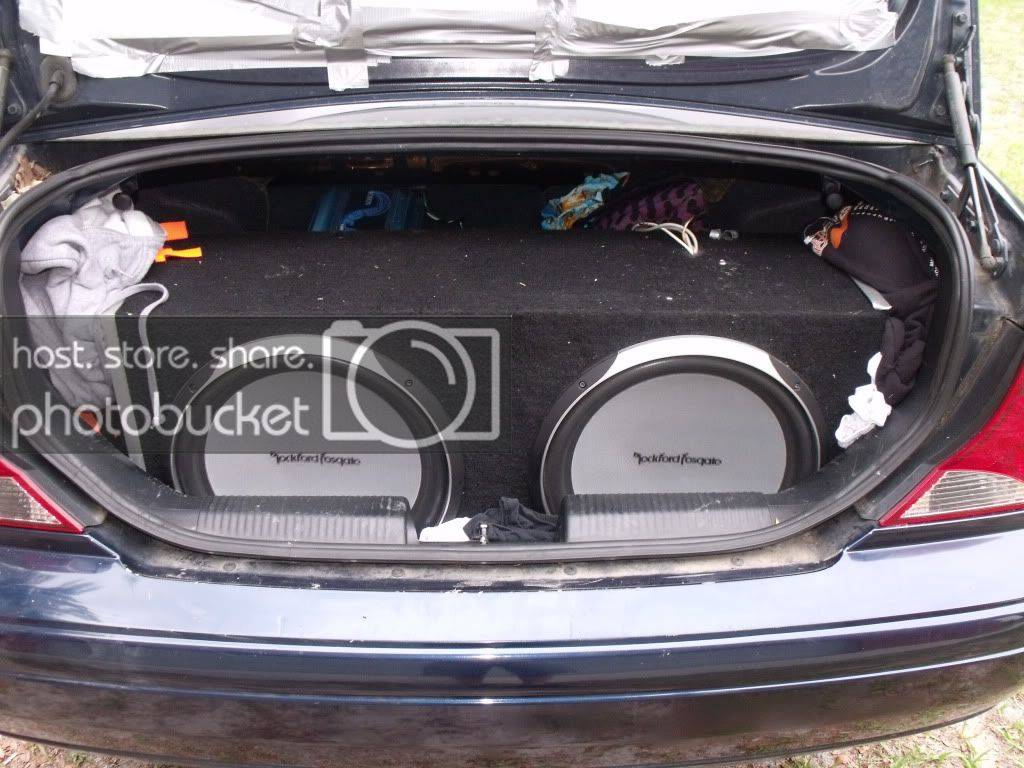

Well like many people my budget is almost none, I am young, 17 and i intend to get the best out of what i have. That said, enjoy, critique, and help.
The car...
03 Ford focus sedan
Same subs old box
Sub before these the type x on right
Subs before that

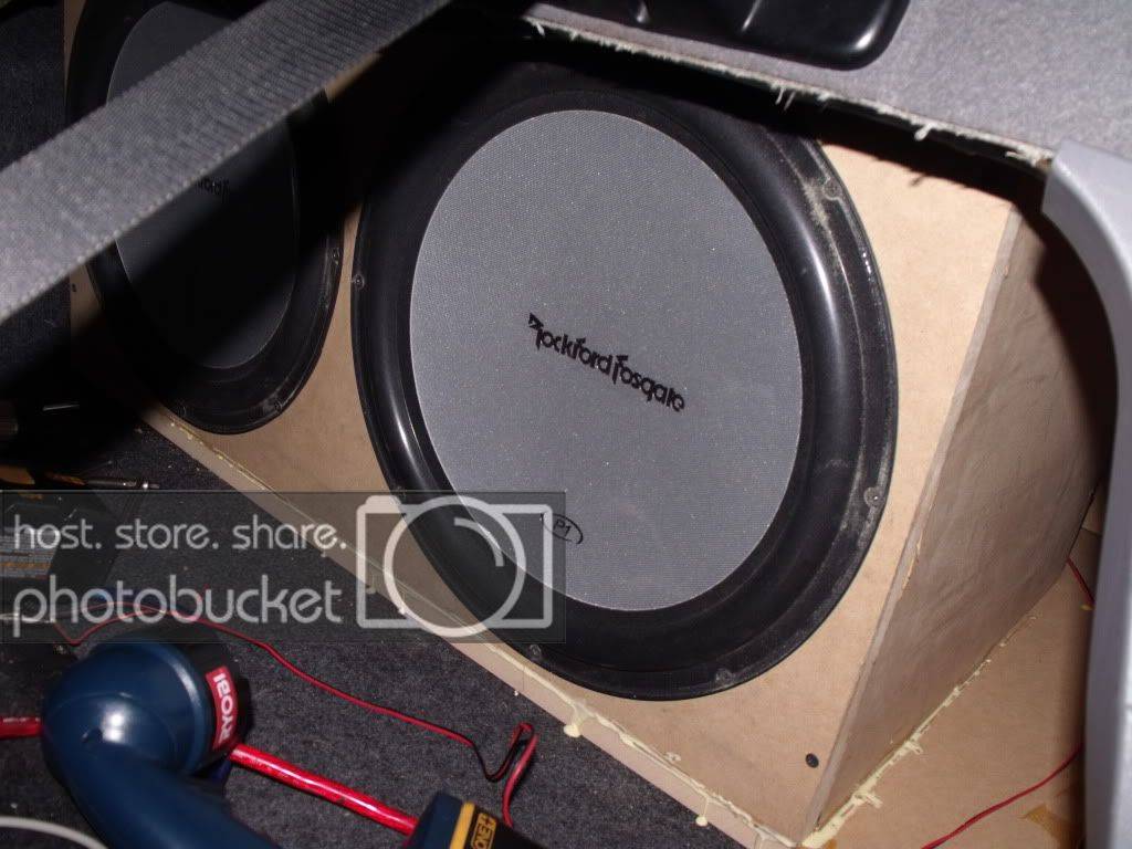

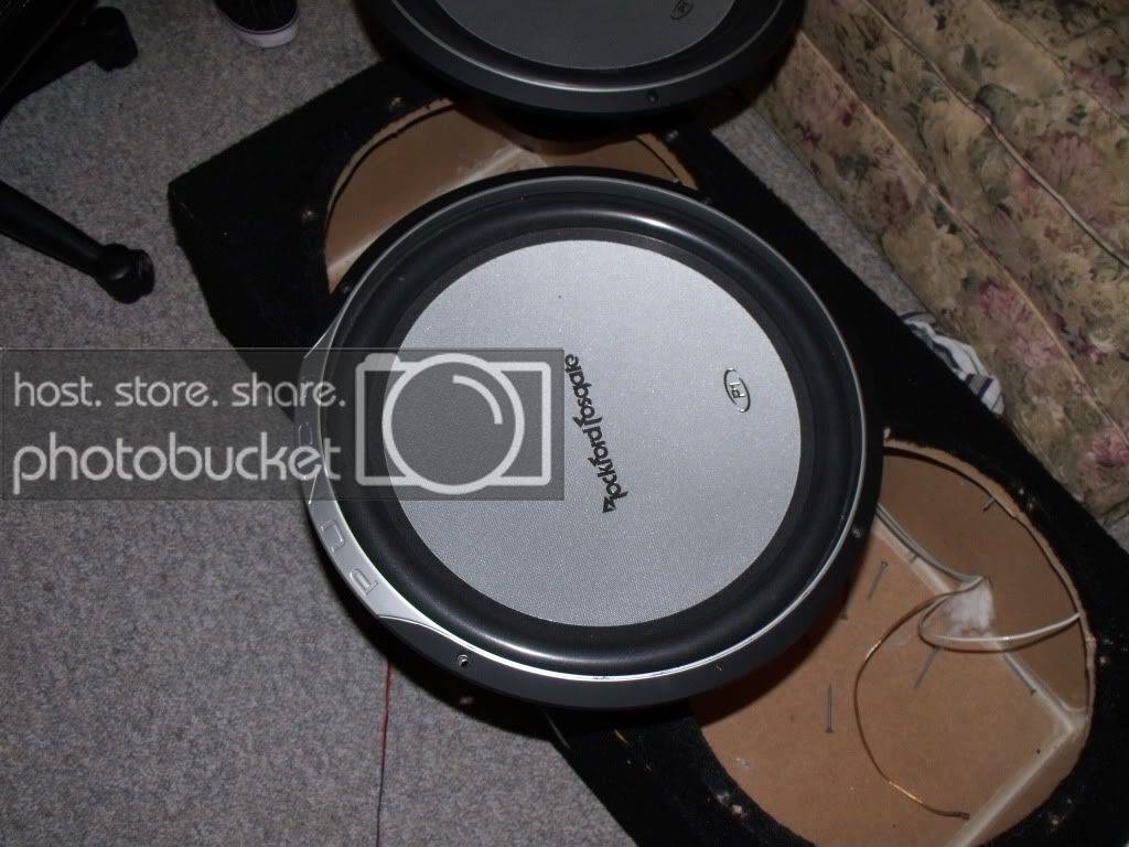

first sub in first box i built
first sub in prefab
Equipment going into/already in the car

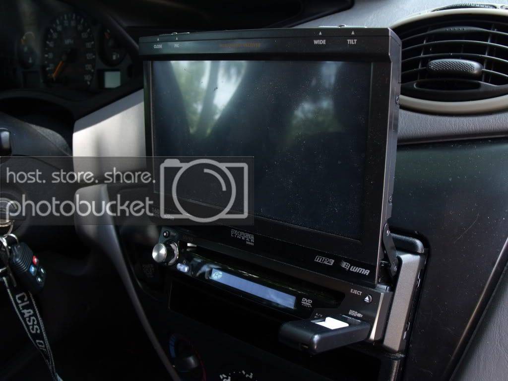

Headunit- phase linear/jensen uv10
Wiring/Electrical- 4 gauge back to amp/amps 0 gauge for big 3 possible new battery

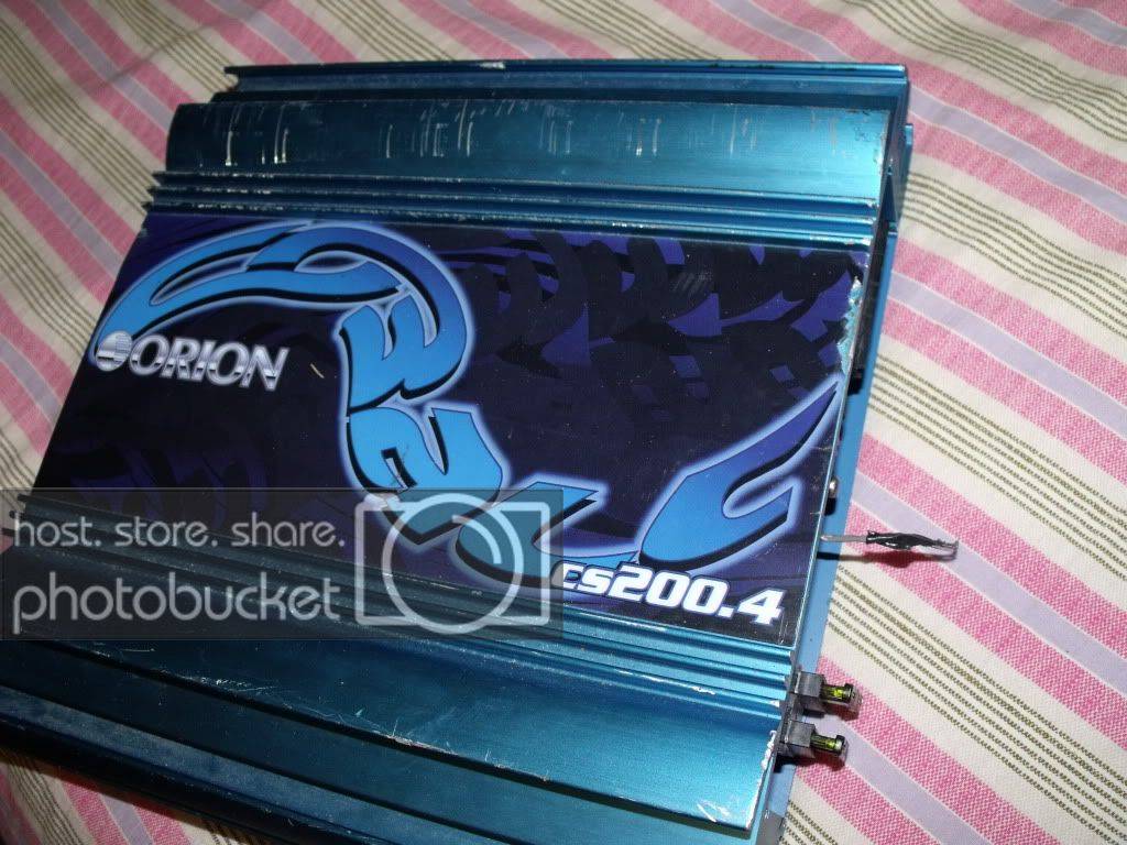

Amps- Orion cobalt 200.4 (will run subs until i get the second amp) Older alpine V12 four channel will run subs once i get it

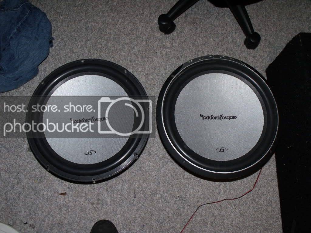

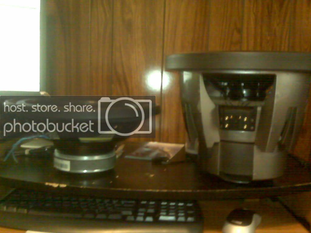

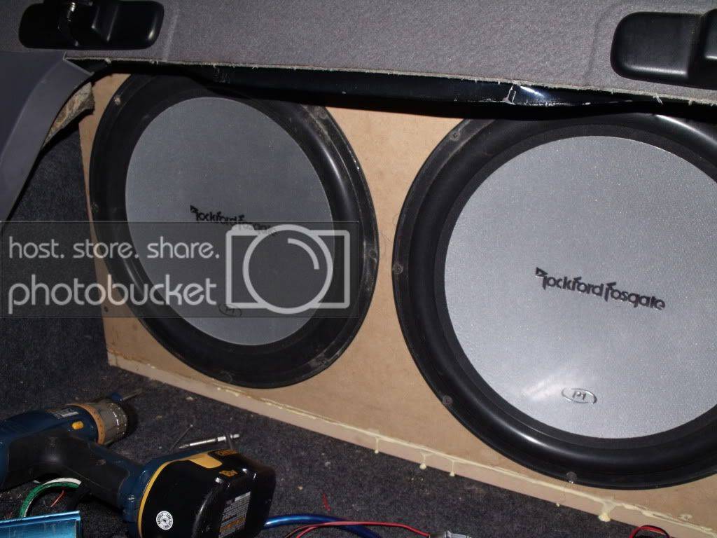

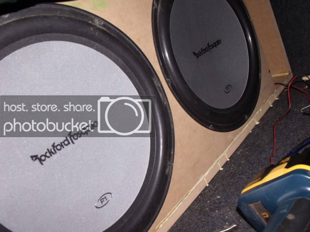

Subs- 2x Rf p1 15s s4 vc

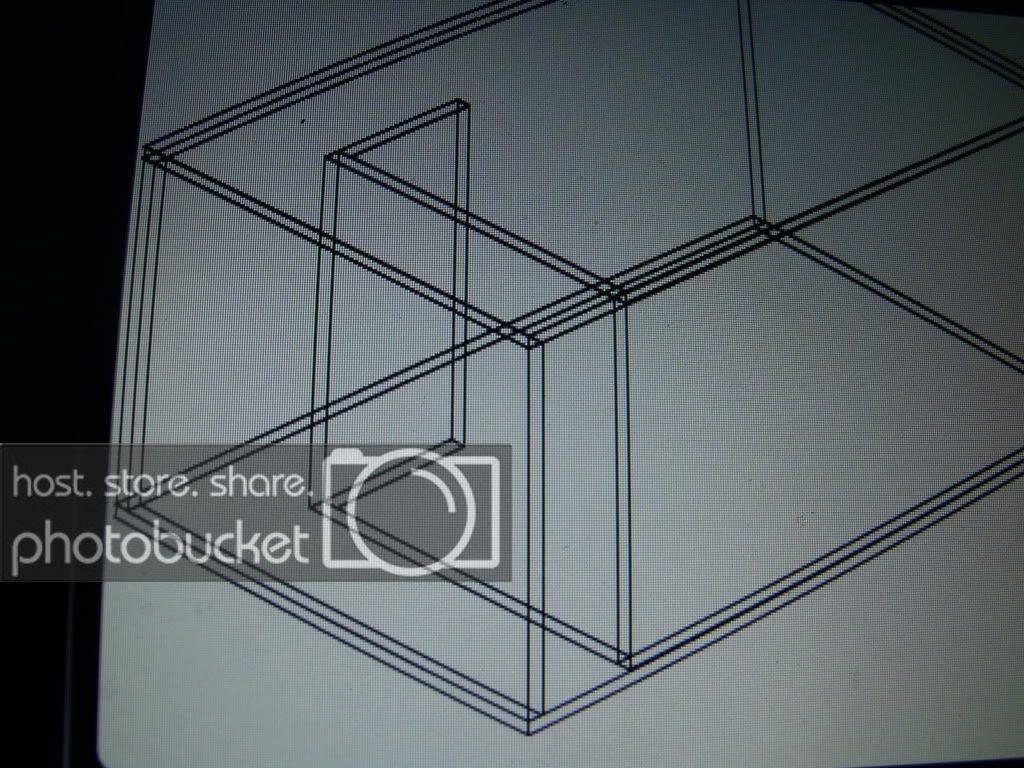

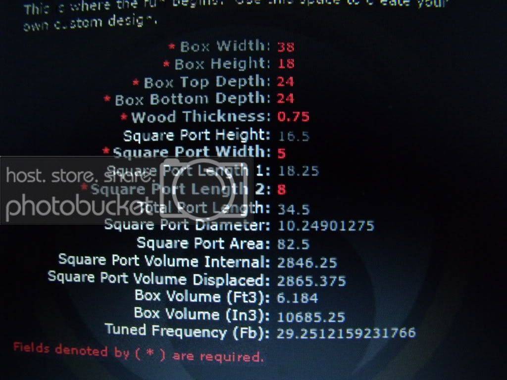

Box- about 6 cubes tuned to 29hz
Highs/Mids- No clue yet i do have some boston 2 inch computer speakers being used for highs tho

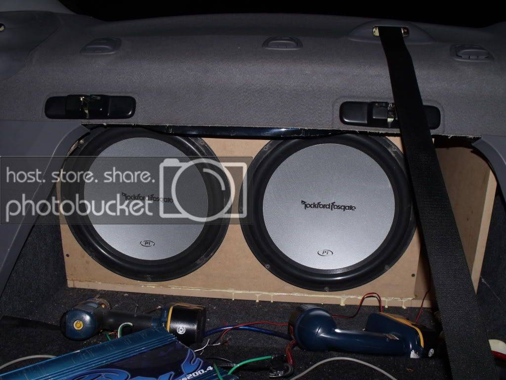

well its not super loud, but i gets low and i dont have any trunk rattle because subs are fired forward and the trunk is sealed off, its about as loud as before but remember im still only on half the reccomended power and its not super clean power... i would imagine if i throw 500 clean watts at it it'll slam pretty good

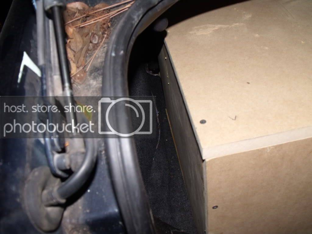

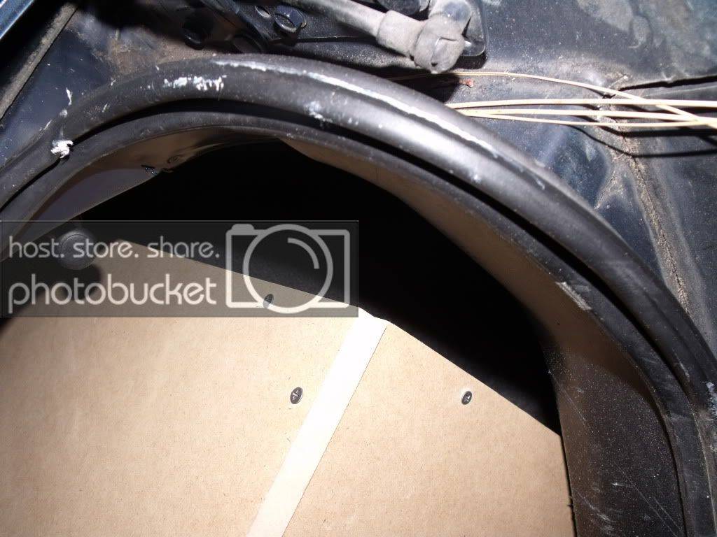

hmm....a 4 channel powering subs? you need to save up and get a class d mono amp. and yes that is some THIN speaker wire. I see that causing problems before long. also what was the point of the screws showing on the prefab box? doesnt make much since.
this but nice setup for low budget
