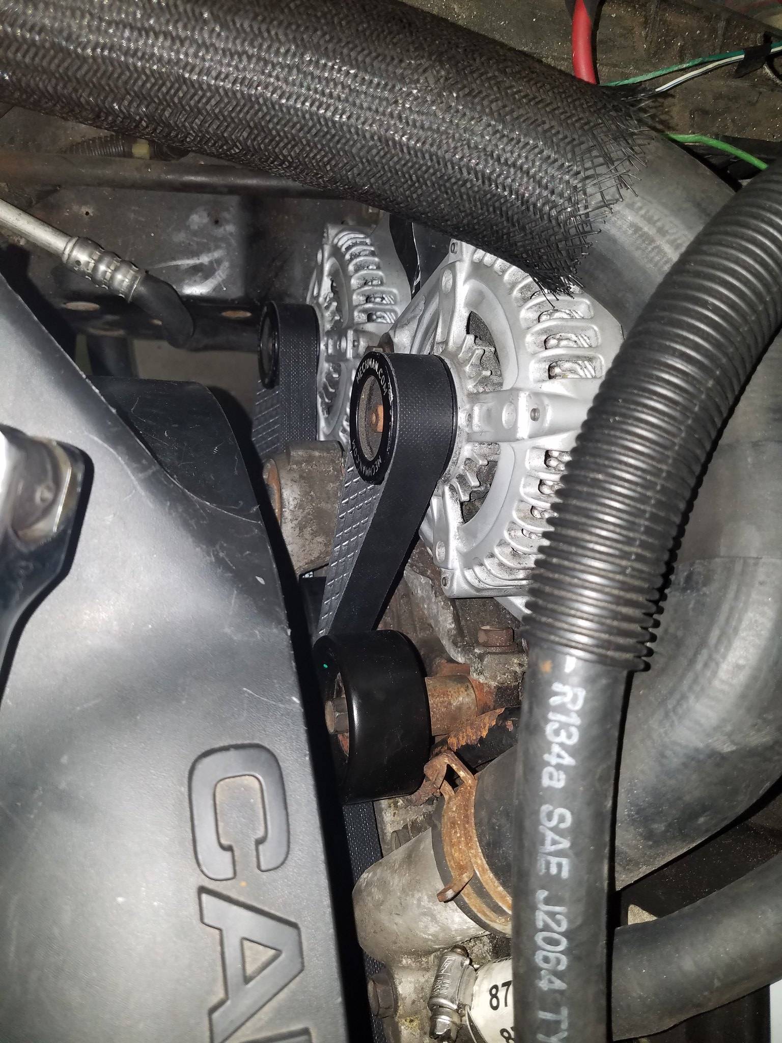

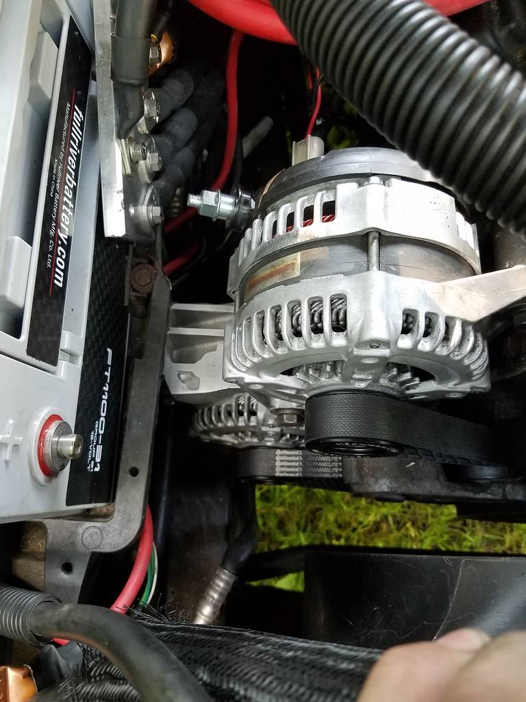

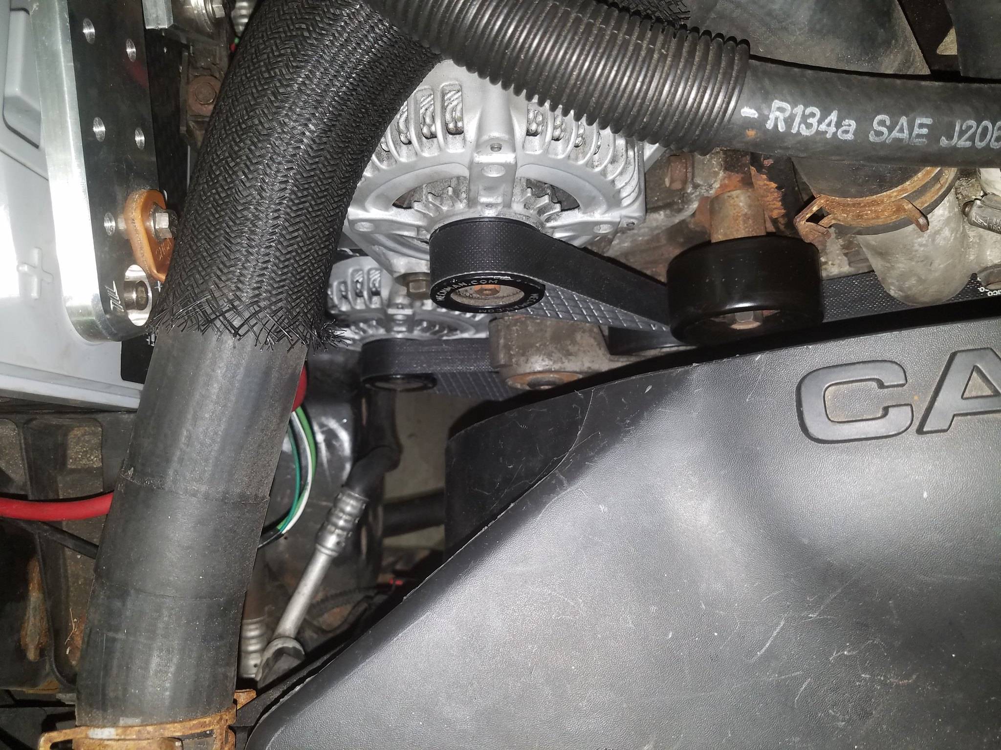

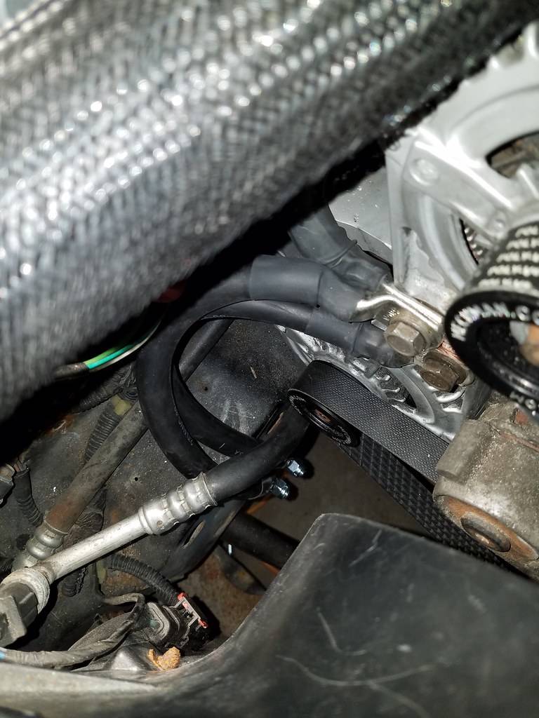

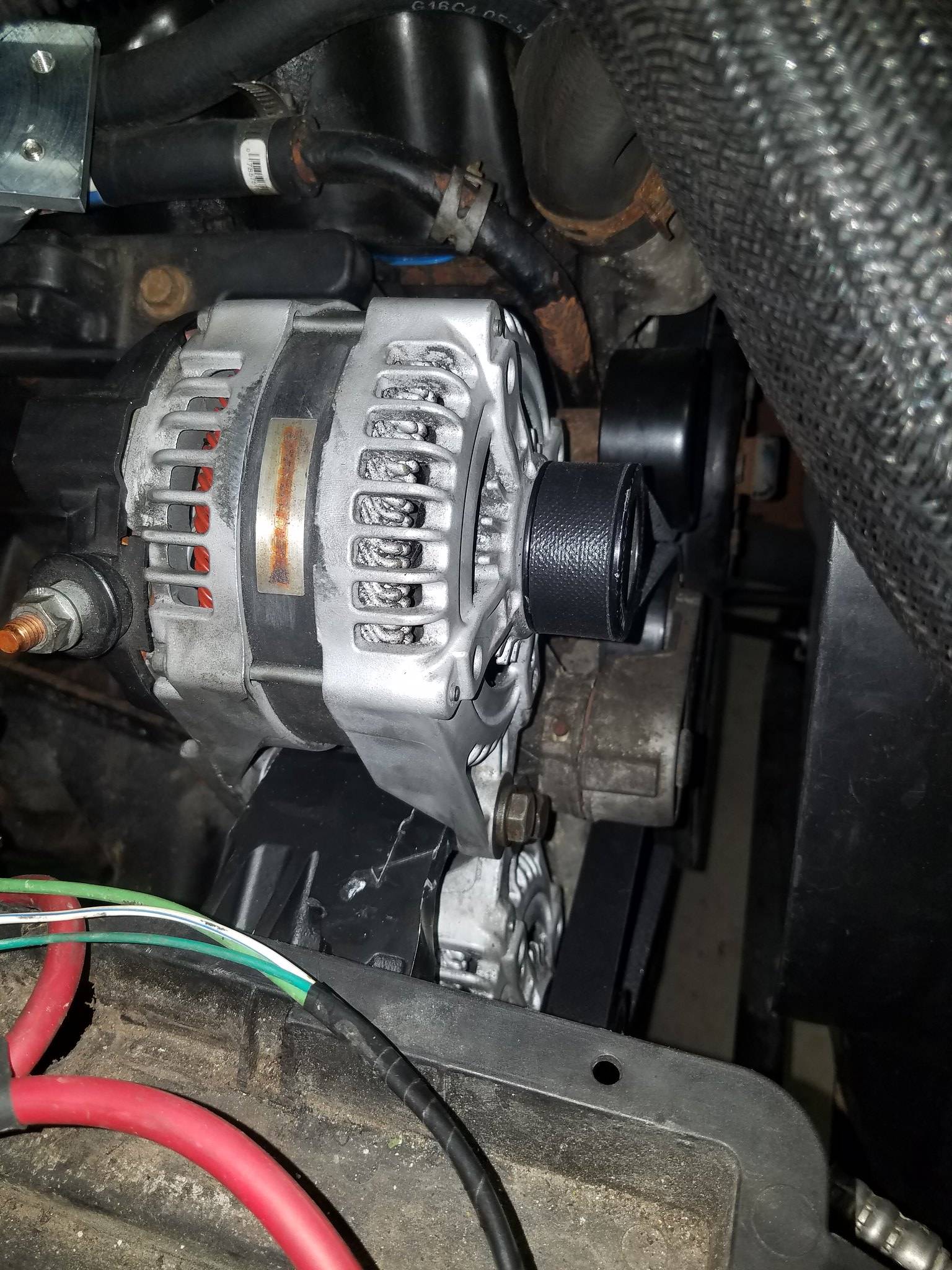

The dual alt setup is on I haven't wired up the transpo or anything but I did hook up the factory connections to test that everything would spin. All I needed was a slightly smaller idler pulley and a slightly longer belt as I bypassed my AC. I ordered a belt that was too long the first time but the second one I ordered fit like a glove. For anyone wanting to do what I did the parts I purchased were a Continental Elite 4060887 and a Dayco 89175.

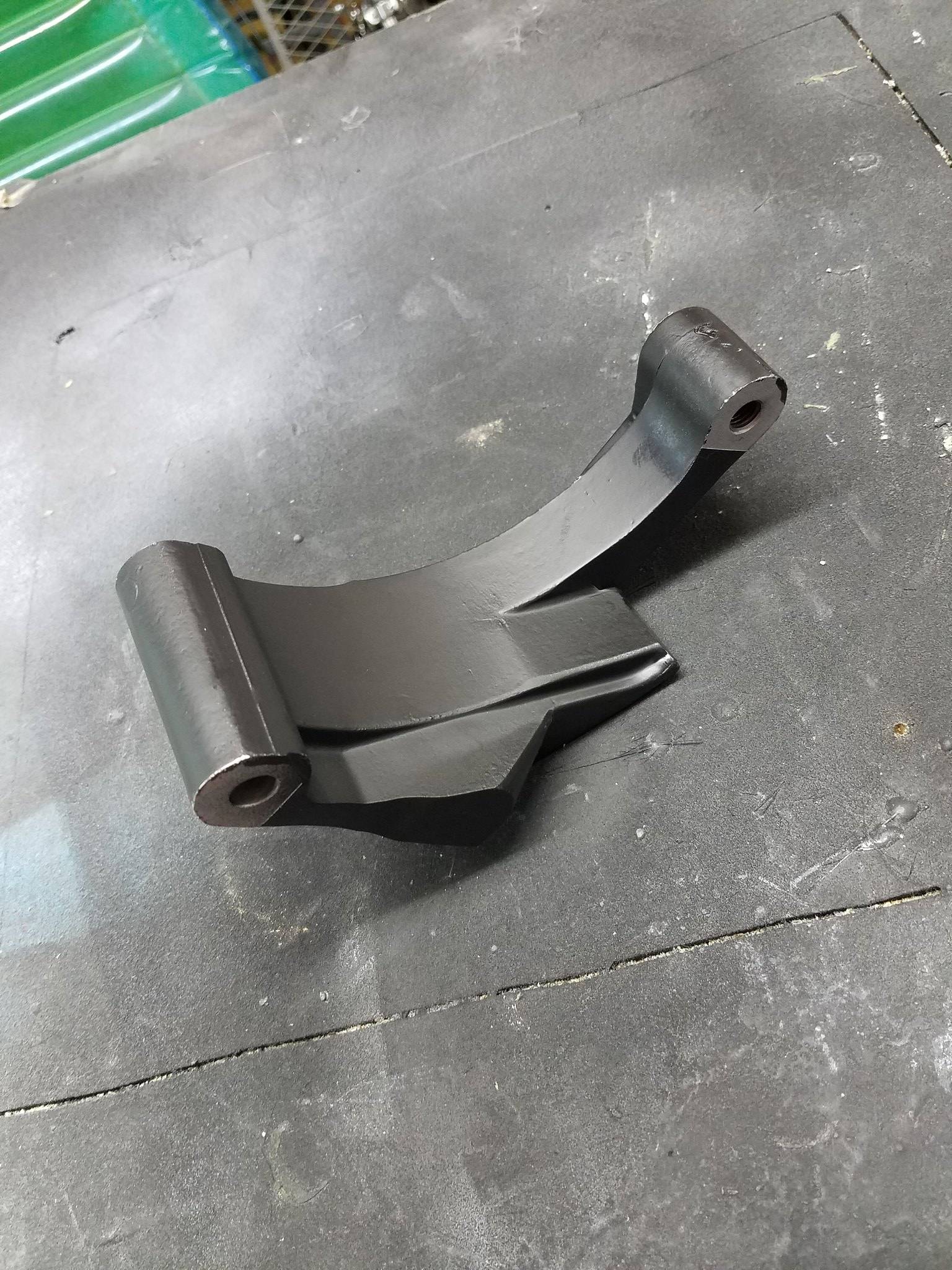

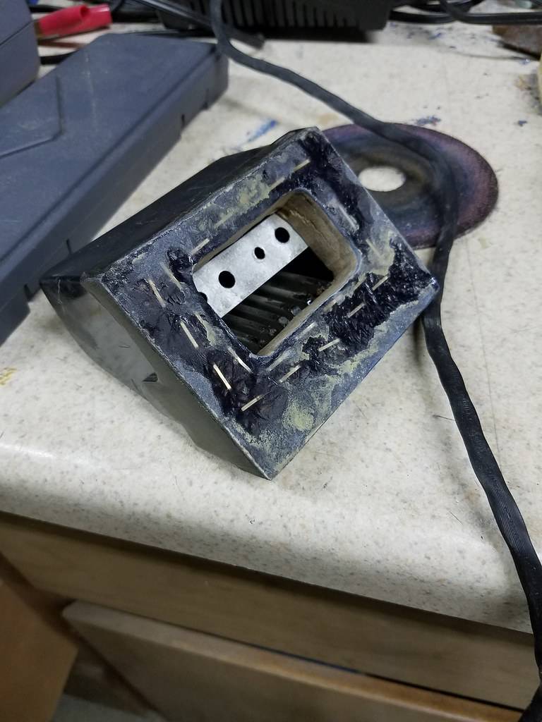

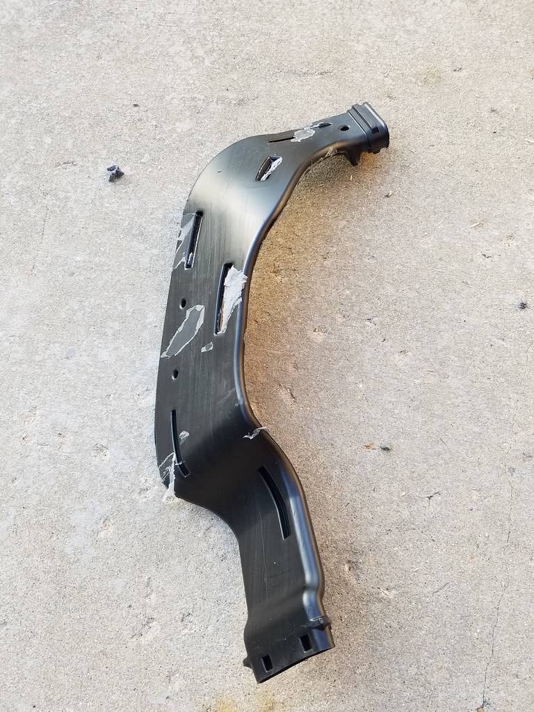

So if you guys remember correctly I bought a used stock alt bracket and was going to use it to locate an alt where my AC was. Well I scrapped that idea as it was going to be a pita but I did still use the bracket. After some heavy modifications this is what was left of it.

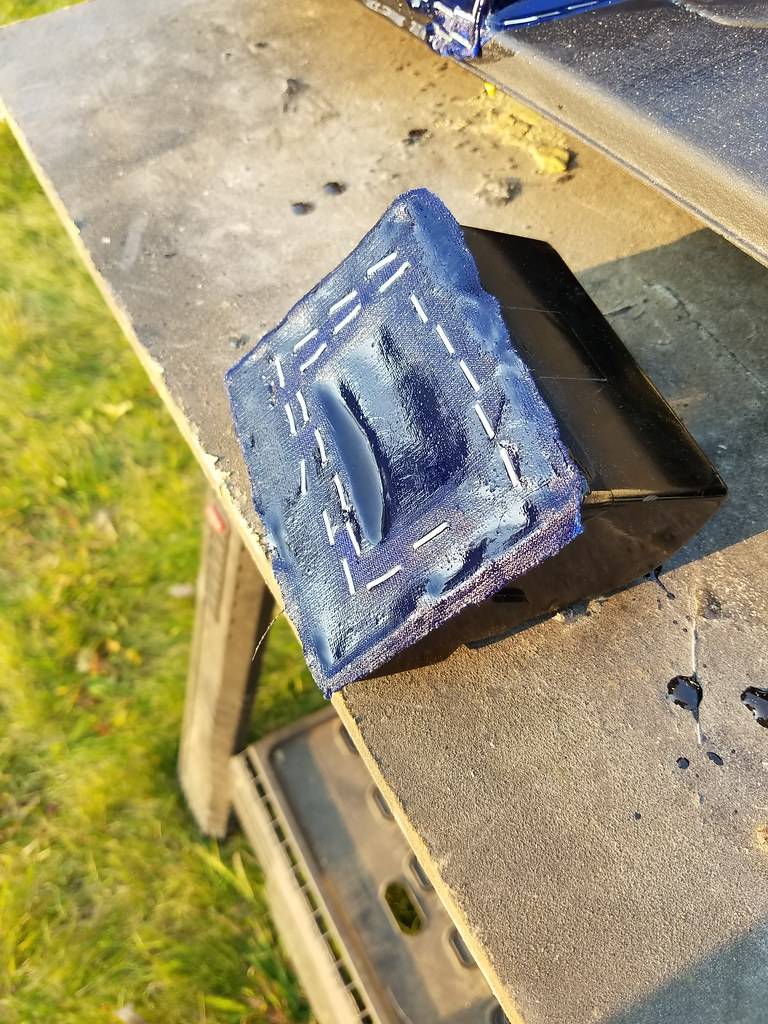

For some reason the paint didn't cure well even though it sat for 24 hours at least, but I wasn't going to take it back out to repaint it.
Oh also I chose to bypass the AC as it was easier and I don't really need it. Also it made it easier to guess the belt size I'd need.

Just wrap a string around the pulleys and measure how long it is it get the correct belt size. Then there is no guessing

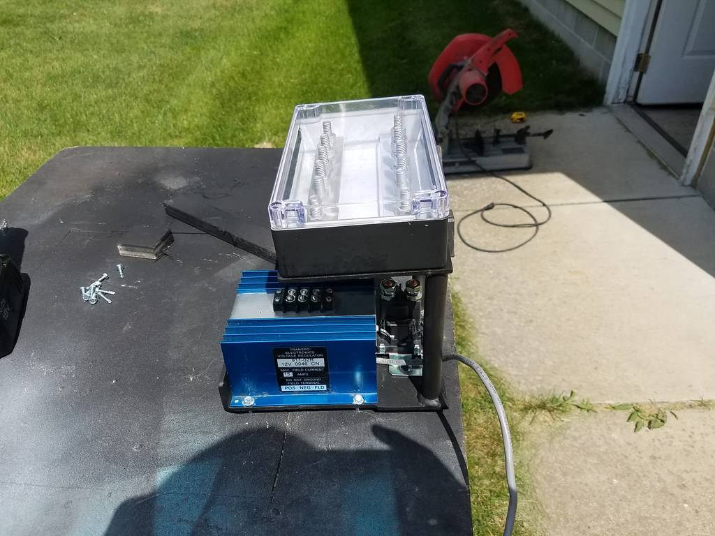

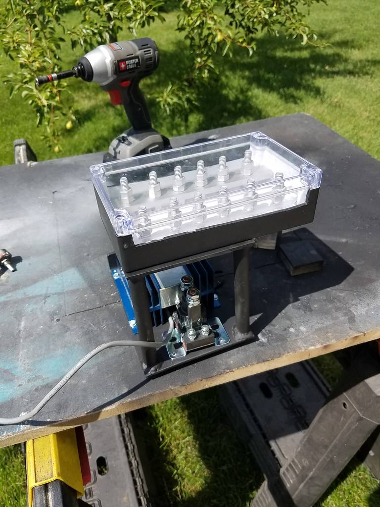

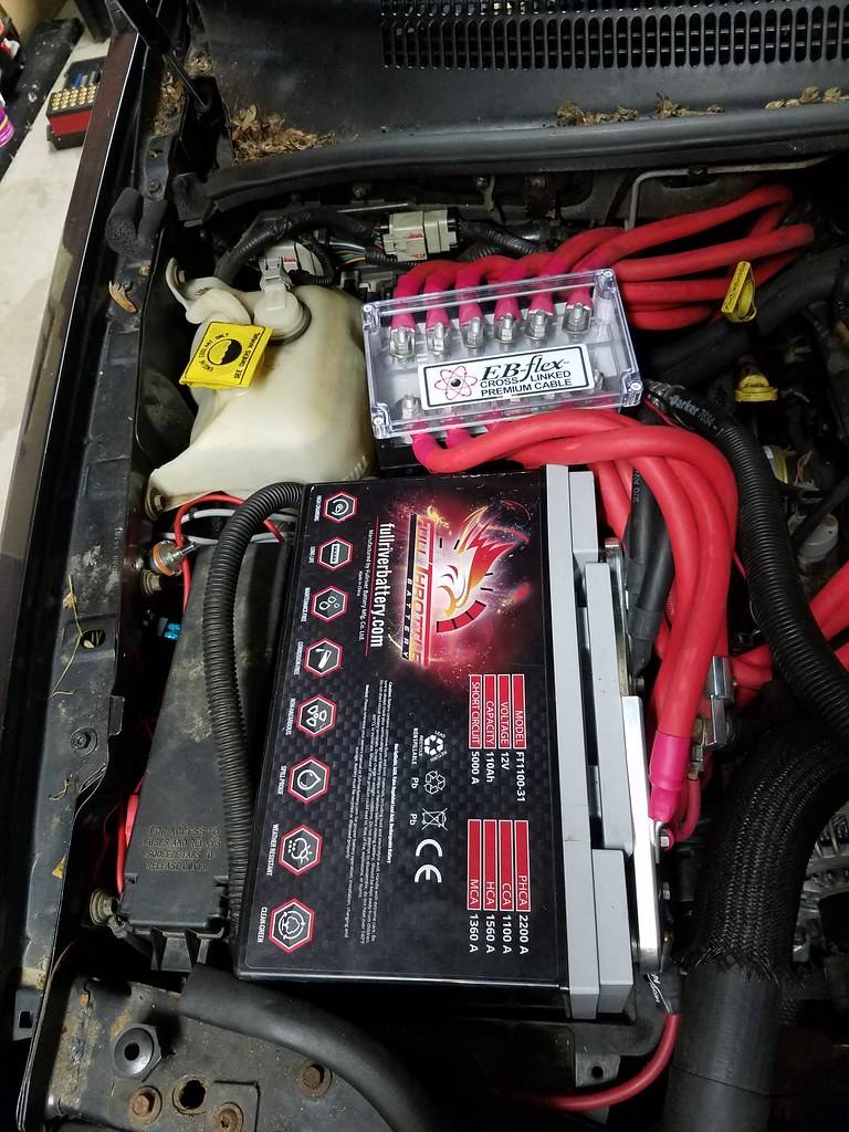

So the jeep has been pretty neglected for the last month, basically it comes down to not being motivated to work on it after work and doing other things on the weekends. Ive actually done a small amount the last couple of nights. However things seem to be one step forwards and ten*steps backwards. So after getting the dual alts installed I made a bracket to hold my regulator, relay and fuse holder the flimsy piece of sheet metal wasn't going to cut it. Got it wired and installed couldn't get regulator to work. Luckily it was an easy fix. Then things went downhill fast I plugged the factory alt plug into the bottom alt for temporary purposes and it started smoking. On top of that after I got it unplugged my Jeep wouldn't start it would crank and crank but not start. Luckily tonight I pulled all the fuses under the hood and found that my injector fuse was blown so the Jeep runs again I got super lucky there. However my bottom alt is now not charging so I have to take it off and send it in to Mechman to have them look at it. Thinking I will send both of them just in case as I don't want to have any more problems. I plan to still work on the Jeep with the alts off but I probably won't be making leaps and bounds, thanks for checking in.
Also for the record I don't know if one of the alts was bad when I got them used or if something happened to it while it sat on the shelf but obviously something was wrong with it don't want to blame anyone and don't know so it is what it is, hopefully the repairs are cheap.

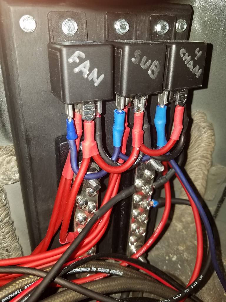

Lot of wire in a small space, basically how everything will look, needs a little tidying up but you get the idea.

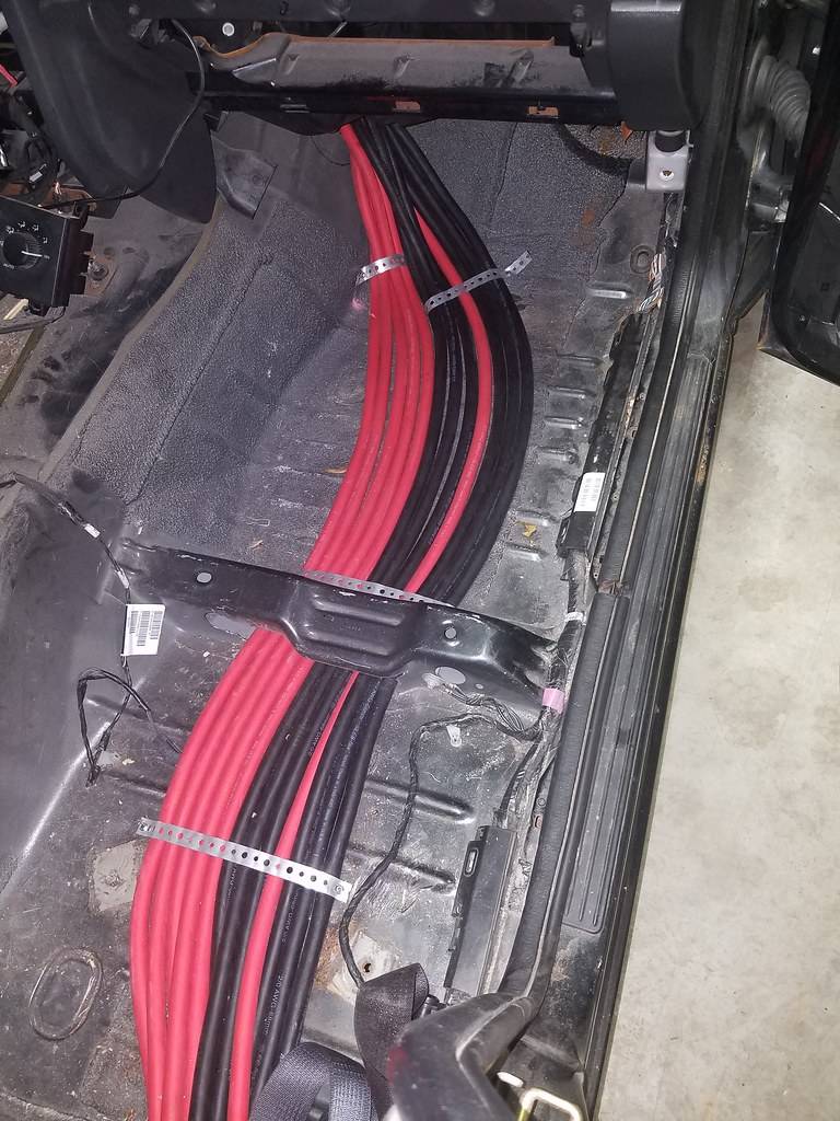

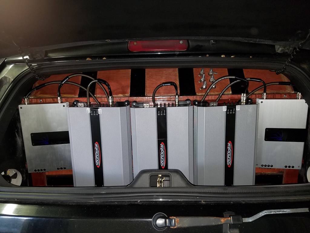

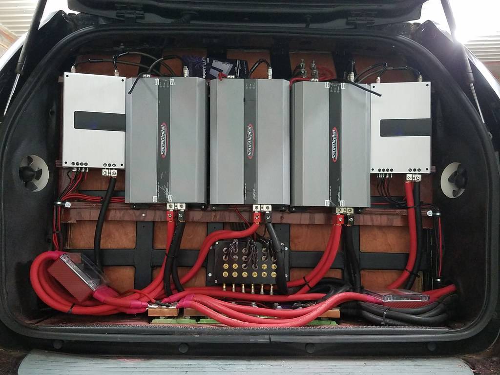

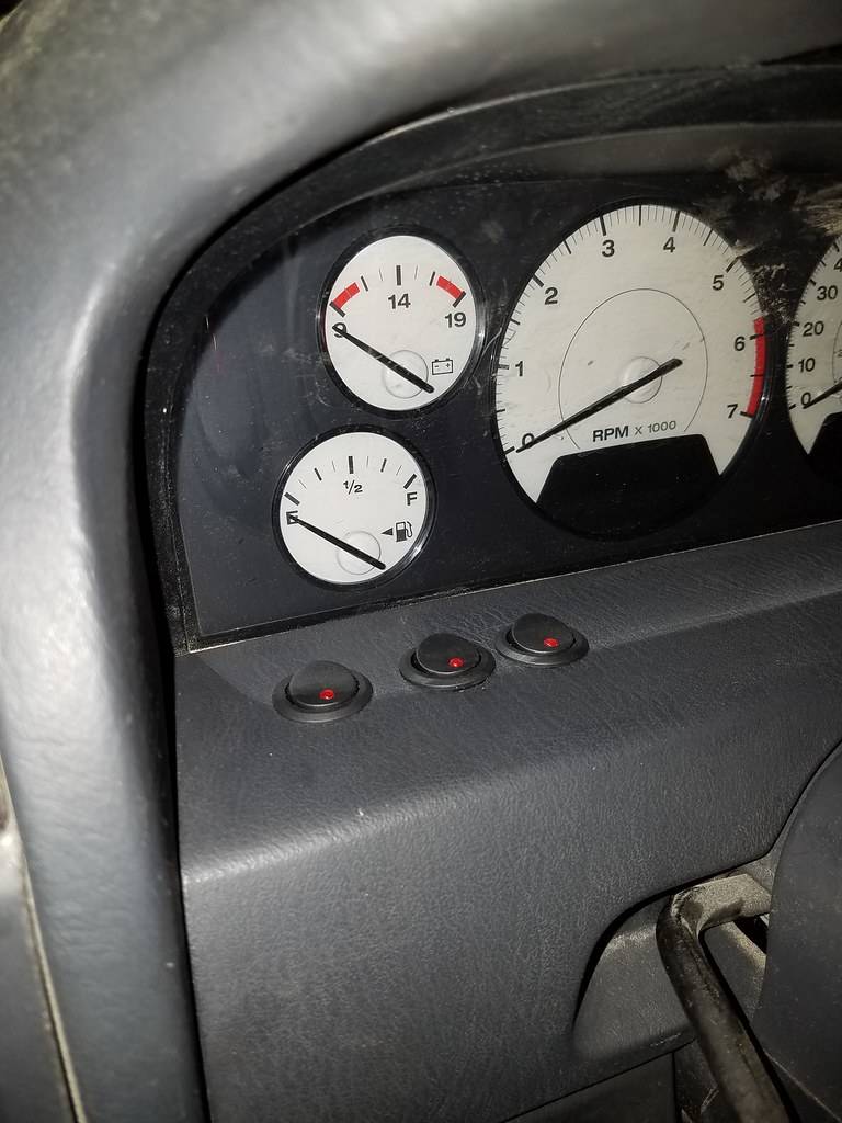

Alright so more updates made a little progress this weekend, all my 2/0 is ran and secured, relays are all wired and the fans are up and running, speaker wires and RCA's are ran, toggle switches for VC1 and volt meter are wired up, amps are mounted, alts are removed and packaged to ship back to Mechman and I think that's about it. I will say this build definitely has the most wiring out of anything I've ever dealt with. More updates soon I hope, hopefully Mechman doesn't charge too much for repairs.

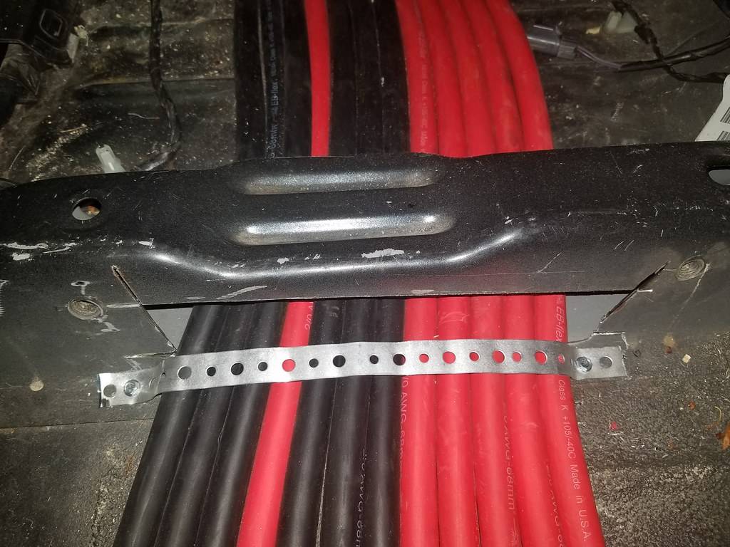

I modified the seat brace so that the wires could run through and hopefully not mess up the carpet so bad.

i really doubt you'll have any issues, and you are doing a better job of installing than i would be able to do, but might i propose that it would be a good idea to put some sort of rubber or fabric between any sharp edges of metal you might of cut and the wiring. you're putting a lot of bass in that increases vibration and i really dont want the casing to slowly get cut causing a short. if those cuts are flat you're probably fine, i just obviously didnt feel it myself

Agree...in both cases. Looks great otherwise.

You know that thought had crossed my mind and I knew just the thing to grab from work but I totally forgot about it, I really just wanted to get out of there today.

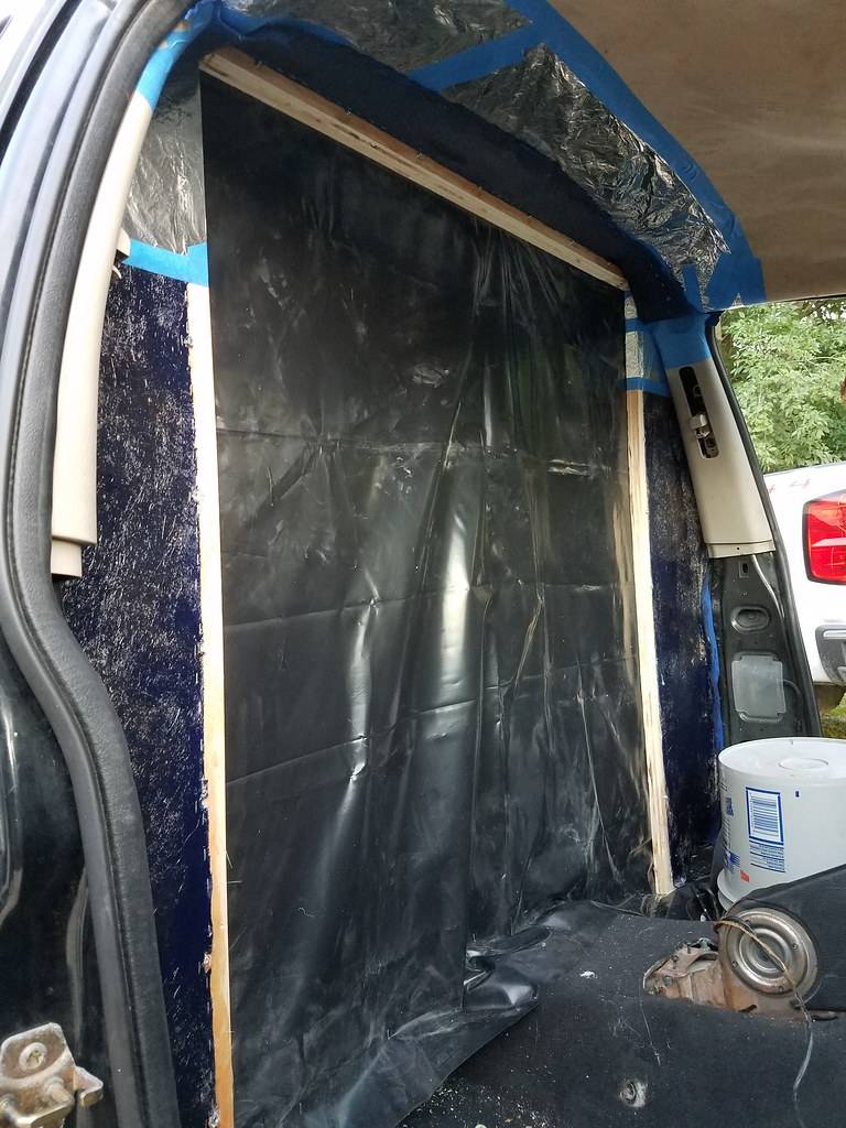

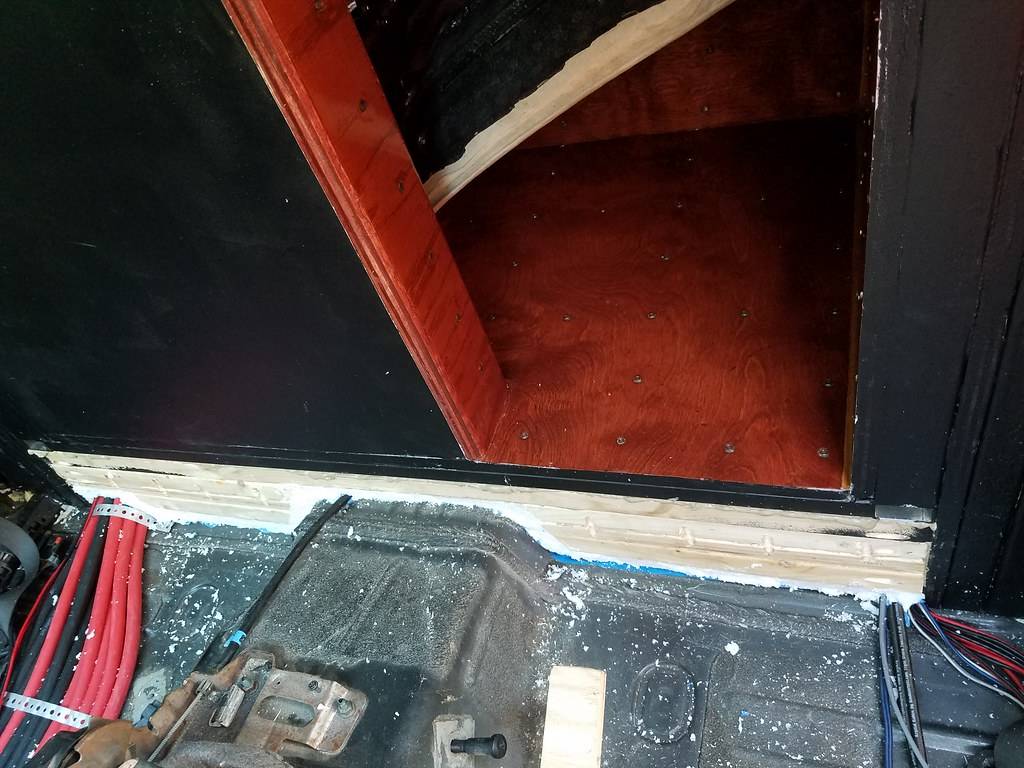

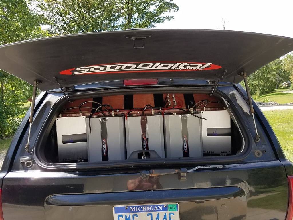

Ok so I guess it's been too long since I've updated this. Anyhow state finals was this last weekend and I didn't make it lol, surprise surprise. So lets see I got my alts back from mechman really fast it was like two days and they were on their way back I think it was $280 for repairs. I had the bracket sand blasted as the paint looked like crap so I think it looks better now at least in my opinion. I also built out the bottom of the wall and sealed it off with loctite foam. Cut the vent out of the floor that takes heat to the rear to cut down from the bulge caused by wiring and trimmed the carped to fit. Wired up almost every amp I just need like 10 feet of Red Electron Beam 2/0 to finish, somehow I have plenty of black left but no red.*To be honest I think my wiring looks pretty good considering 2/0 isn't the worlds most flexible stuff.*So making wooden trim panels has never been my strong suit but luckily it's just for looks not for sealing. Started on trim fiberglass beauty panels, last Saturday I got resin in my eye so I haven't done anything since then today was the first day I could actually see well enough to go back to work so from now on WEAR SAFETY GLASSES.*

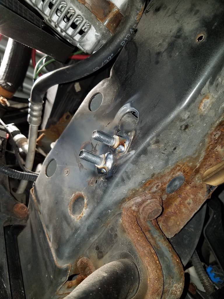

Welded on some bolts for frame grounds as there wasn't any good ones.
Attached wires to said bolts to do the big 3 or whatever.

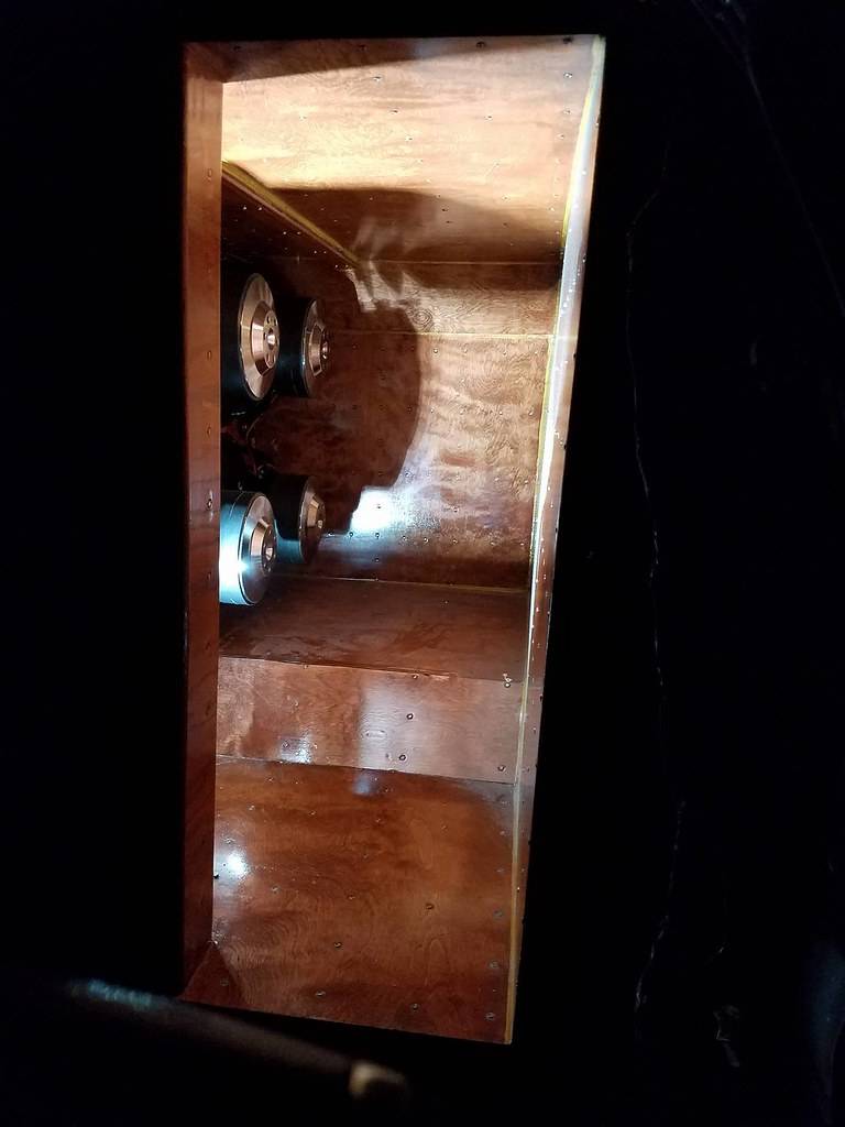

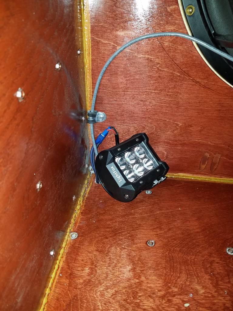

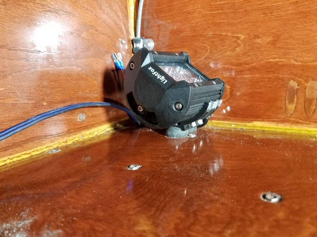

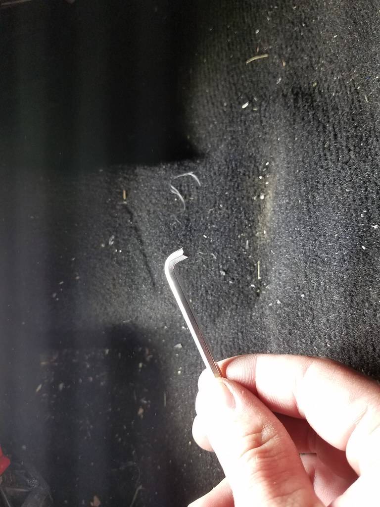

Also I think I said my build wouldn't be pretty or have any lights but I guess I lied, I wanted to show off the *** inside my enclosure. I didn't want to do LED strips so I got cubes. It was only $13 for the pair and if the first one fails I have a spare I had to modify the bracket and the Allen wrench to get the cube to mount in my application but at least I got it in there. I tried pointing it at the back of the box first and I wasn't happy with the output so I re aimed it at a 45 degree angle or so. Overall I'm happy with the output. If you don't like the light that's fine, I think it looks better in person for the record.
