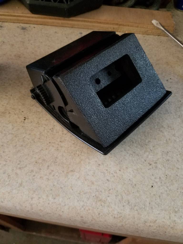

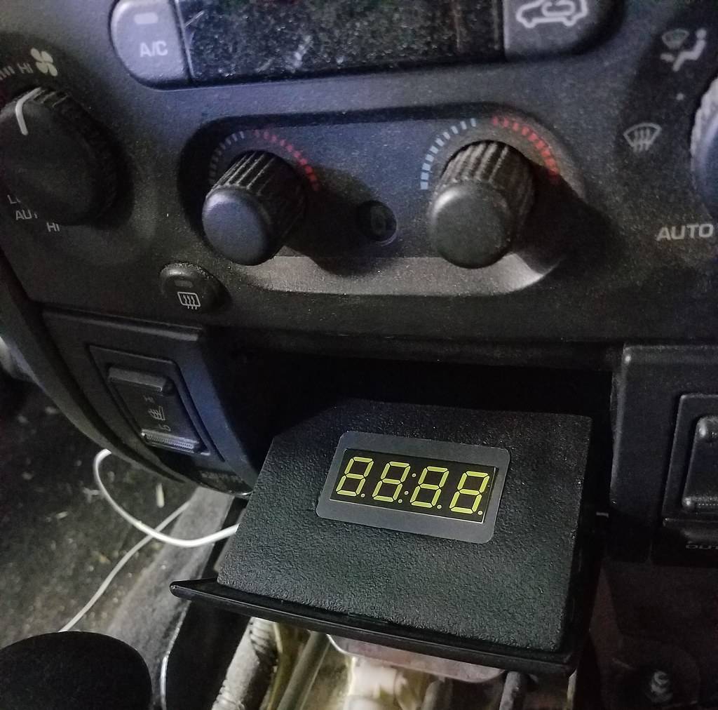

Well I'm still working on the doors I can only do so much sanding before I get sick of it, I did get my VC1 holder done I think it turned out great. Tried to capture a picture of it lit up but it was so bright or something my phone wouldn't pick up the numbers. I also did some more sanding and finished the beauty panels they will look better installed but they're done.

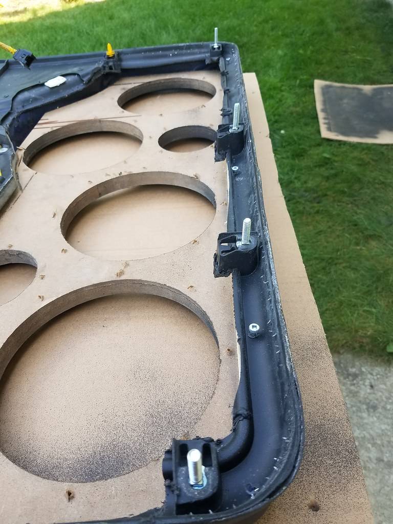

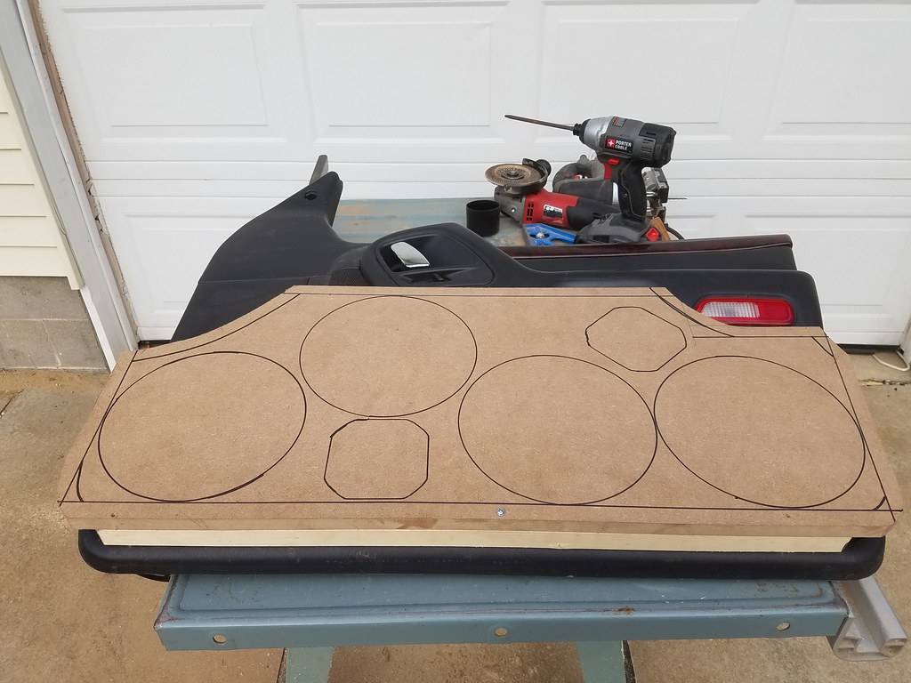

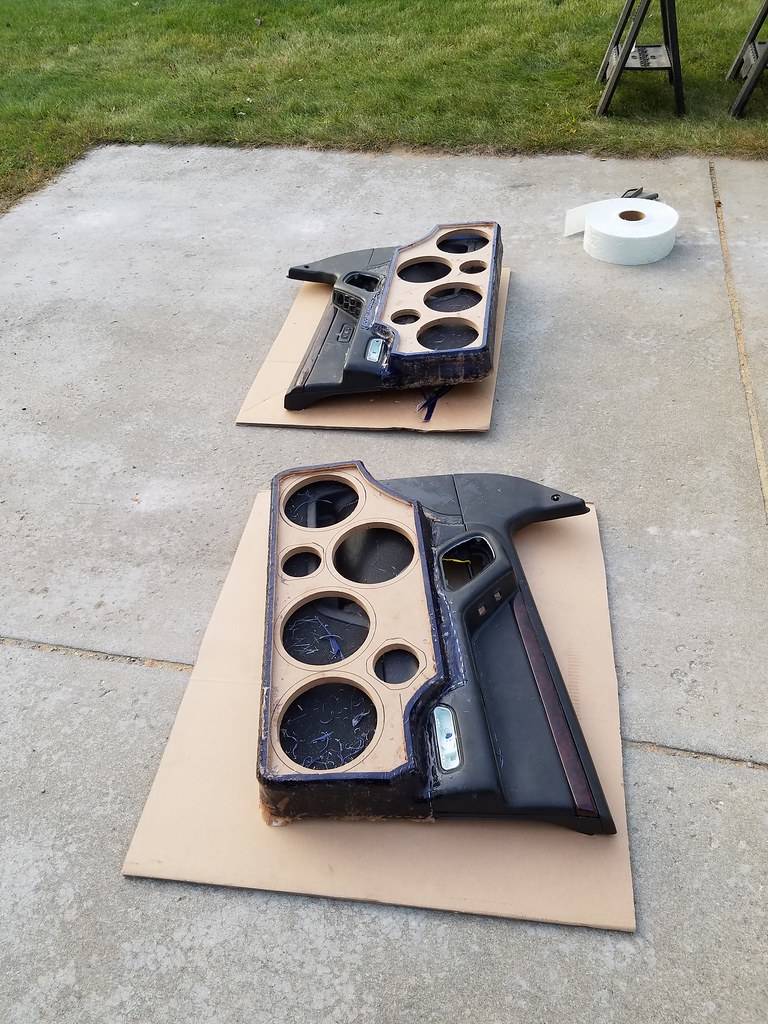

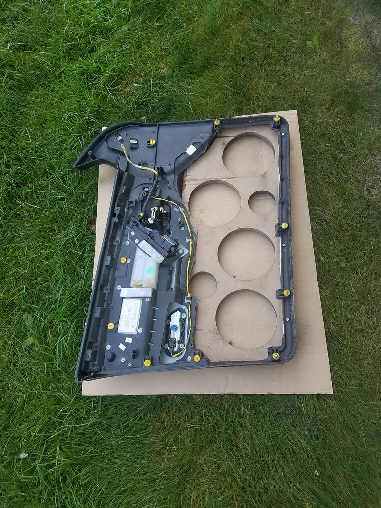

Alright so my door panels are installed and everything in them is wired up. Overall I'm happy with how the doors came out for this being a first try at ever making any. I'll try and explain the pictures as well as I can.

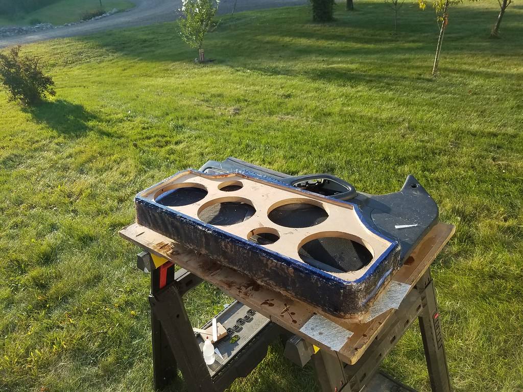

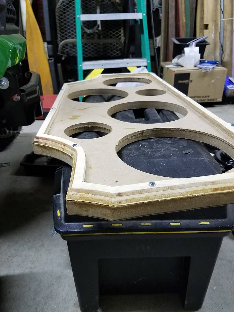

First I made the panel to hold everything and cut out all the holes, which was a tight fit. Then I made a trim ring and used a 30 degree chamfer to get a nice edge.

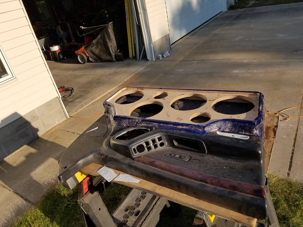

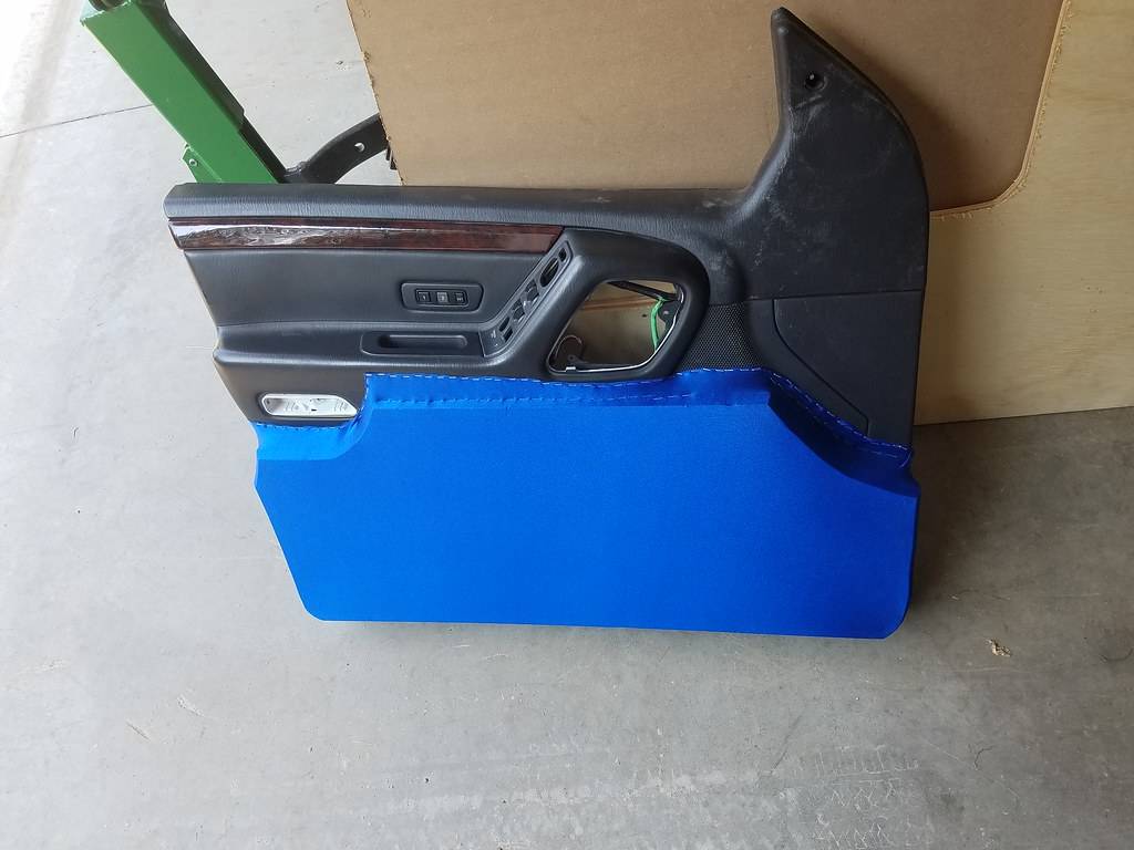

Wrapped panels in fabric, lots of staples later.
Fiberglass and resin naturally.

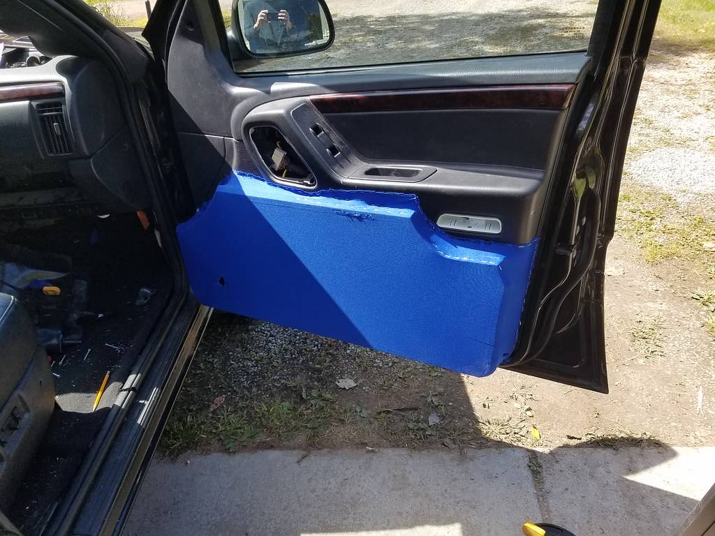

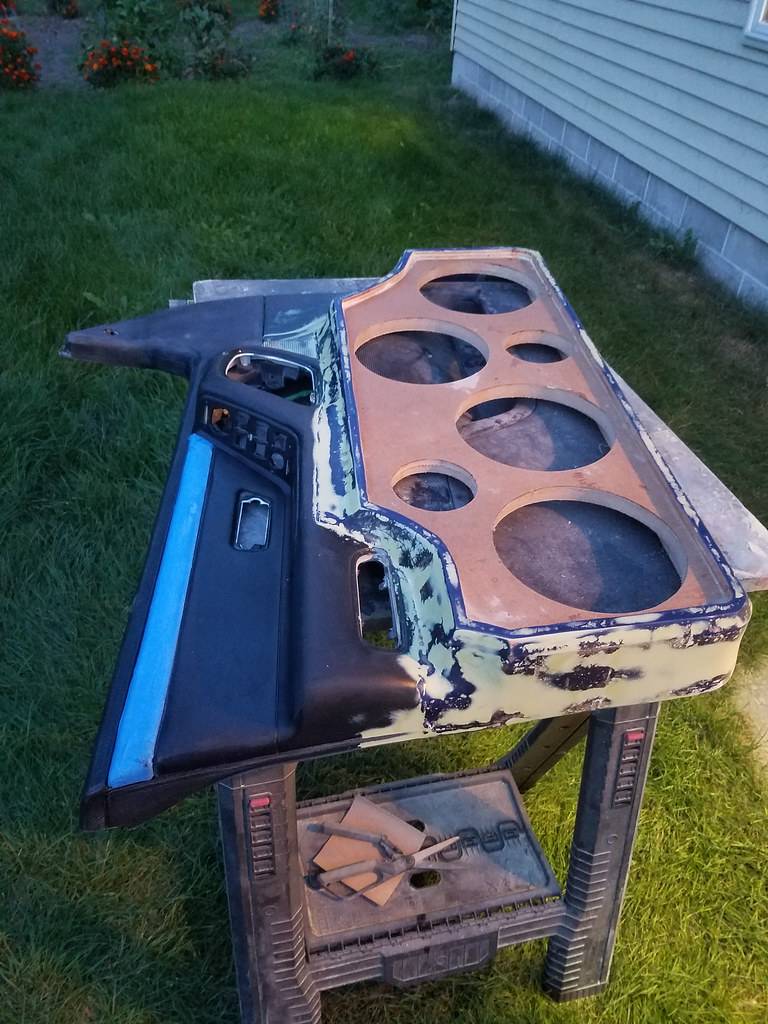

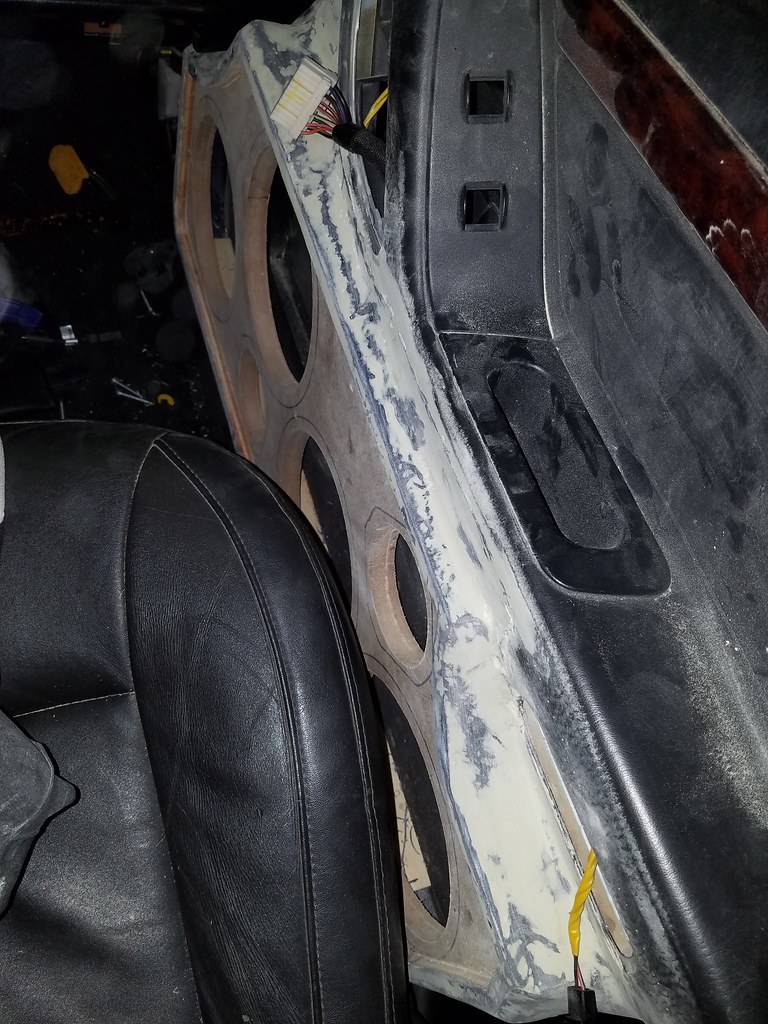

After everything was good and hard it was time for filler and sanding...lots of sanding.

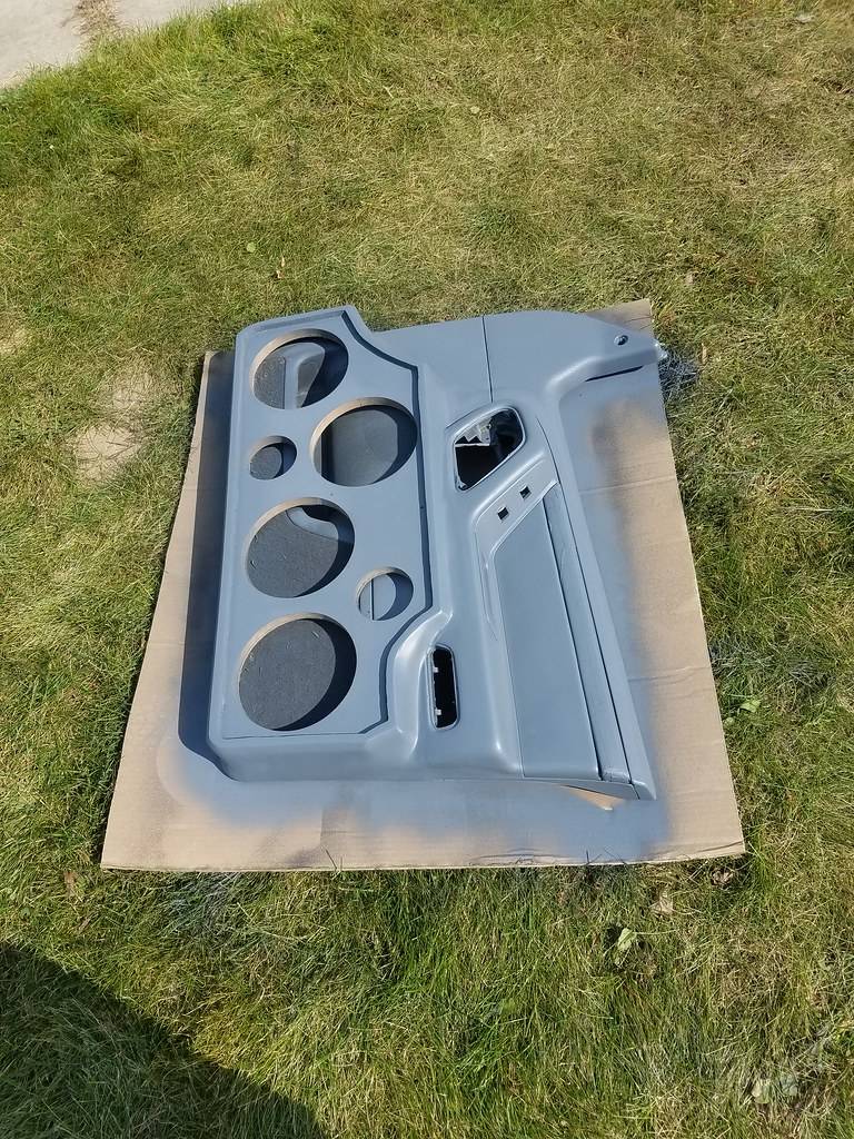

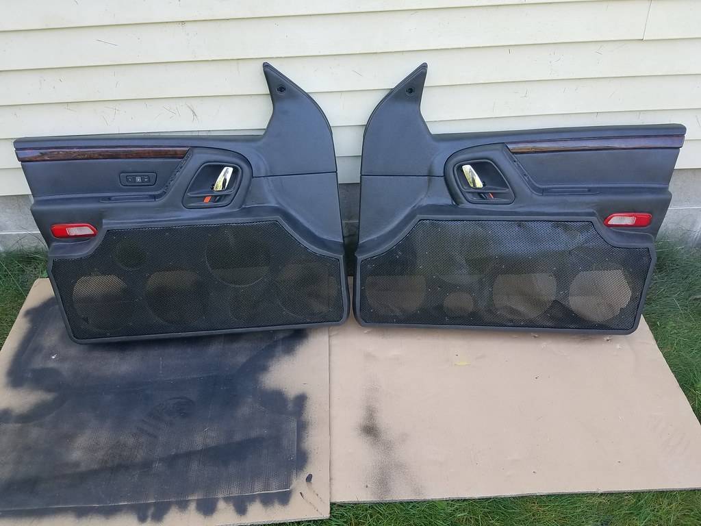

After all that it was time to prime/paint/bedliner.

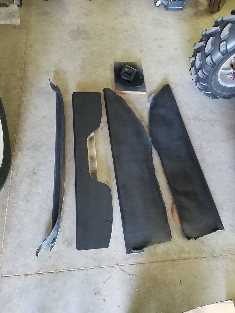

Afterwards I cut out the backs using a jigsaw and a cutoff wheel.

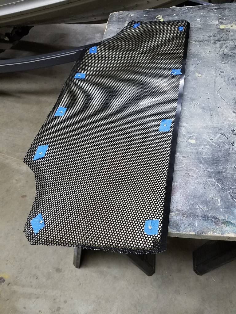

Made some grills using the insides of my cutouts, they'd have turned out better if the metal hadn't got all bent/dented in shipping but it is what it is. I basically just used tinsnips and my hands to make them.

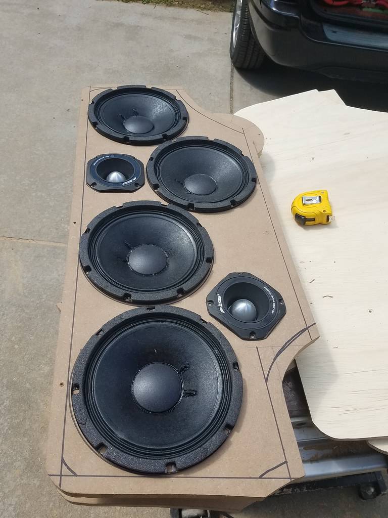

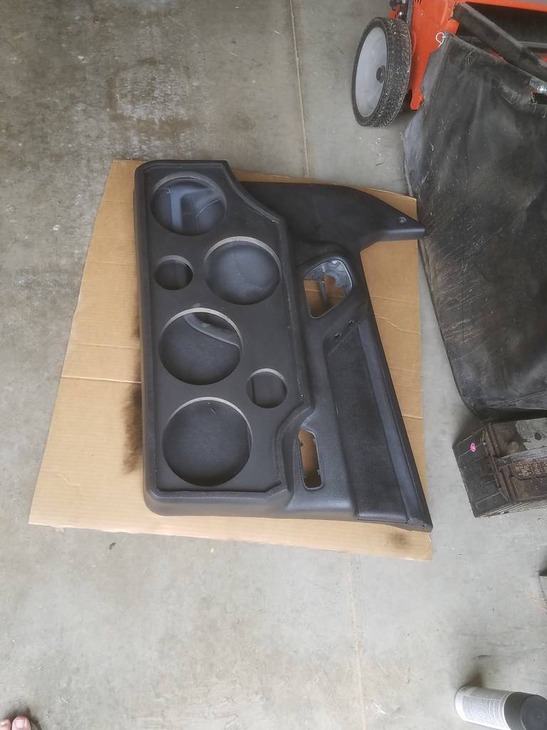

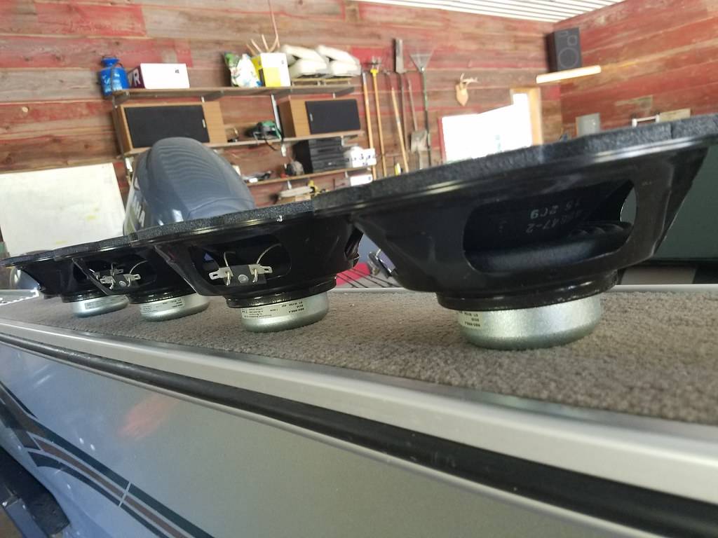

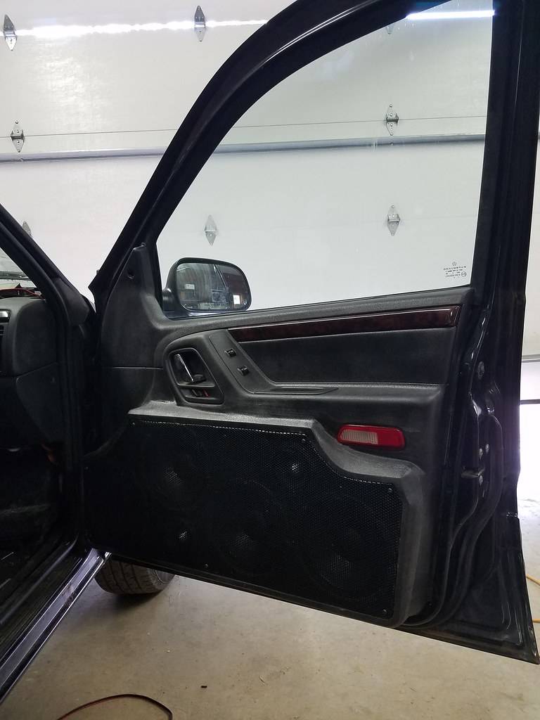

Oh also I switched my choice of midshipmen's, I ditched the PWX 8's and went with some Eminence Neo 8's that Quentin at DSS was selling. Definitely saved me a lot of weight per door. Hoping they sound great.

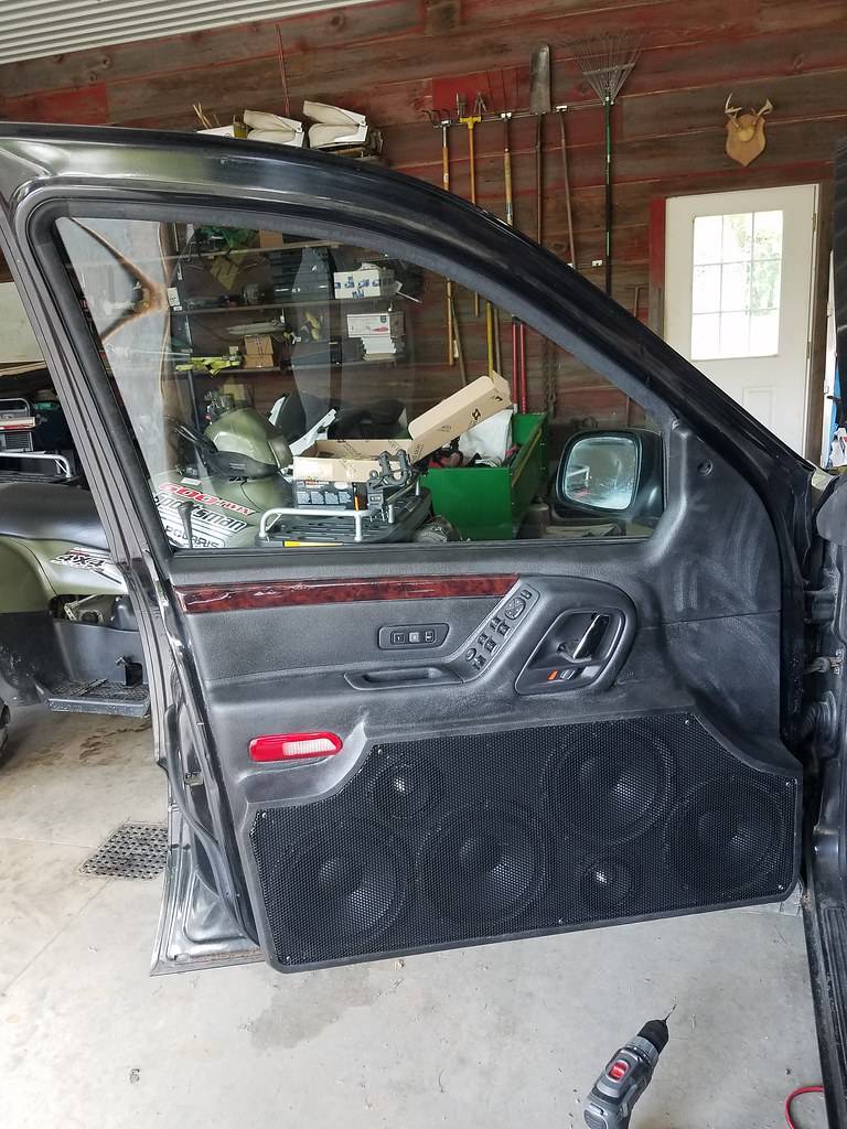

I used carriage bolts in place of the plastic clips to hold the bottom of the panel to the door. I wanted to do threaded rod but most of the places I could go through theres a void or something behind the door skin.
Alright drumroll please.... Finished and installed.I also put more deadener on the doors before installing as I felt they were going to need it.
Tight fit

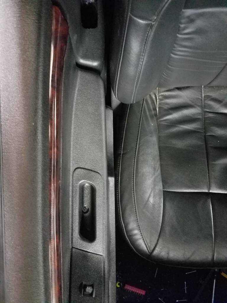

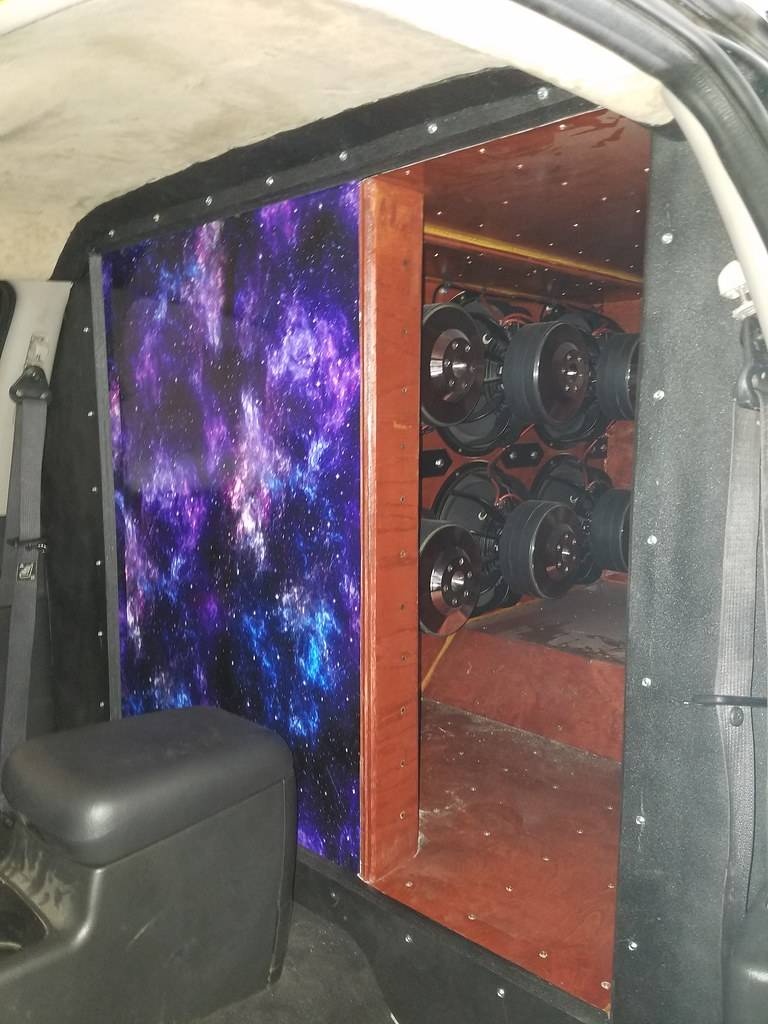

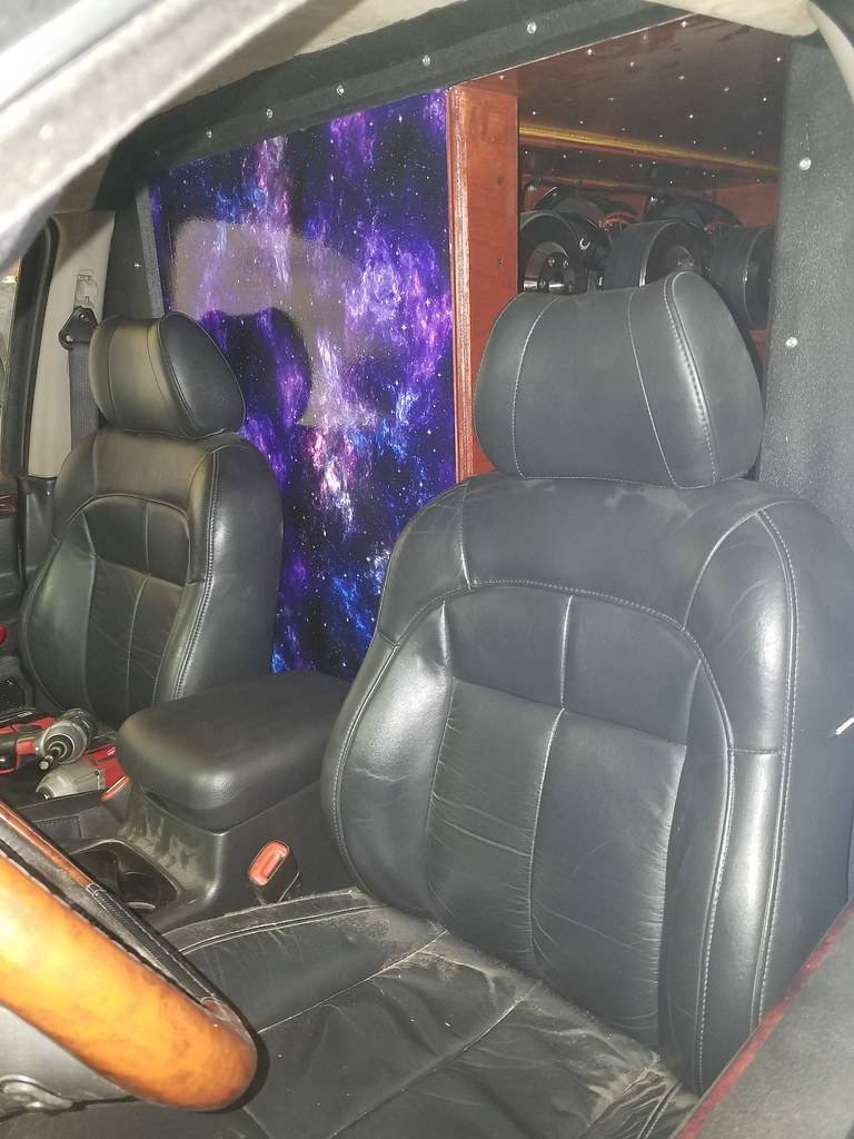

Oh also I got the interior put back in. Couldn't call this build project silent night without a little ECD Customs Galaxy Wrap. If it doesn't look familiar it's from the same company the did the Galaxy Max Duramax. I put a couple wrinkles in it when installing but for the most part they're hid by the passenger seat thankfully.
Trim panels and vinyl on.
Seats and everything else in place
Galaxy Max because it's awesome and I can't not share it.

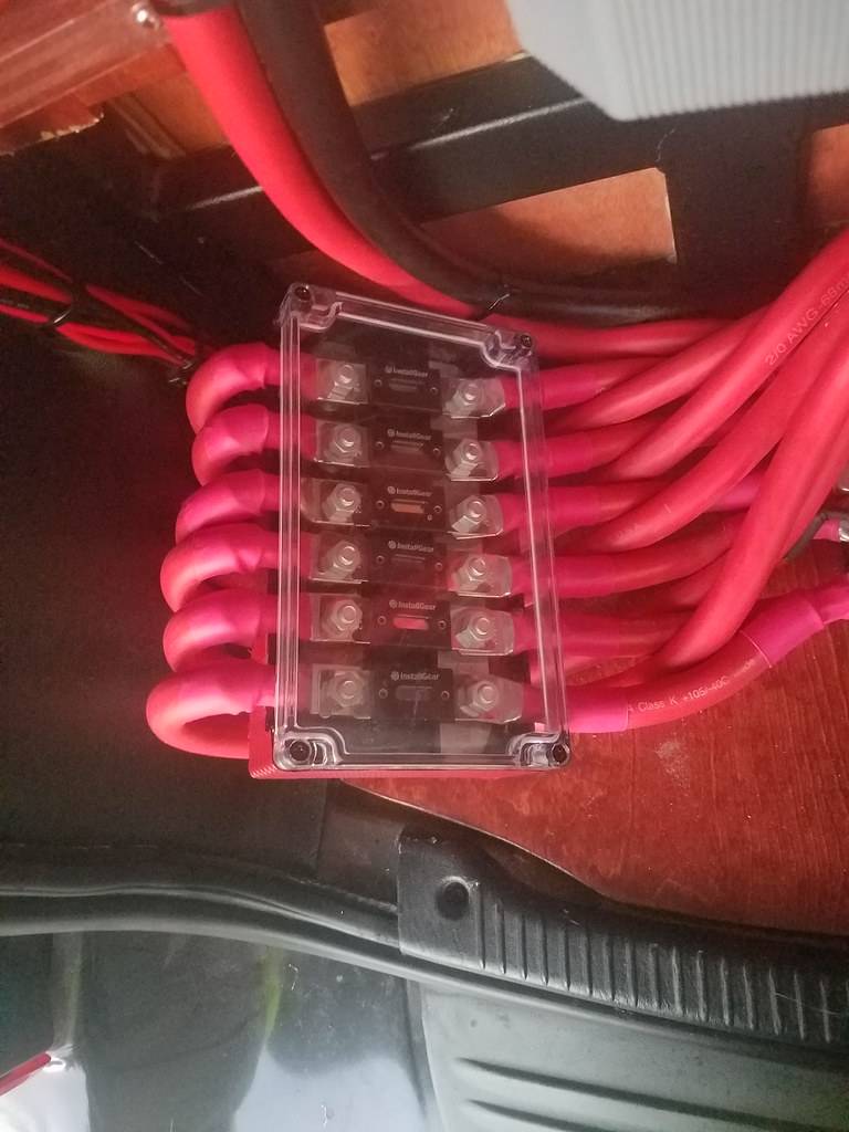

Alright so I kind of finished the Jeep enough to go to a show this weekend. I got everything fused and my voltage would not charge where it needed to be. I think it's because I'm trying to run two alts off of one regulator. So for the show I elected to run down an alt, last night I ordered another regulator I will have to install it by the 15th. At the show I had a couple issues out of the gate, first of all it wasn't loud enough. So we bumped up the gains and re-gain matched them all. Secondly the*electric fan under the hood wouldn't turn on. So I ended up wiring it straight to the battery and disconnecting it when the Jeep wasn't running. I plan to put it on a switch. Overall I think the show was a success I had a lot of fun and the Jeep got a good amount of compliments.*

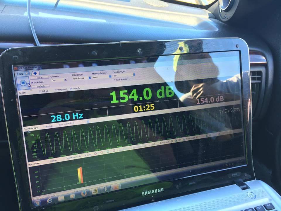

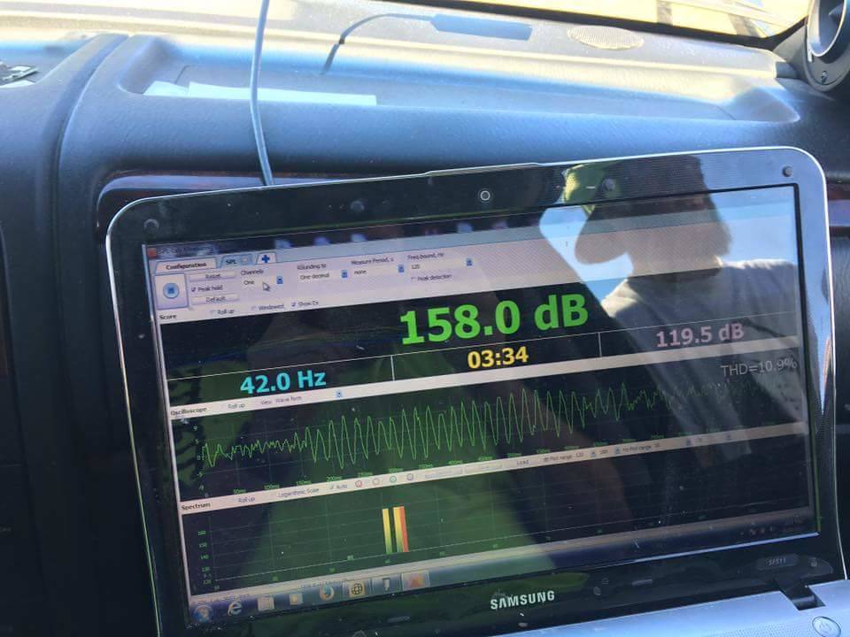

Oh also someone was kind enough to meter it for me. I did a 58 legal on the dash at 42 Hz and a 54 drivers door open on the dash at 28 Hz. I think it has great range it might not be a subsonic machine but it will definitely choke you up. I got a demo in my own passenger seat and it definitely hurts. It will be interesting to see if I can gain anything with the second alt up and running.

That looks fun. I don't expect you'll gain a whole lot from having both alternators going. With the current those amps will want to draw you'd probably gain more on the meter from a few cap banks. For sitting around playing actual music the extra alt should help a lot keeping system voltage up.
