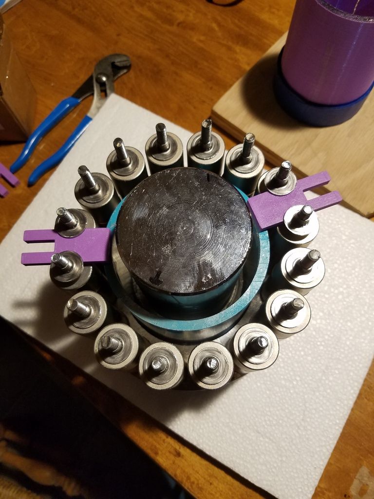

4 Cascade Omega Neo 18's (building motors like Robs, PSI recones likely)

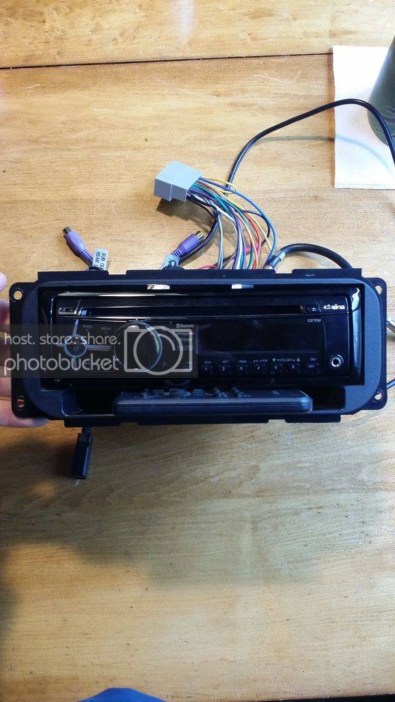

The jeep came with the stuff to put in an aftermarket radio I'm too lazy to do it today:

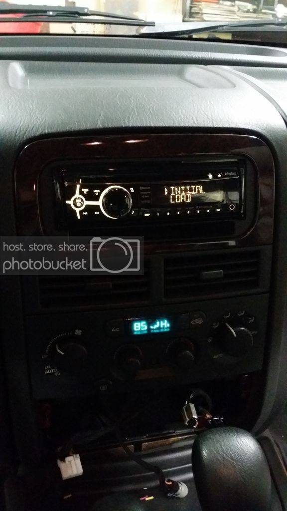

Anyway the day I got the jeep I got bored and decided to put the radio in, at first I couldn't get the radio to turn on, it turns out that there was a blown fuse. After I got it to turn on I wasn't getting any output I didn't have to look into but I ordered a new radio harness hopefully that fixes my issue.

...a blown fuse. After I got it to turn on I wasn't getting any output I didn't have to look into but I ordered a new radio harness hopefully that fixes my issue.
Do you have the factory amp under the back seat? Is there a separate fuse for that that might be blown?

I could have I haven't had time to look sadly I had the Jeep for 2 days when I was home, that would certainly complicate things though. I really need more time to look into it which I'll get after the 20th. Is that the tan one? I think I know which one you're talking about, however I really want to go with a 4th //content.invisioncic.com/y282845/emoticons/smile.gif.1ebc41e1811405b213edfc4622c41e27.gif

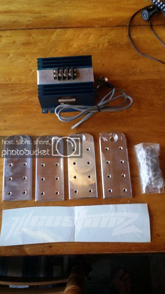

Well one of my favorite things about coming home from being on the road is opening packages. Sadly not much of what I actually ordered arrived. I ordered the threaded rod, weld nuts and a s**t ton of #8 self tappers tracking says delivered, but they haven't showed up emailed company today. Still waiting on battery have yet to receive tracking, if it hasn't arrived by Monday I will be cancelling my order it's a principal thing in my opinion it shouldn't take 3 weeks to ship a battery. Duramax parts didn't arrive either but they had to be custom powder coated.
Anyhow I did get some things at least new wiring harness for radio, antenna adapter, external regulator, Illz Customs battery terminals for battery under the hood and lithium when I get it. I will say I'm impressed by the battery terminals his response time was good and he got them out fast won't hesitate to take future business to him. I also got a used 18" basket but it has vent holes drilled below the spider landing so I don't know if I'll actually use it. Oh and my secret santa package arrived but I'm waiting until chrismas to open it.

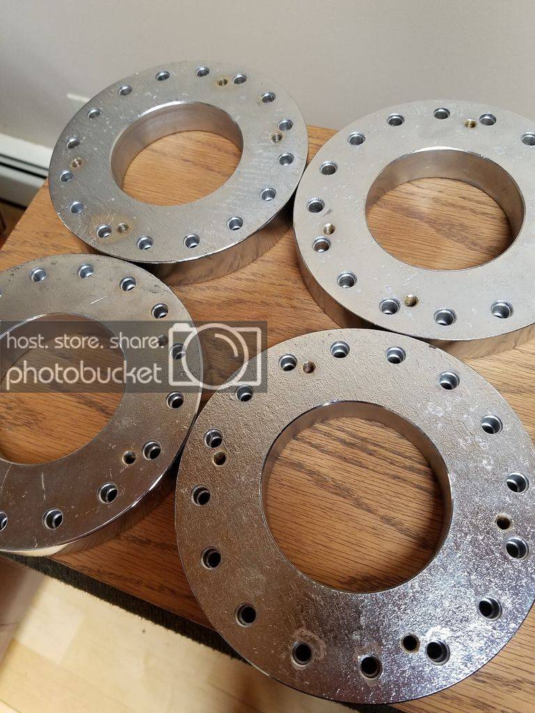

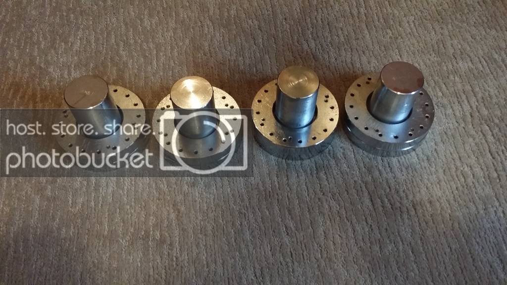

Well more small updates I figure if I keep plugging away at it there will be less work to do in the future. So last night I drilled out my top plates and the back plates for the weld nuts. I used two different size drill bits a 3/8 to go the depth of the weld nut and a 5/16 to open up the top of the hole a little because the weld nuts wouldn't sit quite flat. Picked up the steel for the neo pillars today it was $40 from Alro which is the local steel distributor. Hoping to get them machined next week I'll try and get some videos or something because I think he plans to do them on a CNC machine.
In other news I ended up finding 2 Mechman 320's for the jeep used so I bought them, figured it was a better route as it was only a little more than some of the quotes I got for a single alternator. They're coming with a bracket but it looks kind of rough so I'll probably fab up a better one. Additionally I finally got in touch with Droppin Hz and Mr. Young from Full Throttle. They ran out of 65's and the one the dealer was going to send me went elsewhere. So they're sending me a Group 31 instead of a 65 I just have to make it fit. Might have to weld up a battery tray. So anyhow on to the pictures, nothing real exciting.
I screwed the top plates down while drilling them made it a little easier.
Top plates drilled.
T-Yoke bottoms drilled, by this point I was over drilling it was a tedious job.

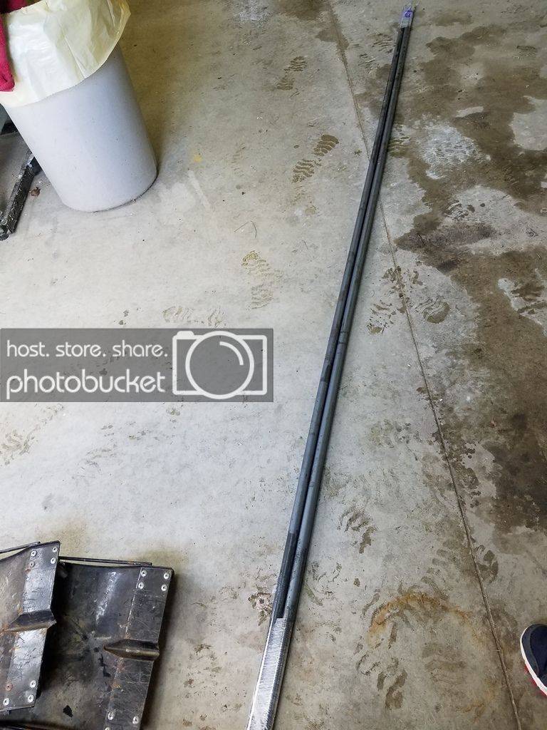

20ft of A36 I only needed like 11 feet but I figured I can have some extra cut in case I want to run 6 subs in the future. The rest can be used as bracing or something.
I plan to cut the threaded rod tomorrow, I have a safety meeting at work and then I'll probably cut them real quick afterwards on the band saw.
