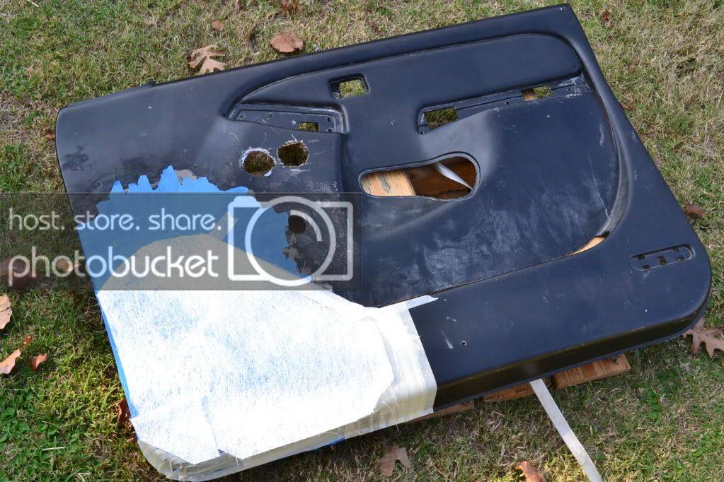

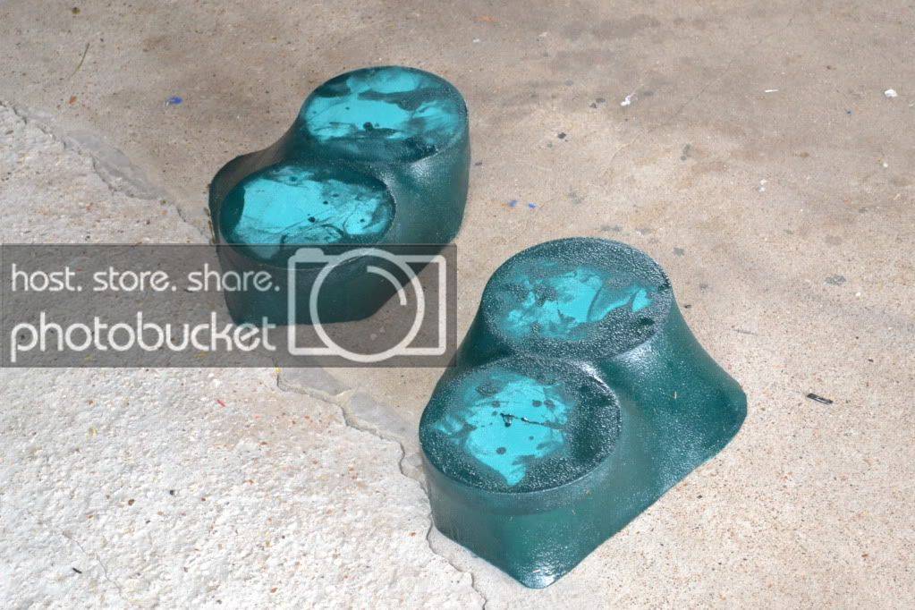

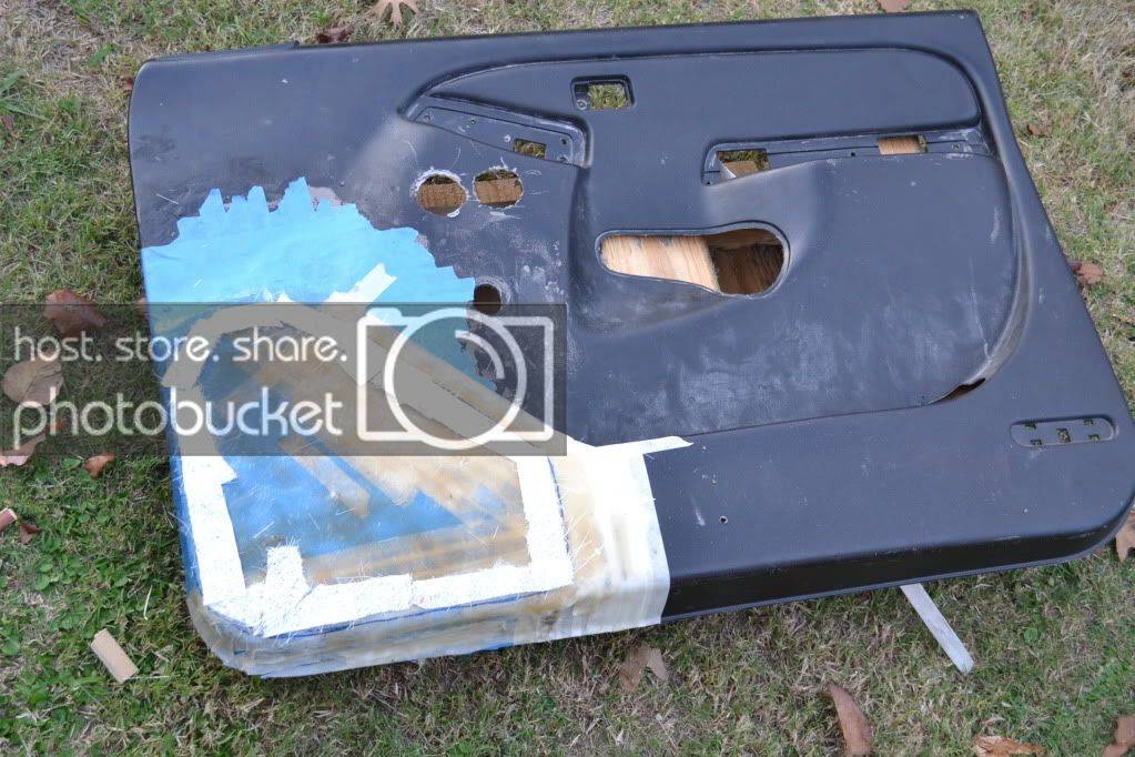

iPad mini WITH 4g. ladies and gents, been sanding the dash for an hour and a half tryna get it baby *** smooth, and i... ill just let the pictures do the talking:)
primered, mainly just a guide coat to see any other small places i need to sand

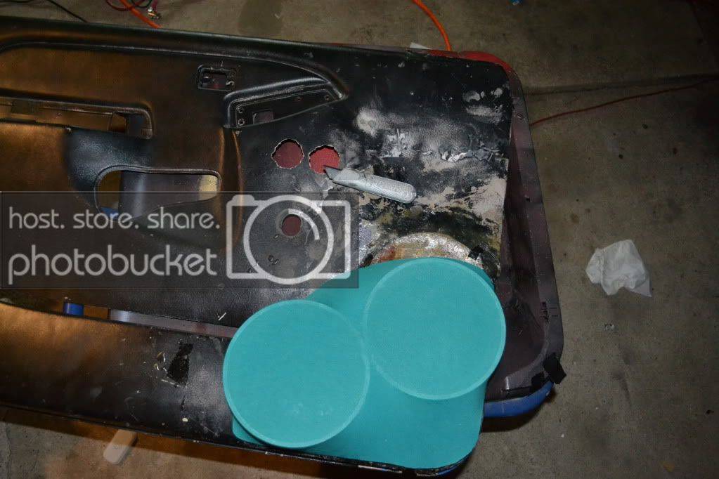

JK, good work though. Lots better than my first, and only, pods I've built. Just took them out yesterday as I'm now back to single woofer setup

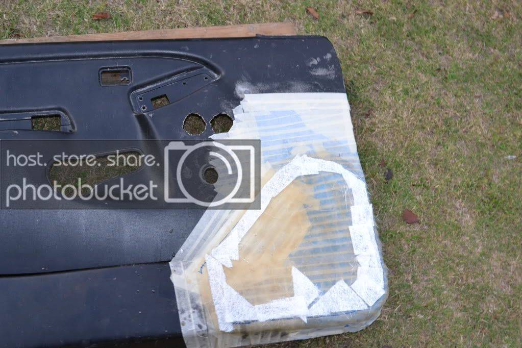

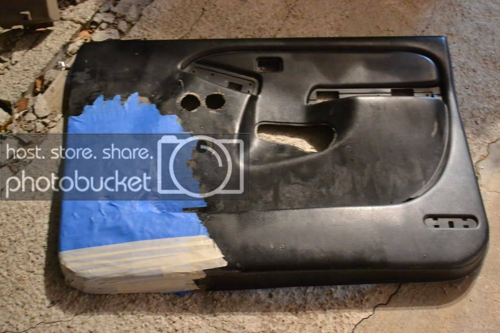

Pods looking good man cant wait to see them finished were you putting the tweets?
Thanks man, and you see those two ****** cut holes about 6 inches above the pods? I'm gonna put them there for now but they may get moved to the dash or pillars, not quite sure yet.
Nice pink phone! //content.invisioncic.com/y282845/emoticons/fro.gif.c695f1f814b01c4ad99fe7f8cccadd29.gif
Thanks man, I just took my time, read alot about it and made sure everything was right,

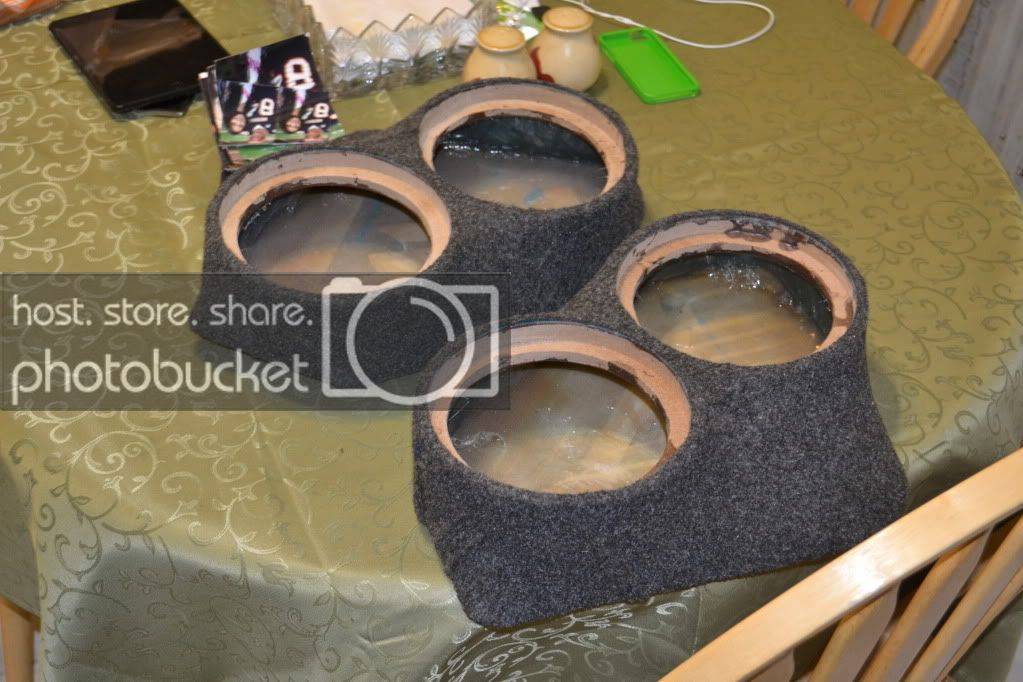

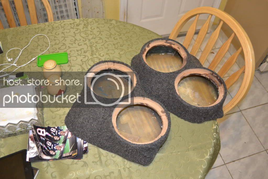

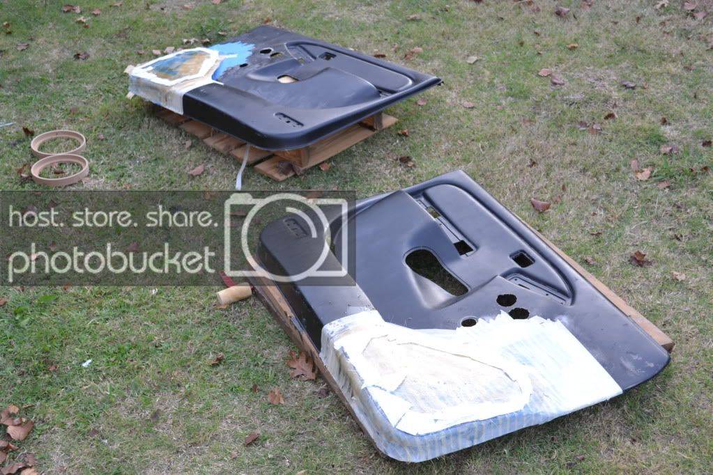

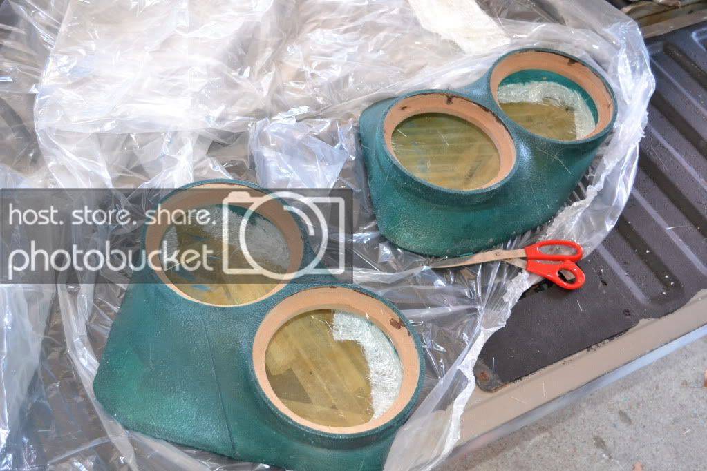

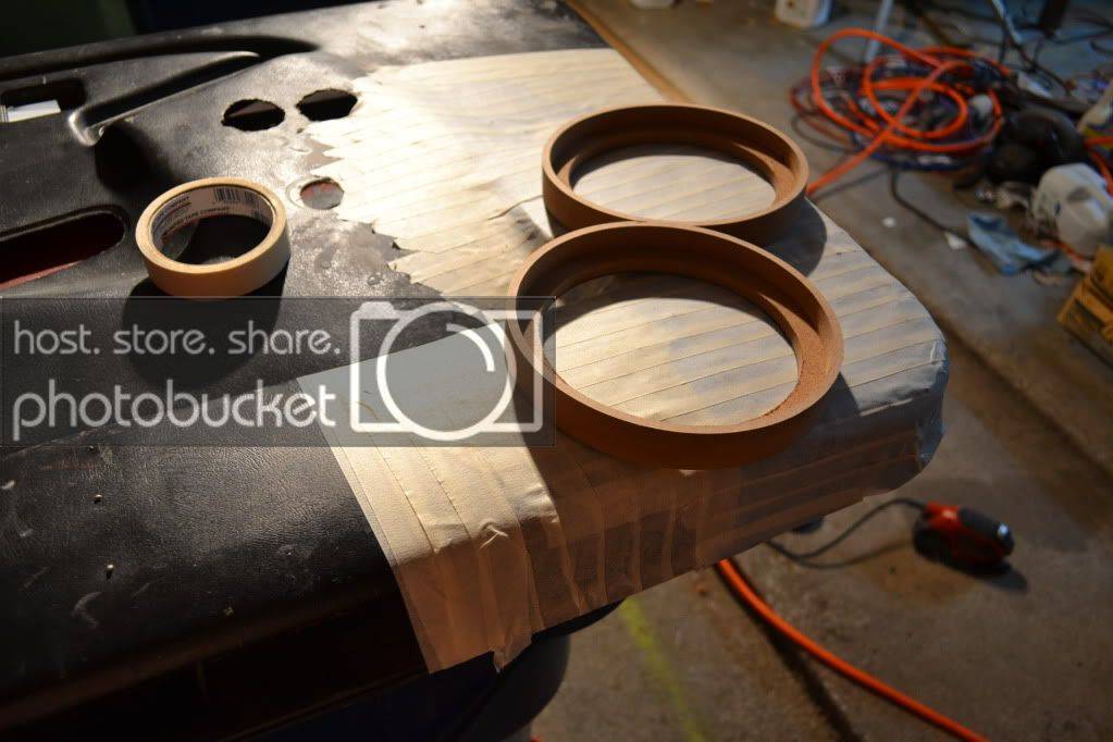

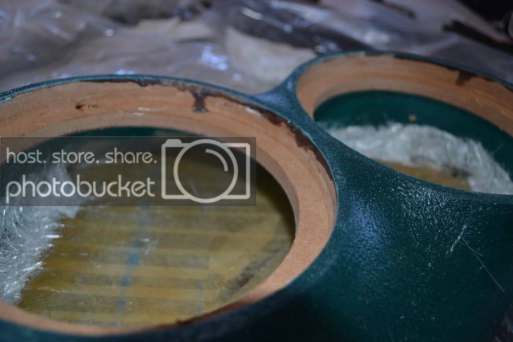

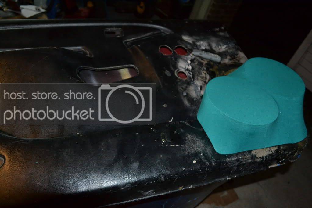

all done! as you can tell my wrapping skills need some work, but i think they came out pretty nice.
who wants to see pics of them installed? perhaps a vid of them playing?//content.invisioncic.com/y282845/emoticons/up2something.gif.dd110ecf3ae4b76050d87598f2f8de7c.gif
Great looking pods, def better the second time around! Would have loved to seen paint or vinyl though! Something you may want to try in the future that you may like is to cover your finished pods with painters tape, lay down some glass and make a "molded" shape insert. Paint that and then you can use it as an overlay on the pod to hide some of the seams of the carpet wrap. Kind of hard to explain, maybe you get the idea. Either way keep it up!
