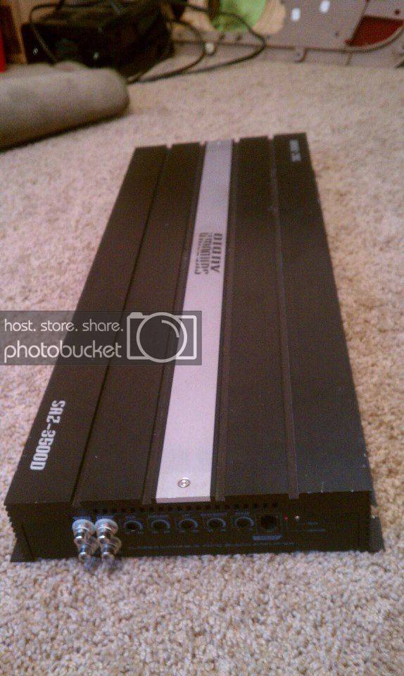

Trading it and my current aq for a SAZ-3500, I don't have room for both AQs and would rather run 1 amp anyways, always wanted a sundown amp, will post pics once I acquire it. Trying to figure out where I'm gonna put my batts, thinking maybe under the hood just not sure where..

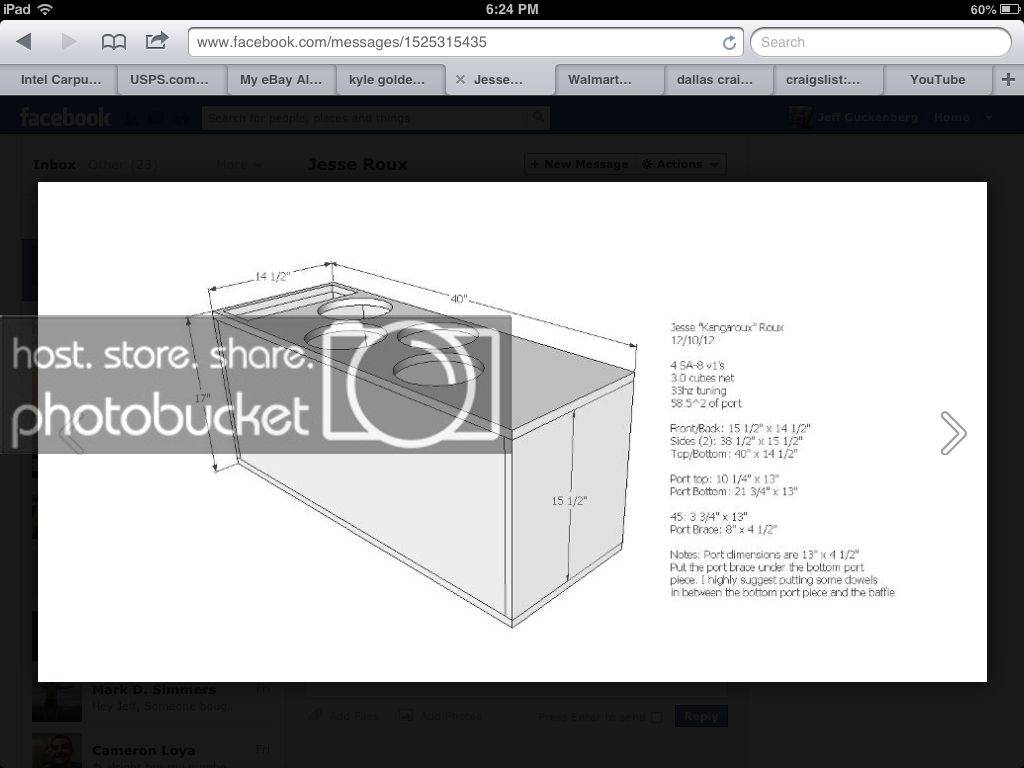

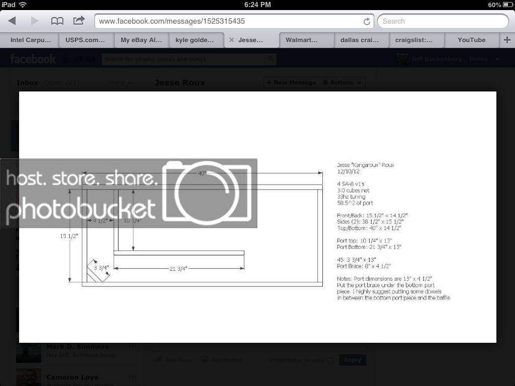

The SAZ
Dual Inputs
Big UPS to @Kangaroux ; you're the man bro.. Thanks for hooking me up with this sexy assdesign, shit tons of port!

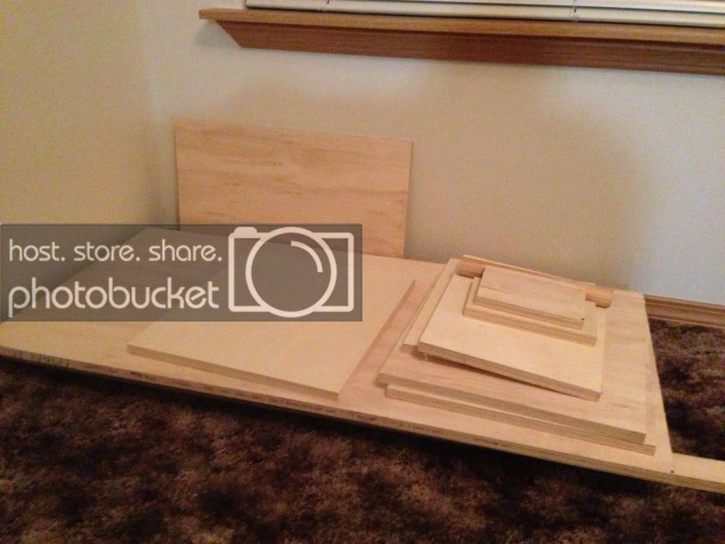

Got everything cut!!! I'm gonna start assembling some of it tomorrow, stay tuned!

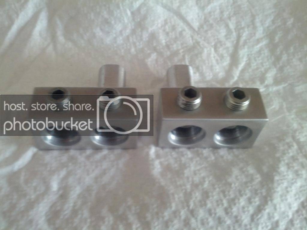

oh yeah, notice that SHOK 1/0, thats gonna be my negative run to the back batt.

not knocking jesse's work at all... but honestly the top baffle should be doubled up, and the port walls should also be doubled.
