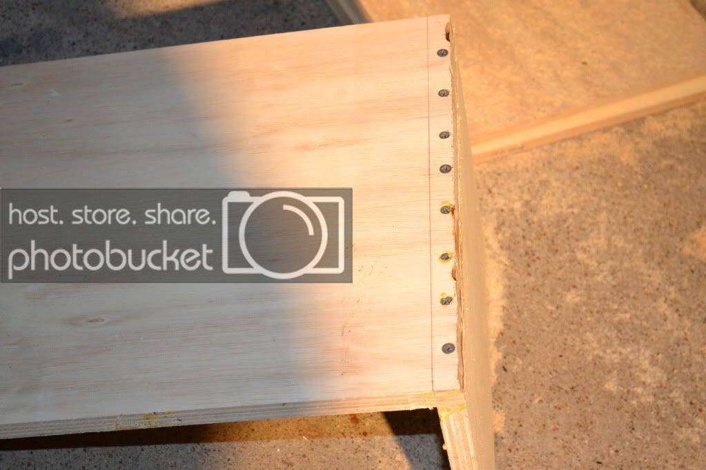

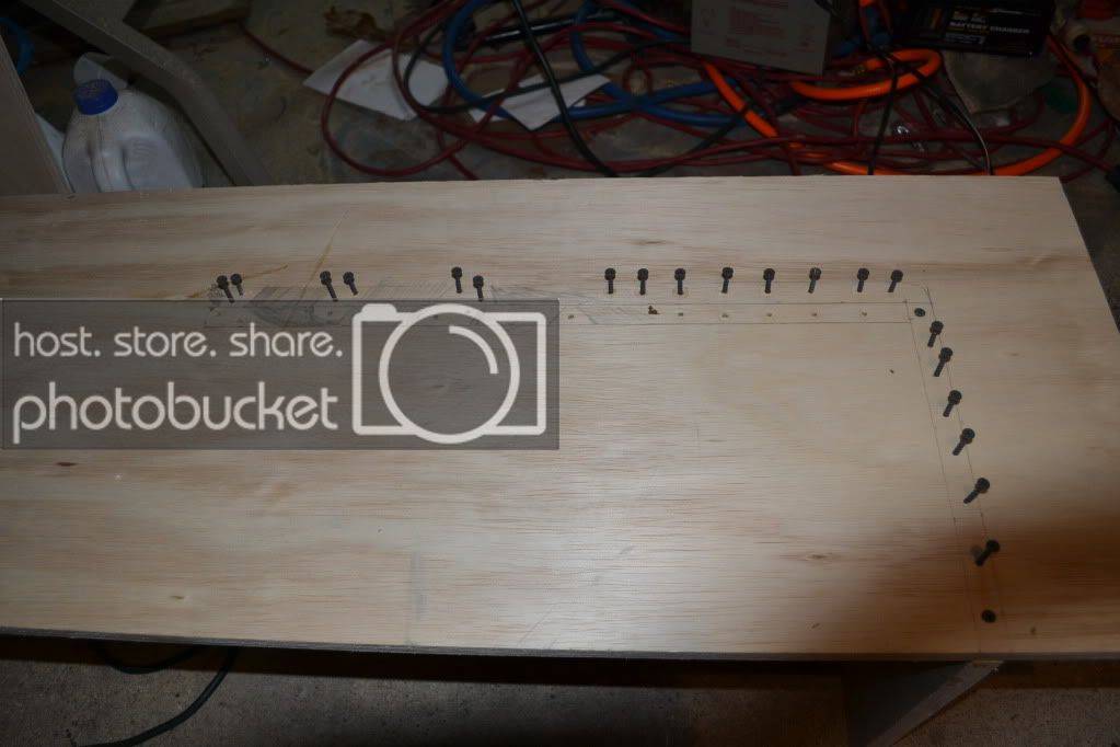

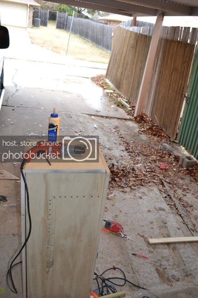

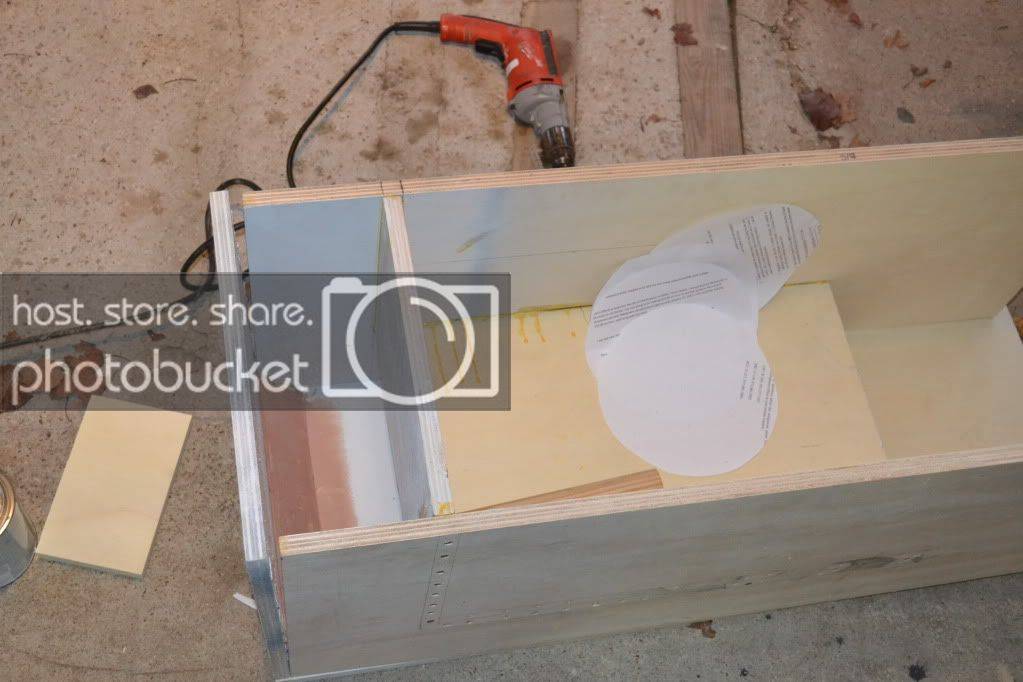

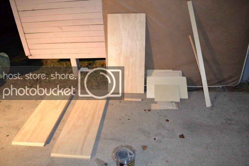

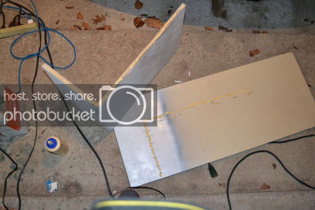

started cutting and building the box, yes i overly build my boxes, do I care? no...

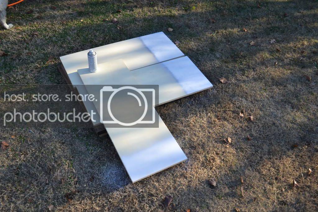

painting away

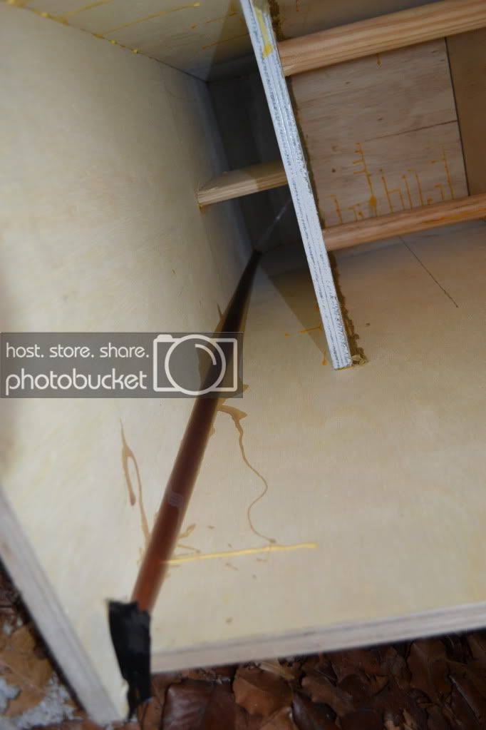

uhh hello port MR. PORT:fro:

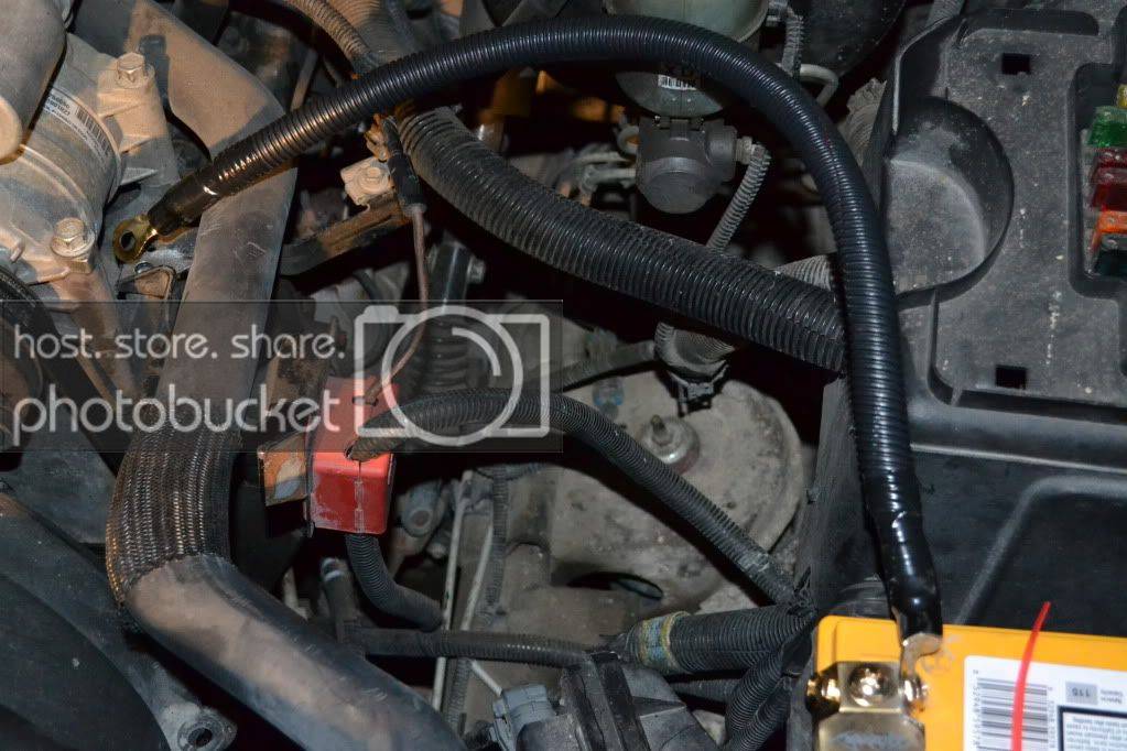

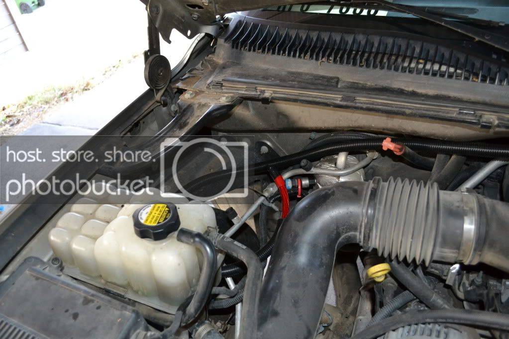

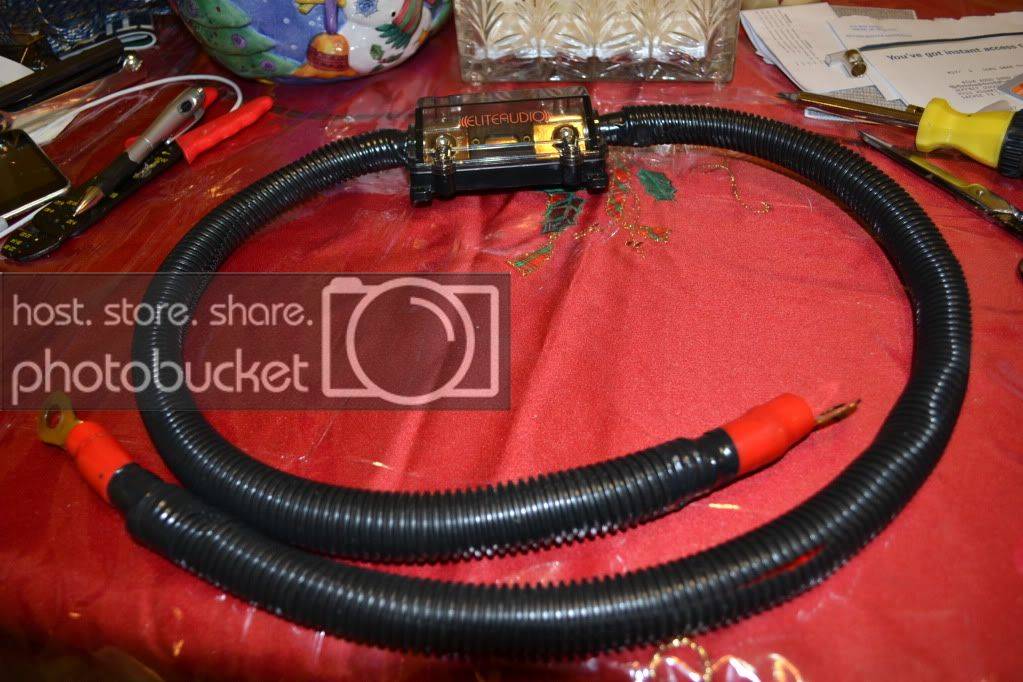

charging 1/0 from the alt to the main batt

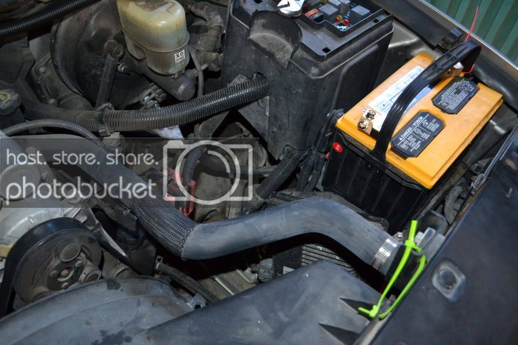

That back corner is gonna house another batt
this little area in between the fuse box and radiator house will house another batt as well.. 3 total batts under teh hood

all covered in loom and terminals sanded, ready for installation

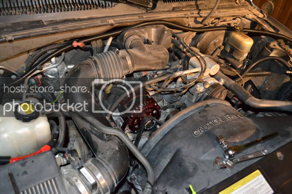

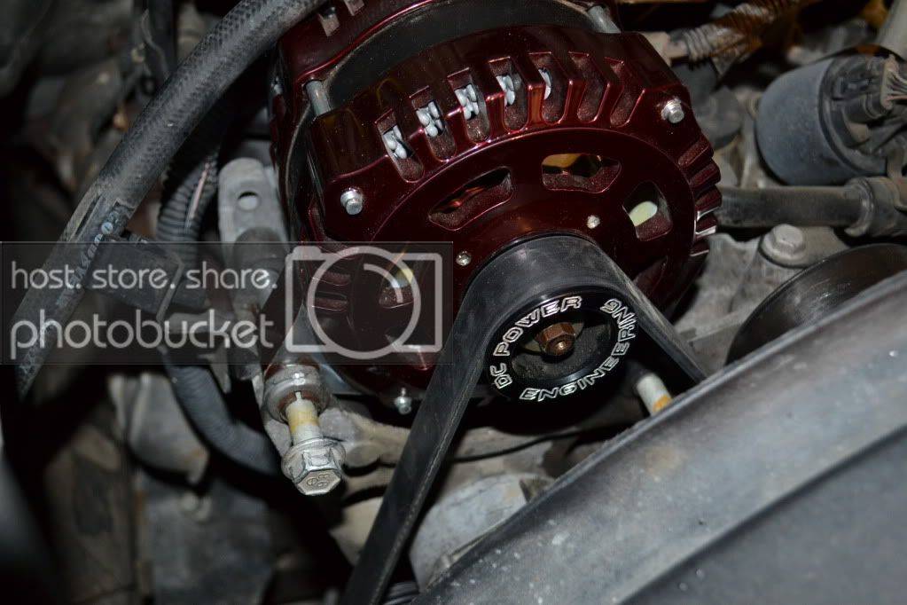

The alternator is finally in!!!!

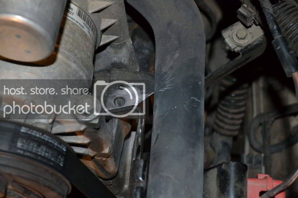

still have to do the engine block to frame ground, will probably go knock that out shortly..

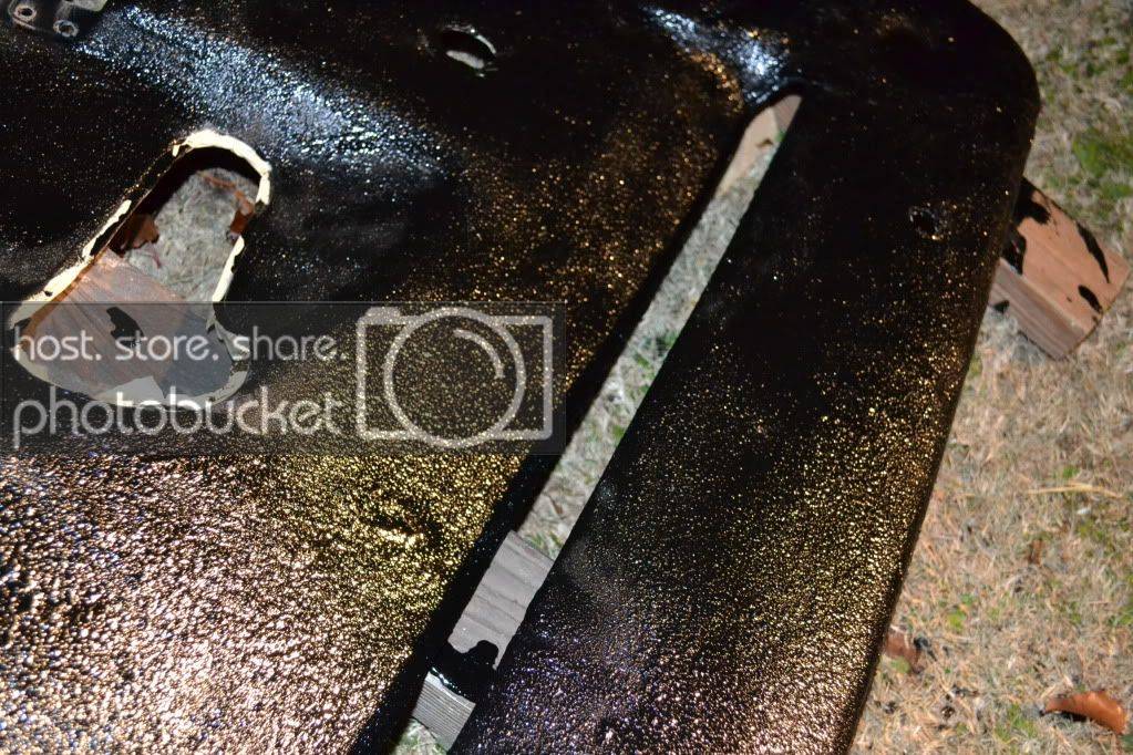

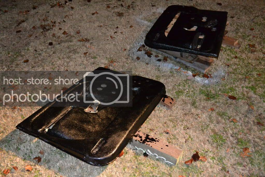

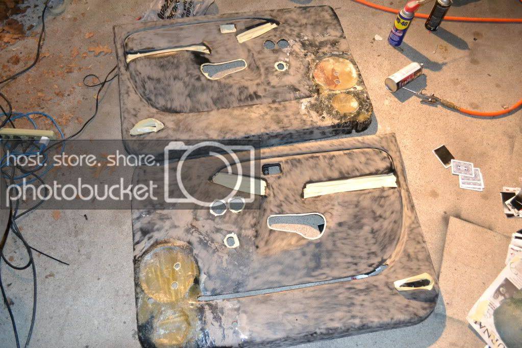

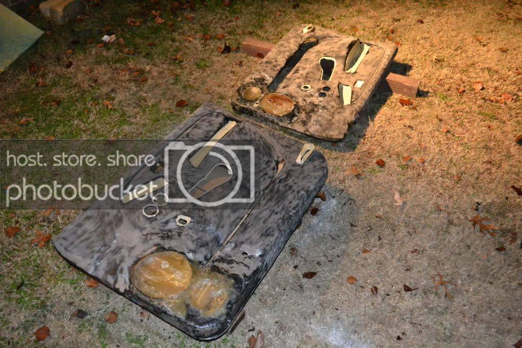

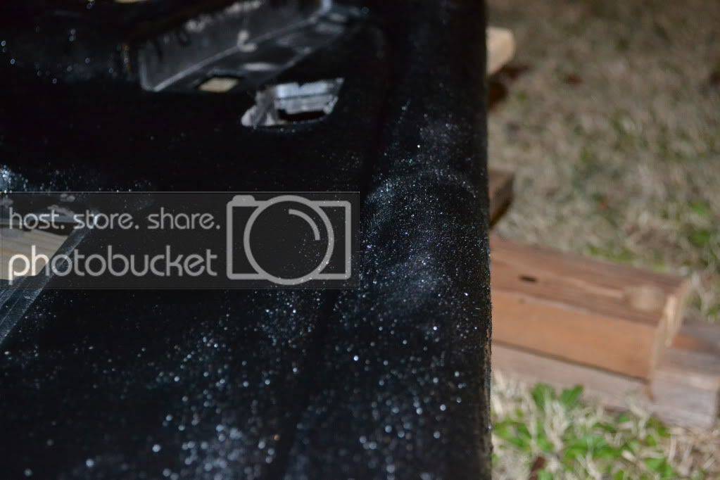

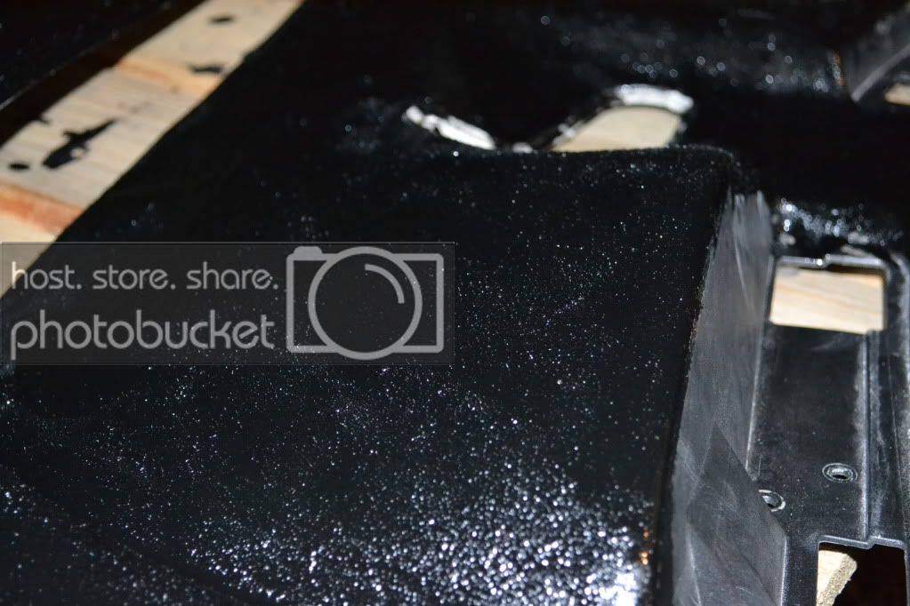

Next i decided to go ahead and sand my doors down, i used a wire brush attachment on my drill, it did the job well.. lol, got them all taped off and prepped. then bedlinered them.

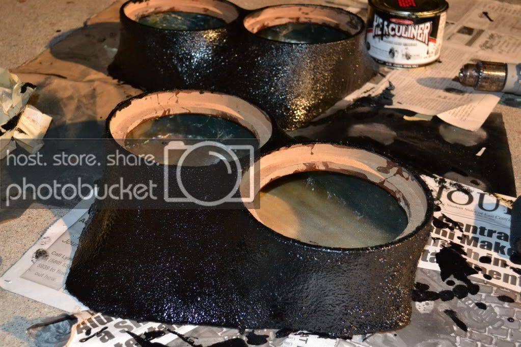

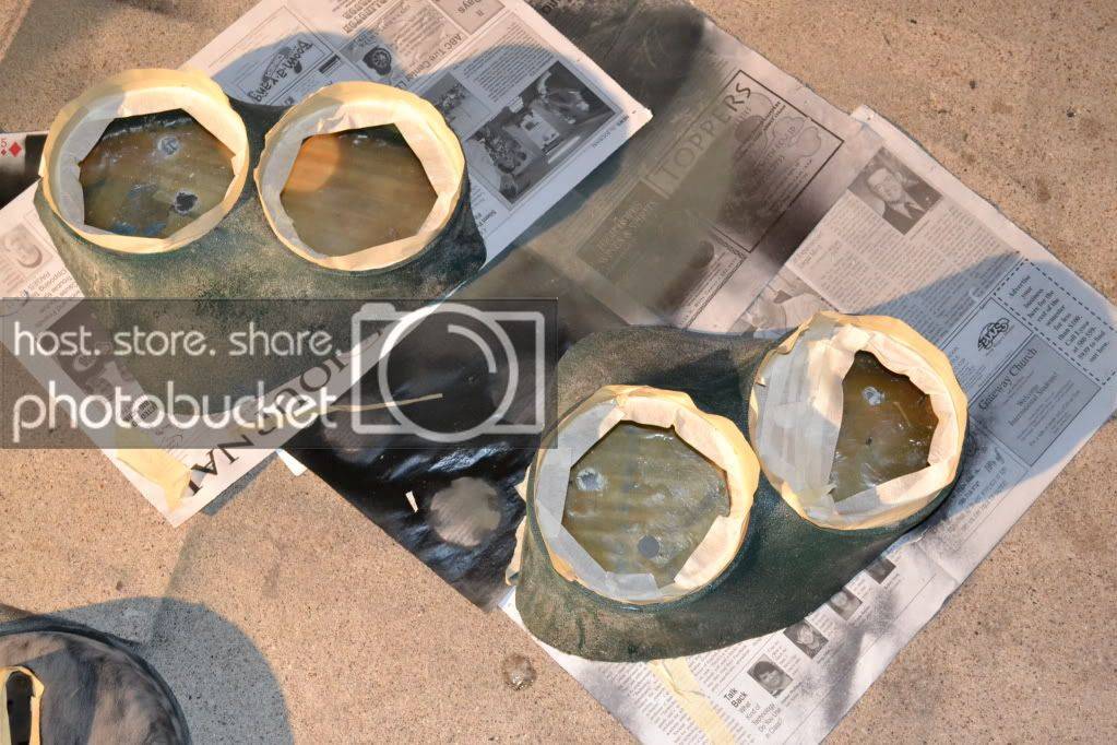

pods taped off
pods linered
doors
here you can really see the texture of the doors

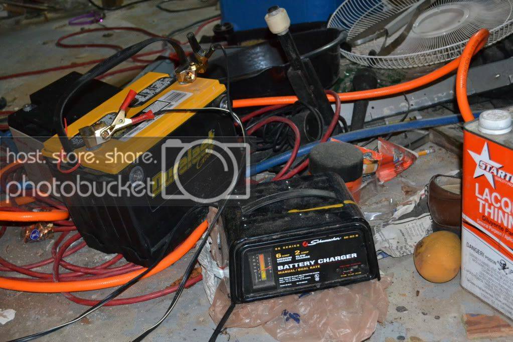

threw my main batt on the charger to top it off..

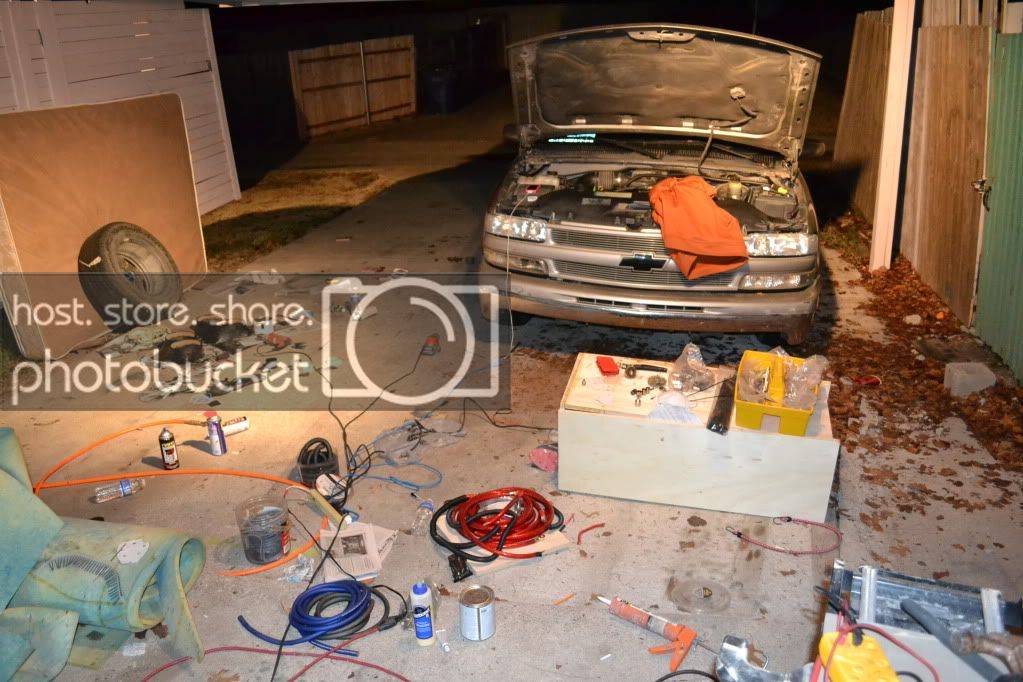

my messy work area! lol
my main runs to the back will be 1/0 Knu and 1/0 Shok, all the power wire that is visible inside the cab will either be blue or black, then for speaker wire to the mids it is blue, speaker wire to the subs is black and white, should be interesting to say the least,
