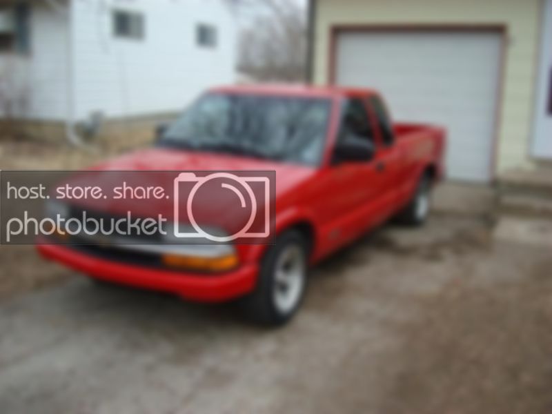

01 Chevy S-10 Extended Cab

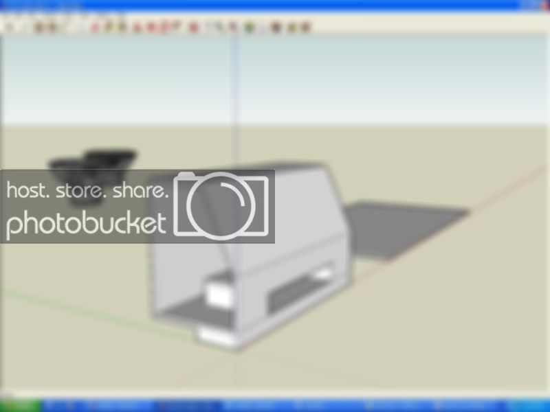

You guys probably remember the first box designs for this truck. Well we decided to put it into play Last night. I made some revisions to the box so he could fit in his seat more comfortably.

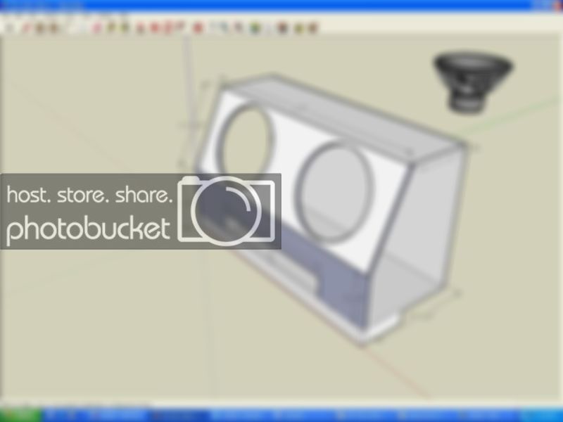

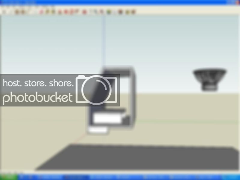

and a really rough sketchup draw-up to grab demensions from
7.8cu/ft after all disp. 104sq/in of port 13.75" long @ 32htz

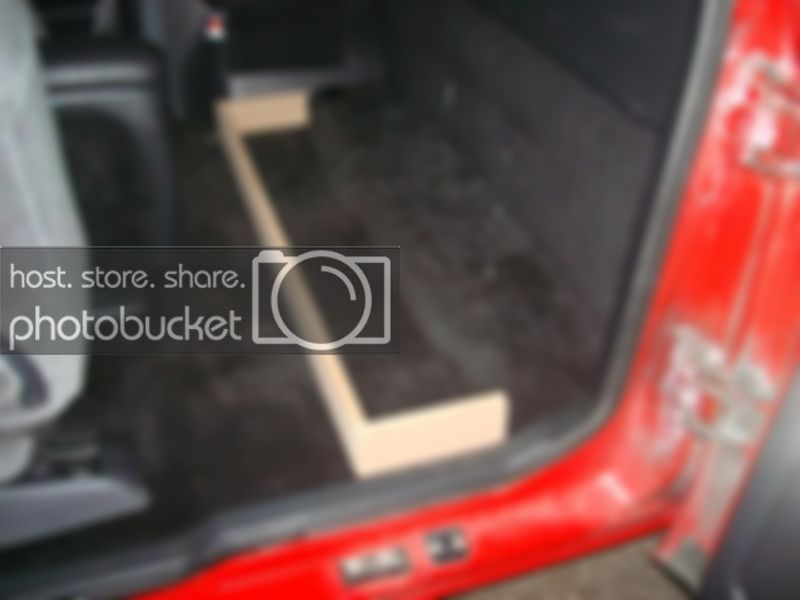

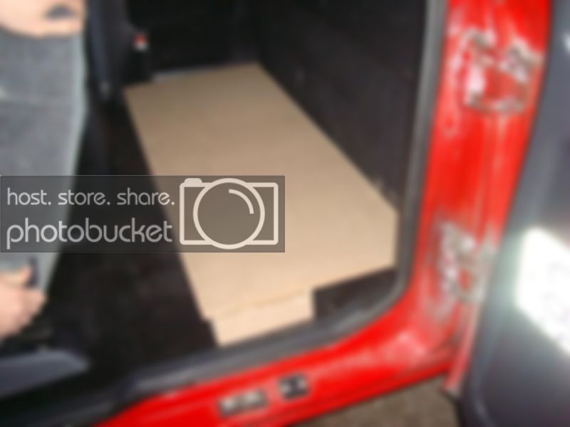

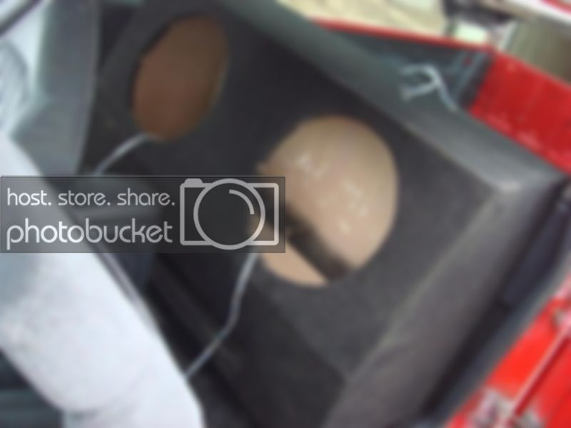

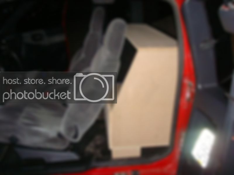

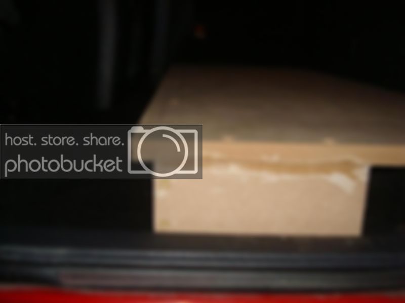

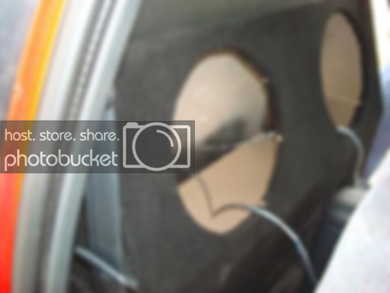

Little Test Fit In The Truck

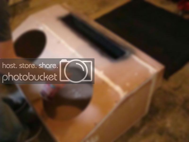

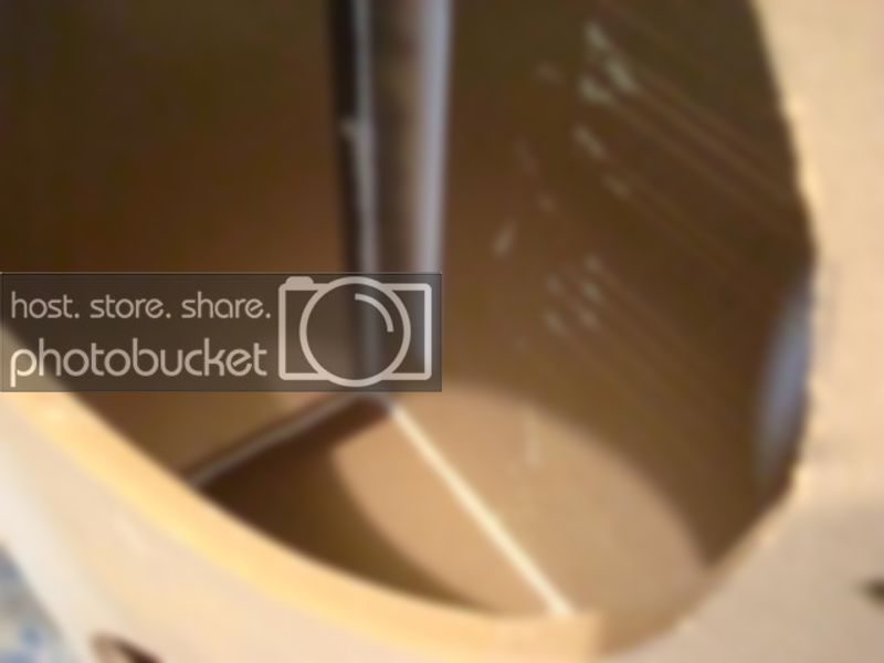

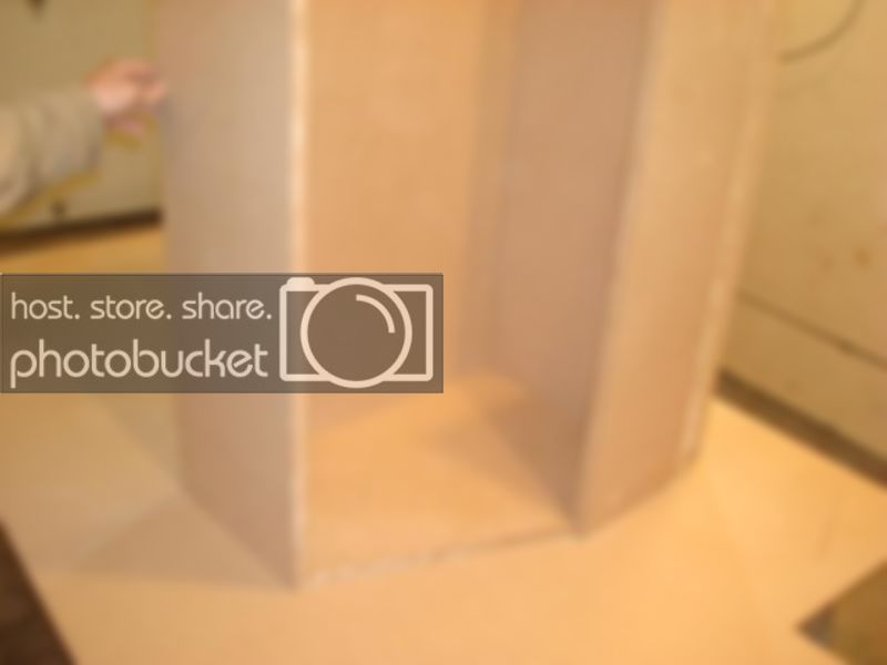

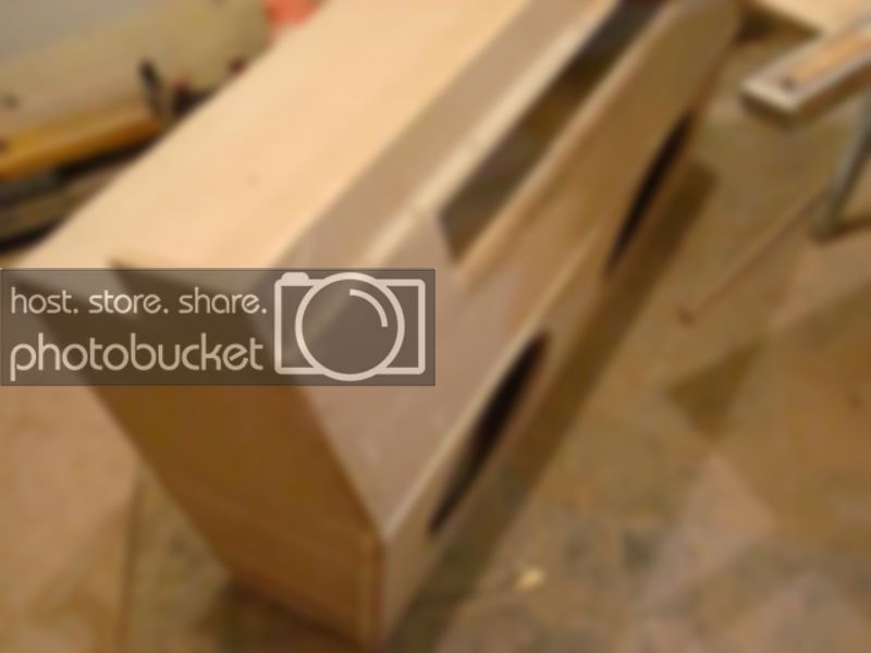

Port Cut-out, In, And rounded over

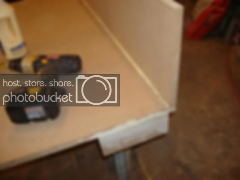

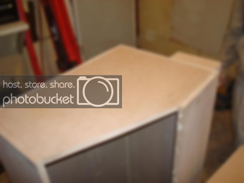

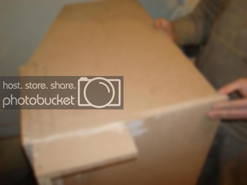

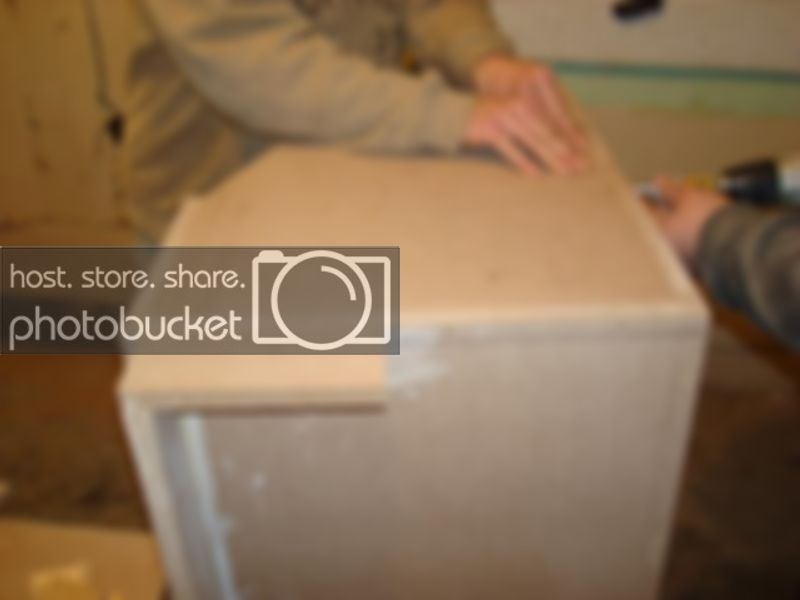

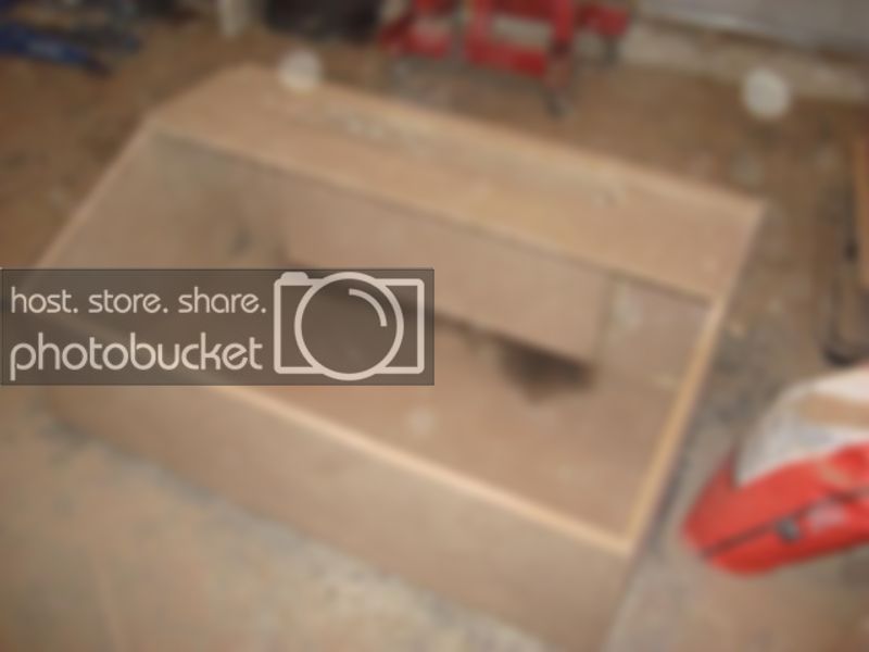

I ran into a little issue with the top piece fitting against the baffle, so I cut an angle on the top (not pictured, but you can kinda see it in these pix)

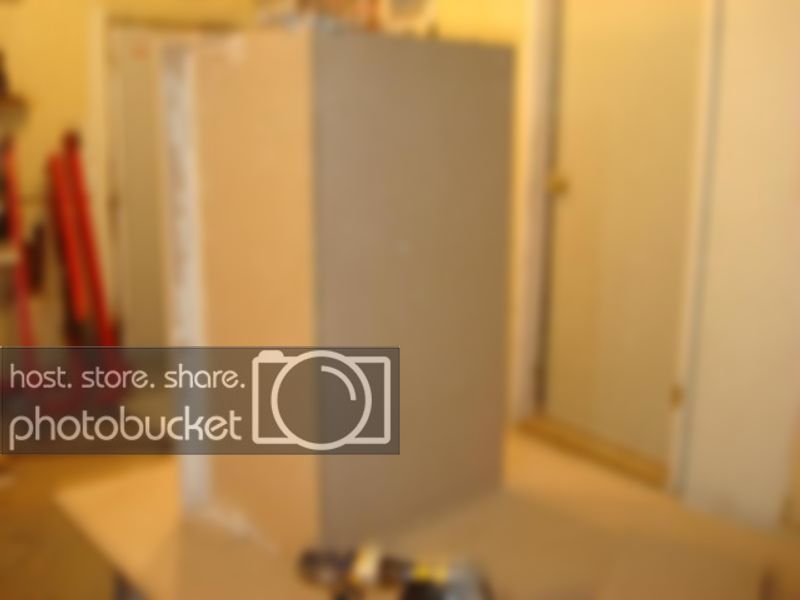

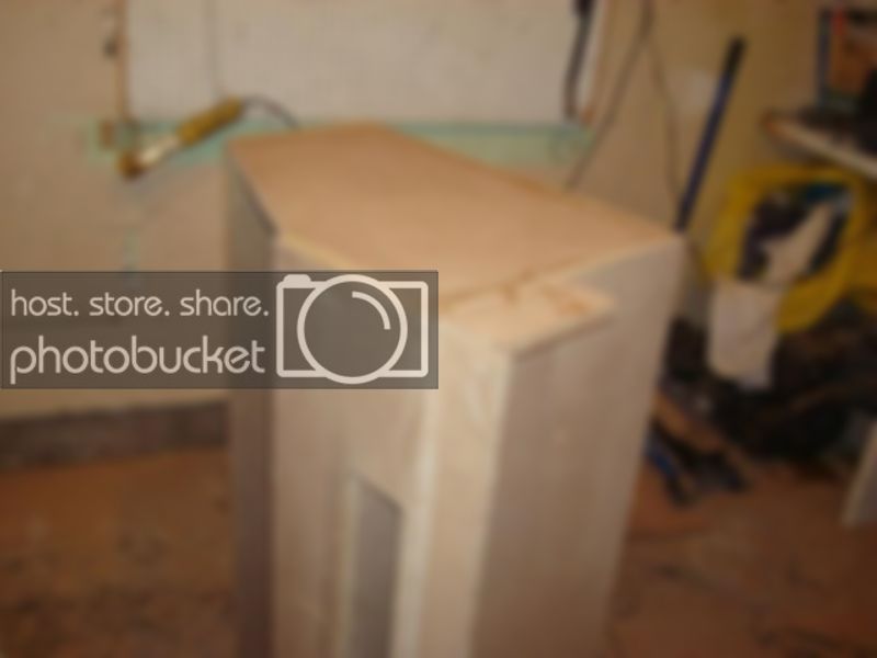

Little Spray Paint

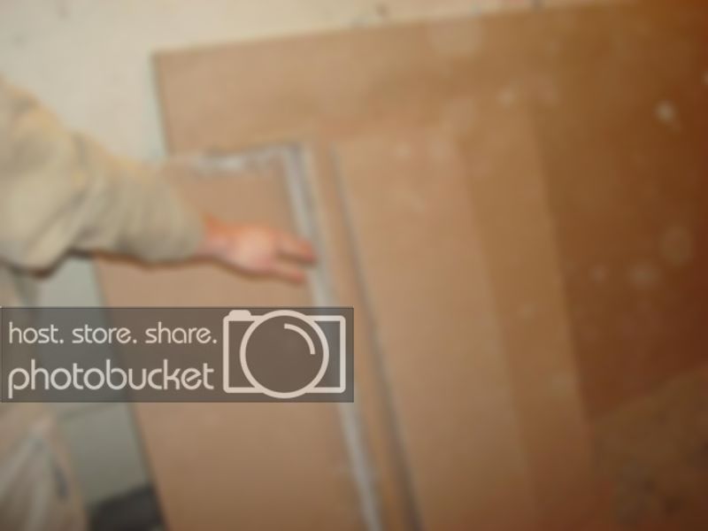

And this is how the box sat overnight. Quit at 6am Friday morning.

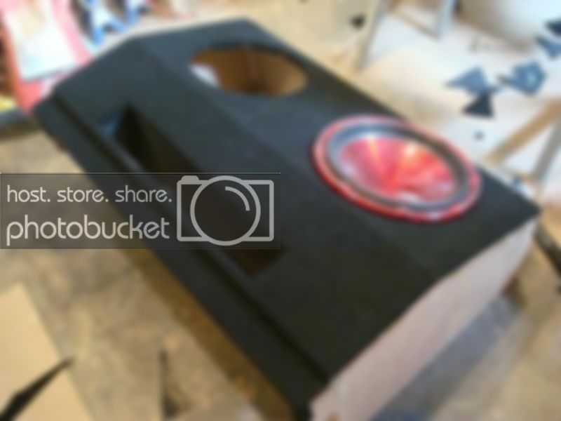

The holes were cut with a Jig saw. I don't have a circle jig for my router yet //content.invisioncic.com/y282845/emoticons/frown.gif.a3531fa0534503350665a1e957861287.gif

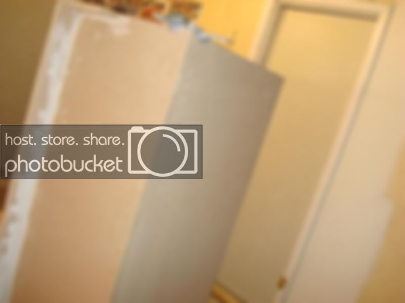

every inside seam was caulked:
SAND SAND SAND SAND (not pictured)

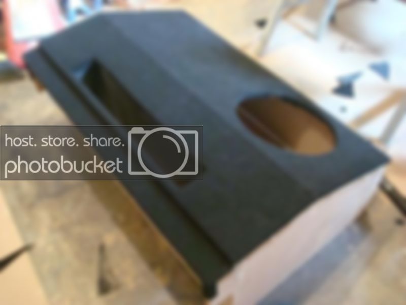

Port Sprayed & Glue adhesive
Material:

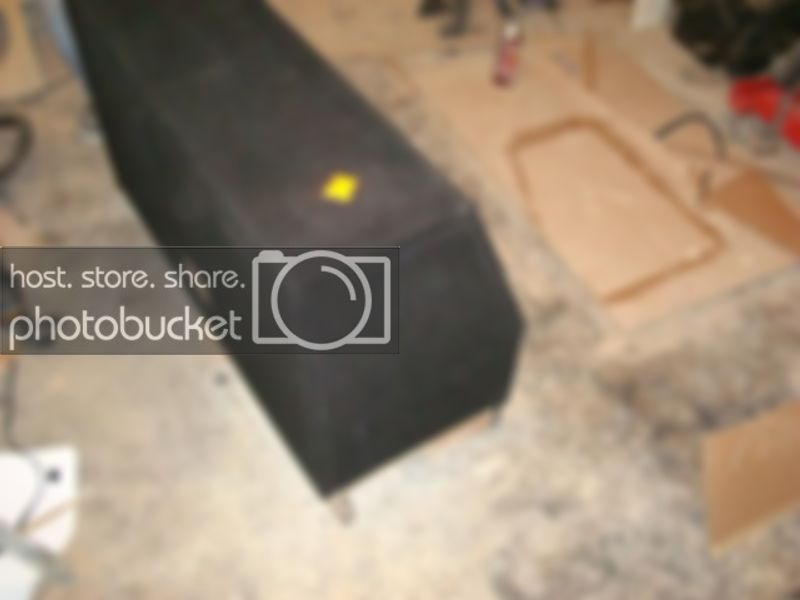

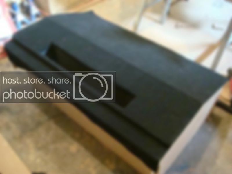

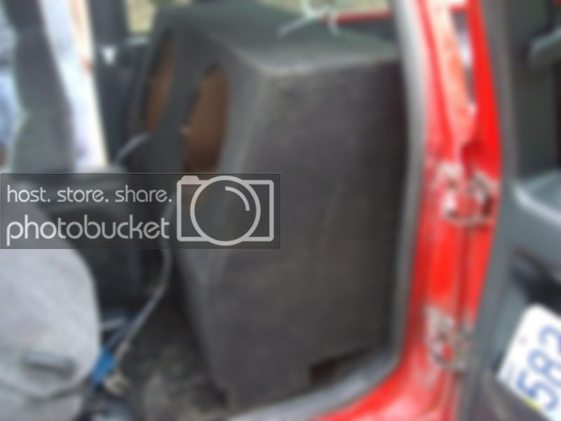

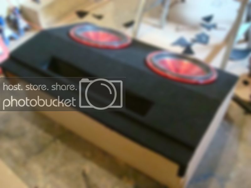

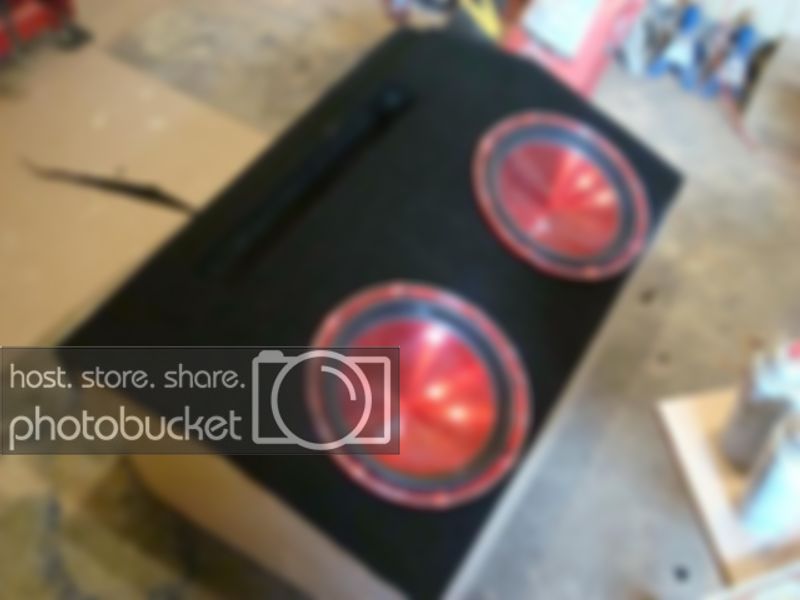

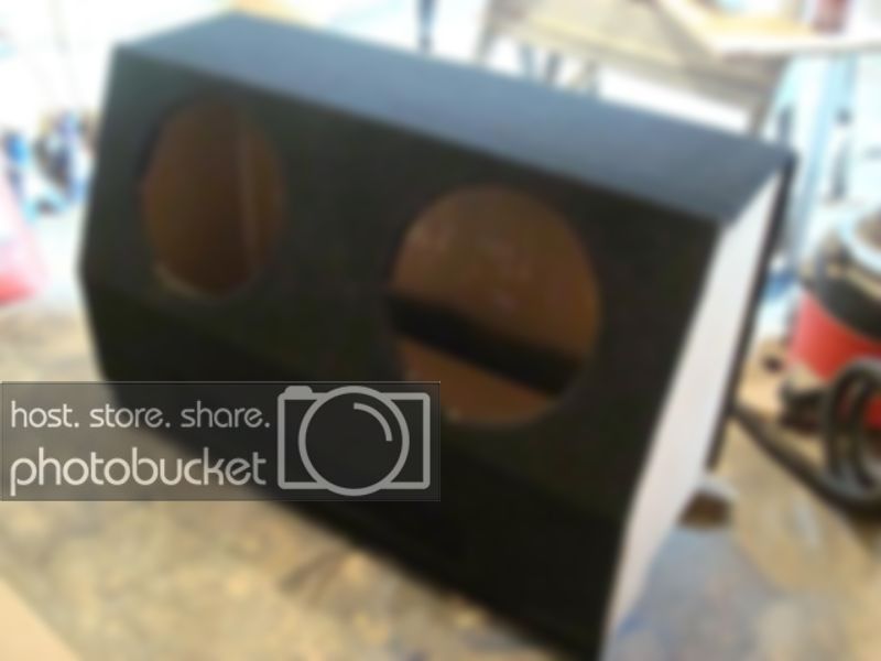

Full Box Carpeted
