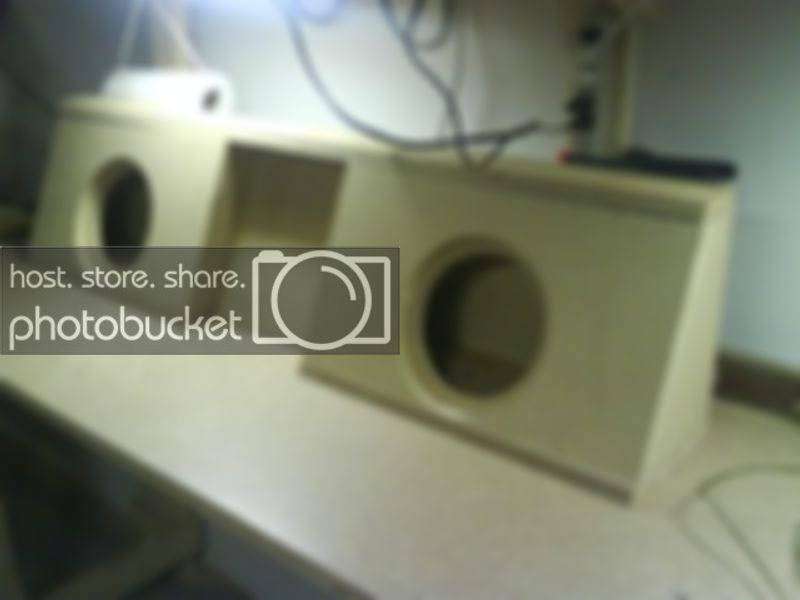

I made some more dust today with the radial arm saw (ripping angles) and the router for cutting circles which killed the bit so I moved to the jigsaw and finished up the circles. Only thing left to cut are the recessed pockets so the magnet doesn't hit the bottom or the back of the box. This box is tiny, made from a 3'x7'x3/4" MDF with about 5 square feet of scraps. It has taken me entirely too long to cut all the pieces.
I find it funny that my box took like 1/2 the time yours did to cut, and its ~4x bigger haha..
yours is also a rectangle plus you have the proper tools and are alot more motivated.
Anyways, I have the box mostly glued up except for the baffles and the top. It takes some time to glue it together with 4 bar clamps, some rope and walmart spring loaded clamps.

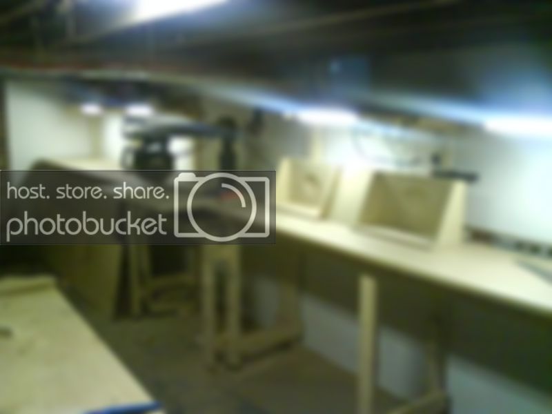

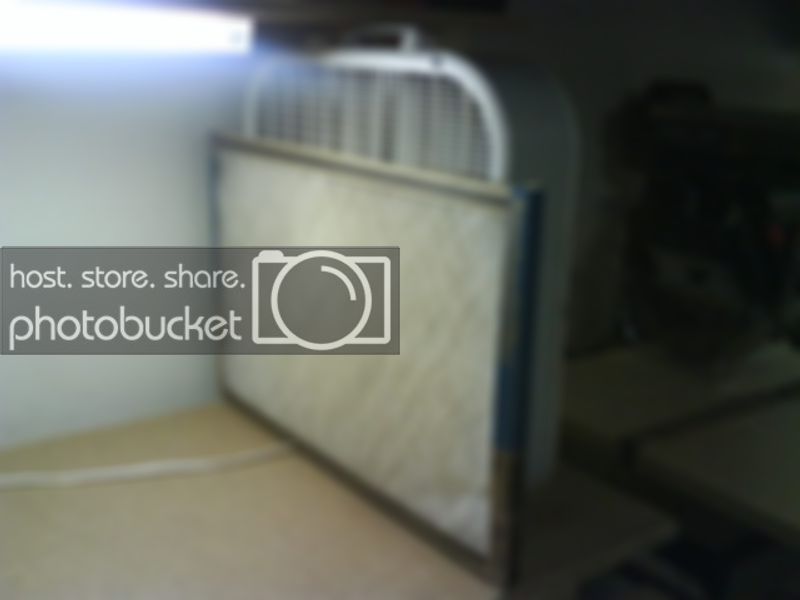

Air filter setup:

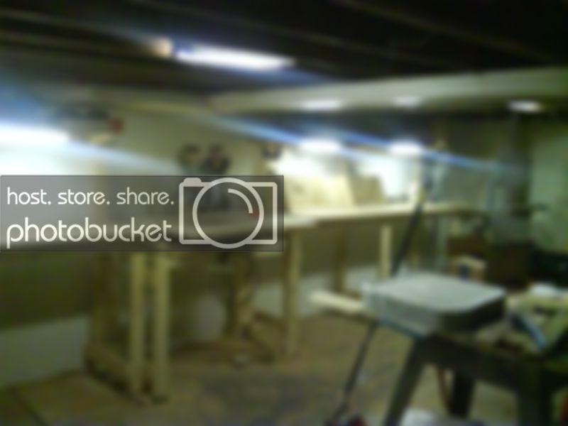

wow I like how you took pictures to show off your AWESOME work space //content.invisioncic.com/y282845/emoticons/wink.gif.608e3ea05f1a9f98611af0861652f8fb.gif
Looks great so far!
Looks great so far!
I can't tell if that is sarcasm or not.....
The workbench took 30 2x4x8's, 3 sheets of 3/4" ply and 1 sheet of 1/4" hardboard. Mounted lights are under cabinet models from walmart. I can rip a 4x8 sheet of plywood in half with this setup all by myself but it's kinda tricky and unsafe. I am at least 2 feet from the blade at all times to do this so it isn't too unsafe but the cut off sheet could fall.

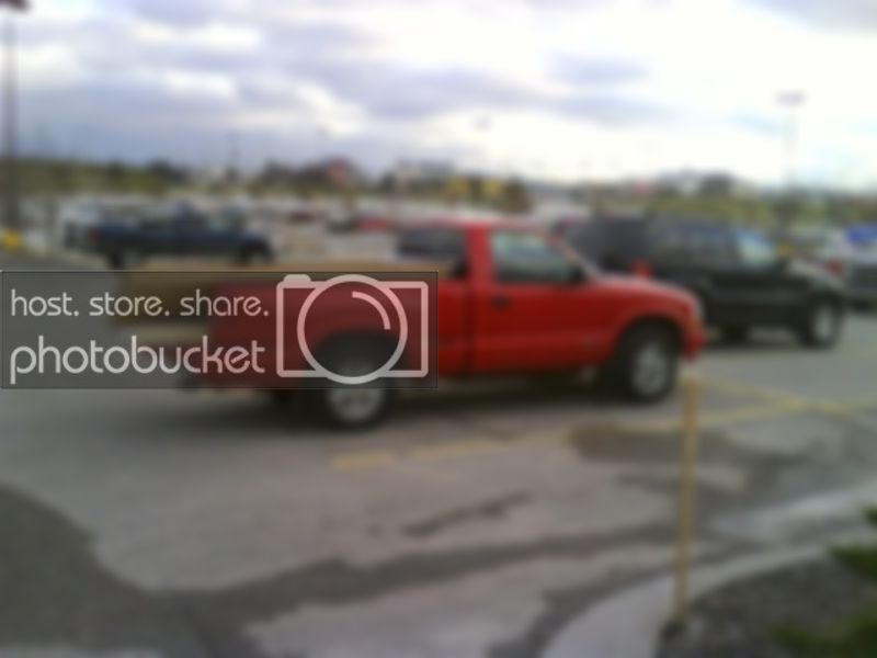

Heres a pic of my truck hauling the workbench
I dont think it was sarcasm, looks like you did pretty well with the space provided.
Then again maybe BJ is being awnry //content.invisioncic.com/y282845/emoticons/wink.gif.608e3ea05f1a9f98611af0861652f8fb.gif

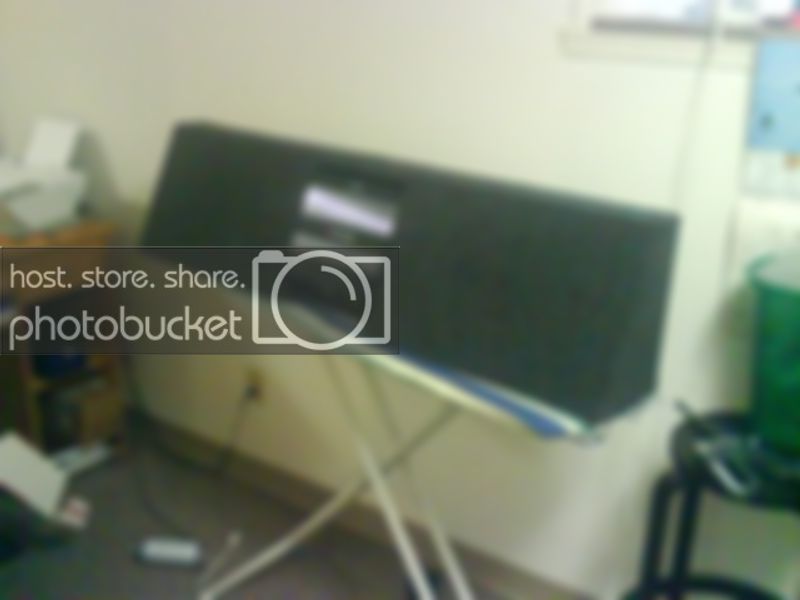

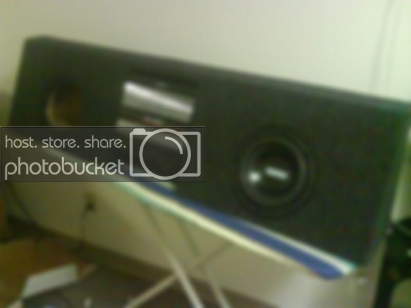

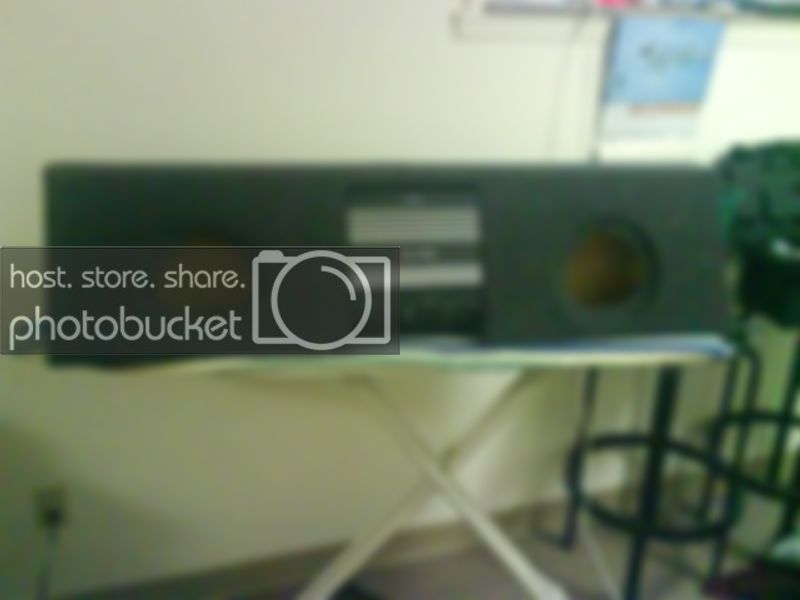

Well i finally got the carpet on the box, final install will happen tonight.
First pic includes chereck04 doing most of the work on the box, blurred out of course for his sake.
Sorry these are only camera phone pics, forgot the canon at home
I'm so disappointed we didn't get it in tonight, oh well. Tuesday will be here soon enough.
I concur, f-ing jack bracket and we don't have the tools not to mention it was 25 outside and dark. I will try a drill bit and chisel for the spot welds sometime soon
