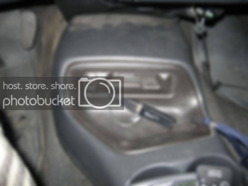

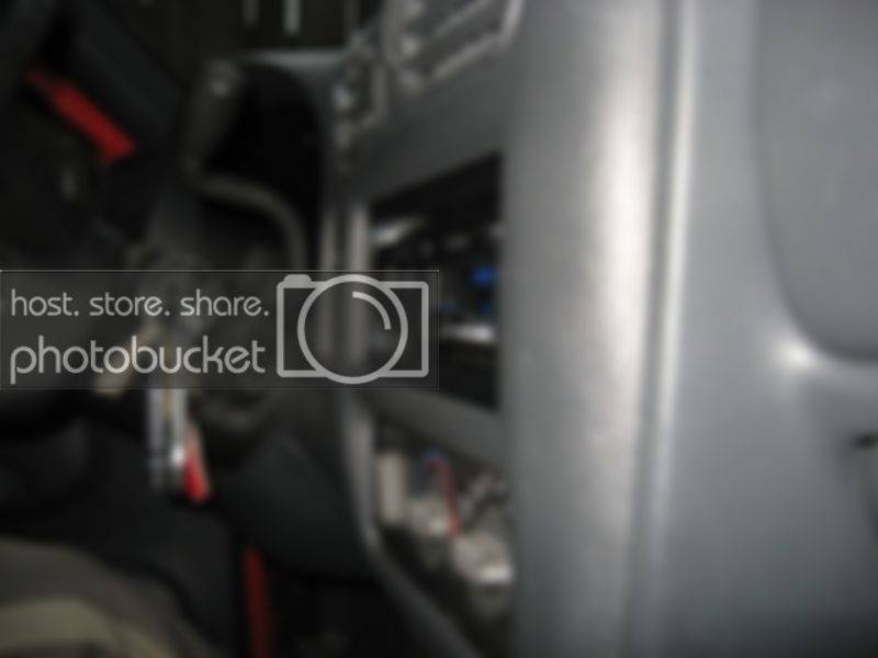

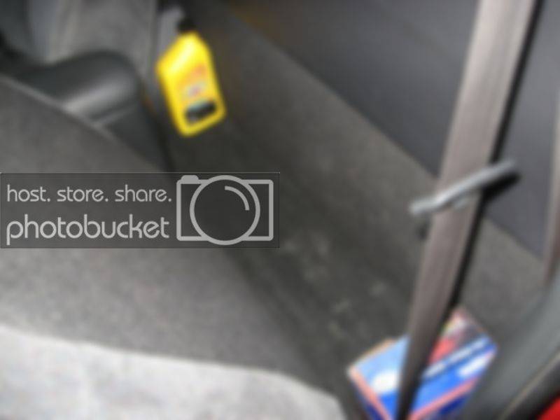

I have PICTURES! Only the Head Unit installed, where the box/amp/subs will go, and the amp. Ignore the dust, I haven't wiped down the surfaces recently. Changed to photobucket, pictures should load now....

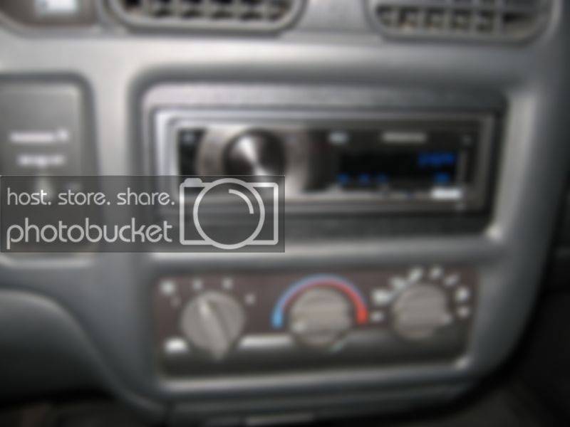

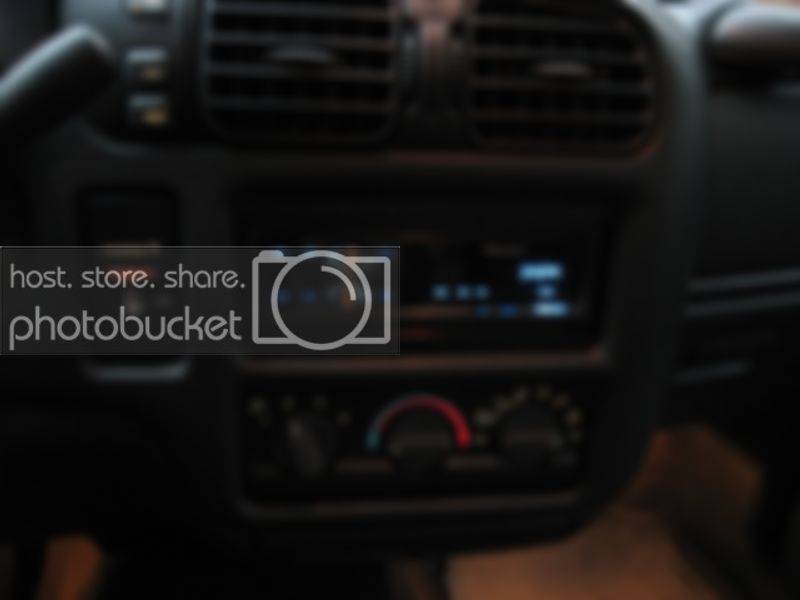

Flush Mounted (had to hack-saw the old radio support bracket)

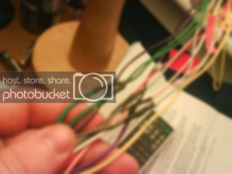

Properly soldered and heat-shrunk wires for the HU:
Where the subs will go, I'll be removing the jack so I'll have the whole width of the cab to work with:
Not much space to work with.... 9" on the bottom, 13" on the back and 3" on the top:

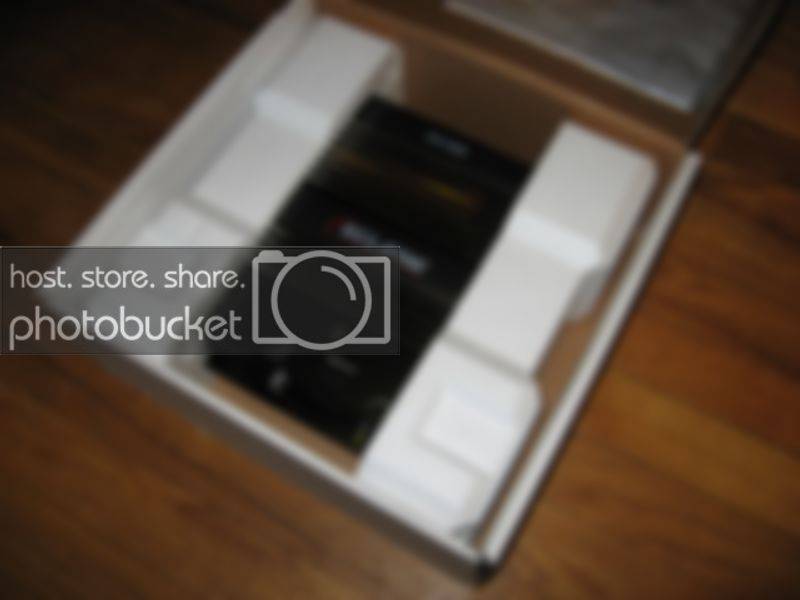

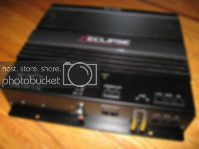

Who would have thunk you could get 480watts RMS for $122 shipped brand spanking new? Oh and it's small which is great for my application.

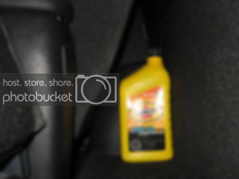

It's half full and I believe shipping would cost more than $5 IF I could ship it, would they allow flammable liquids to be shipped?
i think he was joking
I Know he was joking, mainly in reference to my statements of prices and the fact that they were shipped.....besides, who would wan one bottle of pennzoil for more than what it's worth in the store?

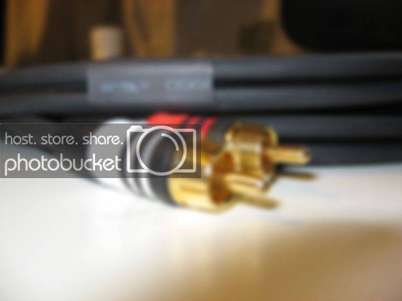

I know this isn't exactly equipment but necessary for the install anyways. I've chosen monoprice.com for my RCA cables, most everyone on here uses knukoncept wires which I don't doubt are awesome but I feel a coaxially shielded RG-59/U cable can do better. I encourage everyone to check out monoprice.com for good deals on most if not all of your A/V connectivity solutions. Disclaimer: I am not affiliated with this company in any manner.

The e8 drivers have a mounting depth of 4.25" and i'll be recessing them into the front baffle a bit so they don't rub the seat backs. I don't know the exact dimensions of the magnets on the drivers but it looks like I'll need to use a router to carve clearance pockets on the bottom and back of the box. I'll be using some sort of grill too, probably modified kitchen cabinet handles (they're called pulls). My outer box dimensions now will be 8" across the bottom with 7" for the center console, 12" tall up to the plastic trim panel and 3" across the top from the back wall to the back of the seat. length will be 50.75" and that'll be tight with the existing trim.
