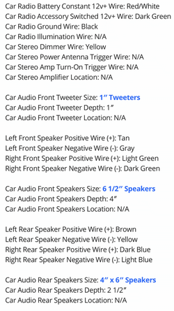

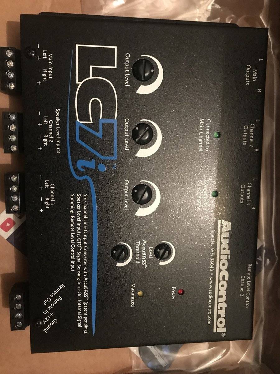

Ok update I picked up a lc7i converter and have it in the rear by my amp. I tapped into the speaker wires at the b pillars by the sill plate. It sounds good for the time being.  Black Friday shopping yielded me a alpine 4 ch amp. Question for you Chevy/gmc crew cab owners who has pics of amp racks.  Looking for ideas.  And still searching for front speakers and rear door speakers.

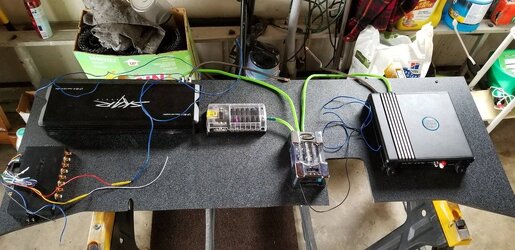

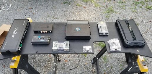

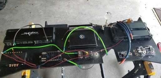

Heres mine, the 1st picture is my current rack after I got a new box and was able to move some things under the seats. Put a piece of black abs over the wood, was planning how the wires were going to run... The rest of the pictures are my 1st version that was spray painted black plywood and had all my amps/components on it at the time.
