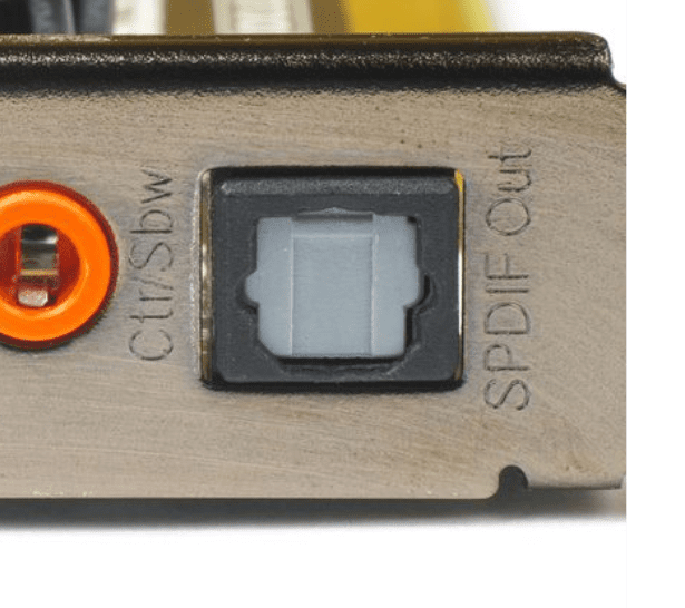

Does the amp have one of these ports?
It looks like your amp uses a digital audio signal (spdif). So no way to test that audio signal with a multimeter. I guess your best bet is to buy a used amp and hope it is the issue.
