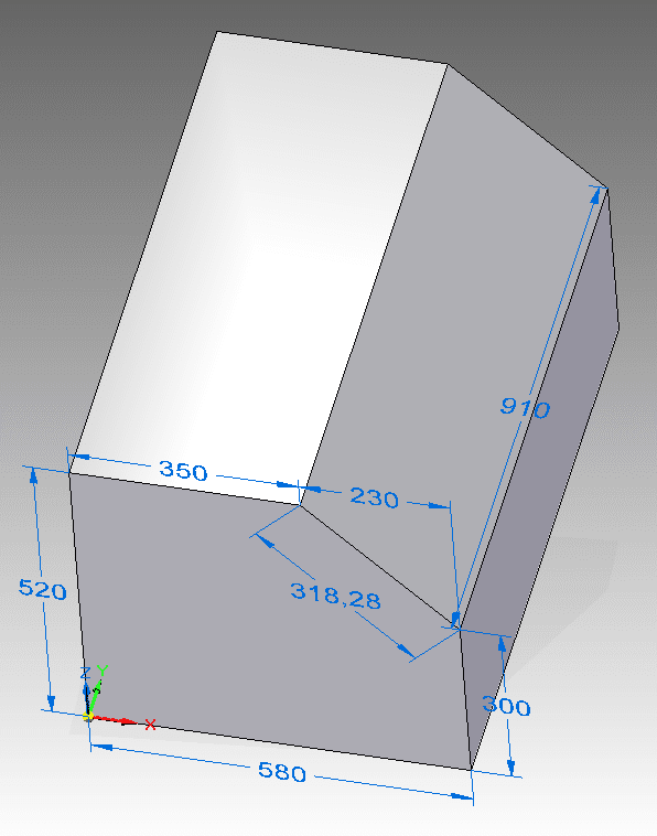

specs:
Sub: American Bass XFL 1522
Power: Whatever an APSM1500 puts out... so probs around 1300wrms
Wood: 17mm birch structural plywood (about 0.67") + double baffle for sub
Ports: Slot port facing up, sub facing sideways inside
Aims: Good response between 25-45hz, decent output between 20-60hz. I tend to listen to a fair bit of rap when I'm in my car so I do enjoy the lows. I guess it would be an SQL box, don't care much for high numbers on high notes, but I do like loud lows and don't care too much for group delay.
For max dimensions I'm in australia so everything for me is in mm, the conversion factor is 1" = 25.4mm. I have here my max dimensions in mm and the software I use won't let me use inches.
Like I said, it's completely up to you if you decide to give it a shot but I'm having a hard time finding a starting point. Any help appreciated, otherwise don't worry about it.
Cheers.

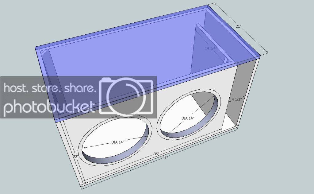

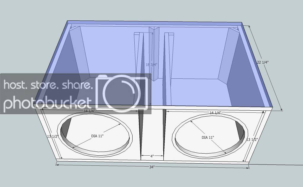

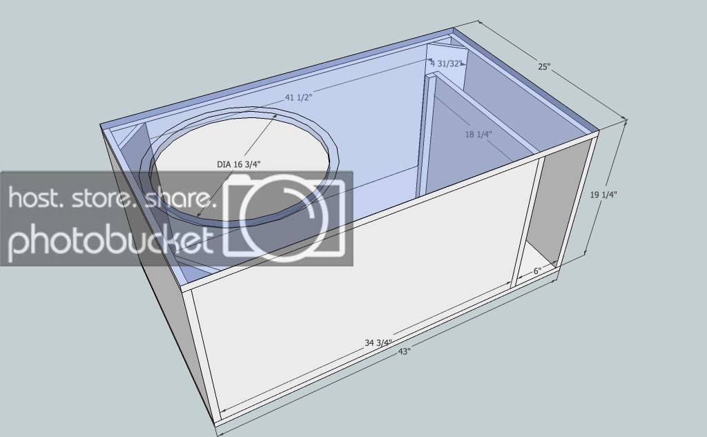

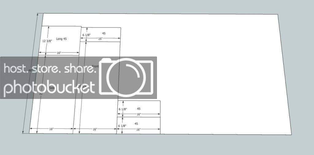

Here are some of the boxes that I have drawn in the past if you are in a rush for a fast design or if you don't need a general design.
Enclosure for DD 2515 3ft^3 33Hz
Enclosure for 2 DC M2 15's 7ft^3 34.5Hz
Enclosure for FI SP4 7.9ft^3 31.75Hz
Enclosure for 2 PSI/Type X hybrid 12's 3.8ft^3 34Hz
Enclosure for 2 SA-12's 4ft^3 31.7Hz
Enclosure for Soundstream T7 2.25ft^3 33.25Hz
Enclosure for SP4 18 8ft^3 32Hz The person that bought the design built the first one though since I wasn't positive on the port for reasons I don't remember.

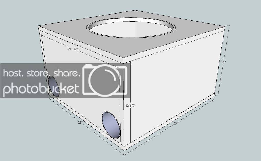

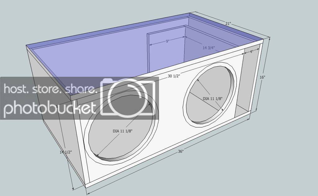

What I designed today for an AT Strato 15 in a Tiburon 3.85ft^3 net, 33Hz tune and 15.75in/ft^3 of port area.
I just built a box for my tiburon 35.5w/15.5h/22d and I'm going to have to go through this weekend and round edges and sand down a corner of the double baffle to get it to fit and the rear seats to latch shut. So he will probablly have to do the same.

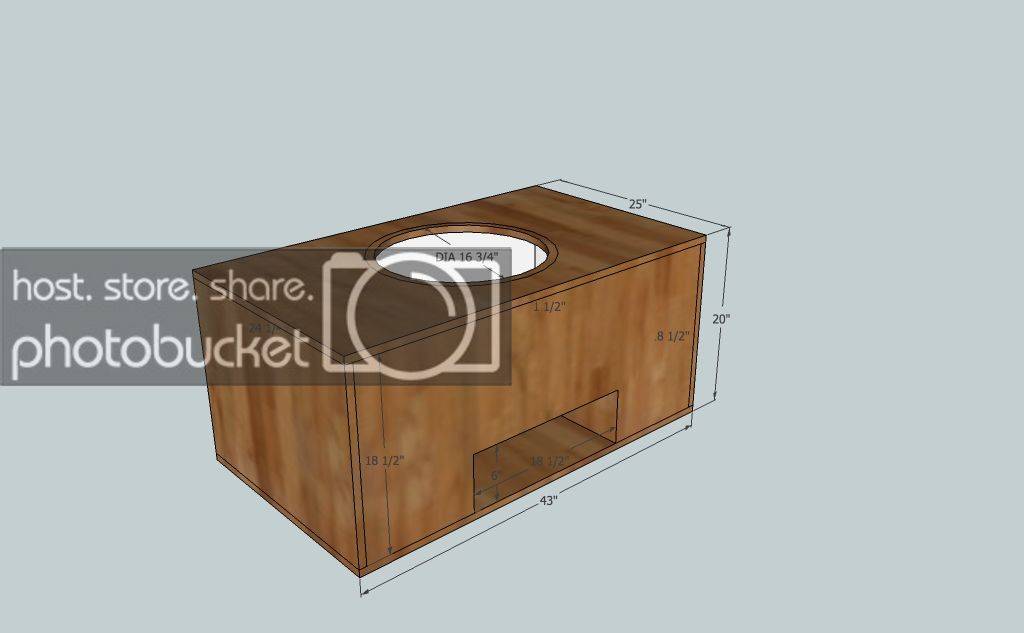

If you could design one to my current dimensions for an AQ HDC315 on 2200 watts. Sub up/ Slot Port up or forward (whichever you think would sound louder)
I listen to alot of Decaf so tuning lower than my current 35 wouldn't hurt.
My box is 4.0 cuft, heard thats what these like with ~16sqin per cuft of port
Also idk if double baffle flush mount or bracing would be better or if it makes a difference.
I can cut 45's, the one in the pic is 2.75" the point of the port to the 45 is 3.25"
Heres a pic:
http://s1141.photobucket.com/user/Tmartin1475/media/aqboxwithdim2_zpsce1d8e1c.png.html
After messing around on sketchup i think i made my port close to 26.5" long with that 45 messing up my tuning. Is it possible to just cut another 20.5"w piece ~10.5 inches long and butt it up to the existing port to lower my tuning or should I just worry about it when I build the box for the 2200 watt amp? (this is for my overrated 1k amp)
(final edit) ofc i cant stretch port cause i would lose box volume
