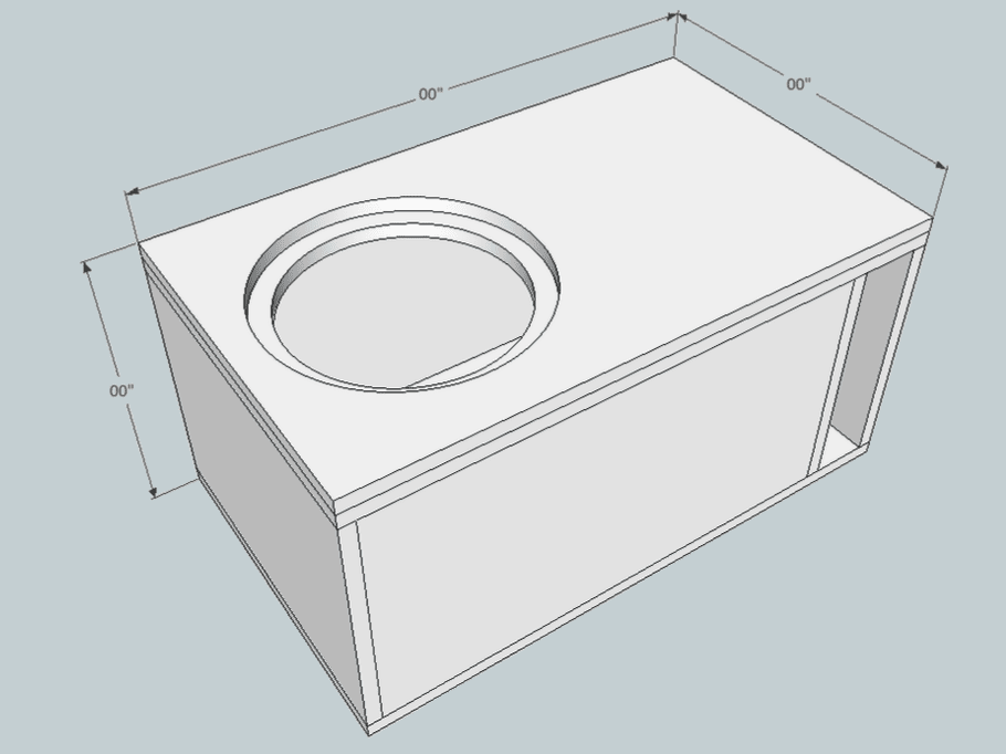

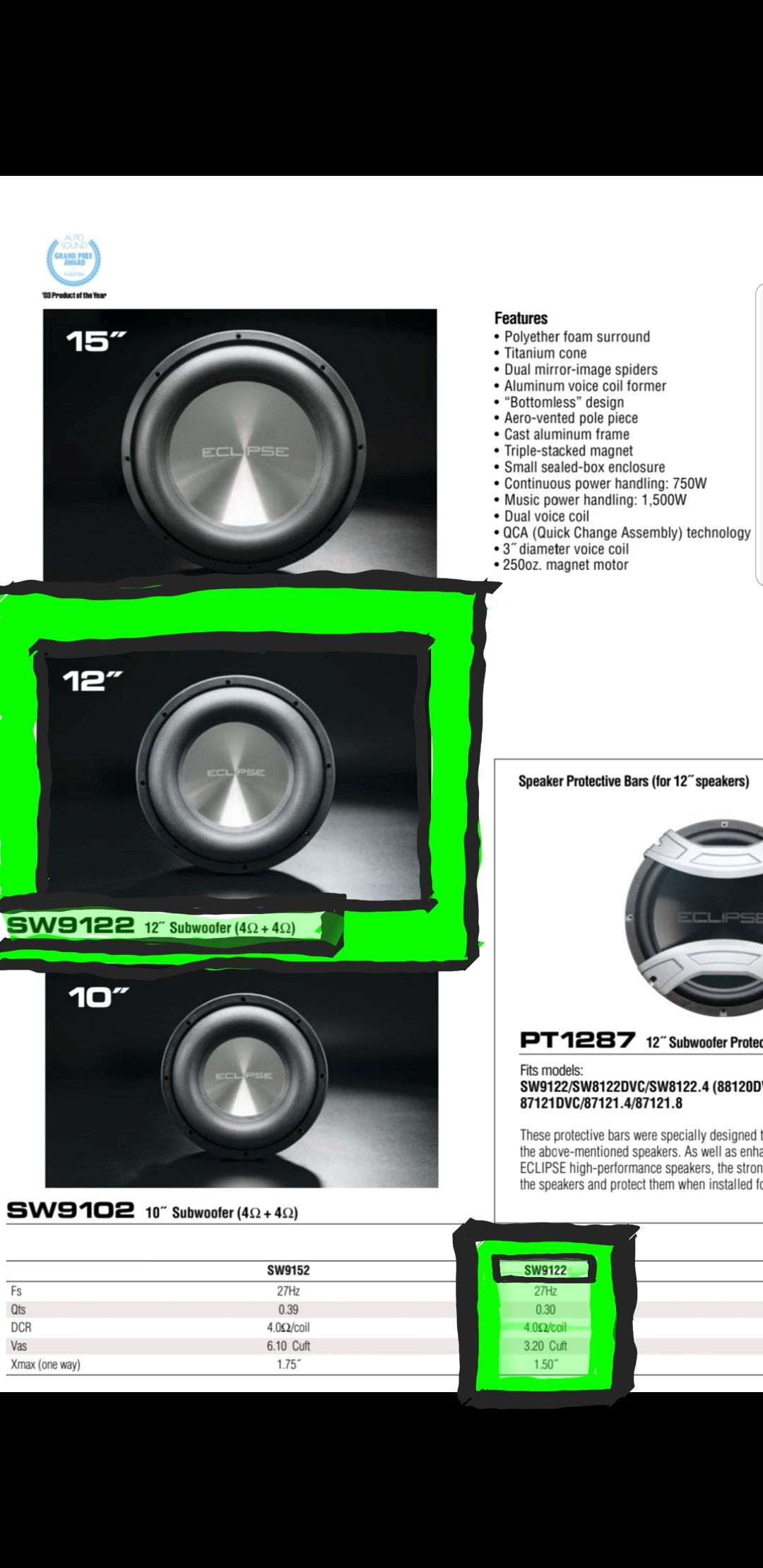

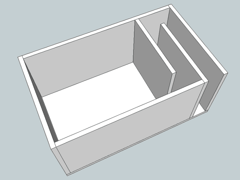

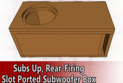

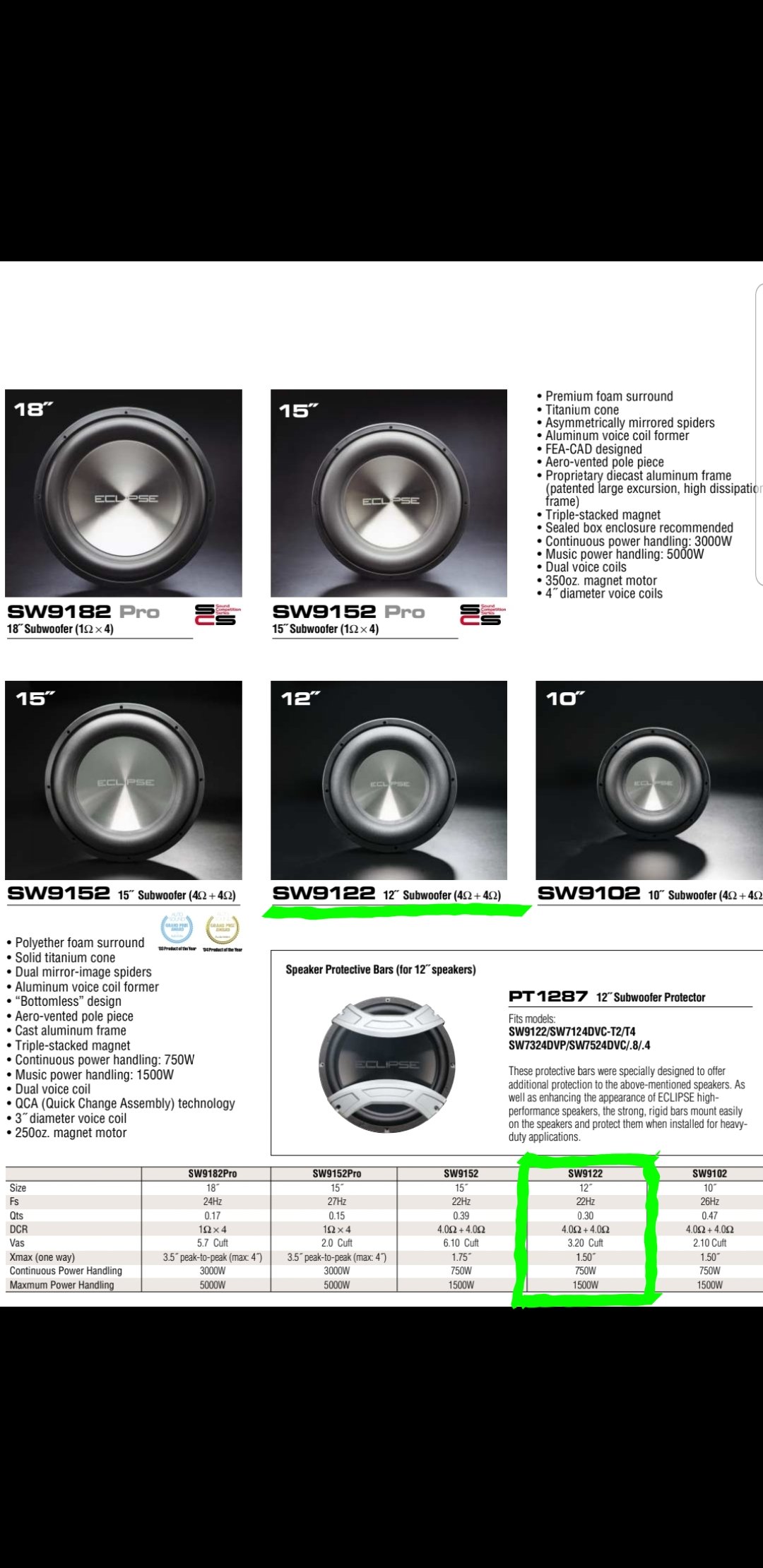

Recently got another 12" Eclipse titanium SW9122 but instead of a small sealed enclosure, I'm wanting to go with a ported box but dont know how exactly how big of a box to build nor the port tuning...Its going in a Jeep Grand Cherokee Laredo so I have quite a bit of room in the back. Ended up going with a Skar RP1200.1D amp to run the single 12in eclipse titanium but could use some help & advice. I attached the specs of the "12 Eclipse Titanium SW9122DVC sub & also what type of box I'd like to make but wood is also alot too and will probably need (2) sheets of MDF $40ea along with all the other stuff I need so should I even build one or find a decent prebuilt?

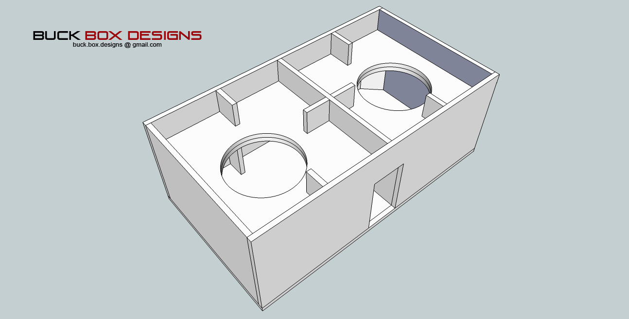

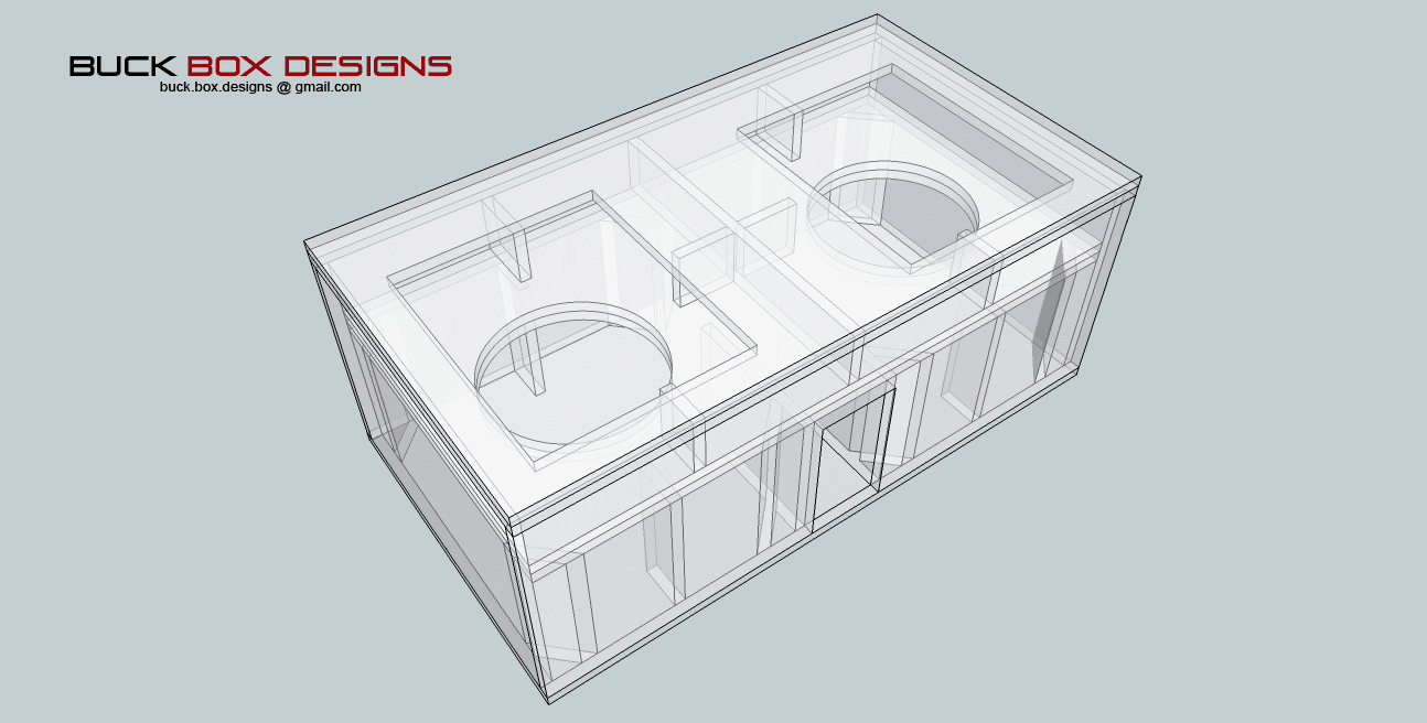

I think I can help you out here. I've designed for these woofers before, like your problem of trying to find box specs is always a problem with these subs.
I would totally do a custom.
IIRC, these subs like slightly smaller boxes. I have a 4th order saved for 2 of these for an SUV, anyways. I turned out really well.
I did this in 2015:
30806
30805
So just let me know. These subs are soft and work well in 4th orders. You see that Fs of 22 hz on that sub? That's really low for a 12, but that's part of an indicator that they would possibly like sealed. Just let me know, and I'll see if I can source any further t/s parameters to help understand the woofer and how it's going to act in different boxes.
