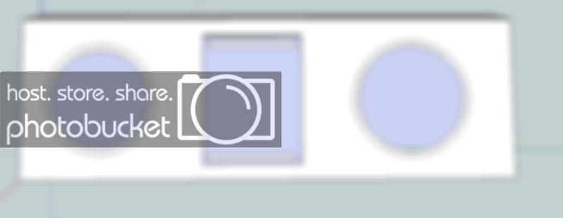

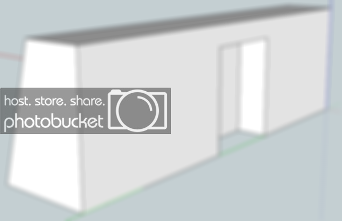

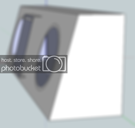

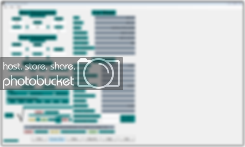

okay so i designed this box on google sketchup and just wanted to know what you guys thing below is the measurements in the torres box tunning program
Recommended Enclosure Specifications
Minimum Sealed Box Volume 0.50 cubic feet
Maximum Sealed Box Volume 0.75 cubic feet
Minimum Ported Box Volume 1.40 cubic feet
Maximum Ported Box Volume 1.40 cubic feet
Vehicle : 1991 toyota pickup
Location in the vehicle: behind seats
Space available (Length x Width x Height):45"x7"x5"x14"
Subwoofer make and model: rockford fosgate rs2d2 shalow mount
Subwoofer Size: 10"
Number of Subwoofers: 2
Type of Port (Kerfed, Slot, Aero, etc.): dont think its possible with space
What type of music do you like?: mostly rap
Is your goal SPL or Everyday Music?: more bass the better
Tuning Freq (Hz): not sure if you can tune a ported box
Volume : 1.41 cubes
Questions: is this setup gonna work and sound good for what i want
