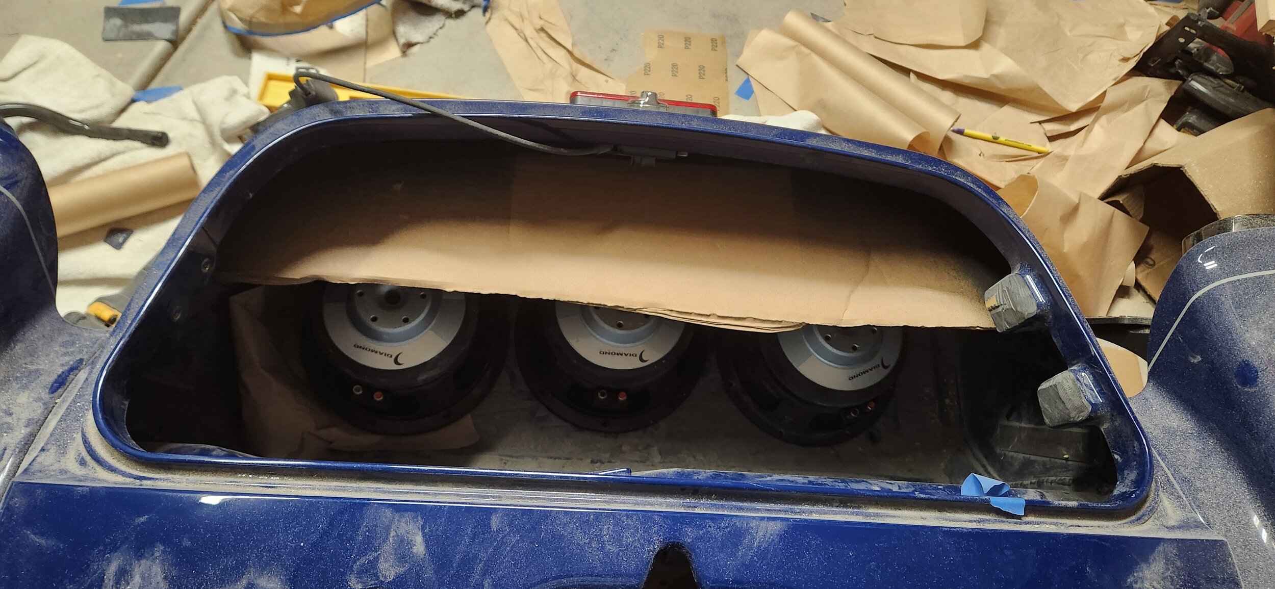

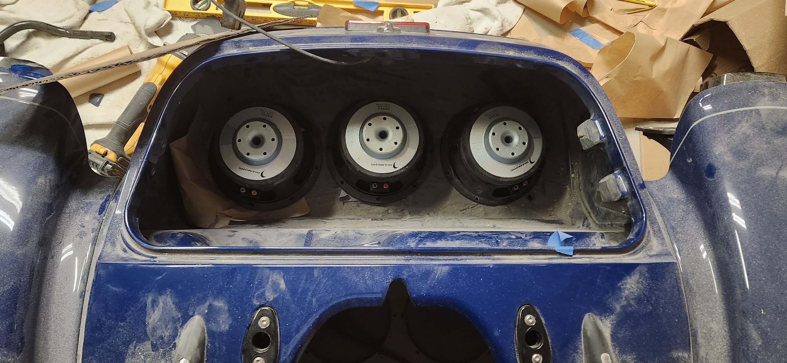

Being a trike it has a small "trunk". I'm trying to put 3 8"s in it. At first I was going to build a box, but 3/4" MDF eats so much of the little volume I have, it's not a good idea.
My plan is just to make the trunk itself part of the box, and lay a perfectly flush panel of plexiglass over the 3 down firing 8" subs.

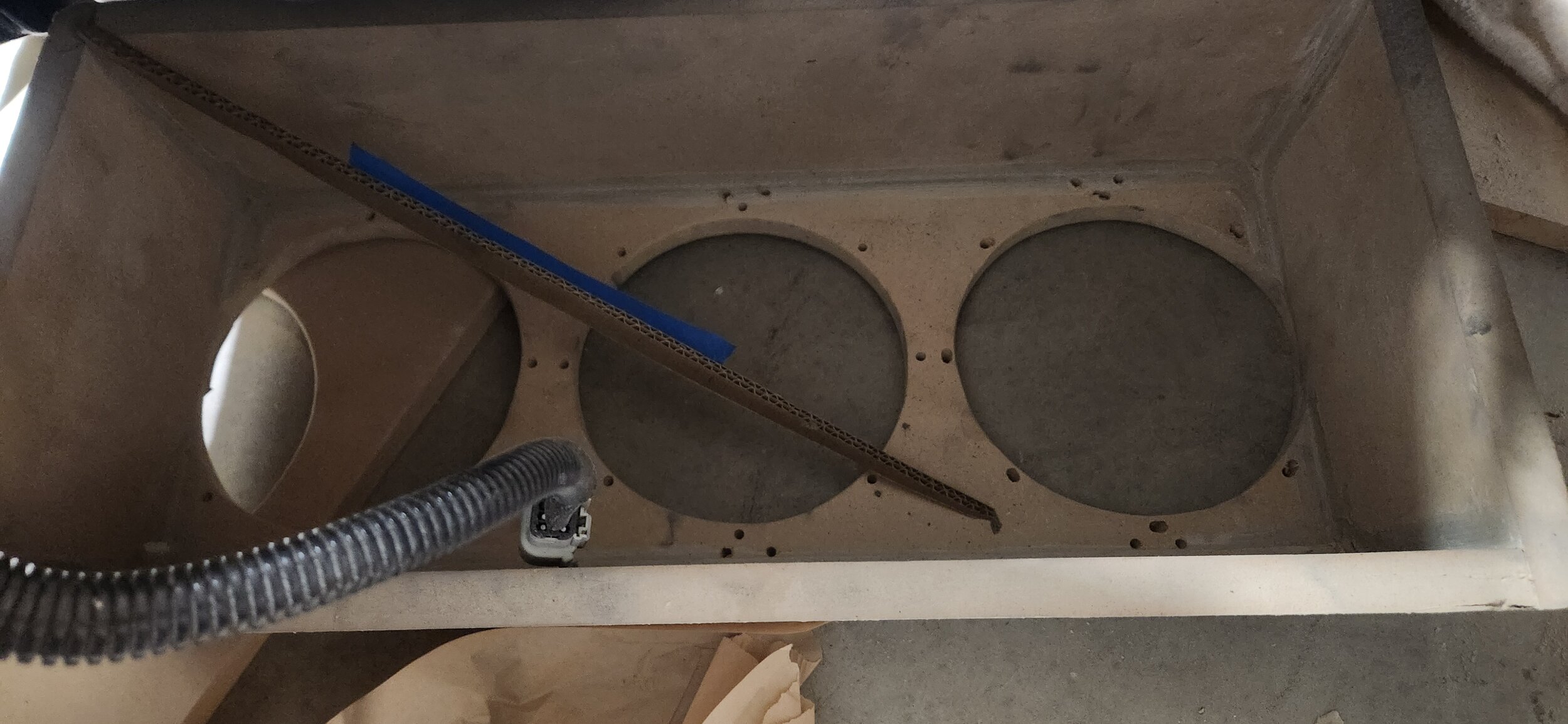

I would like the plexiglass to go where the cardboard is on the second picture.

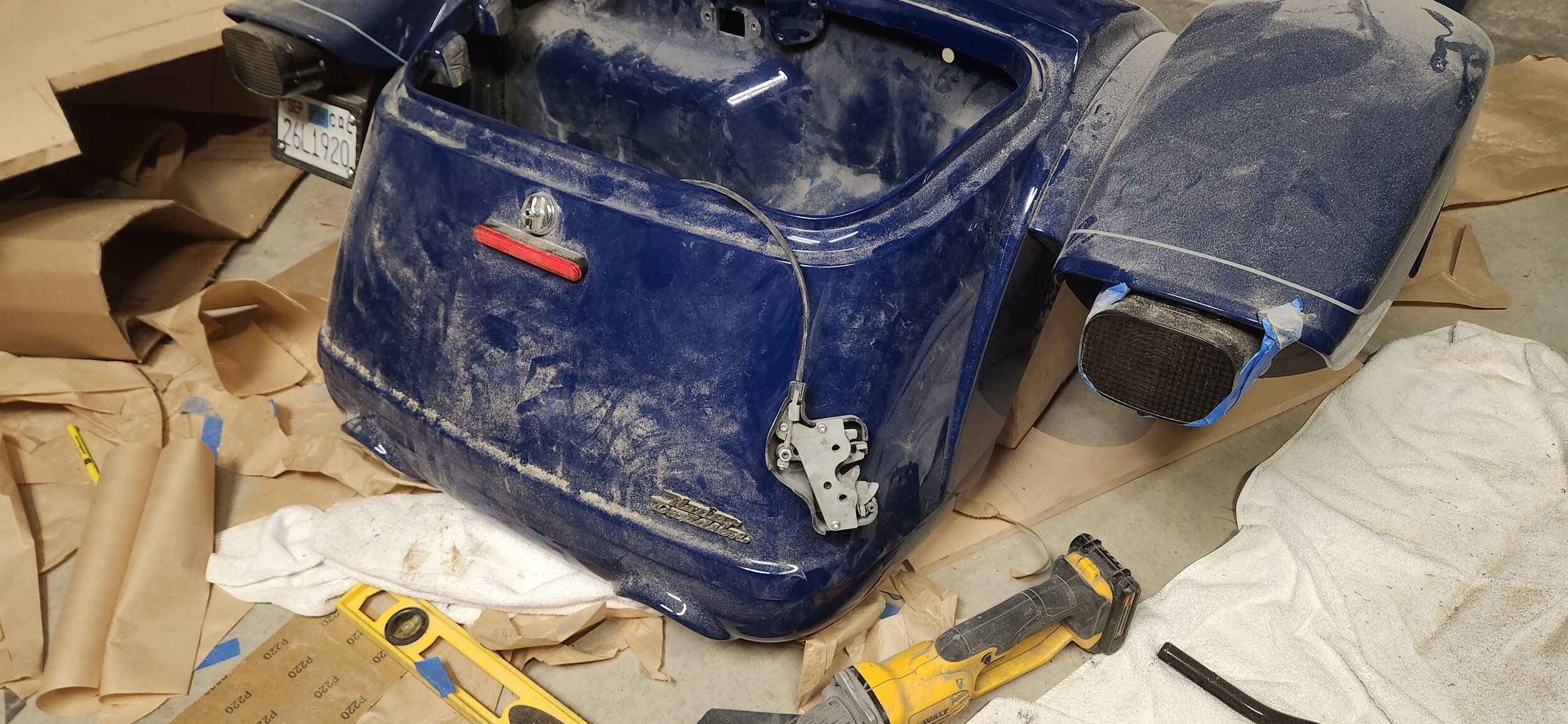

The trunk has so many angles arcs going on. I'm totally lost.

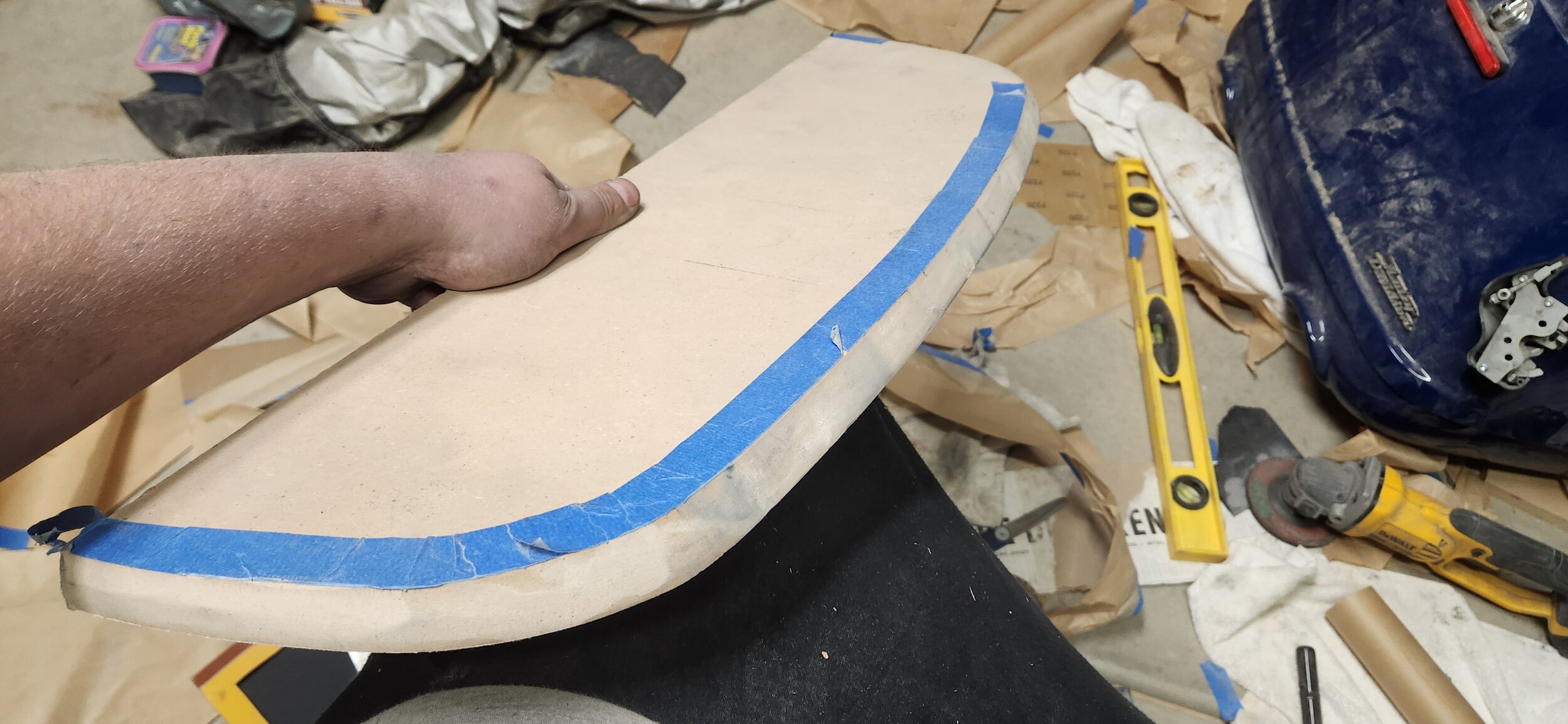

I spent 4 hours trying to make what I thought would be a template out of MDF and I botched the whole thing.
I also built a sealed box, but it's so small, if I could just put a plexiglass panel to seal the subs, I could basically double my volume and go from the bare minimum Sq ft for the smallest sealed box to a decent sized ported box.

When I said down firing I mean the subs are pointed downwards, I'm going to make a 1" spacer between the sub and the trunk floor, that way when tbe subwoofer is hitting and moving back and forth, it won't hit the trunk floor.
Instead of cutting an actual hole in the trunk floor for the subs, I'm going to use a drill and drill rows of holes until the trunk floor almost makes a mesh pattern. This will protect any rocks or Debris from hitting the subs as they will be otherwise exposed to the undercarriage.
Think what the grill looks like on a GMC Denali. I'm going t2o put a pattern like that in a hole shape for each of the 3 subs.
If I were to use an mdf speaker box (like the one I made), I wouldn't have enough volume for 3 subs. If I used the trunk itself as a box, I'd have copious room for 3 subs.
This brings me back to my original dilemma, how can I make a template of the exact angles of the trunk so I can make a plexiglass panel to seal off the subs? If viewing the trunk from the top (birds eye view) there's no straight lines, there's a mild curve on the parts that almost appear straight. If viewing the trunk from the side, the back of the trunk slants at an angle. It's pretty complicated and I need to make a very snug surface.
Once again, this MDF template is close but no cigar and it took me around 5 hours to make it!
