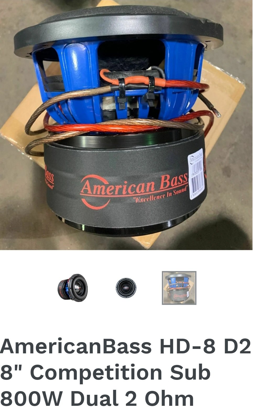

I went with two of these for my next build. I want to put them in a 2 cube net box after port and sub displacement. I'm going to put 2K on them. AB HD8.

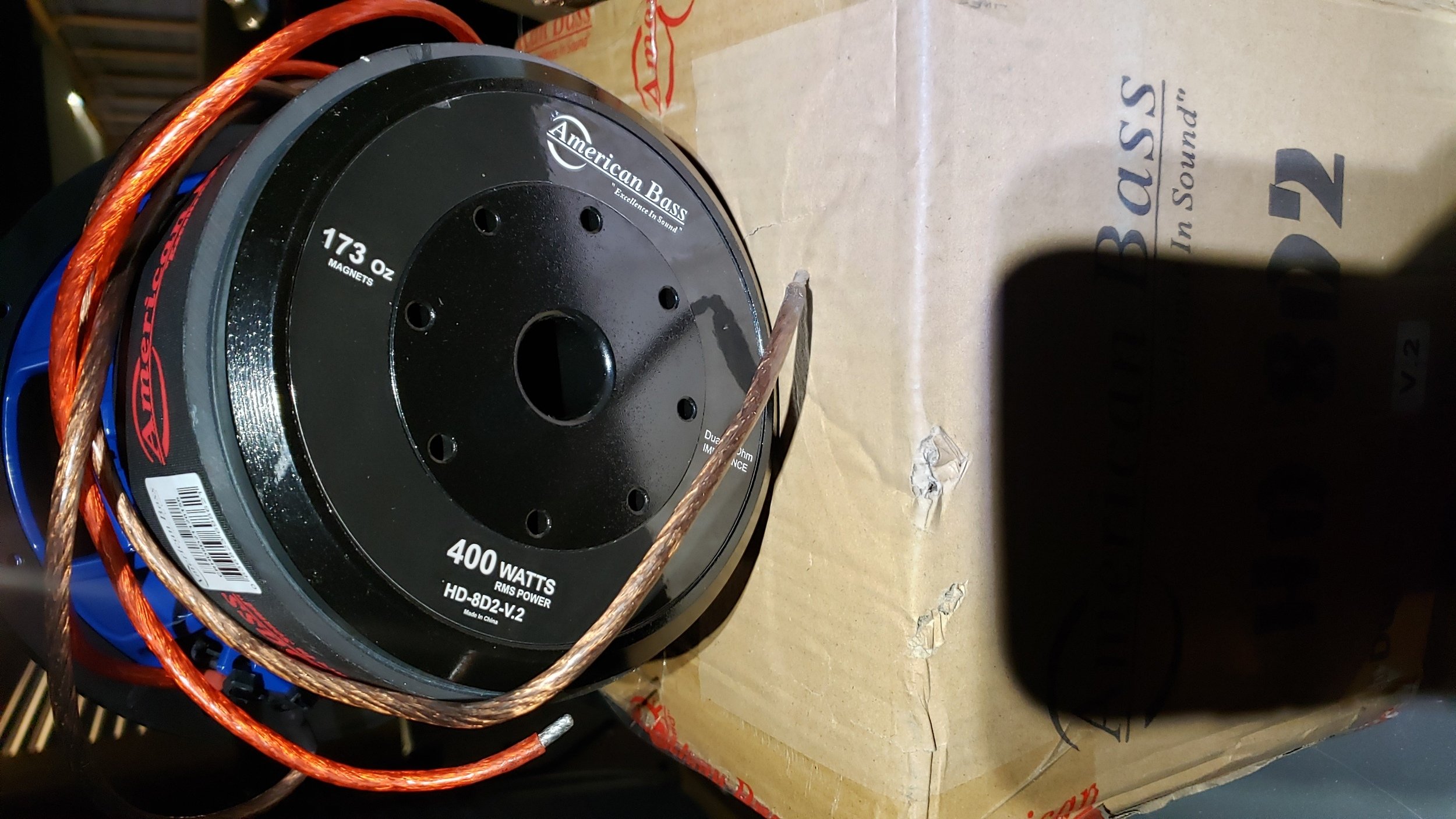

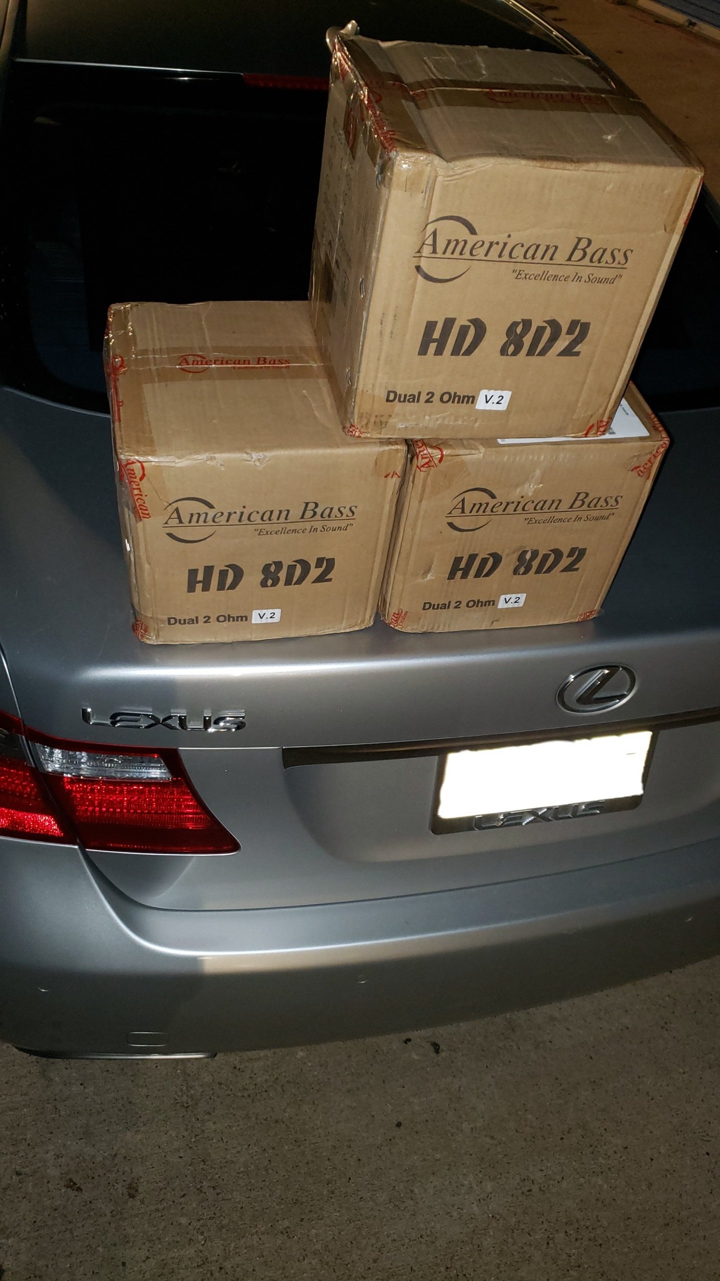

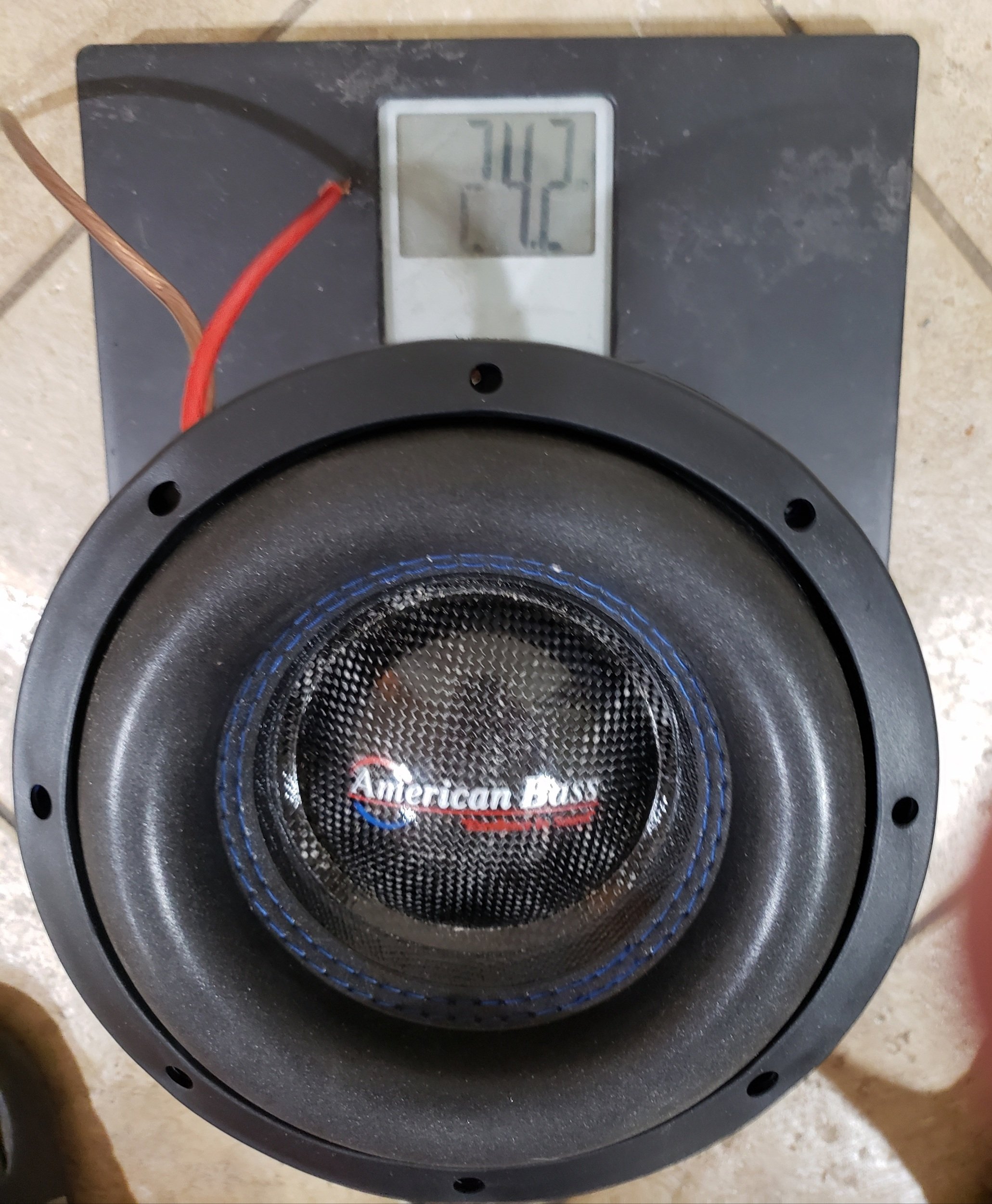

I just got 3 of them. I'm thinking about trying a Soundstream txp1.12000d, but it is probably a bad move? It didn't come with box recommendations, but the previous black basket model said 1.1 cu ft? Is the magnet weight 150 or 173oz?

If you do a ton of power, you can go smaller on the box size, to an extent. Usually AB's subs do good in about 1 cubic feet per 8 for ported. Don't go too small though, you'll keep the woofer from moving too much at certain resonances and it'll kill some frequency ranges.
That's quite a large motor for an 8", I bet they could probably take 800 watts on music if it's clean, maybe above 30-35 hz or so. But you'd have to be very mindful if you're overpowering woofers that much, especially on low notes. That's one reason I like putting woofers in 6th orders, you can use all of the power and both the front and rear wave can be absolutely controlled for massive bass.

What vehicle are those 3 8's going into man?
