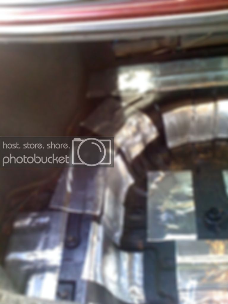

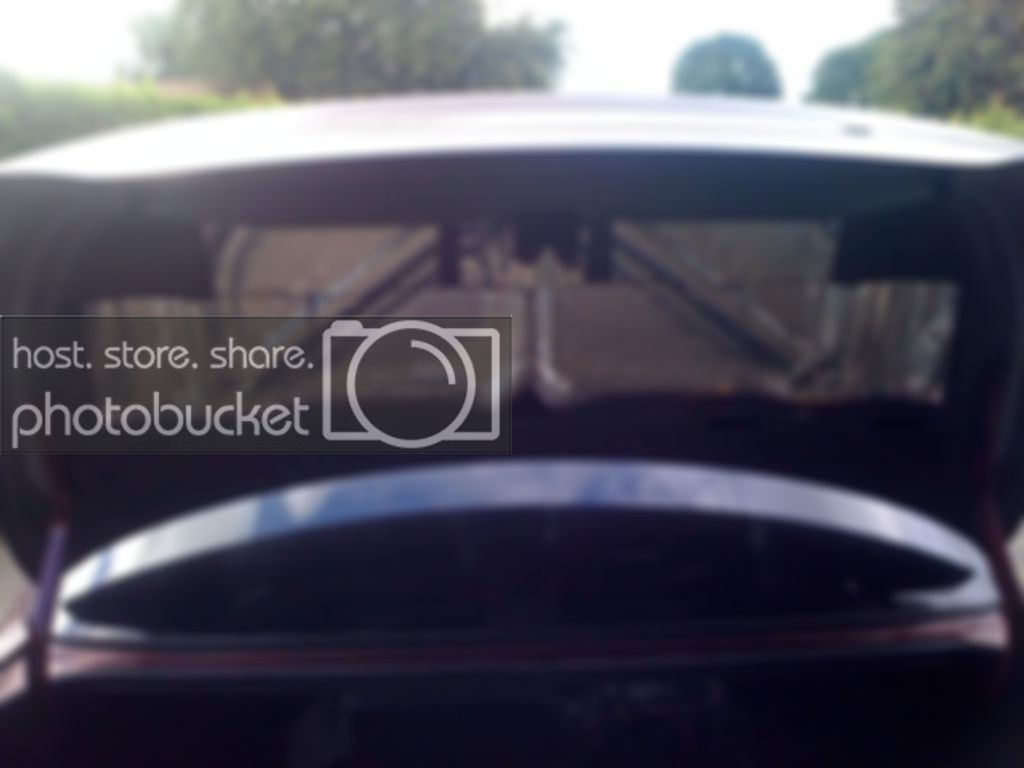

added some SDS CLD tiled to the trunk lid and floor

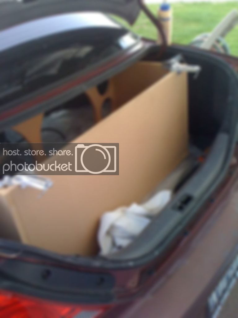

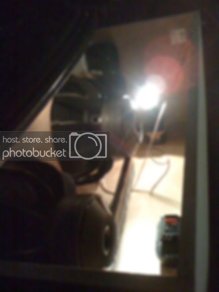

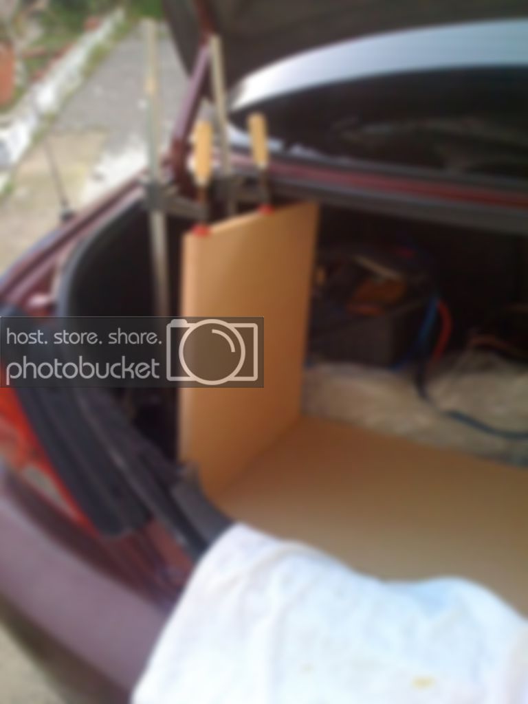

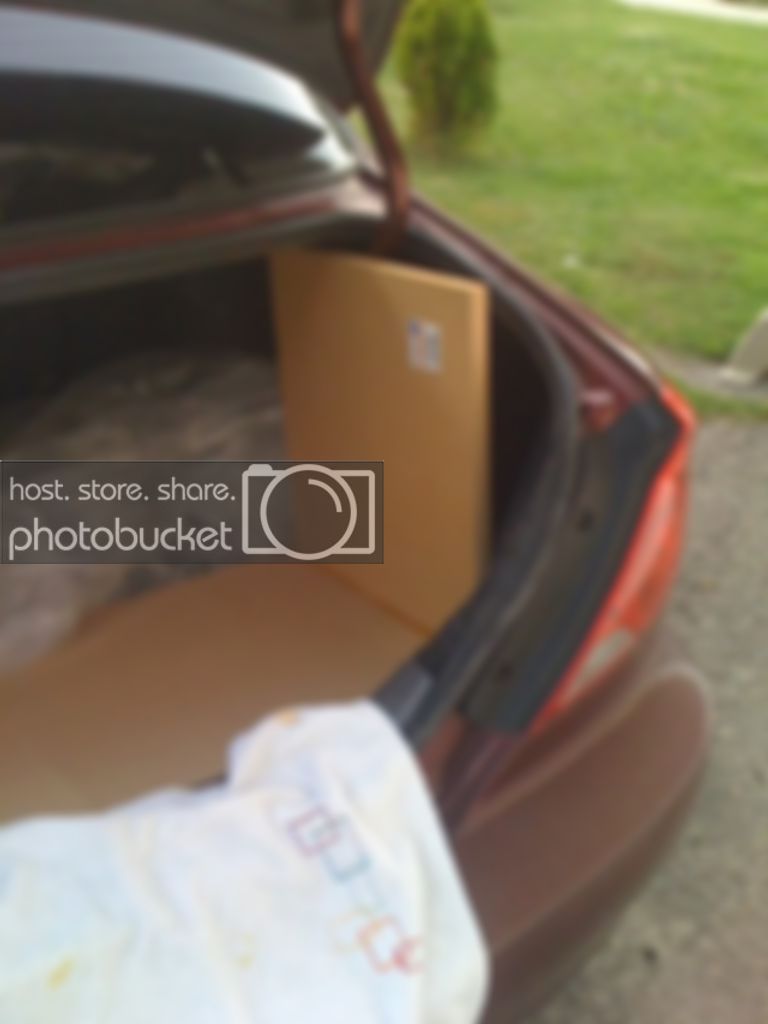

Box will be 4 cu ft net with 2 4 inch round ports tuned to 34hz.
Top of the box was put on last night, will be putting in the batts and amps today (hopefully). Now all i need is a HO alt and i will be good to bump. well maybe another batt or 2 also.
reason trunk looks dirty is because i had already put a layer of edead v3( the printable stuff) a few months back. but held on really well the product was great to work with. but thanks for the feedback
yea it is. tiny KIA trunk is very limited. but subs were built to work in medium sized boxes. recommended air space for each was 3 cu ft. hoping it does well or else back to the drawing boards!

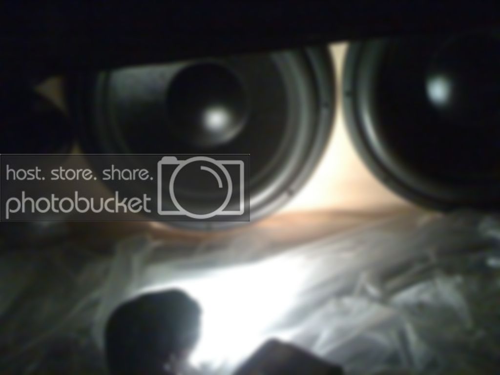

just fired it up for the first time and bot a little scare because i was hearing a very bad rattling sound then realized there was some plastic wrap/tarp in front of the port lol.

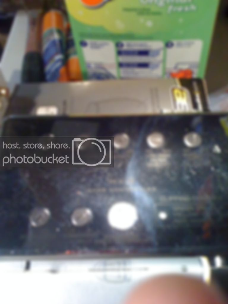

MX-3 inline driver (a little dusty) [/b]

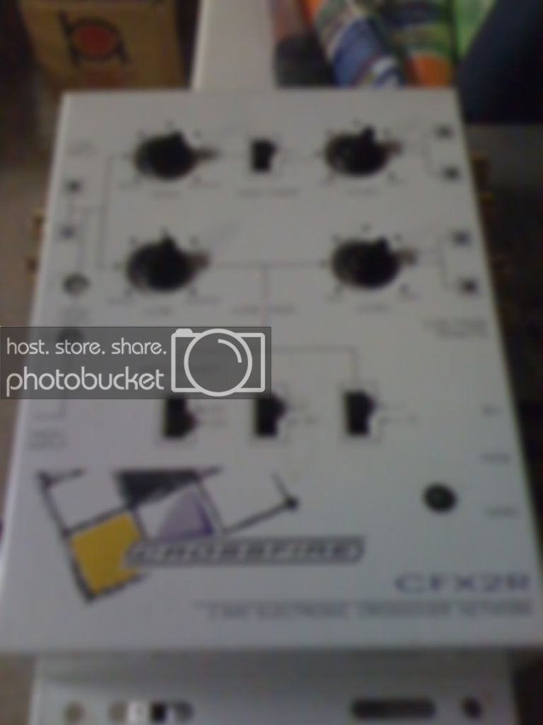

Crossfire Crossover (TEMP)

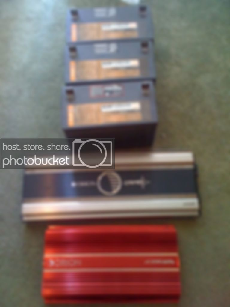

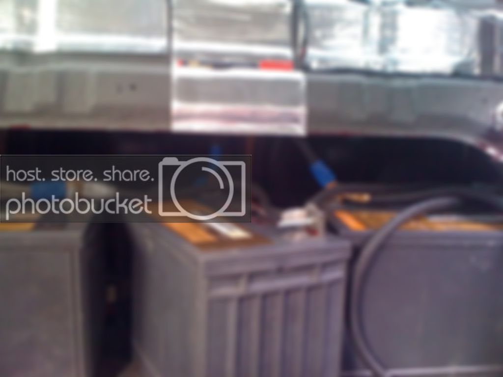

Three big batts to juice the set up!
