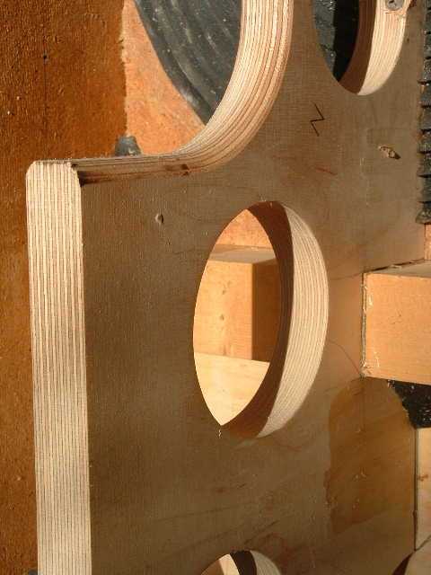

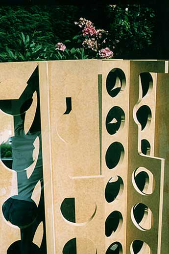

I've always thought that lattice bracing would restrict air flow because of how much material is used to do the bracing...
If done properly, then no. I cannot think of a high end loudspeaker or subwoofer that does not employ extensive lattice bracing as the main means to strengthen the enclosure. And I'm talking about Hi-Fi, in which turbulence is far more important than in car audio subwoofers. For example:
Also note that almost none of these are built using screws.
its not worth it man. u found ways that work for u i guess and i have found mine. BUT to entertain u here goes. resin IS NOT brittle. i have a peice in my back yard that is about an 1/8 thick and is very hard to break. it doesnt just snap with ease. and goop is amazingly strong, i have tested a DRIED and cured bead of it and the bead was about 1/4 thick, i literally could not pull it apart. im telling u man with glue, then screws, then resin then goop. theres no air or anything for that matter gonna break my boxes. there buillt like tanks.
You're right it isn't worth it, because while I'm trying to teach you something about physics and chemistry in speaker design and industry, you're talking about what happens to work for you.
