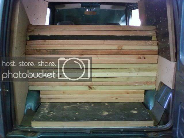

2x4s would be the way to go:
Pic was taken before I finished the 2x4s but it goes all the way to the top.

i dont have room for 2x4s for this design but i just dont see how 2x4s actually can help tremendously since they are made out of wood and i know they can flex.
