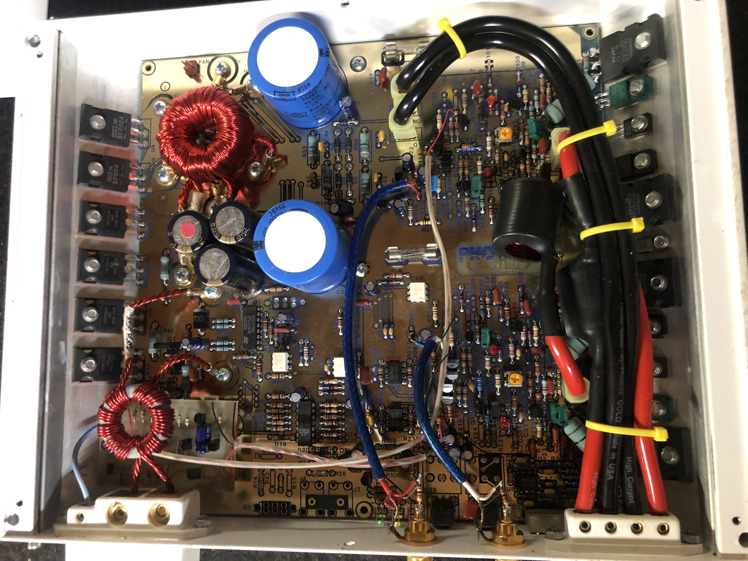

I’ve got a couple of old school Pheonix Gold Amps I purchased in the early 90s. They’ve been sitting in boxes literally for decades, I’m pulling them out for my 3rd gen Firebird build.
I noted the MPS-2240 appears to have some sort of a passive filter ? on the rca inputs, there is also another small board near the power supply.

It is a passive attenuator
If you look really close there should be a resistor where the ground meets the board too
It done to combat high gain when there are differences in the sensitivity between the source unit and the amp
It not something you see much now but it was the 90's
