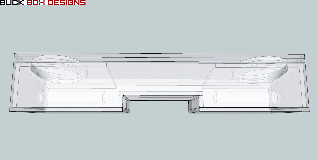

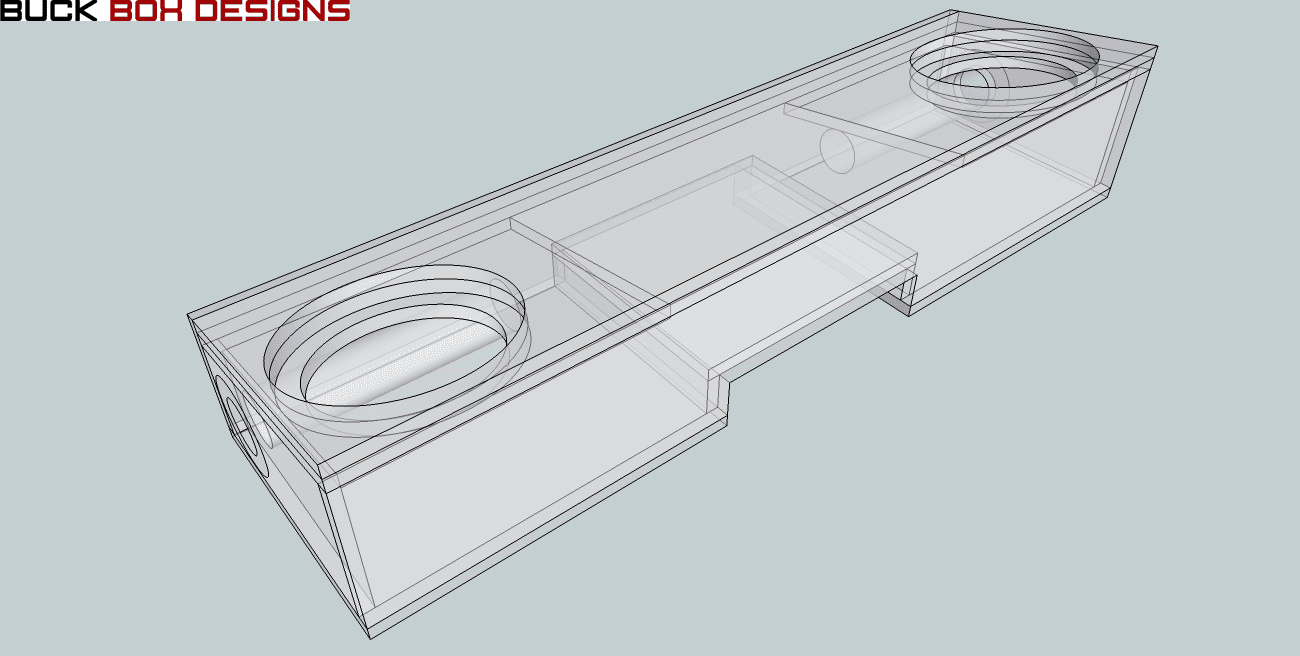

Would this work?
these were two alpine type s 10's. probably an extended cab full size truck.

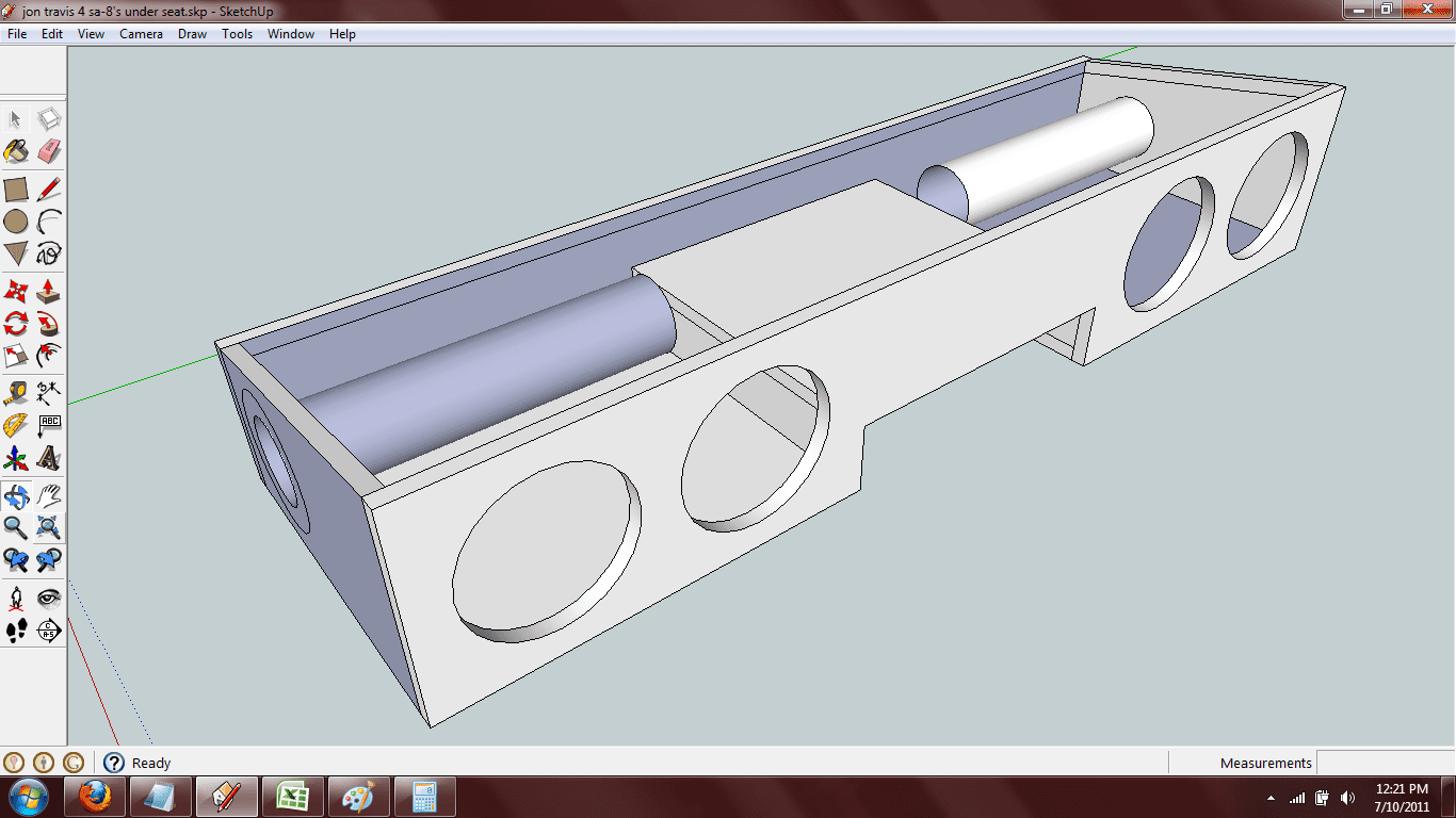

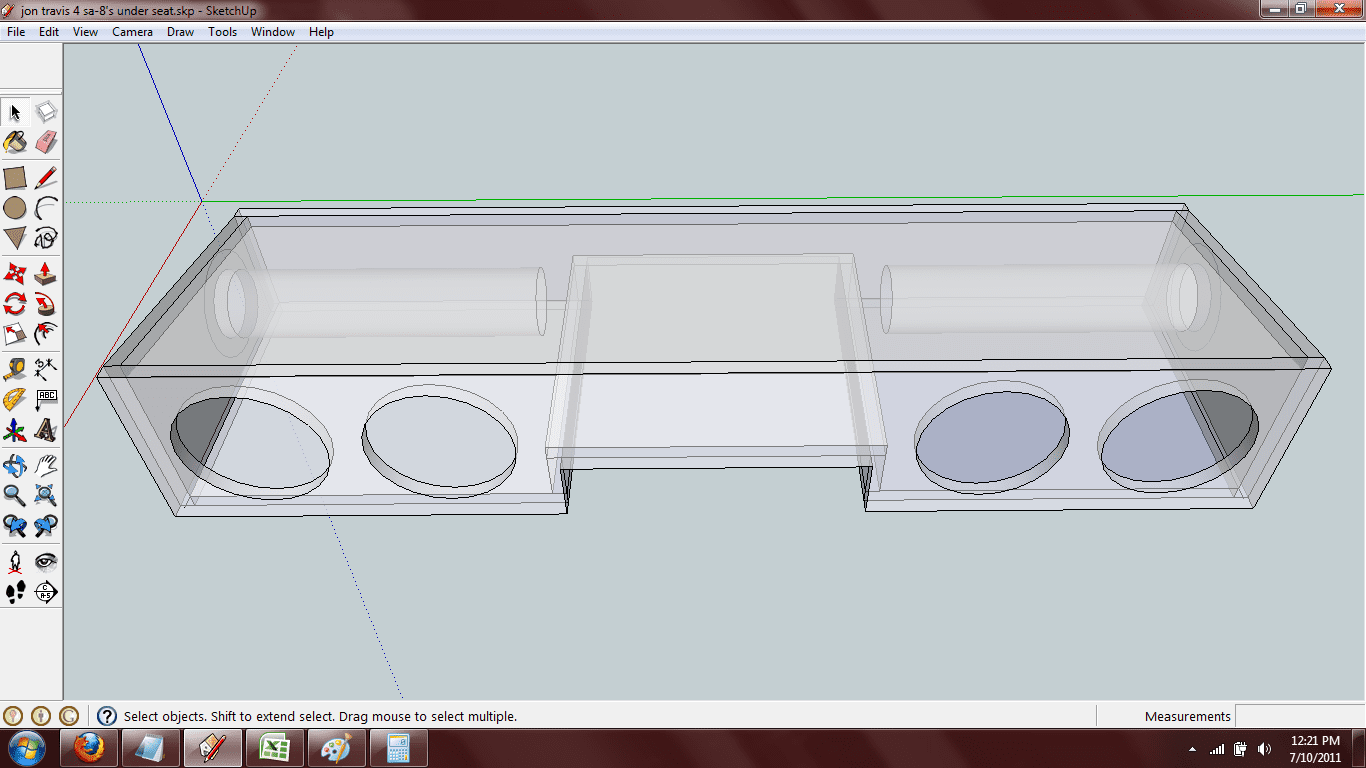

Oh the 4 8s setup is perfect, and would allow me to make this into 2 boxes instead of 1. That isn't a requirement, but if I can do it feasibly it would be best for easier box removal when I want to fold the seat down. Appreciate that.
4 sa-8's under seat. full size truck again.
I did quite a few of these sa-8 underseat boxes. The biggest problem you run into is the port.
1. Small woofers usually need more port area then their larger counterparts per cube. sa-8's need 18-20 in^2 per cube sometimes, if not, you'll get port noise. Where an sa-12, you can do 12 in^2 per cube all day long.
2. Obviously the axel/****** hump makes the port config severely more difficult.

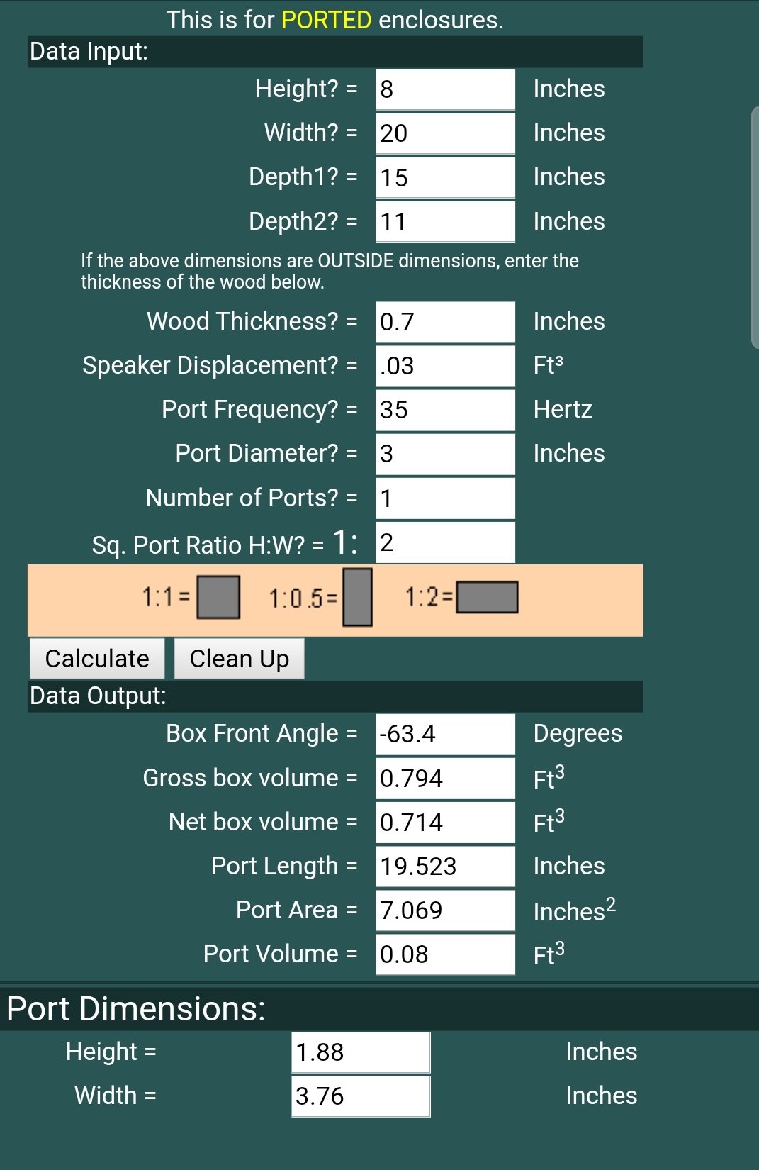

Hey so I did some calcs on doing 2x boxes instead of 1, and then calculated port size from an online site. How accurate do you think this is?
24594
Never know with these online sites. But it says my box volumes will be roughly .8 cubes, and 1.88x3.76 port at 19.5 inches in length, which is almost the entire box length. Thats to pull 35 hz tuning. Thoughts?
