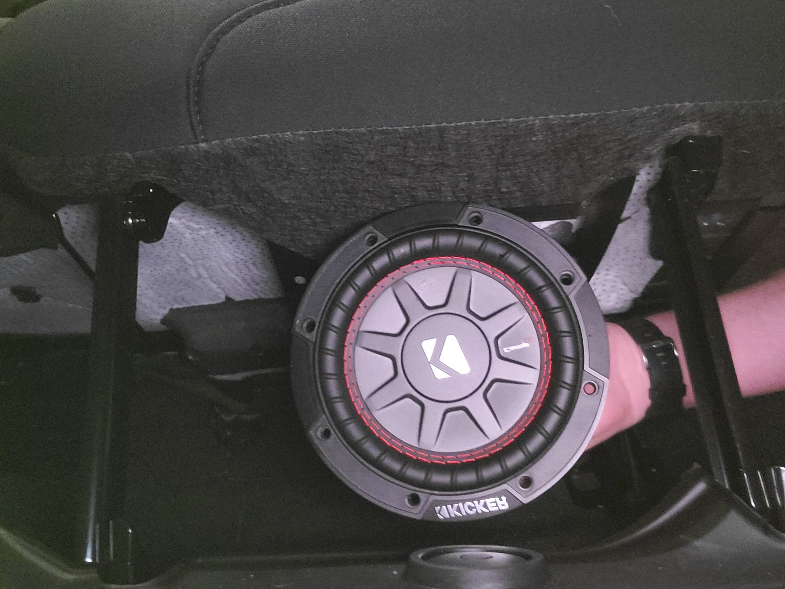

So interesting development. 6.5s should fit with no modification.

About an inch above and below. So, what are thoughts on this, 6.5s front firing, or 10s firing into the seats?
