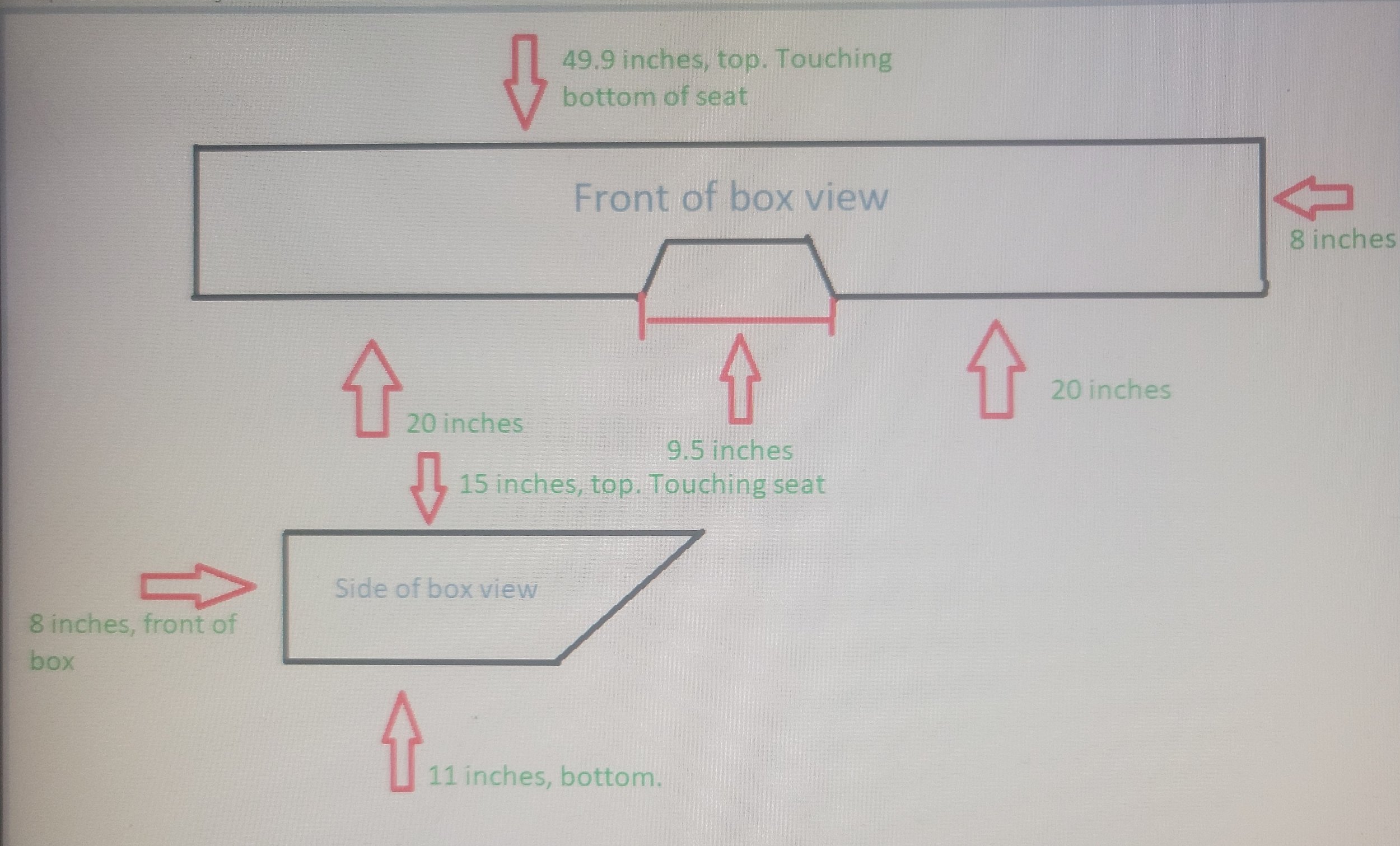

Understood. Is anybody here good with volume calculations? I did some actual measuring and drew a doodle, but not sure how to calculate it. Maybe you can understand my super awesome paint drawing...

Also, if somebody wants to help me figure this out, those would be outer dimensions. I also forgot to include the top of the center hump to seat bottom is 6 inches.
You definitely don’t want to put that hippo in .9 sealed. That is way too big. Sloppy bass city. I would port those at .25 cubes each, and as low as you can tune it to with your space. 30 hz preferably.
Alright as big as possible, 4x 6.5s, Once volume is calculated if I understand correctly we can calculate the port size. What port type would be ideal for this project?
Also, I'm planning to build out of 3/4 inch birch ply, unless somebody has a better idea.
