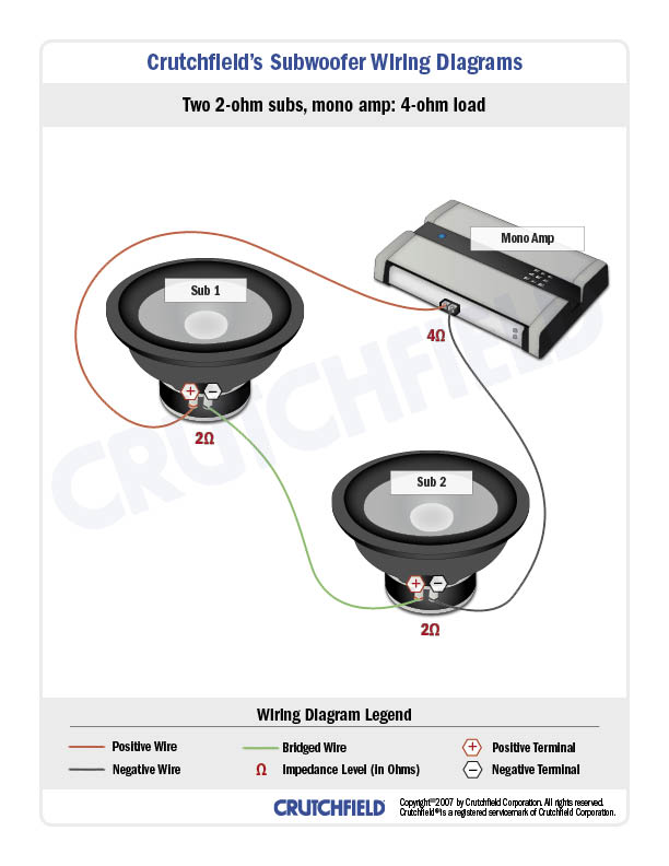

Seeing that you have a lot of knowledge in the car audio field. How would I go about wiring my monoblock amp to two infinity sub woofers? Whenever I wire one sub to the other and one terminal goes to the amp it doesn't produce much bass. It just sits there and moves the subs back and forth a lot faster than only having one connected.
Single voice coil and it is the Boss Riot R1100. It is 850 watts RMS, which I know is very over rated and boss amps are that good. But I would expect at least some bass to be produced.
I have tried wiring them like this
and this
but I get the same result from each.
I should have checked that while I had them pulled out of the enclosure earlier. I do not know if they are 2 or 4. But lets say they were 2 ohm, how would I run it? and same with 4 ohm. How would I run it. Just so tomorrow ill pull it out and check and wire it how you have told me depending on the ohms. Thanks again.
I would go with diagram 1....I doubt that the Boss amp is 1 ohm stable, and likely to damage it pretty quick. Safe to stay with diagram 1.
That's a 250 watt amp...it's not gonna blow the doors off but should make a little thump. It's nowhere near 1100 the claimed amount is. Disregard that number.
Diagram 1 is putting both speakers in parallel.
I guess my 500W amp may kick a little! It sure seems to! :)
John Kuthe...
Hi! I got it figured out and it does hit hard now! Thanks for the help! I got it figured out, it was my brothers fault. He had one of the subs wired to the terminal backwards so I was hooking the negative to the positive and the positive to the negative. I'm glad you said it was a wiring issue or I would not have checked that.
