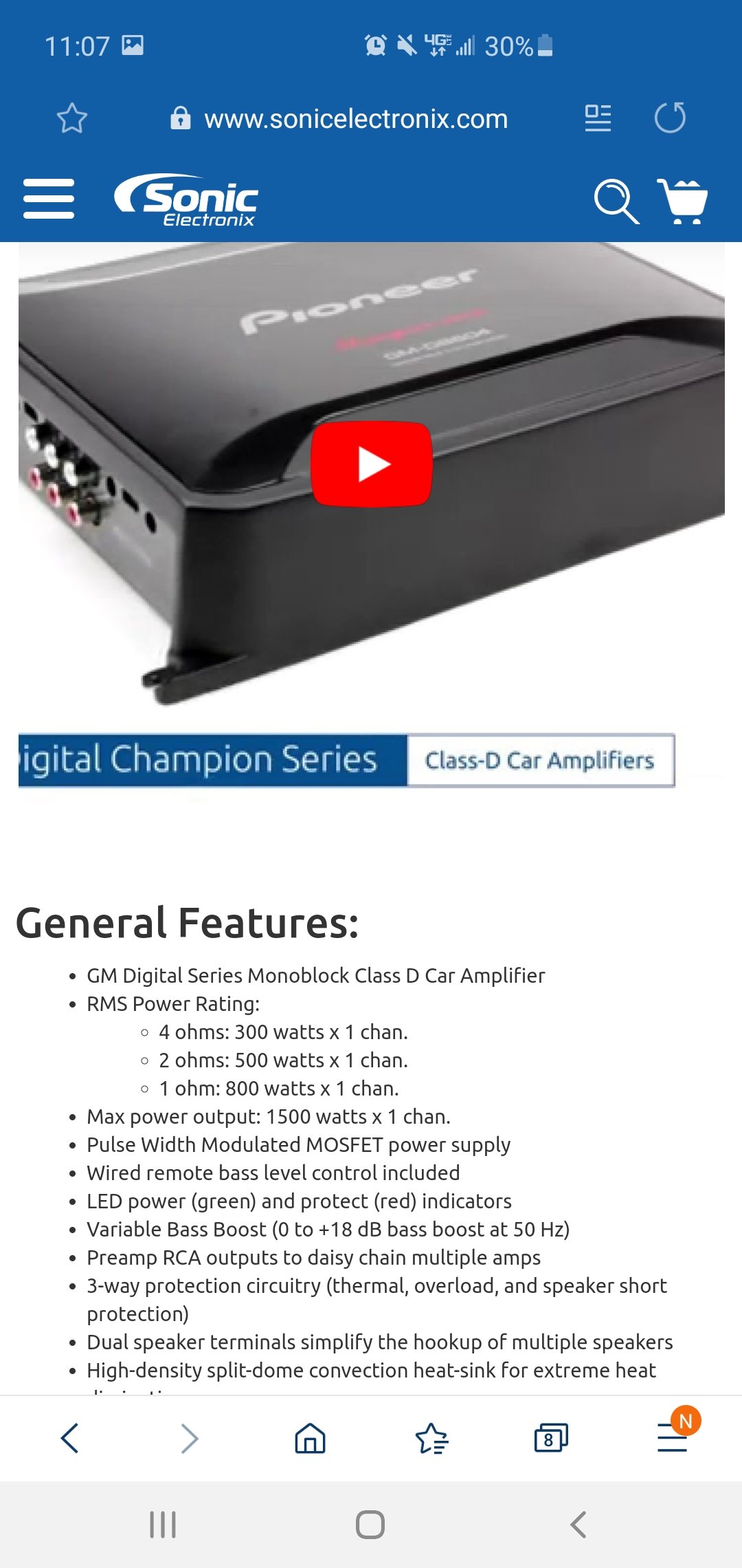

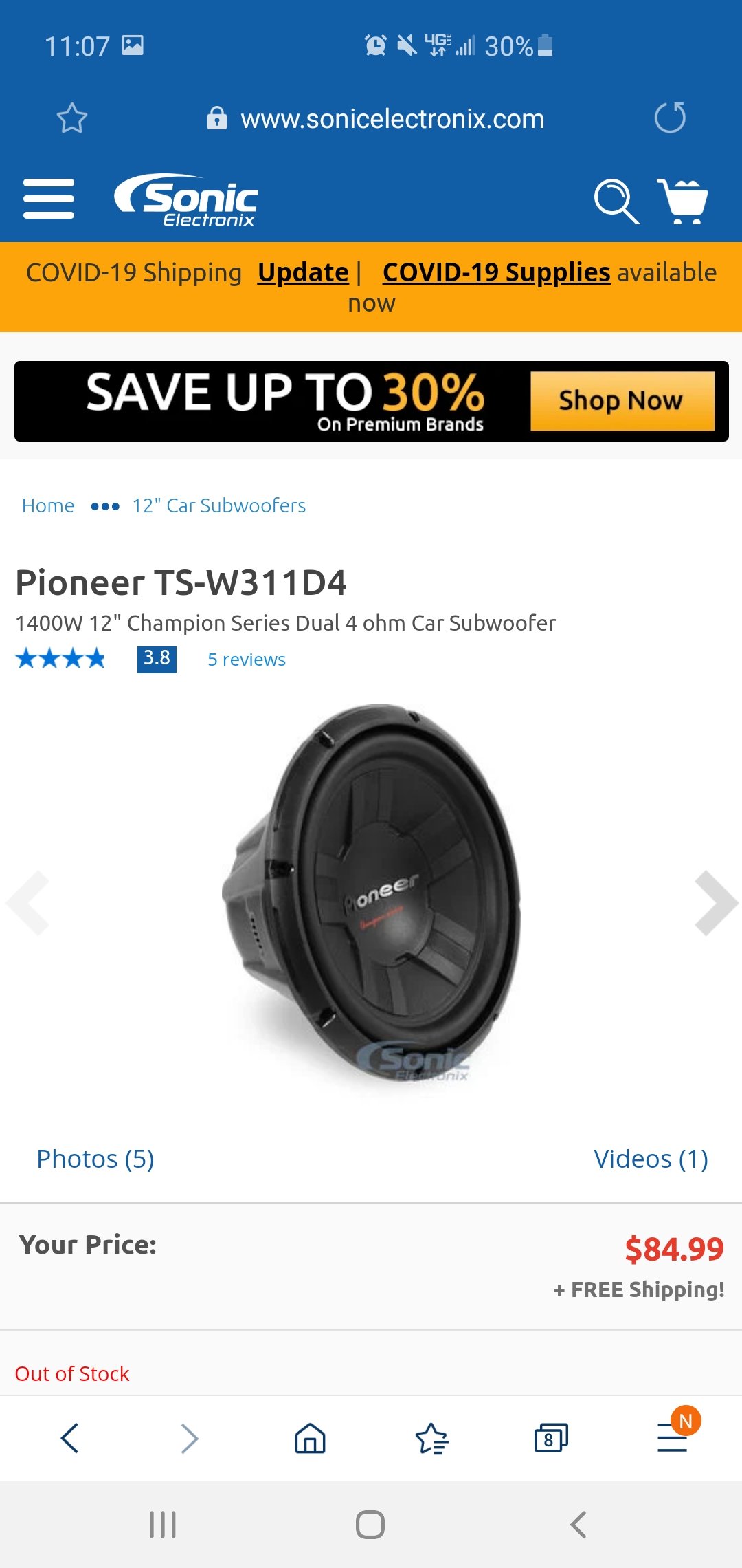

2 subs with each voice coil wired in parallel would be matched at 800W RMS on both the amp and the subs, so I'd say so as long as by "subs" you mean 2
Okay what about the max peak watts? I know the amp says 1500w x 1 channel and the sub is showing 1400w for one wouldnt I need 2,800w max for output?

The wattage quoted in the picture he linked was peak, it's actually only 400w RMS.
Yes theoretically if I used that amp it would blow my subs correct? Being 1200w rms? And I should be fine with this amp? Being a perfect 800w rms x 1 channel at 1 ohm?
Only if you don't properly throttle it back with a multimeter or oscilloscope, but in general it's good to match them because clipping is much easier for beginners to set to avoid and the amp will clip right at the level the subwoofer is starting to exceed its rating too.
Technically at 2 ohms it provides 800W, but the issue with that is with only two dual voice coil 4 ohm subs there's no way to get 2 ohms of impedance unless you ditch one of the subs. You have to choose between 1, 4, or 8 and those ohm values don't match as well as the 2 ohm one.

Well I should be fine then if I use the amp I posted above which hits 800w rms x1 channel at 1 ohm? No issues or dialing anything down?

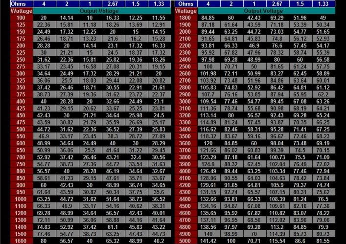

So you'd plug a multimeter into the terminals instead of a speaker on the amp and then set all the equalizers and boosts to 0 and play a sine wave tone, usually at like 40-80hz. Use this graph to reference what voltage you're looking for as you adjust your gain setting to achieve the rating of your speakers and then you're done.
It's worth mentioning on this you'll need a true RMS multimeter for a reliable reading.
