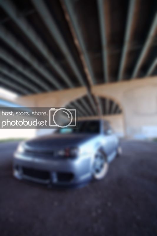

It's going in this:
*Not sure if it's relevant, but I also got a DNX8120 HU going in, as well as a RF T-1000 mono amp.*
Nice ride. You'll be fine with JL's sealed spec. You can use screws, but not absolutely necessary if you have enough clamps. Use 3/4" MDF minimum, if you use screws make sure you pre-drill the screw holes to keep the wood from splitting. Cut all of the panels first and do a mock up without glueing to make sure the fitment looks good.
