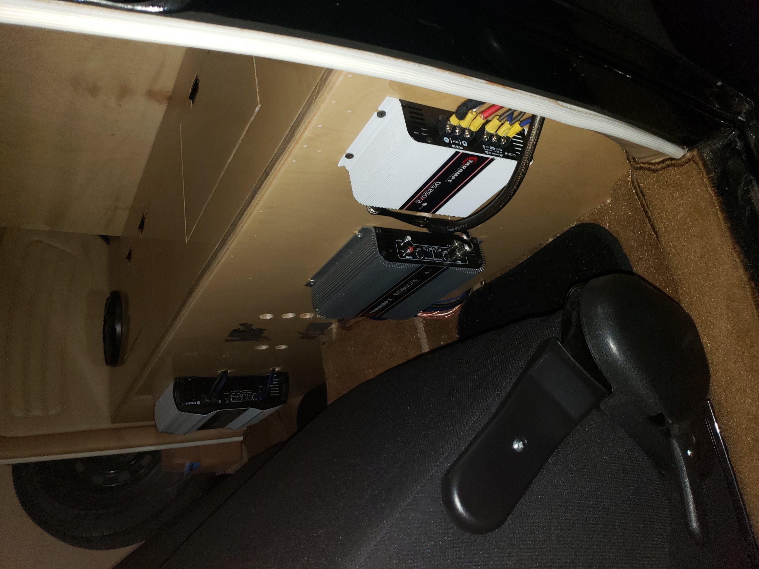

Haters!
Taramps DS250X2
Taramps DS800X4
Taramps MD3000.1 View attachment 20027
Just because you have those amps doesn't mean they're able to provide their rated power. I really think you're just trolling due to your boredom. At minimum, not even taking into account the efficiency of those amps you'd need 277 amps of power to produce 4000 Watts @ 14.4 volts and thats at 100% efficiency which doesn't exist in car audio. In reality its much closer to 300 amps @ 4000 Watts.

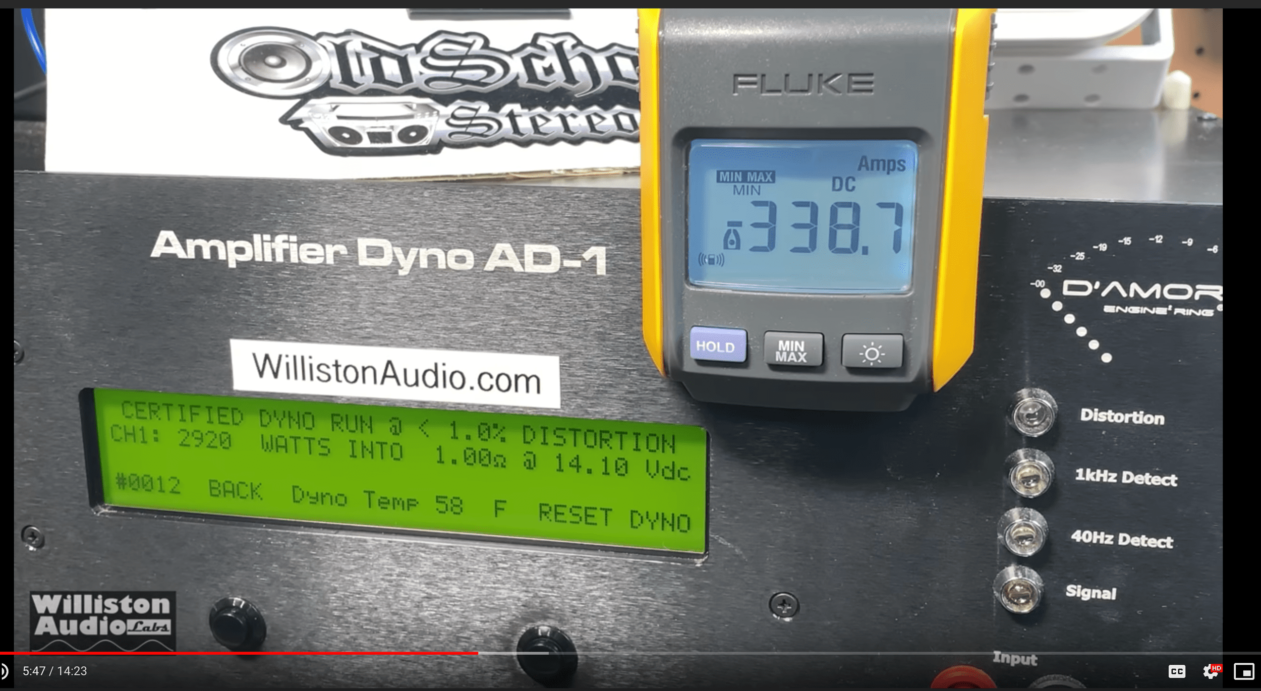

Here's a pic of the dyno vid for the Bassline 3k Amp btw:
GL getting your MD to magically not need ~243 amps while also still providing power to your others amplifiers.

I've two AGM's if that matters. 1/0 ofc big three. Remember, my car doesn't have a lot of other electrical (headlights, taillights, and fuel pump). The amps are rated over 4k, sorry.

It does, it makes a world of difference. Your amp may be able to provide rated power as a result but during extended listening times with heavy music you will eventually see voltage drop as the batteries drain due to the alternator not being able to keep up.

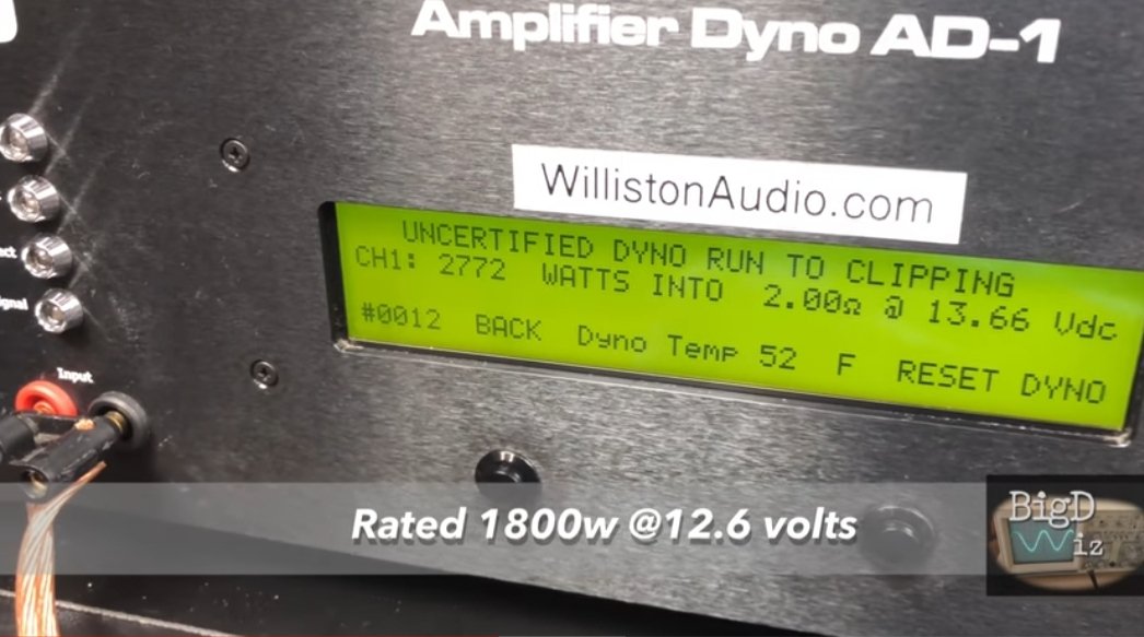

What does the MD pull? It seemed to work fine when we put a meter on it. MD's are rated at 12.6. MD pulls over rated wattage. MD1800 pulled over 2,200 on the dyno.

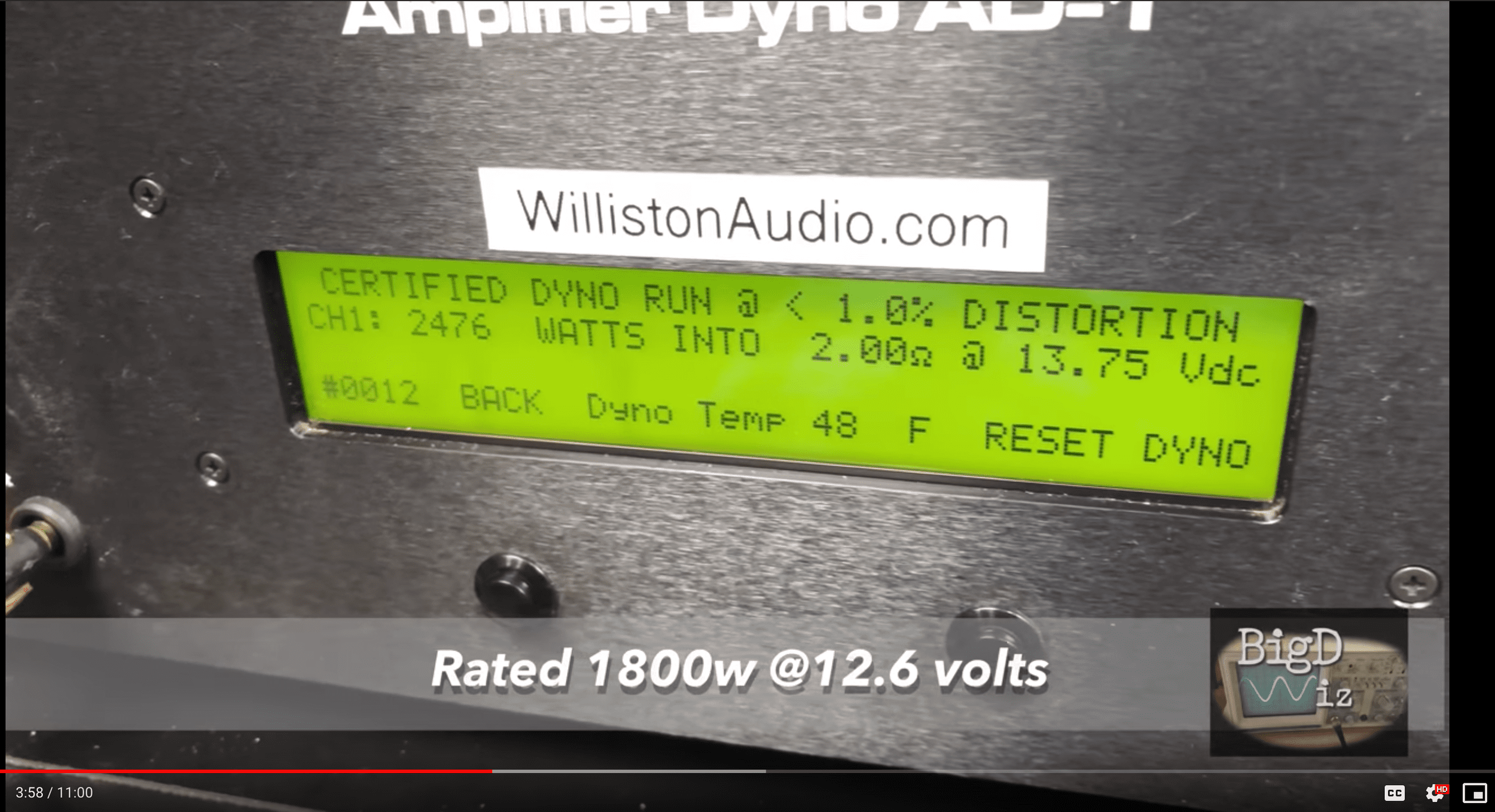

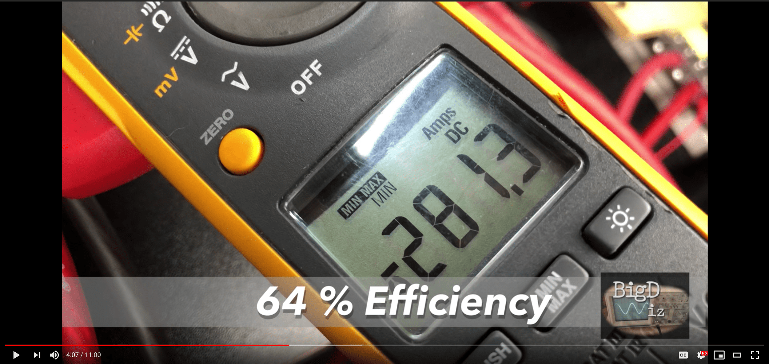

I can't find any dyno's for the MD3000 - Only the MD1800 @ 2 ohms, 13.75VDC - Provided 2476 Watts of power @ 64% efficiency. Which equals 281 amps of draw.

Making a lot of assumptions, but with 95 Amp alternator and 2 AGM's you'll probably get 5-10 minutes of max (non clipped/distorted) volume before voltage drop/clipping begins to occur. Depending on AGM size.

MD1800 over 2,700 on the dyno. If my car is on, I never drop below 12.6. We metered it from the windshield and doors open if that matters. He was on team Fi.
lol this is just sad now. You are not getting more than 1500w out of the MD1.8k.
