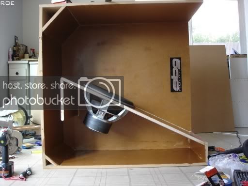

woofer installed on inner port wall?

ok...there wouldn't be enough area around the sub to gain, but i see where your coming from
are you thinking of a horn type enclosure?
a horn enclosure would be cool. i mean all i was wanting to do was be different lol. how exactly would you tune a horn enclosure? i never quite grasped that. ported i get but horn not so much
i have never even tried to tuen one, much less build one, deathbybass can design one, i've seen one he's built
i might ask 80 if he has any experince. Deathbybass seems like a decent builder but could give a rats *** if it has a few flaws. thas like the opposite of how i think
what are the Pros and Cons of a horn enclosure?
Pros;
Increased efficiency over a given frequency band, including reduced cone movement and increased power handling. Consistant group delay makes it easier to time align. (depending on design).
Cons; Very large enclosure size for true bass horns, complex to design and make, suitability for car audio use is doubtfull at best.
Horns work best in a far field environment, much of their efficiency comes from their high directionality*, this advantage is lost in the small space of a vehicle where near field effects** are dominant over much of the bass frequency range.
*imagine a sub radiating bass in all directions, now take all that spread out bass energy and focus it into a narrow cone, that essentially, is what a horn does.
**The cabin space of the car restricts the expansion of the bass wave and yeilds increased efficiency and powerhandling like with a horn, all be it with a more erratic response.
