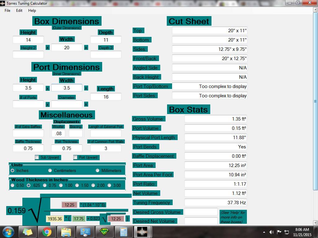

Q Power QBOMB10VL Single 10" Vented Ported Car Subwoofer Sub Box Enclosure Qbomb | eBaySo i only have enough for this box has anyone tried it? putting a lanzer max 10D in it with 1500watts. its .3 cubic ft off of the recommended(1.79).

To prove you that the specs are BULLSH*T. Its all inputted in. First off, side port is far from being the best way the port and fire. The port area is way too small, even with a 5/8 wood thickness, it doesnt help, imagine if they actually used proper 3/4 wood thickness. The 1.4 cubic feet claim is a GROSS cubic feet, not a NET cubic feet. You are at 1.1 cubic feet of USUABLE NET(the only airspace that matters) airspace after accounting port and subwoofer displacement(space they take up) If you take shortcuts on the enclosure, be prepared for your system hitting weak and sounding like utter sh*t. Build your own. Its cheaper than pre-made dog sh*t on ebay and way better quality.
