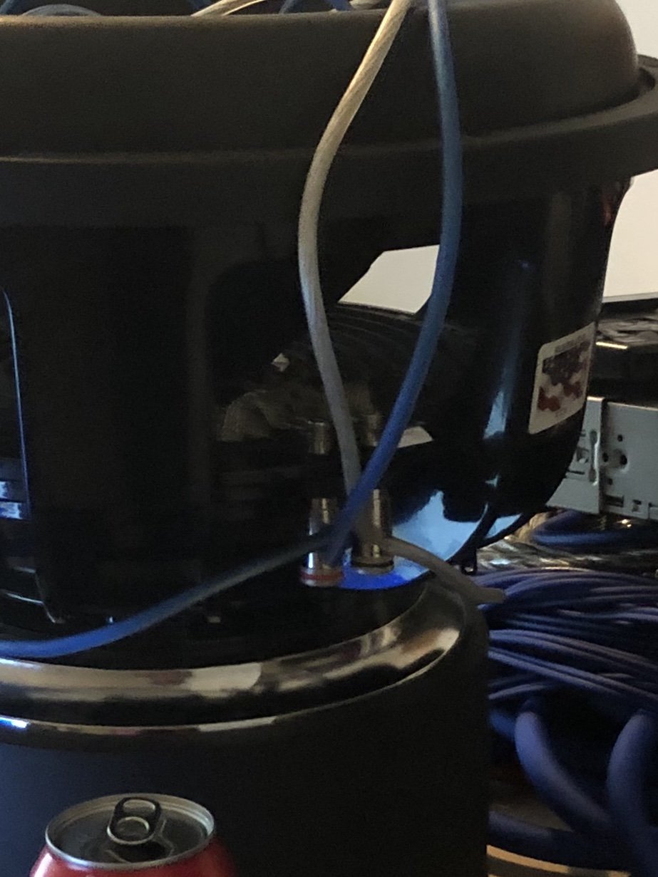

So this is probably a silly question but when wiring a DVC sub in parallel, I know that it’s pos to pos & neg to neg (obviously) but when taking each to the amp can they be T’d between the terminals? Or does it need to be from one terminal of each? (Attaching diagram for clarity’s sake)
If it is supposed to be like the second diagram, how exactly is recommended to get both wires onto the one terminal securely?
I’ve had no issues before doing this but have always used much smaller gauge wire for the sub wires and larger for the power and ground which didn’t crowd the terminals. The manual for the sub I have now says to use large gauge wire which makes it difficult to fit one wire in the terminal let alone two.

it’s the same thing. I wire mine in parallel like this so it’s easier and all the wires are the same length away from the box terminals and are closer together.
I’ve got mine literally spliced in the middle of the wire from terminal to terminal, running out to the amp.
I thought it should be just fine given the short length of wire n all.

so ima try to figure a way out to fit both into one terminal. The openings are only 3/16 of an inch or so. Can put one in on each side of the (1) terminal but not sure if there would be enough pressure to hold them in place, especially once it starts hitting.
Side note: the way it is now, using less current... what does that mean in a functionality perspective. Less efficient for the amp? Draws more power off the electric to compensate? Or something else?
Wire 1:Negative sub terminal 1 to negative sub terminal 2
Wire 2:positive sub terminal 1 to positive sub terminal 2
Wire 3:positive sub terminal 2 to box terminal
Wire 4:negative sub terminal 2 to box terminal
