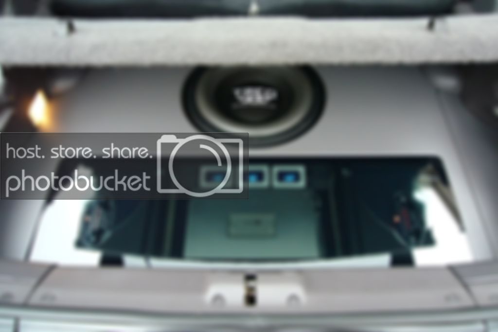

I honestly can't figure out what I want to do here. I'm tempted just to run a single SA-8 with a used amp and see how it is. The last time I did anything with car audio, well, this was my setup. Technology has come so far since I've last even touched this **** and power ratings are incredible to what they used to be. This is a 1990 Mitsubishi Eclipse, ran it with the stock alternator and a second battery, nice 4 channel setup, single 12 inch Treo, small aux battery, never had a hiccup with it and it sounded great.
