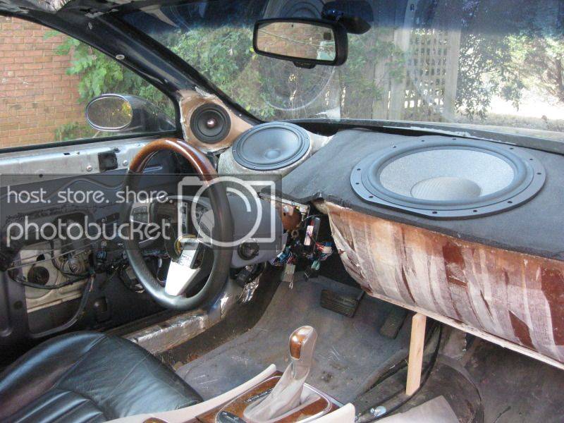

since your not using a very large sub you should come up with a low profile in-cabin location for it (rear deck, dash, center console, rear seat side panels,etc). trunk installs are just so uninspired //content.invisioncic.com/y282845/emoticons/boring.gif.42c69fa49b1e73e6332d62b462a2a4b3.gif
