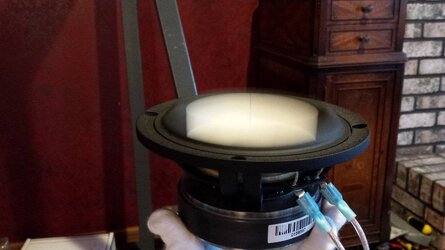

I appreciate all this. Gives me some direction from a different perspective. Man that little speaker is moving lol
