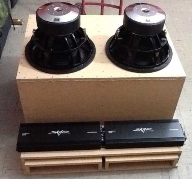

Local friend had his 2 15's in a Wrangler in a sub up/front ported box with the port close to the floor. It works rather well surprisingly. Soft top and all its well over 140db and can be heard and felt at a good distance. It's tearing that poor jeep apart.
Its been changed up a bit now with some legit power on B2 subs. Idk if he changed the enclosure yet but the gains can be heard and felt everytime he drives past. That jeep does rather well for a soft top even with the top off.

That's a cool place for those amps, if that's where they were.

wow!! 140 dB with a soft top. That’s crazy. I will post a pic of the current enclosure, with dimensions ASAP.
