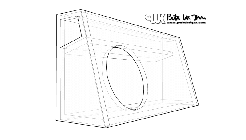

whats wrong with this enclosure???
The area above the port IS NOT DEAD SPACE, explain your reasoning, you know using science, that this volume of air is magically isolated from the rest of the enclosure volume.
air is like water in the fact that it takes the path of least resistance when it is being forced somewhere.
that area above the port will not be pressurized anywhere near as much as the air behind the sub/to the left of the sub.
Its not completely isolated, but partially so. the air goes around that "Area" above the port, straight to the port itself.
the air above the port is not being utilized to its full potential.....so now you have a condition where the port is too large for the air that is being utilized properly, and on top of that, it fires right into the sub which is no good anyway.
Hopefully that explains it just a little.....just remember that just about everything in enclosure design and tuning is mainly based on theory from ideas that people had many years ago.
the new box.
much better
how much did you pay for that design
im guessing at least 35
should have gotten at me for a 15 spot.

Looks like the same enclosure basically with the port on top, and on the other side. //content.invisioncic.com/y282845/emoticons/smile.gif.1ebc41e1811405b213edfc4622c41e27.gif

I still don't think that design was all that flawed. The same design except with port on passenger side has been proved many many times. Maybe it just didn't work well with your sub. Mob is known for great designs but maybe he just slipped on this one, no ones perfect.
