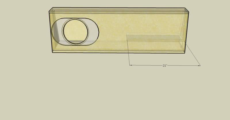

whats wrong with this enclosure???
burzendowski
i paid for this design and the designer says its a good design..//content.invisioncic.com/y282845/emoticons/frown.gif.a3531fa0534503350665a1e957861287.gif... the woofer unloads really bad in this enclosure . the sub moves like crazy until over excursion with no output just air movement. this enclosure produces absolutely no bass. the sub was tested in another 1.5 40hz enclosure with no problems. this design is a 1.5 38hz.
what do you think? Ive wasted so much money on this enclosure:mad:
truck enclosure double front panel 3/4 and a 1/2 the port comes out the side 21 long 14.5 tall 4.5/8.5 angle 50" wide
It's really hard to tell wtf were even looking at...first of all, what is the larger grey oval around the cutout? Second, what does the 21" stand for? Is tha like a port in the back or something? Can't really see it...
who designed it you can pm me if you want I got a real bad design from someone on here like 1 month ago but really did not want to bad mouth the guy
what is the larger grey oval around the cutout? QUOTE]
is this one of those Boston subs? SPG555-2 or SPG555-4? I heard those call for some crazy design?//content.invisioncic.com/y282845/emoticons/confused.gif.e820e0216602db4765798ac39d28caa9.gif
port is acting like a hole in the box. Its not a correct port
If the port wouldve been along the back wall and taller, or actually if it was a correct port, the location wouldve worked.
Well the enclosure appears to be tuned correctly, judging by the the volume and the dimentions of the port, the enclosure is long enough for standing waves to have an impact in the bass frequencies, though this wouldn't cause a total loss of output.
Do you get bass if you completely seal the port? (stuff a towel ect in it)
it appears the port isnt top to bottom of the box thats likly your problem
not to make it sound simply stupid but that would impeed air flow with the little pocket.
then explain how aeroports work....
There is a lot of dead space though, on top of the port
If the box specs are close to the sealed specs for the sub I would seal the box. Or jusr rip that carpet off and try to redesign the box by re-positioning the port.
I dunno, Cant he seal it and drop areos?
