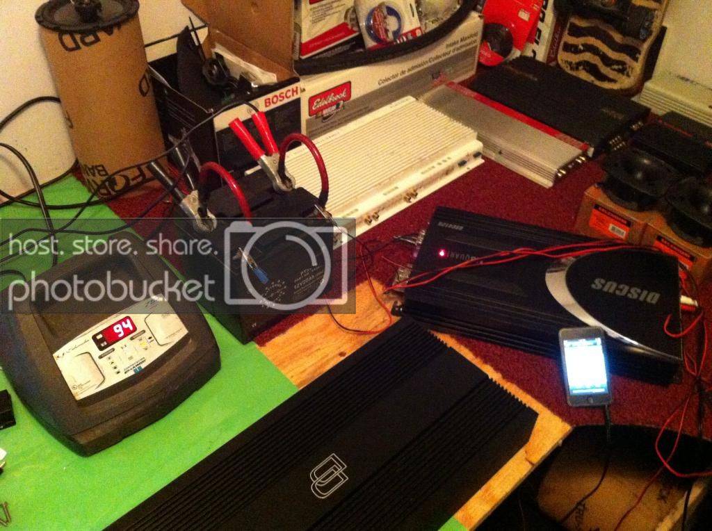

i use a pair of small 27amp hour agm batterys together to have 12v and 54amp hours avalable - this is plenty to test most 2 chan amps and head units - if i wish to test any of my larger amps - i attach my car battery charger to the batterys and set on fast charge - wich is a good idea anyways - as it usualy charges in the 14.4 to 15.0 volt range and its nice to keep your batterys maintained on the bench.
This is what I do also.

Or you can just get a small group 31 bat and a charger and be able to (temporarily) test big amps. A charger holding 14.4 is great, but after like 5 amps (or whatever it's charging at) is exceeded, it will quickly fall to battery resting voltage. So, it really is temporary.
as a super rough idea to guideline with - 100 watts of stereo power needs 10 amps as power. 500 watts of used stereo power = pulls 50 amps
so if you use a 5 amp power supply to test with the most your going to be capable of putting out is 50 watts total.
is why its so much better to have a battery or 2 up on the test bench to use as they store alot more amps capable of being used to test with
as a super rough idea to guideline with - 100 watts of stereo power needs 10 amps as power. 500 watts of used stereo power = pulls 50 amps so if you use a 5 amp power supply to test with the most your going to be capable of putting out is 50 watts total.
So I am better off with a regular car battery on the bench with the capability of keeping it charged as needed? And just use a power wire with an inline fuse and a ground wire for larger amp testing. Again I dont want the amp to stay running for extended periods just make sure it powers up and the speaker outputs can be tested.
Thx
You're assuming the source is a mere 10 volts... (10v*10a = 100w)
If you use JUST a charger (No batt) you would get available amperage * charging voltage. Assume it's charging at 14.4v and can supply 5A of power.. 14.4 * 5 = 72w. Using a charger without a battery is pointless imo. What OP should do is just get one very small AGM battery and a simple battery charger. Get battery's AH rating and you can figure out from there how much power you can supply for any given amount of time. (50AH * 12.9 = 645W for one hour, or twice that for half an hour, and so on)
I wouldn't even bother adding the chargers supply, because even if it's charging at 14.4, it won't be able to handle any load. (Say it charges at 5A) After 5A is exceeded, the voltage will quickly fall to battery resting voltage anyway.
Thx
yes - a car battery up on the bench - with a float charger attached is a great way to power up and test car stereo items
