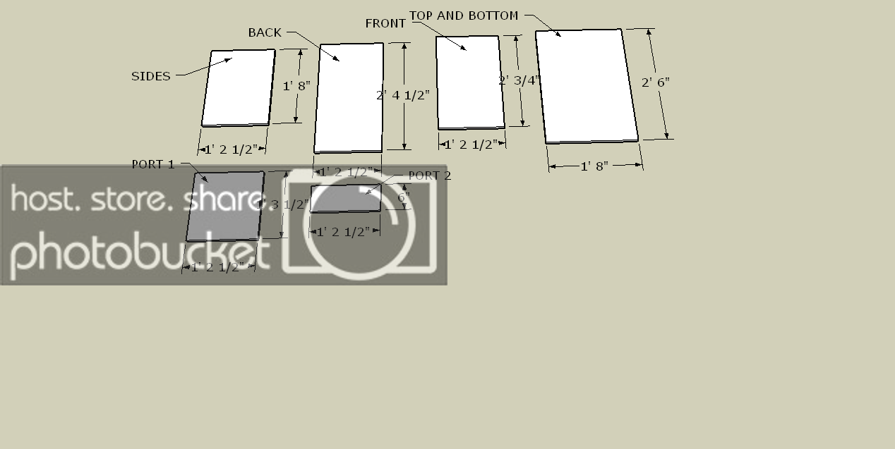

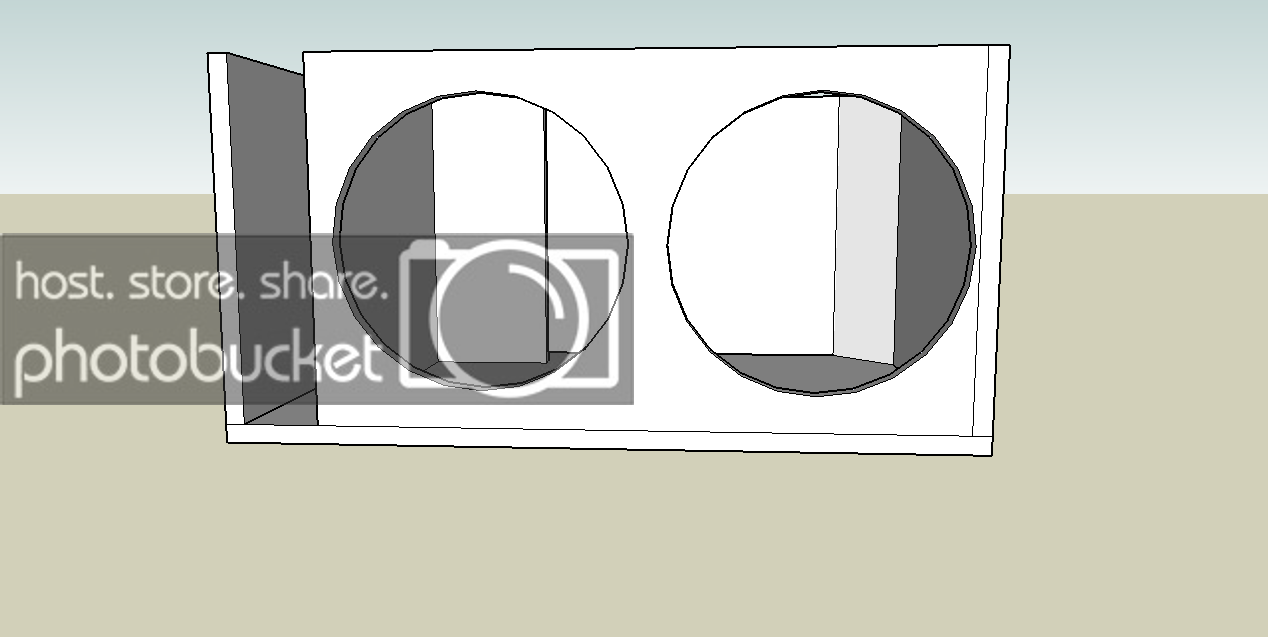

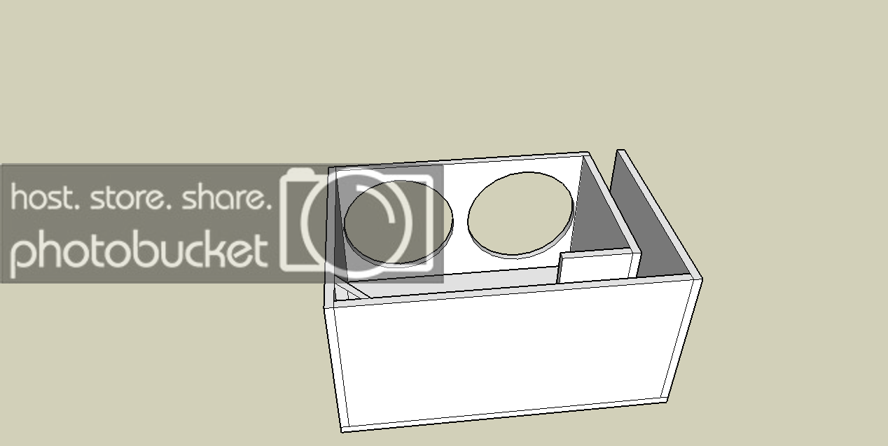

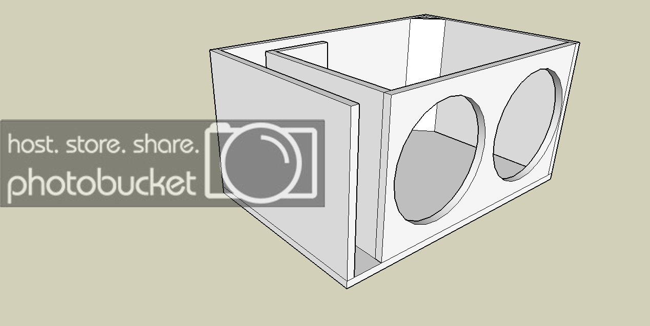

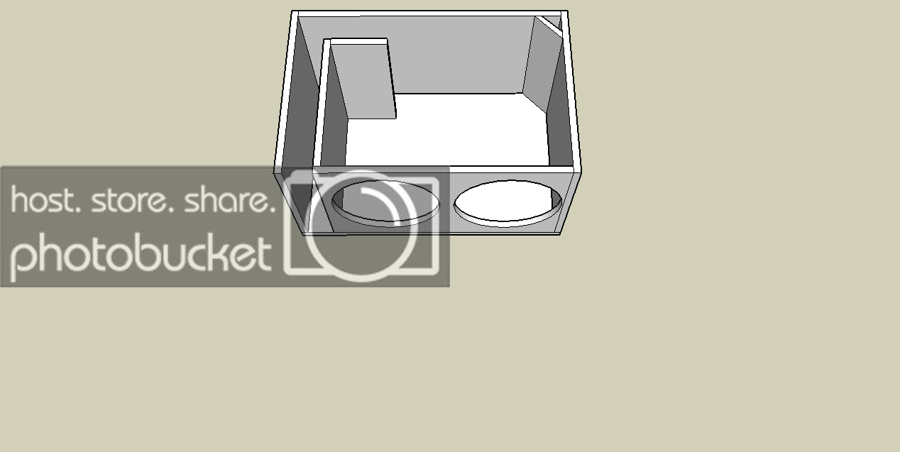

Sorry buddy for leaving you hanging today. Had to run out quick, had an emergency. FREE PLAN.
CUTSHEET
Best I could do with your Diminsions. Cramped space in the trunk of a cavilier.
3.7 cubes @ 34.603 and some change Hz 43.5sq in. of port.
