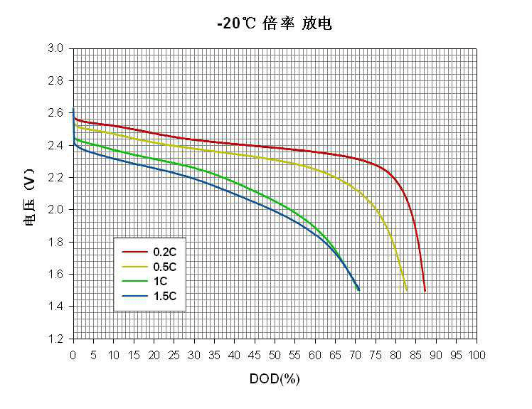

What I am really curious about is finding the spec sheet for the 66160 Yinlong cells XS sells, mostly out of curiosity. Might have to e-mail the Chinese distributor that @hispls used for his big order. I don't doubt that you and spls have the specs correct for the cells he's already got.
Consider the depth of discharge chart for LTO:
45721
Charging up 16V or above may not hurt them but it certainly isn't gaining you much of anything over charging your 6 pack at 14.8.
