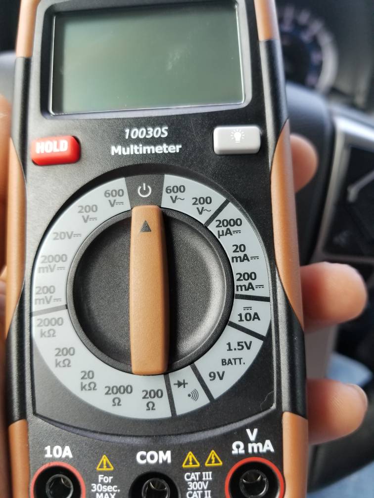

What setting would it be

Just as popwarhomie said, set DMM at 200 ohms. Stick probe in each pos(red) and neg(black) of the terminal of the sub. Should give you a lower number if the subs are dual 4 ohm, then it might read 3.7 or 3.6 There's never a perfect 4.0 coil read.
Same with dual 2 ohms. So the DMM should say 1.7 or so give or take a point or two. Let us know how it goes.

I just picked them up the lowes reading I got was 3.6 so I got them. Now just need to figure out the dimensions for a box and build one
