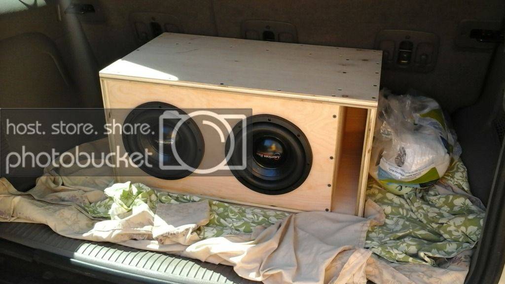

Starting to sand the filler. Only one of the 45's are for the port in this box, but I filled the others anyways. I'd feel like I did a half-assed job if I didn't lol.

OP, here's a model of your current sealed(purple) and the ported design I'm building for the Gcon(teal) . Both on 400w, but there's a huge difference. I know that doesn't account for cabin gain, but a 9db gain at 30hz and around 8db at 40hz. I'd say build the box design I posted.
Here's Dcon ported(teal) vs Gcon ported(yelow) both on 400w in the design I posted. **** near identical, but of course the Dcon power handling limits it from getting as loud.

so basically that shows I should be happy with sq in a ported enclosure like that then right? Am I seeing that correctly that it seems to stay fairly flat ported also?
