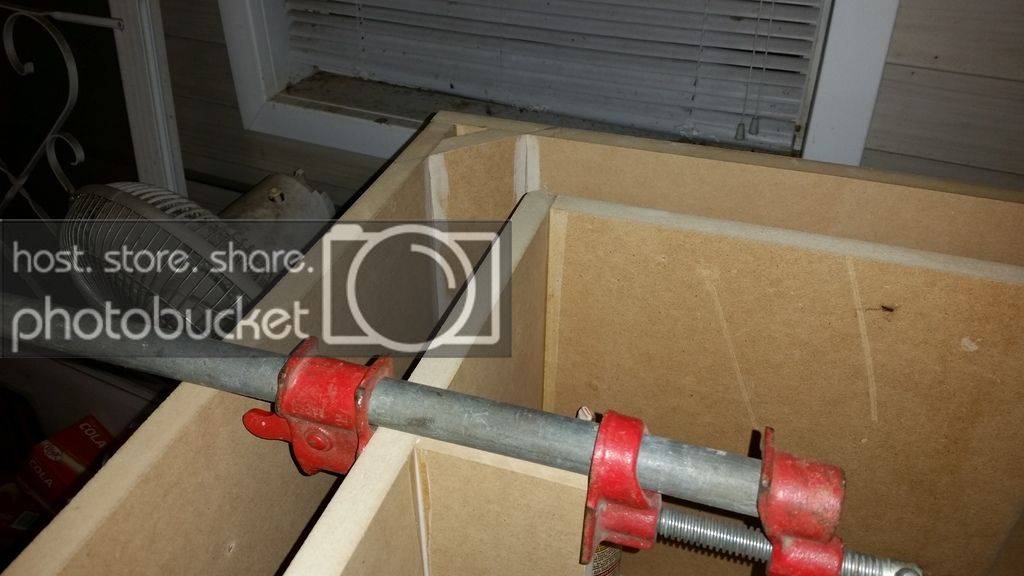

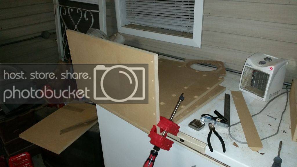

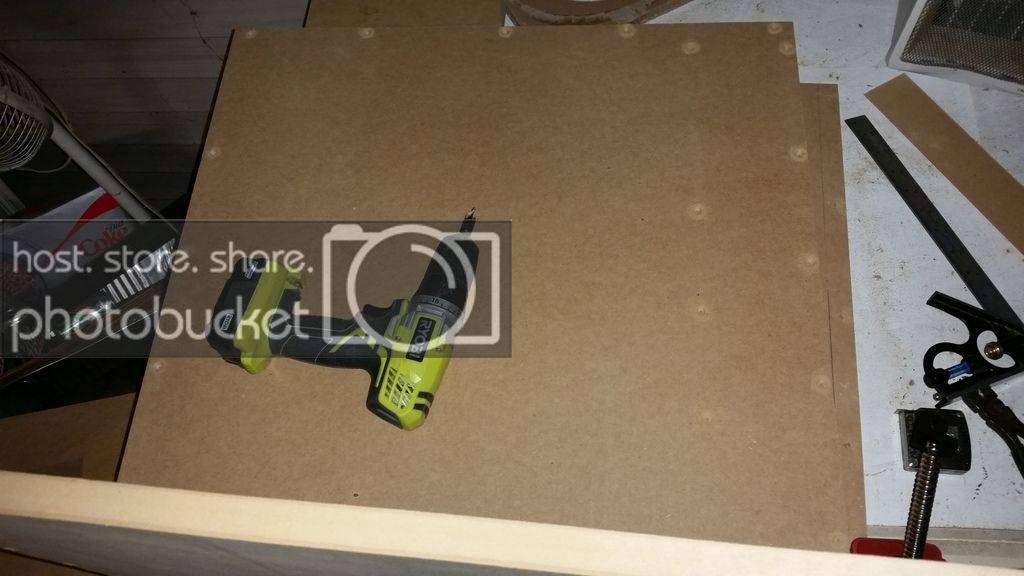

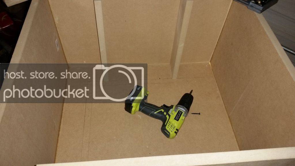

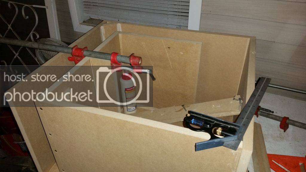

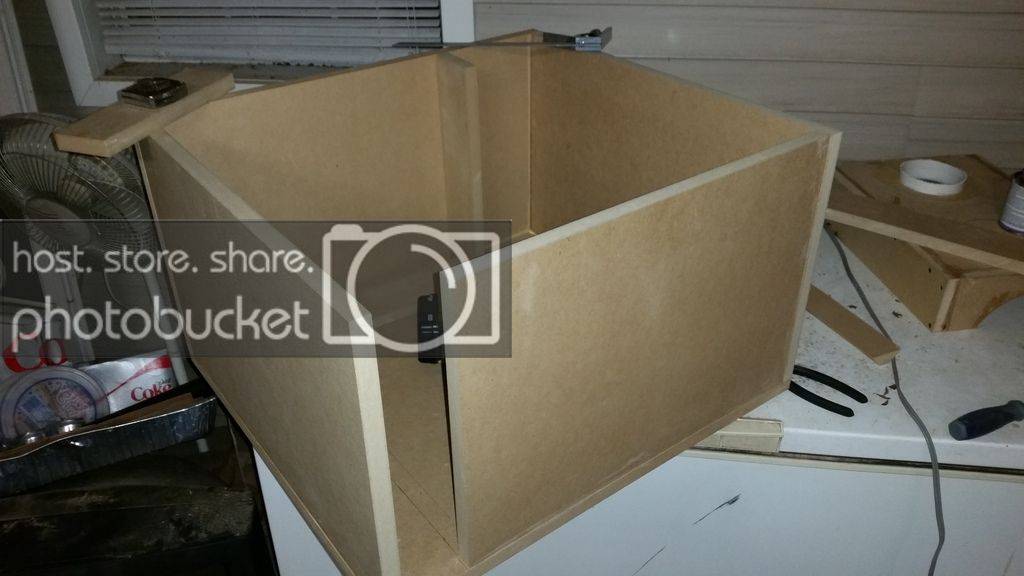

Wasn't able to get the box finished today, but I did make some progress. Box is 2.63cuft@32.5hz with 15.39sqin of port per cube. I saved the design if anyone wants it, it will work with both the Dcon And Gcon 12".
I always dry-fit everything together and pre-drill/countersink before I break out the glue. When I design my boxes, I make one end so there's an overhang on each panel. After the box is assembled, I hit the edges with a flush trim bit. Makes life a lot easier, and looks cleaner.
