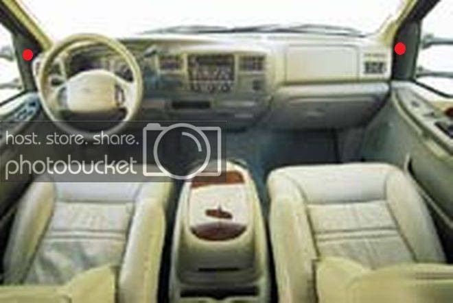

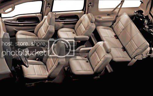

I have gutted the entire interior and done selective placement of CLD with around 30% coverage, complete coverage from the windows down with CCF and MLV, and even have some of the hollow areas packed with foam. I drive a Ford Excursion. Now, just in case you don't know, this thing is HUGE. Cargo area BEHIND the front seats is 165 cuft!! Its just a LOT of area to fill with sound. Here are some pics so you can get an idea of what I'm dealing with here.
This is just to give you an idea of the overall size of my interior. It does not include the rear cargo space behind that third seat, though.

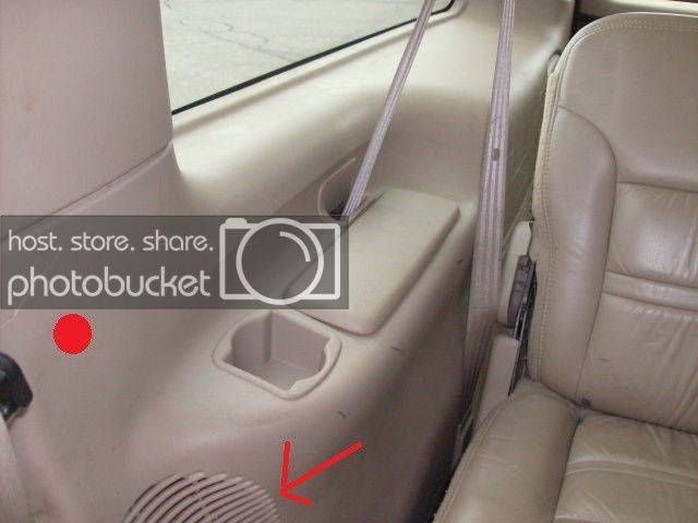

Here is how big the rear cargo area is.
Speaker placement for rear seating. Arrow shows stock location where I have the 5 1/4" placed. Red dot shows where the 3/4" tweeters are installed.

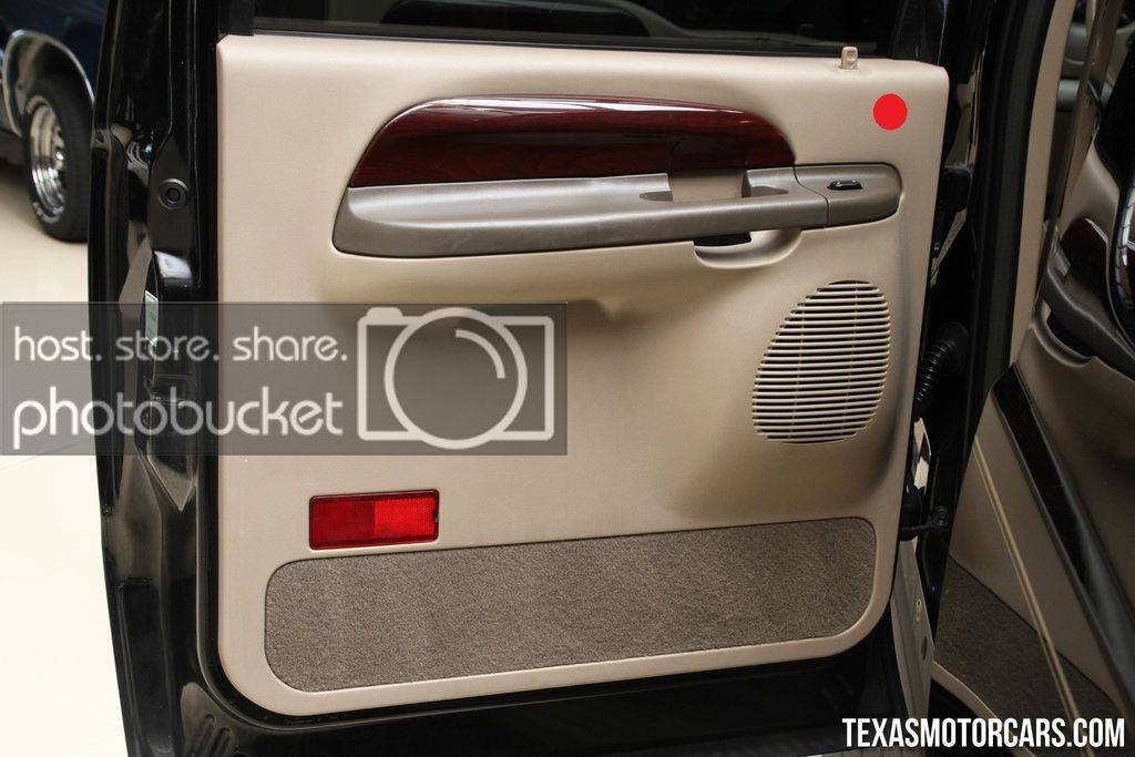

Speaker placement for middle seats.

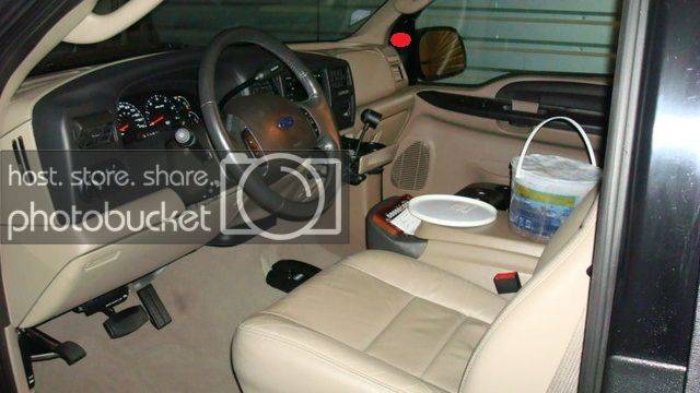

Speaker placement for front seats....two shots just to give a better visual.
