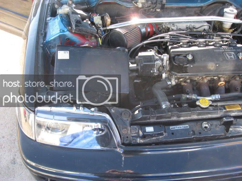

One of my cars is a 1997 Civic EX coupe. For my electrical I am using a Kinetik HC1400 battery, custom 175 amp alternator, and reprogrammed ODB1 ECU that removed Honda's Electrical Load Detector. I also did my big 3 with some Knu Konceptz 1/0 that was given to me by my cousin.
As for Honda's electrical load detector. That kicks in when the situation is right to save fuel and it reduced my voltage from the 14s to 12.5 when it kicked in. Now, my ECU doesn't even know that I have a ELD so my voltage stays constant.

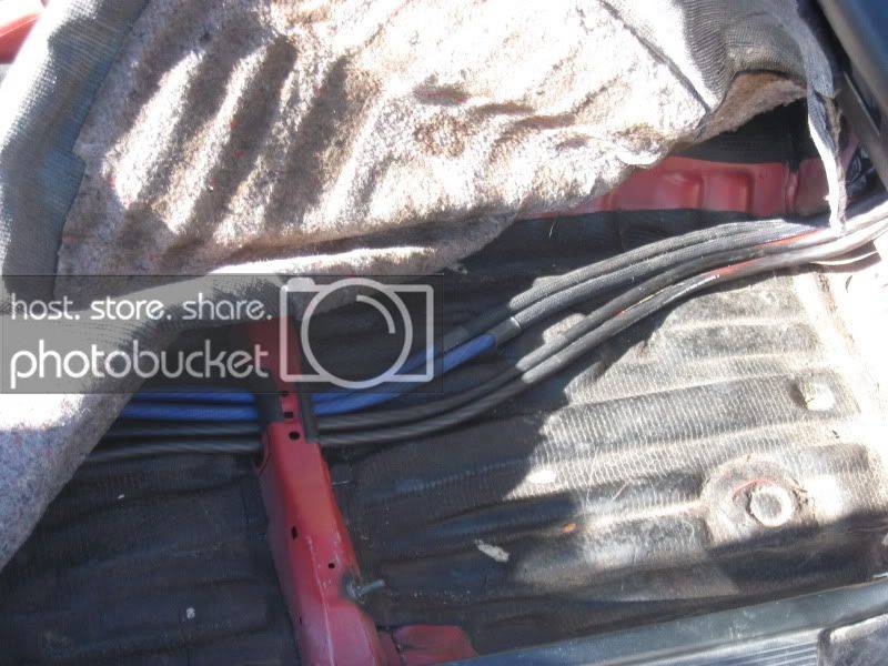

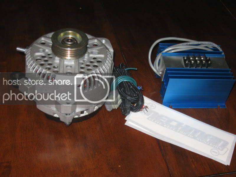

Group 31(one under hood, one in spare tire wheel well) and a 220 amp Mechman alternator with external regulator. 1/0 wire strung everywhere. No problems with electrical at all.
