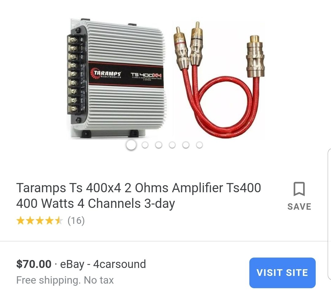

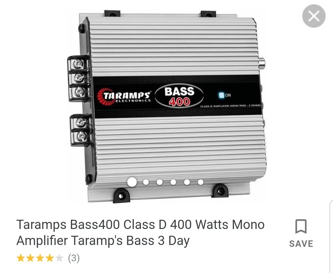

Would these work for you?
Yes. A speaker amp will greatly help your speakers to keep up with the sub. Might be hard to find two decent amps for $200 but it's possible with patience and time.
I have an idea... I found this Metra adapter and it plugs into the wiring harness that goes into the amp. I believe it just bypasses the factory amp and uses the head unit to power the speakers. Do you think buying a higher wattage head unit to power the speakers and buying a monoblock amp for the sub would work out alright?
Yes but I strongly suggest that you get a 4ch eventually so your speakers don't starve/distort. Very cool to have a sub but even cooler to have speakers keeping up with it.
