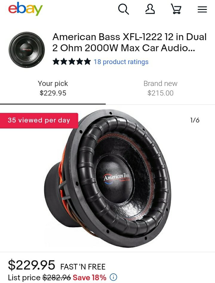

This. It's hard to beat for the money. They can take a pounding. Make sure that your amp is one ohm stable. If it isn't the buy the dual 4 ohm sub and run it at 2 ohms.
Thats a good looking sub. Ive book marked that site. I may try one out for an Xmas present to myself??
